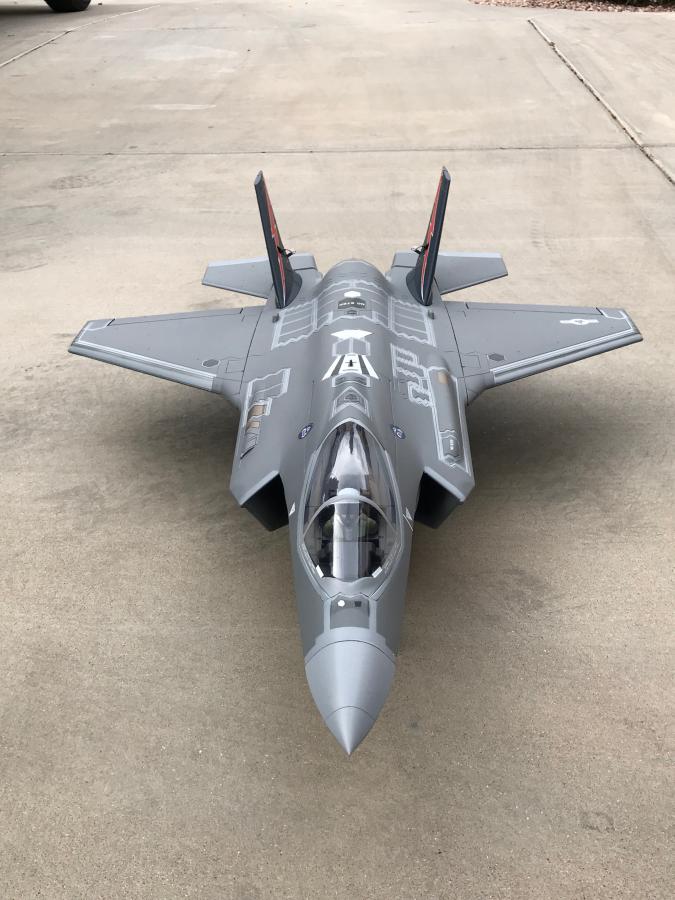

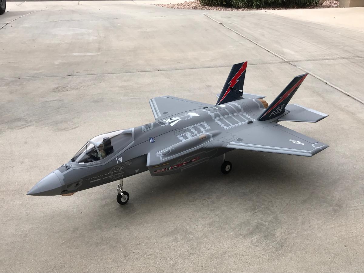

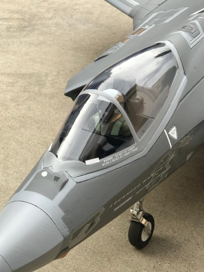

    Got mine today and already built. This was the fastest and easiest build I've think I've ever seen. Absolutely simple.
    Couple of points:
    1) The CG in the manual is ambiguous at best. I just found what seems like the best/right spot and it's balanced. Battery as far forward as it will go. Hope that works
    2) The way the ailerons wires are coming in to the receiver won't allow for flaperons to be set up. It's a one-piece Y-harness. I'll have to replace that with 2 separate long servo wires so it can go into 2 channels on the receiver. The way it is now, you can only plug the ailerons into 1 channel. They can't be split up. That's a bummer.
    3) This plane is absolutely GORGEOUS. This is probably the best looking plane I've ever seen. Wasn't crazy about the scheme when I ordered it, but it looks fantastic! It's :Cool:
    4) It's not a big plane, but it seems like it will have plenty of power. Wings are small as are the other surfaces, but the way it's laid out should provide for good handling.
    Will maiden later this week.
    Thanks Motion and Freewing. Another winner, for sure. Keep 'em coming!
