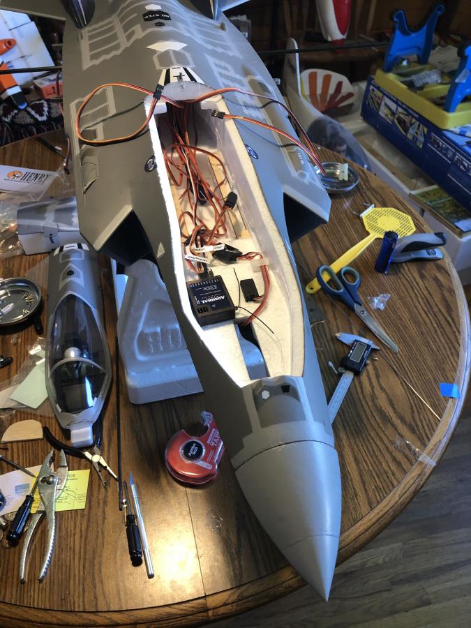

        I have just changed out the Aileron Y harness and installed two new 30" extensions, so I can set up the F-35 with spoilerons as a few others have done to make the landings just a little bit slower. Running the two new servo extensions was a little bit tedious and took more time than I thought it would, but I believe it will be well worth they effort. Now to get it back together reprogram and get it ready to fly with spoilerons

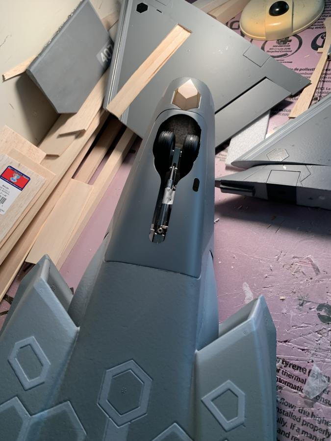

                    I've started my C version rebuild. I got the fuselage yesterday and just transferred everything back in. I had to replace one servo that had stripped gears. I decided to go ahead and modify the nose gear while I was at it so I ordered an F-14's nose gear and cannibalized the lower portion that fit the F-35's nose strut. The wheels weigh a ton so I am going to swap them out for some lite weight ones. You can see the new wings under construction in the photo as well. I thought I would also add this information for anyone that might be wondering...the replacement fuselage comes with the rudder, elevator, and aileron wires already installed. There are no decals on the plane at all. Only the light grey painted lines and shapes are there as you can see in the photo.

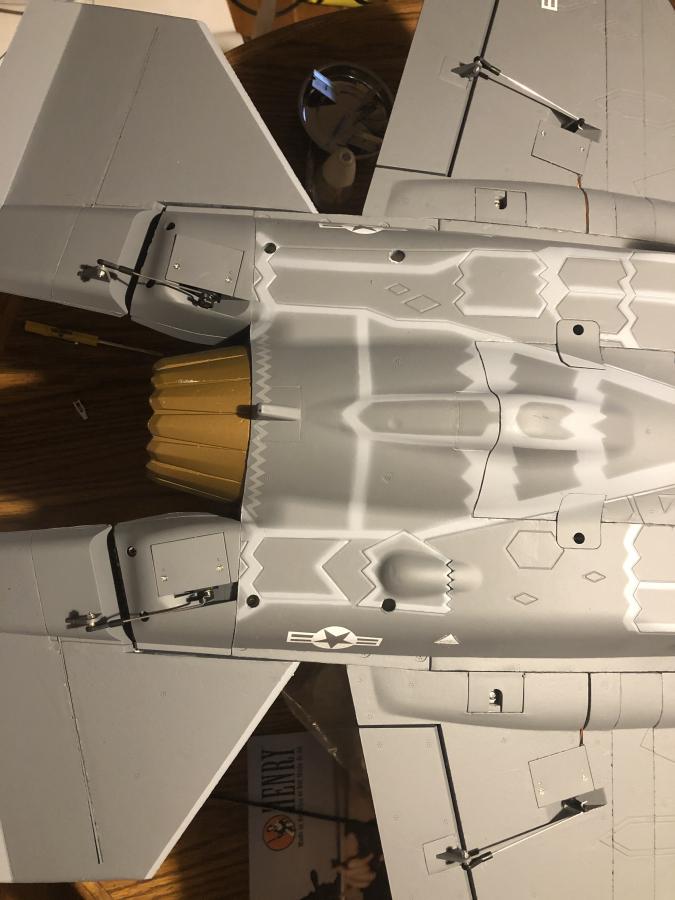

                                          Just thought I’d put this up
                                          A bit late, but do-it-yourself afterburner on mine:
