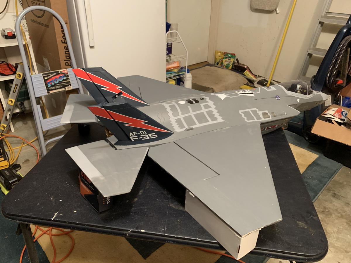

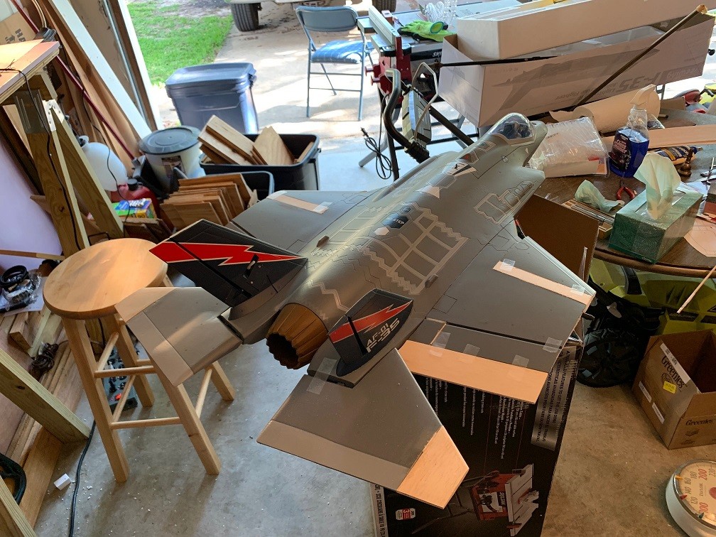

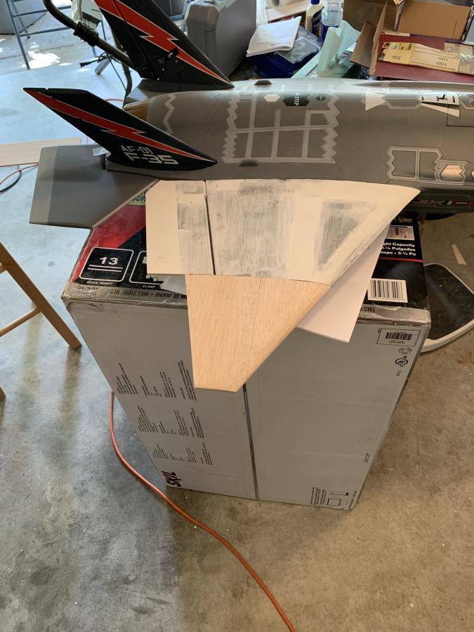

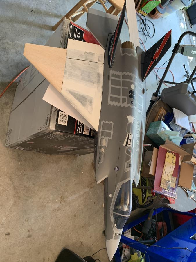

          • Here are some pictures with the extender blocks in place. Everything is just taped together so I could see how it was going to look. The extender blocks in the main wing are EPS foam but I feel pretty sure I am going to make them out of balsa instead.

            • The larger wings and control surfaces on the F-35C were required by the Navy for slower landing speed on carriers. I imagine that would translate well to RC. The landing gear on the Navy jet is beefier as well. And don't forget the tailhook bump underneath. Awesome project!

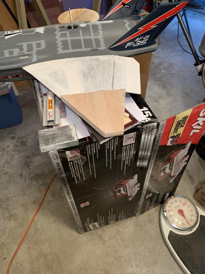

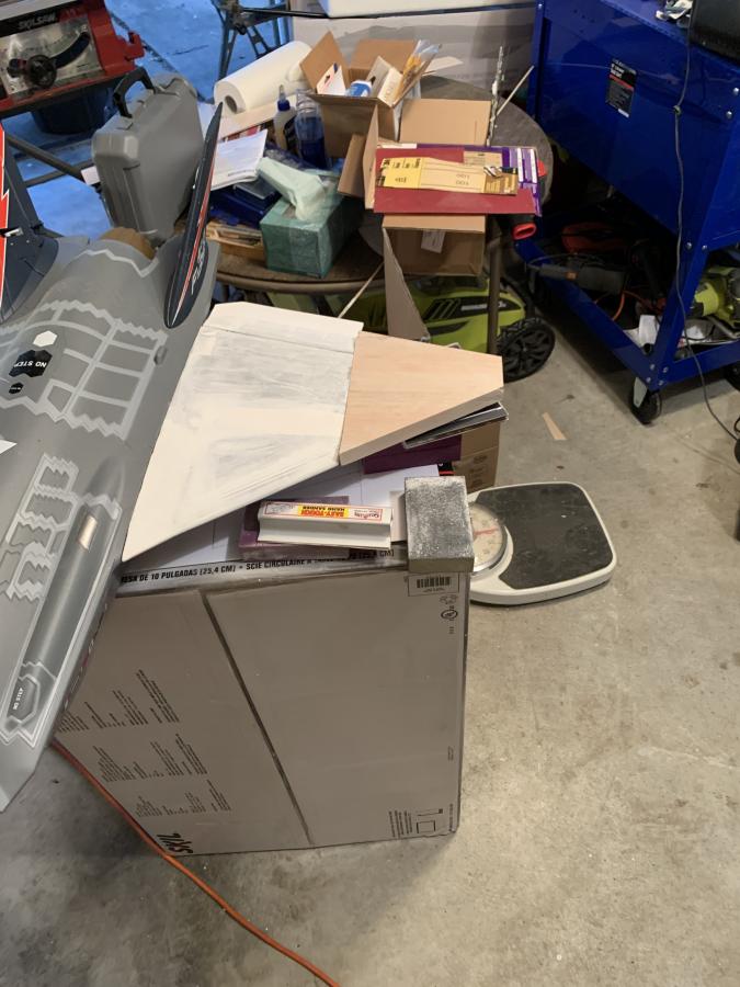

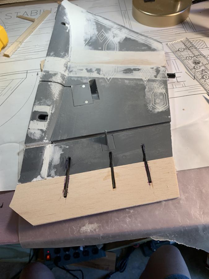

              • I have been working on the main wings the past few days and got the leading edge done. At the root I molded the wing out of a combination of lightweight Spackle and Elmer's Carpenter's Wood Filler. The last coats are applied with the wood filler thinned with water. After three coats it is ultra smooth and very strong. I added three carbon fiber square rods to the flap extender pieces and then filled with Spackle and again the final coatings are with the wood filler. (I still have two coats to go one the wings) I learned about the wood filler from an article on finishing balsa model rocket fins. http://www.apogeerockets.com/educati...sletter298.pdf
                I am now working on the wing extensions which will be solid balsa blocks. Once I get them done then I can work on the addition of the aileron servos and wire routing. Question for anyone...does it matter if I place the servos out on the new extension pieces for the wing or is it better to keep the weight closer to the center line of the fuselage on the original wing? I can mount it in either location and the difference would only be about 2.5 inches inward if I mount it on the original wing.

                Here are a couple of photos of the wing extension block rough cut to give you an idea about the full size of the wing.
                Click image for larger version  Name:	IMG_6343.jpg Views:	0 Size:	93.8 KB ID:	252771

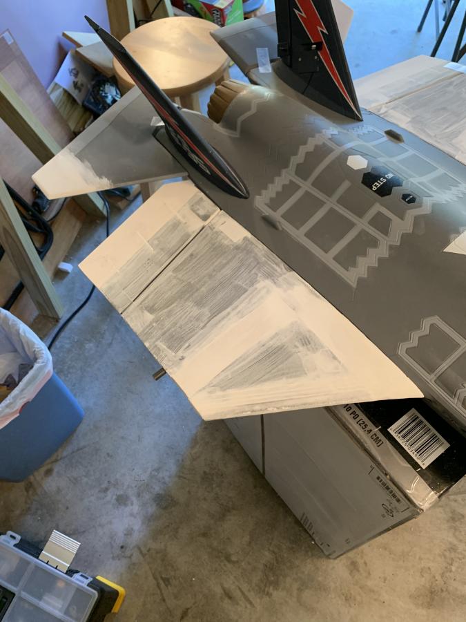

                Here is the right wing with extension attached and sanded to shape.

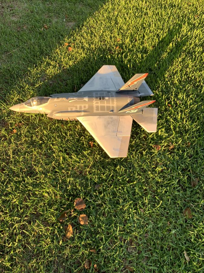

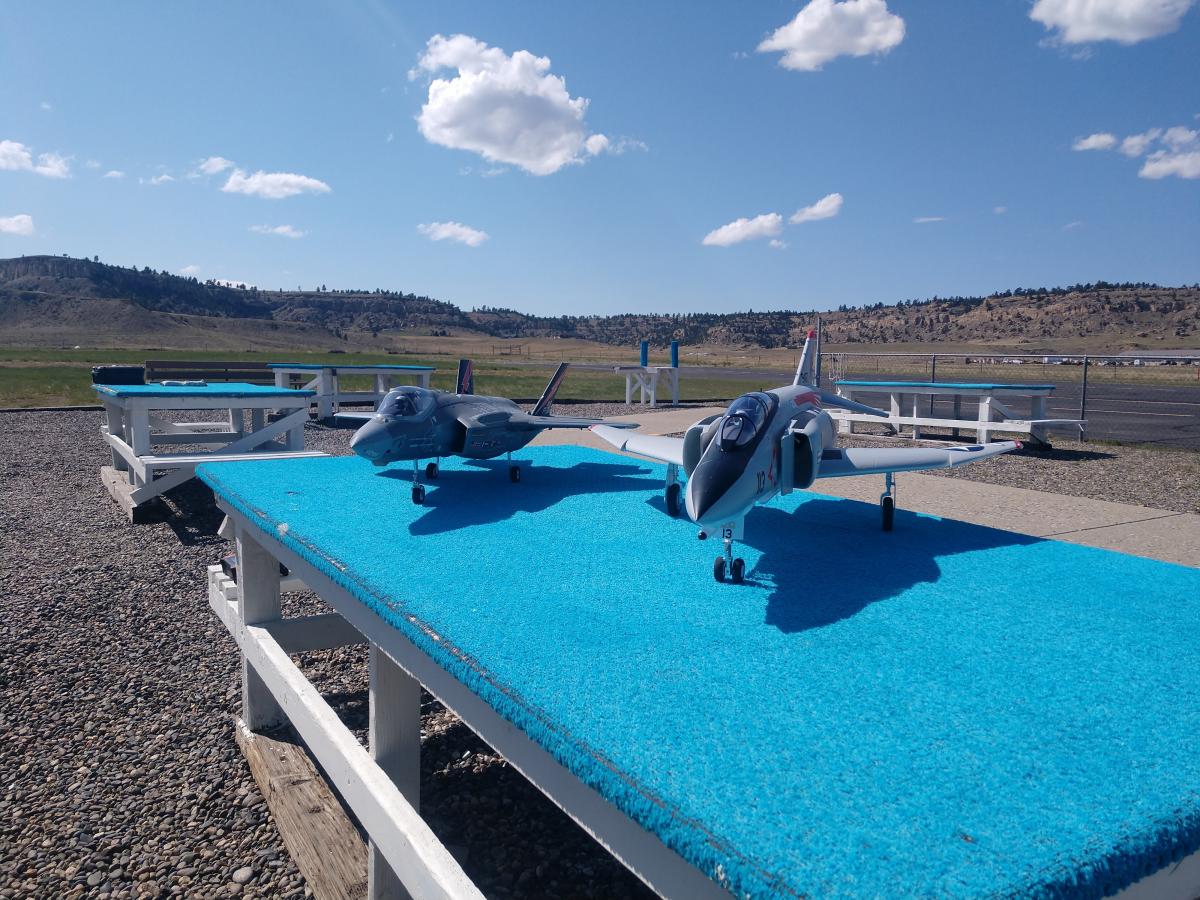

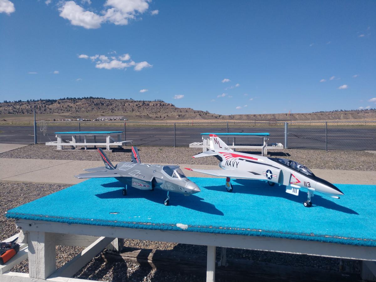

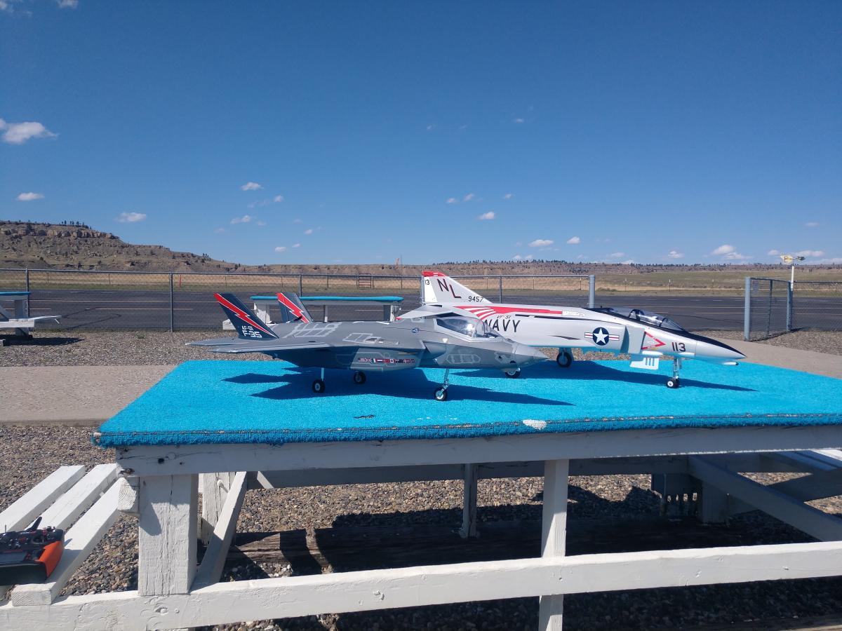

                  Here are a few pic's of my F35 Lightning sitting side by side with my new Eflite F4 Phantom from this weekend. I put a dozen flights on the F35 between saturday & sunday. I've been practicing my high alpha slow flight and landings. With the spoilerons the F35 slows down and gets into a high alpha attitude really easy. I'll try and get some more pictures & video added over the next few days or so.

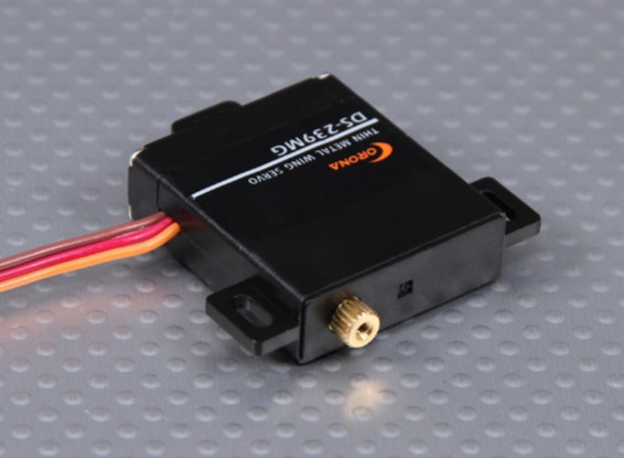

                  • Dradams2 - Are you planning to use standard 9g servos for the wingtip ailerons, or do you need some slim servos out there?
                    • Originally posted by cg7060 View Post
                      I am planning on using slim servos...
Name:	corona slim servo.jpg
                      This is not the fastest servo (.15 seconds per 60 degrees) but plenty good for my relaxed style of flying. 22g weight.

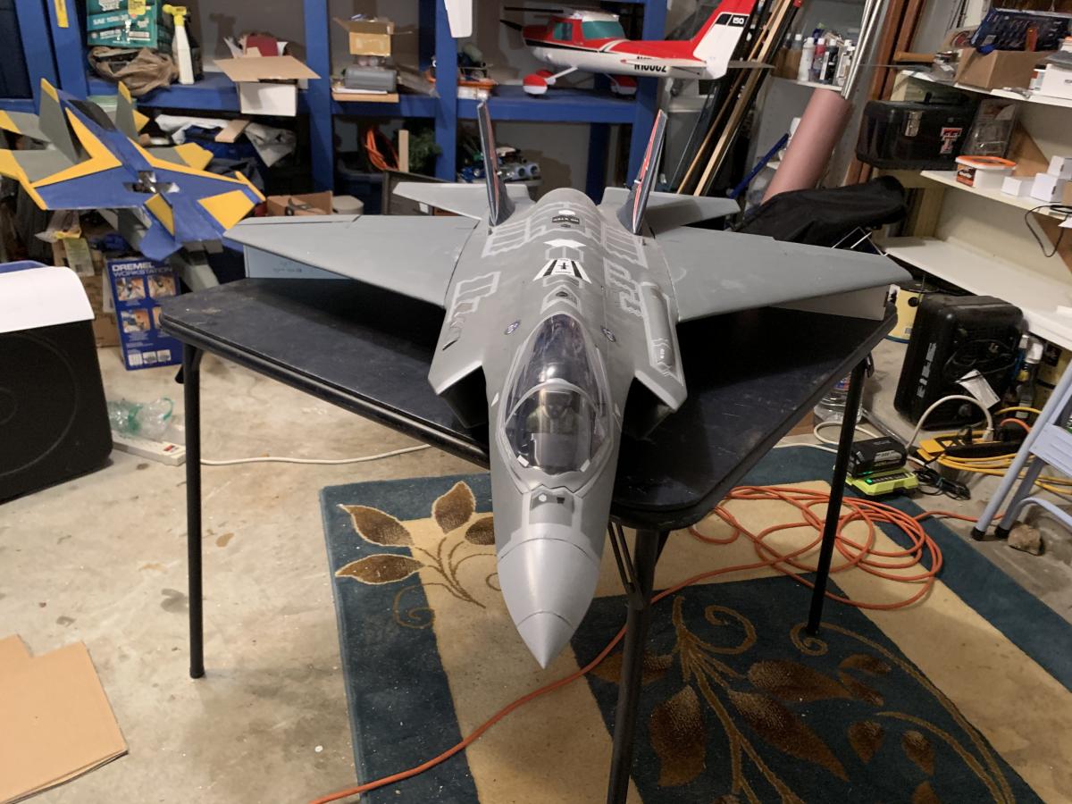

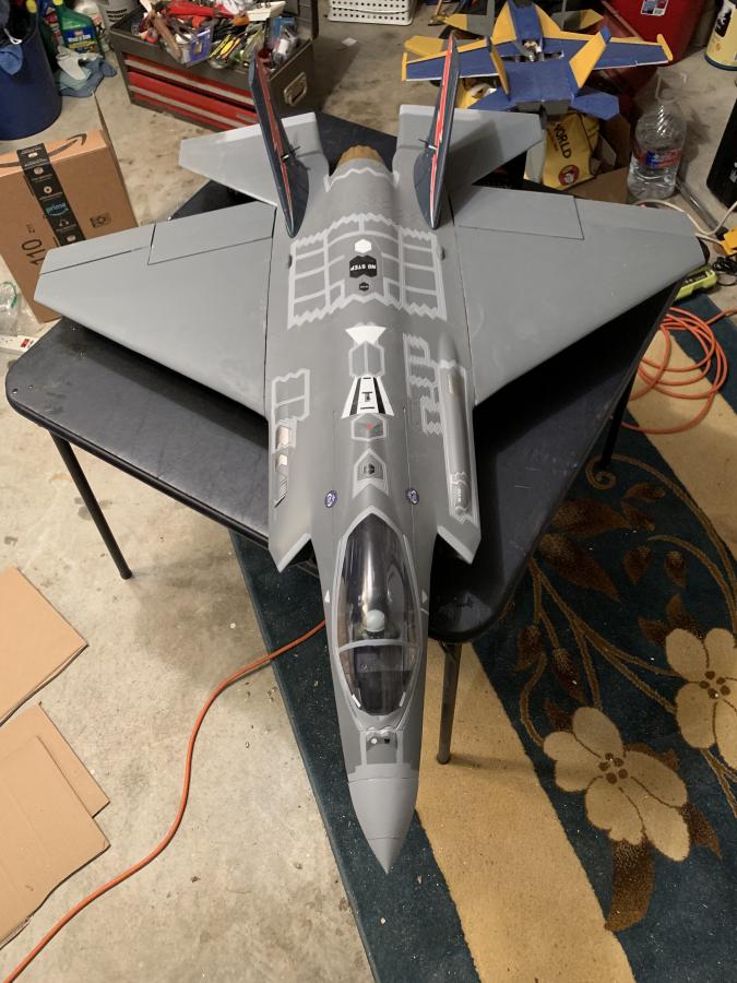

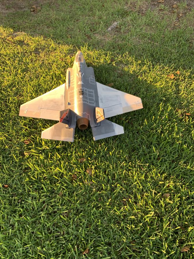

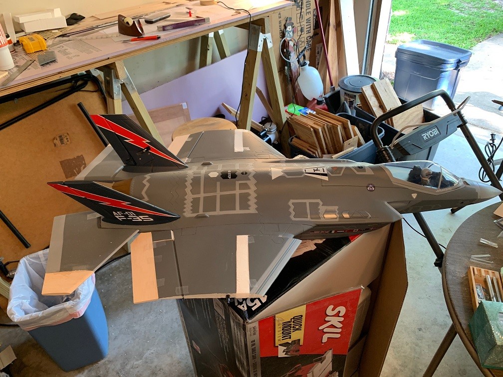

                      • Alpha First peek at overall look...🙂 Still using scotch tape to hold flaps, ailerons and elevators in position. Total weight gain 12.6 ozs at this point when servos are installed as well. I'm not sure how much the repaint will add. That's definitely more than I was hoping for so I may try to trim the weight some.

                        • Looks decent. You could probably make those wings just a little smaller to be a little more scale and that would also help with your weight issue. But really you are doing some good work here. Super curious how it's going to fly!!
                          • Originally posted by Crick3t View Post
                            Actually, the wing and horizontal stabilizers I worked hard on to make sure they were as close to scale as possible. It was fun and challenging moving the leading edge forward 1.25 inches and then setting the flaps close. The wingspan is right on scale wise. I think it will really help see it better once I get started on the painting. I'm also very curious about how it is going to fly.

                            • I suppose it just looked a little off because it's still a work in progress. Keep us posted. This is an awesome project.

                                  Sorry I didn't reply to this sooner. I am not using plans other than the dimensions I created through all of my research. I knew exactly what the wingspan was going to be (39.7") so after trimming the wing I built the extension by tracing the wing and then laying a straight edge on the leading edge to extend that line. I did the same using the trailing edge and then measured out the appropriate distance to set the wing tip line. I used the picture in my post above to figure out how I was going to do the ailerons. Looking at the picture it looks like the aileron makes up about 2/3 of the flap length (leading edge to trailing edge) so that is what I did. I made the wing extension blocks by laminating three 1/4" pieces of balsa. I recently bought a Wen table sander that has a disc and belt sander. It has been a huge help in shaping the airfoil and leading edges.
                                  I got the aileron servos installed today and as soon as I get the 17g servos from MotionRC that I ordered I will be able to finish out the wings and start painting. The scheme I am using is the one pictured above.

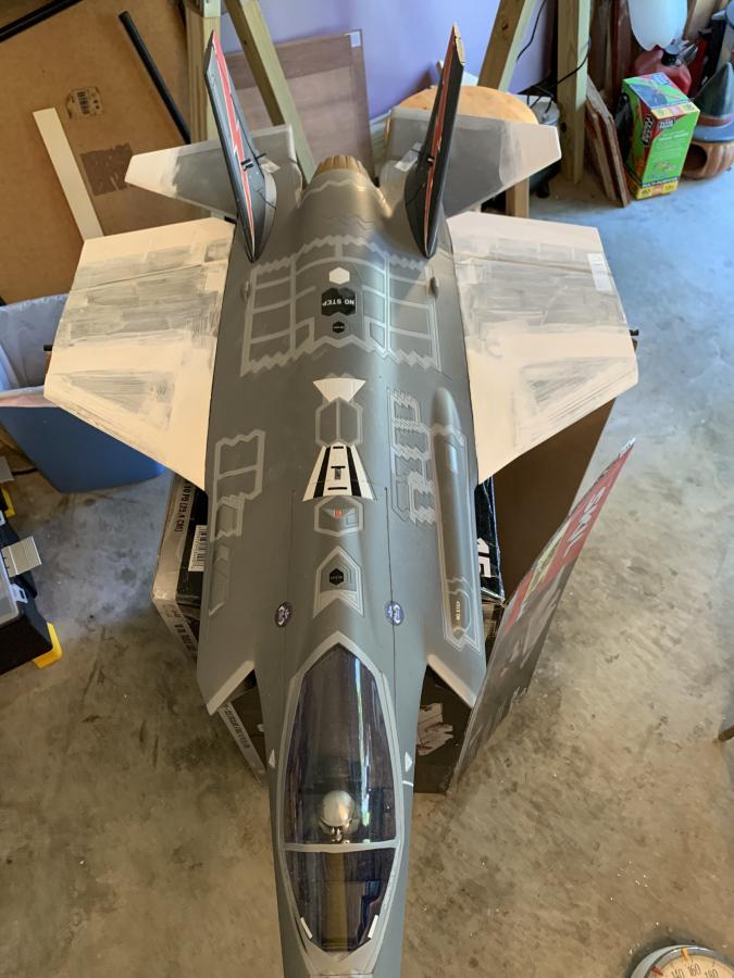

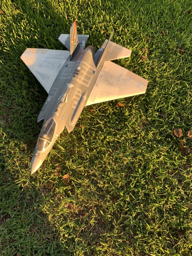

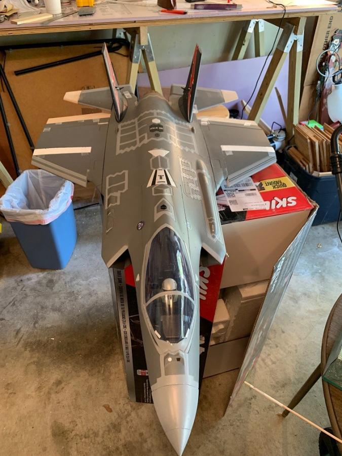

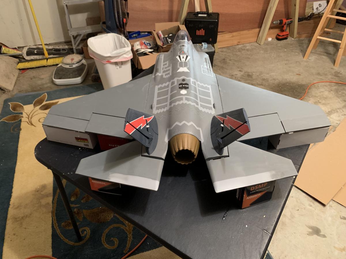

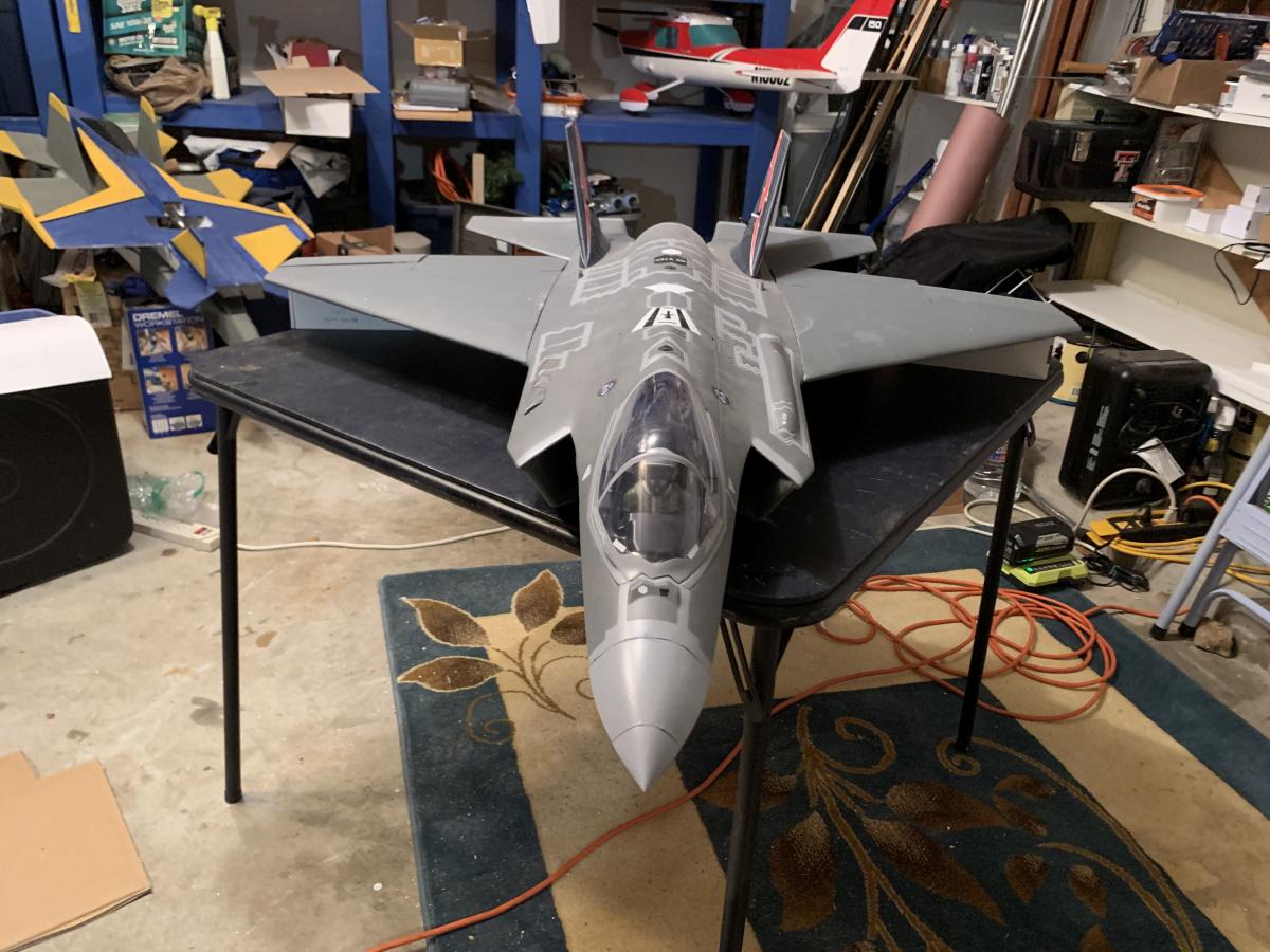

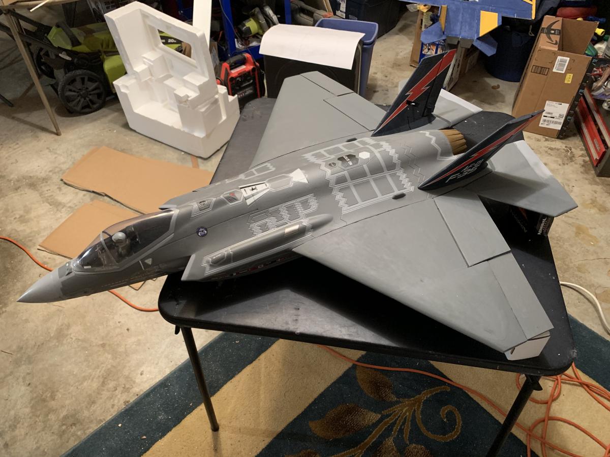

                                  • Here is some base coat painting. Found all the imperfections so will be doing a lot of sanding tomorrow. Ailerons and elevators still not connected. I am in the middle of cleaning out my garage. It's quite a mess right now.

                                    • u must realy b in lockdown ,,u have done a huge amount of work....looks impresive .... u said it was mainly 4 static display .....u r close
                                      well done
                                      • Dradams2 - things are looking really good. It does look a little more to scale now that it's painted up and not taped together =)
                                        This is pretty awesome! Really hoping we get to see video of the maiden!!
