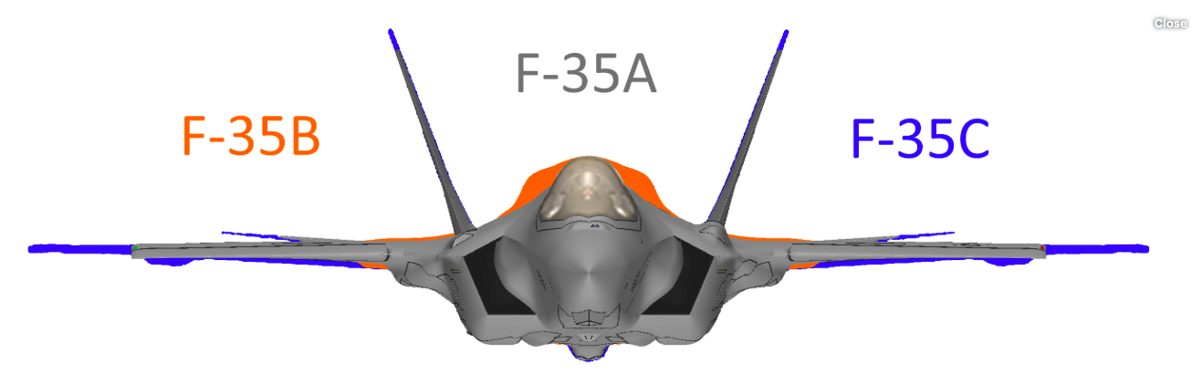

      Originally posted by Cycross

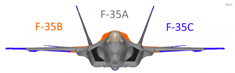

      Dradams2 - admire your scale efforts into doing the Navy version. I just got one curious question - Are you also going to do that vertical tail modification as well? The C model vertical fin is marginally taller than that of the A model.
      I didn't know there was a difference in the vertical stabilizers. I never saw any measurements or comments about that. Do you have a link for a source I can look at. I would certainly consider making the mod if I can get the measurements. Thanks for the information.
      • Cycross
        • Aug 2019
        • 6
        #703
        Below is what I can find, but it is more evident from pictures with both A and C side by side. Notice the tip profile versus that of a A variant.

          #704
          I might be able to get some measurements.
          With the wing LE being moved forward on the C version, the C verticals had to be taller to keep them exposed to clean air when flying at high angles of attack

            #705
            That is a good graphic. I hadn't seen that before. I had seen the photos where it looked like they were taller but I never could nail it down and wasn't sure if it was just the perspective of the photos but this makes it clear. Thanks. I can use this as a guide and extend the vertical stabilizers as well. I will do a "best guess" at it if I can't find the measurement since from the graphic it doesn't look like it was that much.

              #706

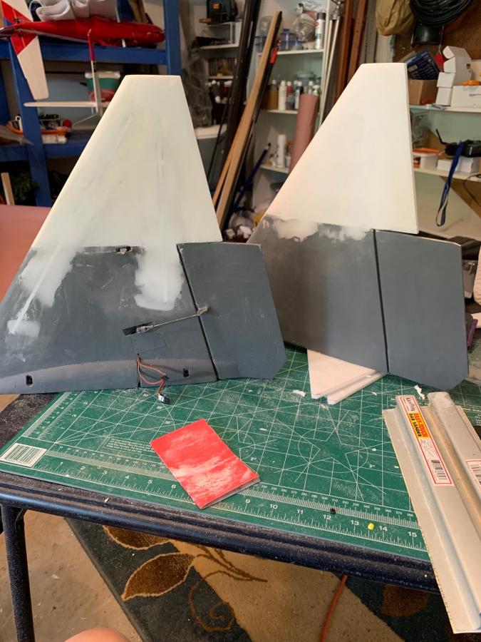

              The actual C tails are right at 13” taller, in true view.
              Given that the FW model is 1/12.85 scale, if you make your A tails 1” taller, you will be right on the money.
              the picture shows some 1/10 scale vertical tails, an A and a C, with the leading edges aligned.

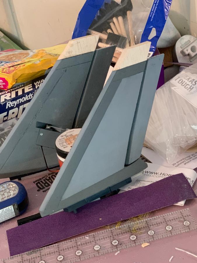

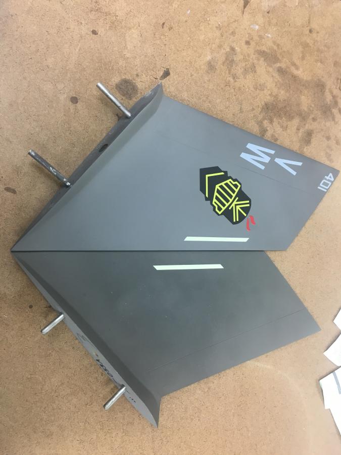

                  #708

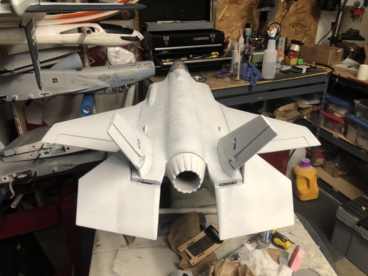

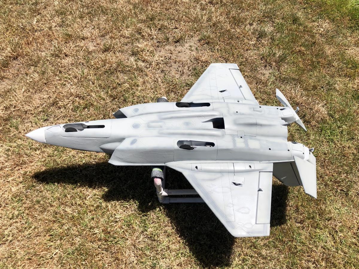

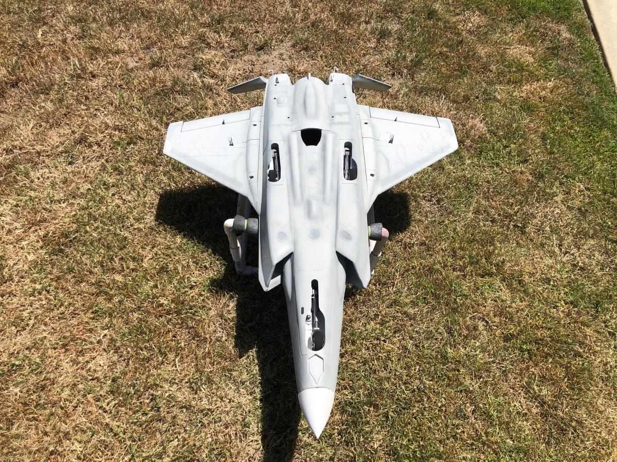

                  Okay, I had to back up a little bit and that slowed me down for a while. Once I had the balsa tips in place, painted and ready for final trimming I weighed them one more time and it was just unacceptable to me. My original F-35A wing that weighed 99 grams now weighed 295 grams, almost triple its original weight. So out came my Dremel saw and I chopped them off and went with the Model Airplane Foam that I have used for years building RC Powers park jets. I know its strengths and weaknesses and felt it will hold up for the type flying I will be doing with this jet. The rebuild cut off 70 grams of weight from each wing coming in at 225 grams. Here are three pictures of what I did. I am adding one inch to the vertical stabilizers as well.

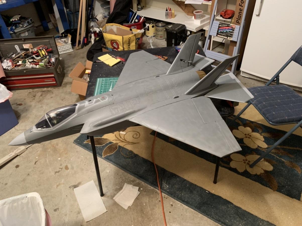

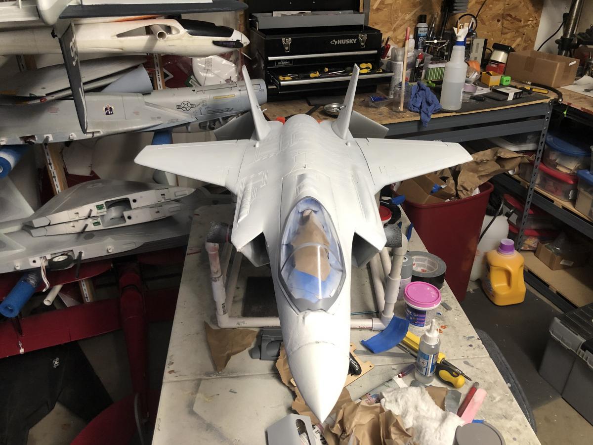

                    #709

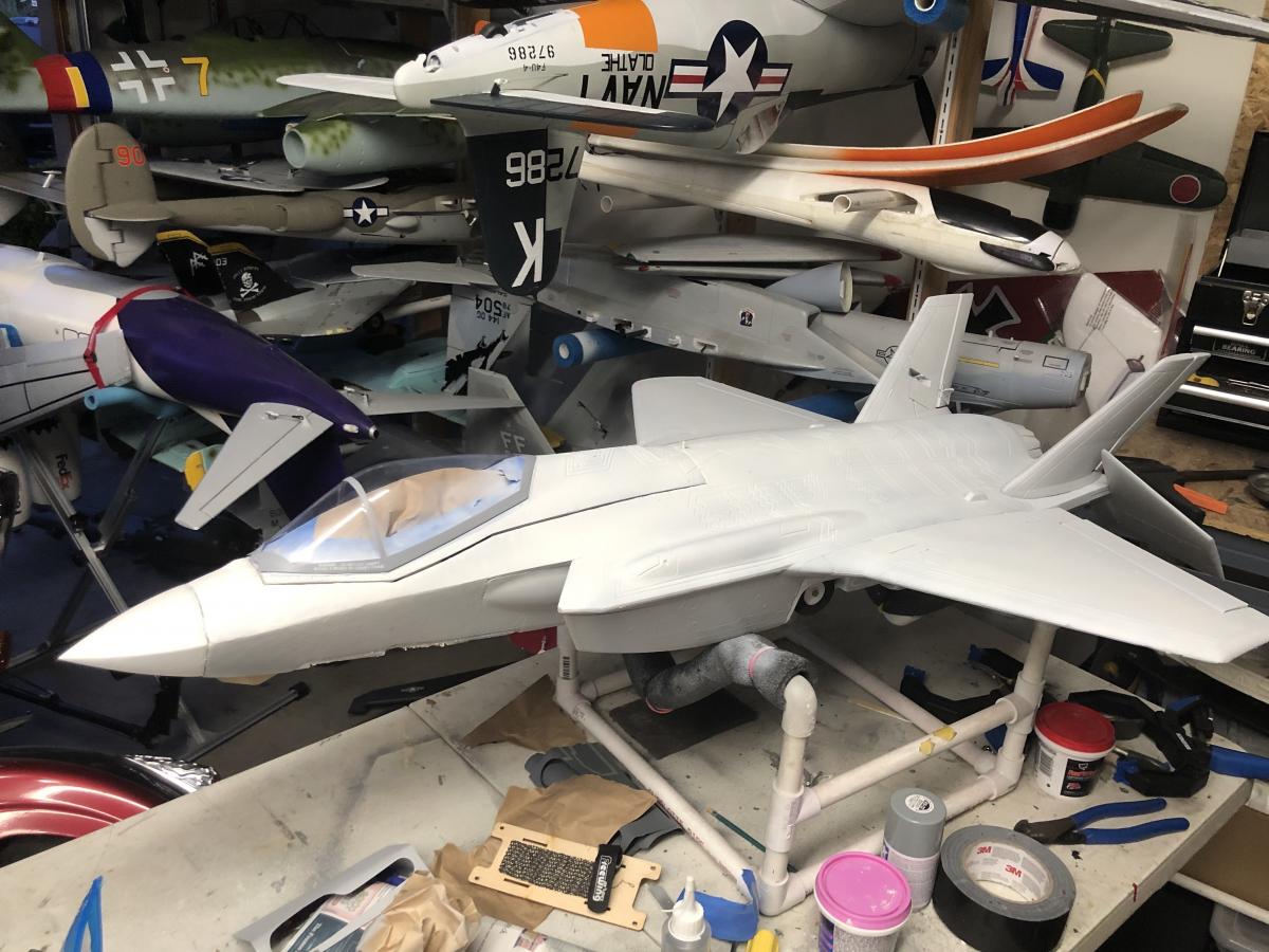

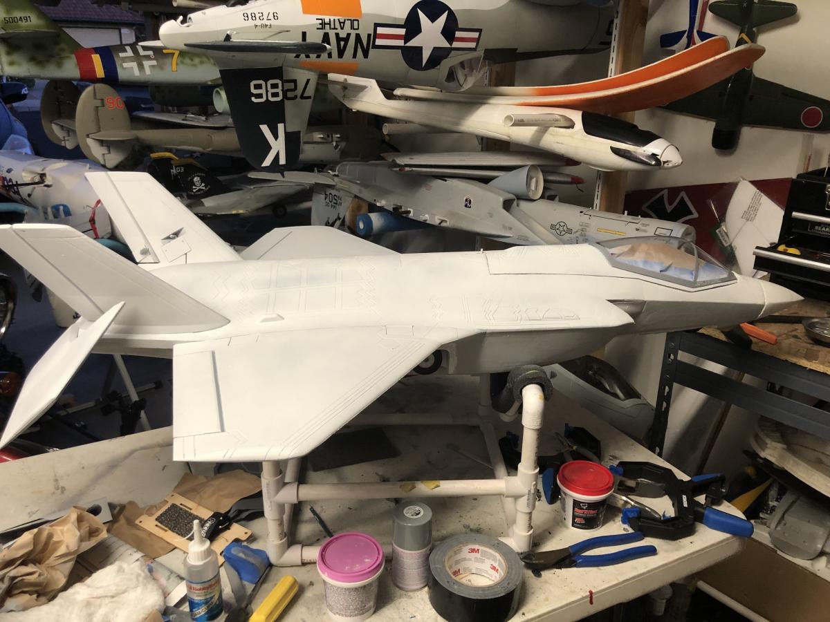

                    I have finished the airframe now. It is as close to the C version as I am going to get it. Large wing, wider horizontal stabilizers, and taller vertical stabilizers. Now I can start working on painting details and waiting for decals from Callie.

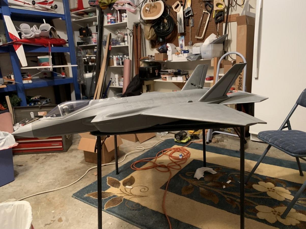

                                #715

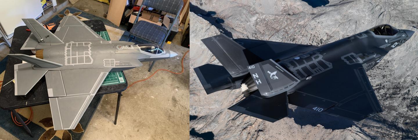

                                I got some painting done the last two days. Still a ways to go but it is getting there. Air brushed the wings, tails, and elevators and the base coat on the fuselage. I am free-handing the fuselage markings which is slow work for me. I'm not an artist. 🖌 It's still a lot of fun doing this. I have learned a lot from this for sure.

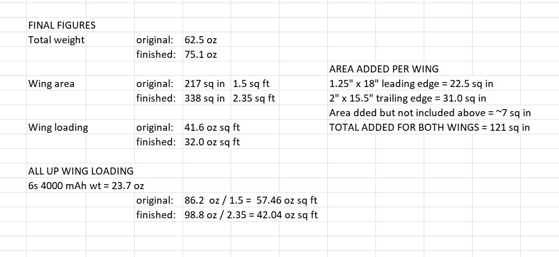

                                  #716
                                  Alpha I have the final numbers now for this conversion and I will need a little help at this point. The wing loading came in lower even with the added weight because of the amount of added wing area. As I have already said, I moved the leading edge forward 1.25" and added 2" to the trailing edge. My question is: What is this going to do to the center of gravity? Which direction will it move and by how much, if any? Thanks in advance for any help here.

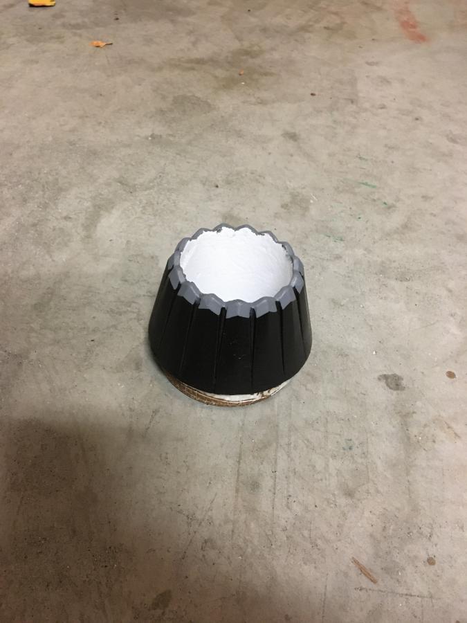

                                      #718

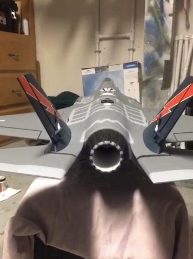

                                      Looking great! One thing I would do though is paint the turkey feathers/exhaust. I did that on my F-35 and it looks so much better. All you need to do is use a hobby knife and cut around the seam of where it meets the fuselage, and after some wiggling, it should come off easily. To paint it, I used Rustoleum Oil Rubbed Bronze (Almost a perfect match) on the outside and used the excess grey touch up paint to do the little area on the trailing edge of the saw tooth. I also used Rustoleum Flat White on the inside and sanded down both the inside duct behind the EDF unit in the fuselage, and the inside of the turkey feathers (before painting the inside of course).
                                      (the pictures make the oil rubbed bronze appear darker than in reality and sorry for cruddy picture quality)

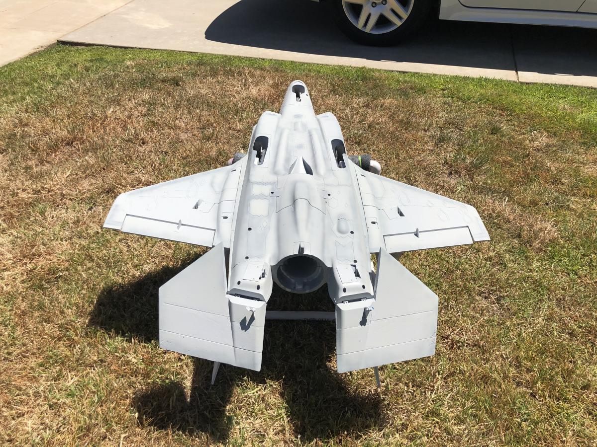

                                        Well three weeks ago I crashed my F-35. Only damage was the nose in 3 pieces and split like a banana, gear mounts ripped out as gear was down for landing.
                                        so i pieced her together with gorilla glue light weight sparkle and regular sparkle. I have primed the top white and the bottom grey. Graphics are ordered from Cali.

                                          Well got the painted and the top ready for desert camo paint.
