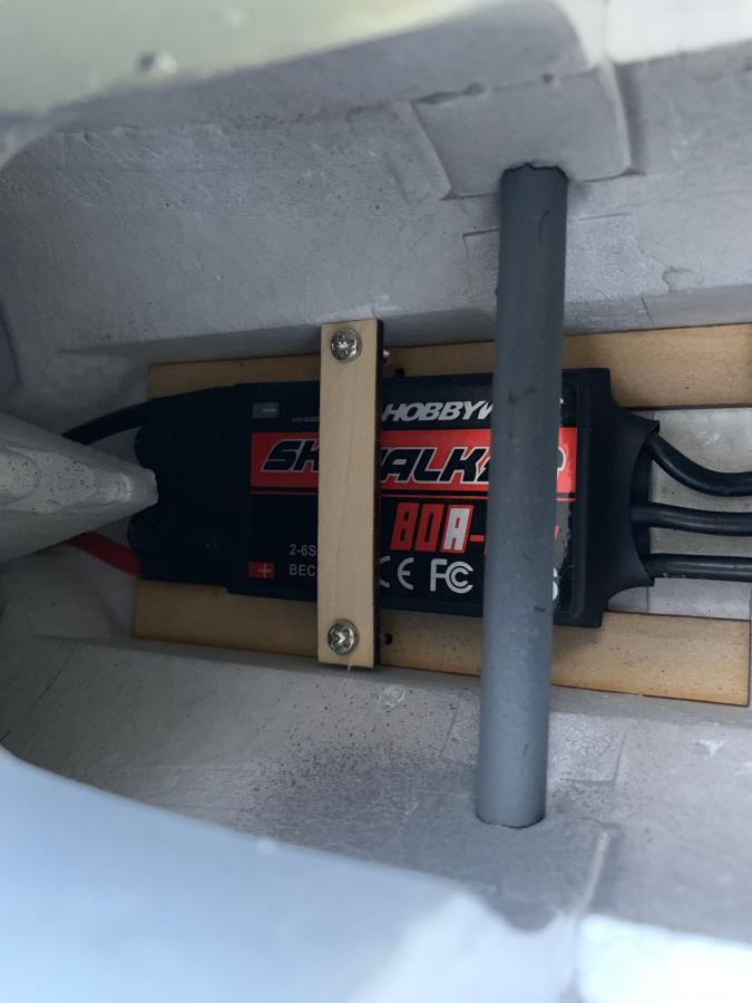

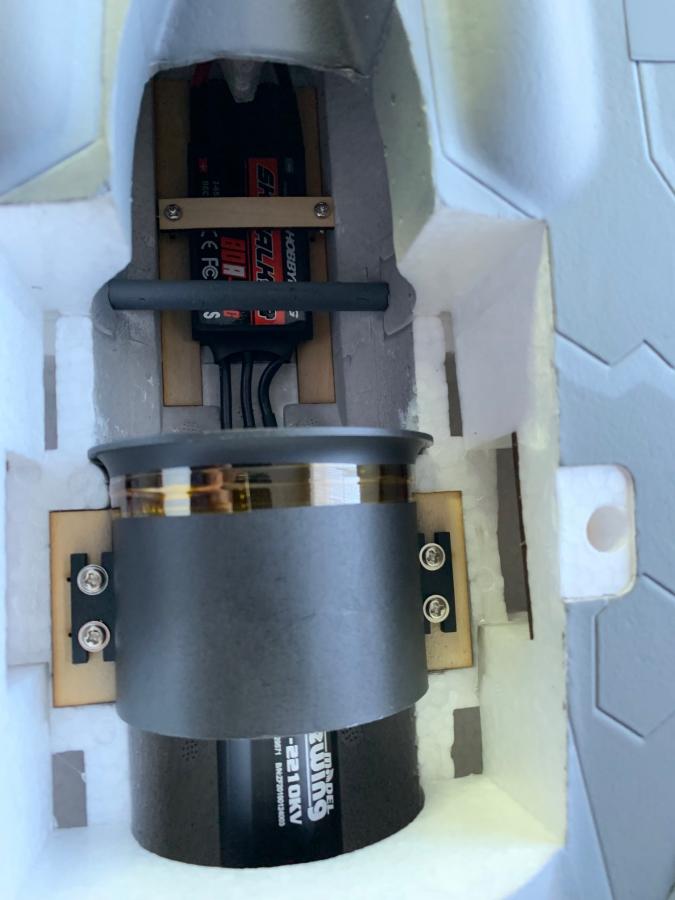

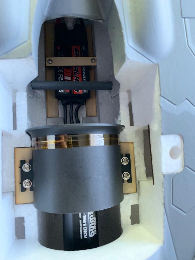

              Hi guys,
              I wanted to pass this along regarding my jet fan unit on the F-35. I have 48 flights on my F-35 now and it has been lots of fun to fly. As most of us know, the ducted fan is out of site and we do not think about checking it for maintenance. I check all the servos and linkages every flight, but never really thought about the ESC or Fan unit.
              I pulled the access cover off of my F-35 and discovered the fan screws were loose and the ESC was loose and moving back and forth. Wow, I tightened everything up and all is well. I am adding this to my check list after 20 flights.
              Hope this helps others too.
              Rich

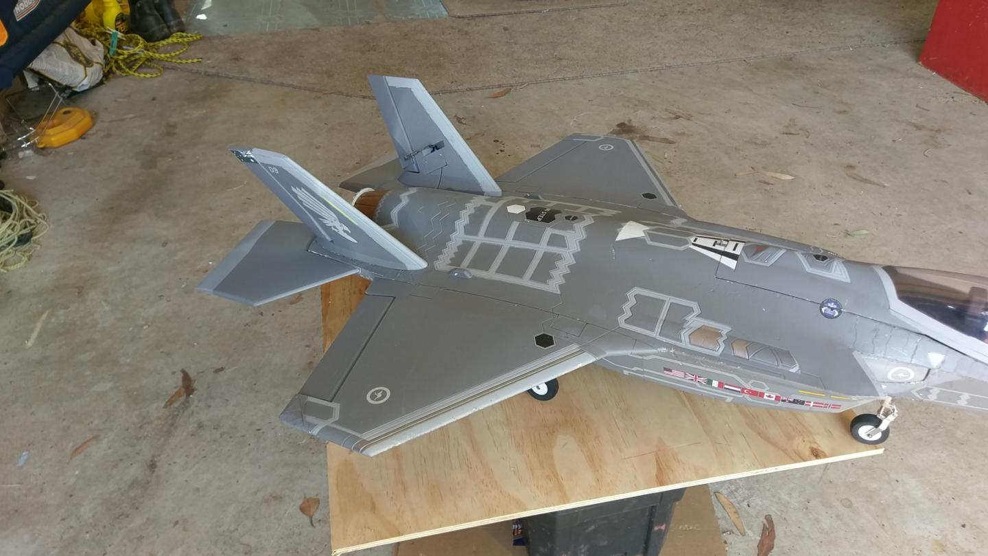

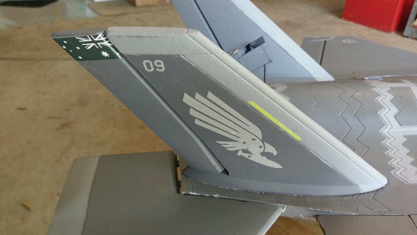

                #547
                Just a couple of pictures of my Australian insigniea from Callie Graphics
                    Here's a trick I learned from my electronics test fixturing days - apply a dab of enamel paint (or even nail polish) at the screw/flange joint to make it resistant to working itself loose.

                            #553
                            I always take out the screws that come with the kit and use a much courser drywall type screw. they hold better and don't loosen over time.

                              #554
                              That's a great idea. I put some FoamTac on the screws on my fan unit. I guess as long as your fan is balanced and you don't pick up debris into the fan blades... all is well
                              Rich

                                #555
                                Great idea... I used FoamTac on my screws which is a similar thought. Also, you need to check the plywood mounts are thoroughly glued into the foam. I found on side barely glued into place on my T45 jet.

                                  I just wanted to post something that happened recently to my airplane that could be a reminder. When I was flying the model the fan failed in flight, causing a loss of power leading to a belly landing. When you assemble the airplane and before you fly, make sure you check the fittings holding the fan on to limit the chance of failure. I hope this helps others from experiencing this same situation. Thanks.
                                      On mine, after about 45 minutes of airtime, the fan decided to remove itself from the motor shaft. Fortunately it did so on Power up while on the taxi way.

                                        #559
                                        Was it just the fan, or the fan assembly (fan, spindle, retaining nut and washer, spinner, etc)?
                                          The fan came off from the housing, along with the spinner. I suspect the retaining screw and washer loosened, causing the spinner to separate which lead to the fan coming off and disintegrating. It damaged the foam in the process of course.
