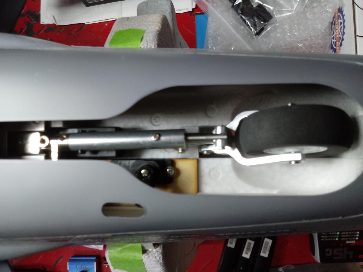

              I'm looking to mod the front gear as Stewart did in his grass ops video. He claims to extend the strut by 10mm, but there's no way. The strut pin is not long enough. Anyone know which Freewing model has a longer pin, but the same dia ? Has anybody done the mod, and how did you do it ?
                  I agree. I tried and even lowering the strut down to the end of the flat spot, I'm not getting more than a couple of mm and if you don't find a way to keep it there, each landing or bump in the ground will bump it back to where it started. I think the idea is to find a longer pin, grind a new flat and use a spacer, but is there enough space in the wheel well if the tire is 10mm further to the end of the compartment? I haven't looked closely enough.

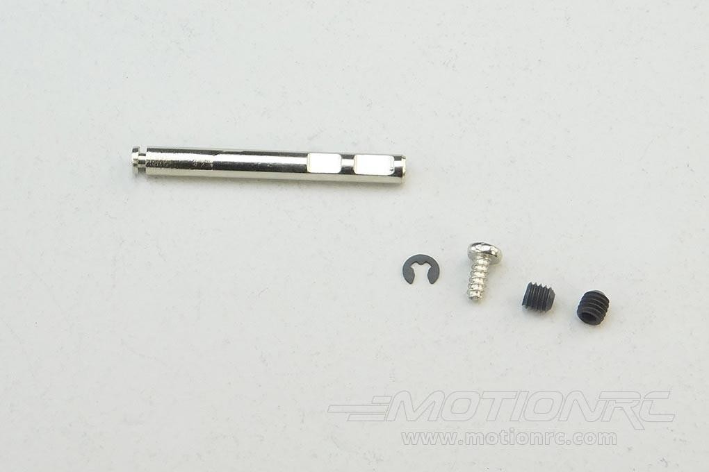

                        Maybe this one for the F22 would work?
                        https://www.motionrc.com/products/fr...connecting-pin
                          The link you have is for the pin for the A-10. I actually have a couple of those but have not measured them to see if they are any longer than the F-35 one. They're buried in my huge pile of parts and I can't go search for them at the moment. Otherwise, I'd go and measure one and compare to the F-35. Maybe tomorrow.

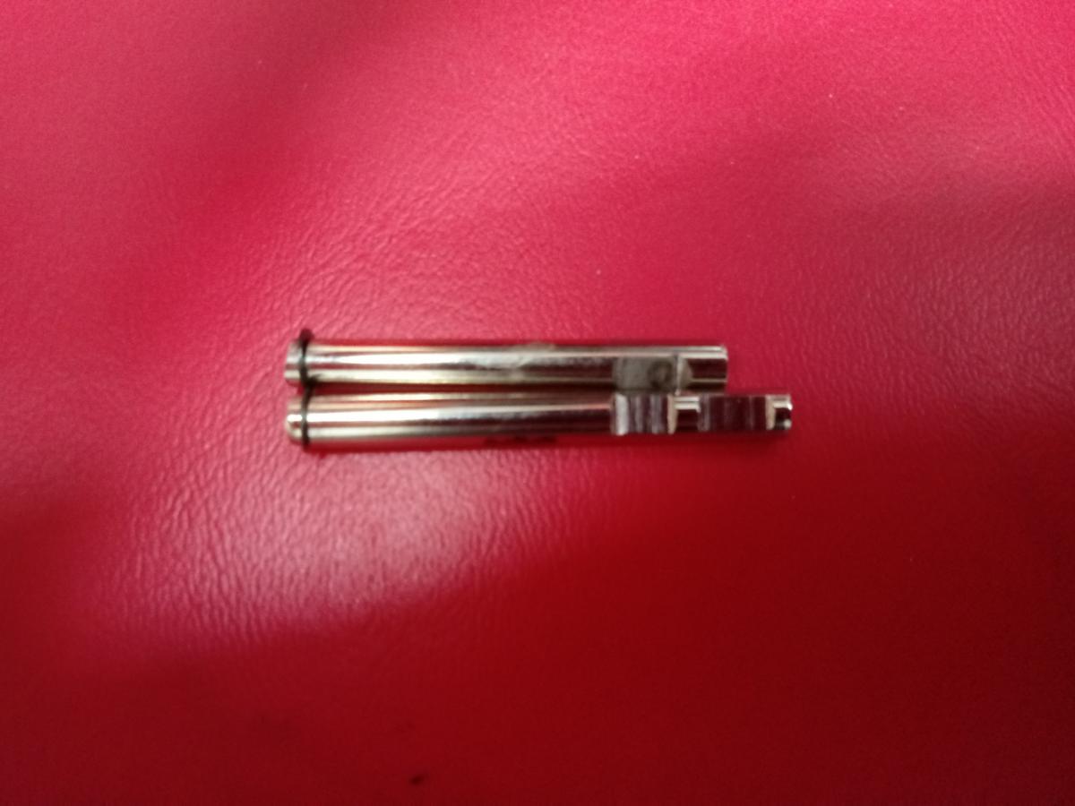

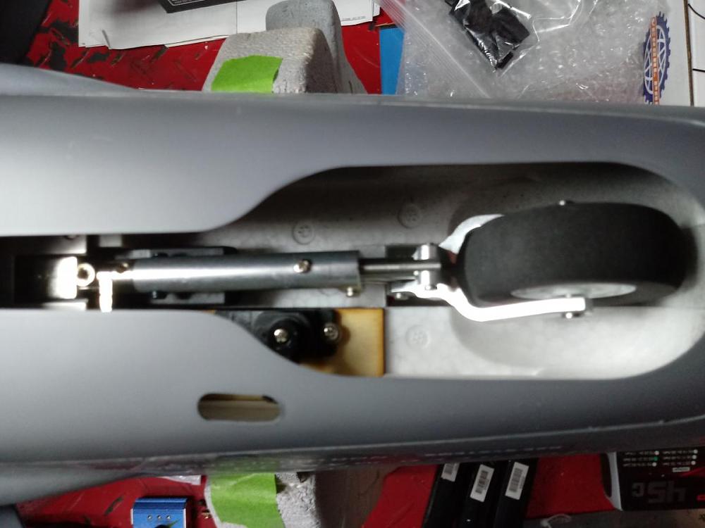

                            Well, I worked it out. I found a spare pin from my stinger 90, and it fits the f35 trunion perfectly. And the length is just right. In fact it gives me more than I need because of the limit of the wheel well. I have it set up so the nose wheel is about a 32nd away from the wheel well in the retracted position. Works great, and wound up with 6mm total extension from stock. So there's no way that Stewart got 10mm without carving the well.

                              Stock pin, and stinger 90 pin. I did have to grind another flat spot for the steering tiller.
                                    Yes, one of the reasons I said to look at this one...…. because it is also used in the following Freewing/FlightLine RC aircraft
                                    • Freewing F/A-18C Hornet
                                    • Freewing 90mm F-22 Raptor
                                    • Freewing F-4D Phantom II
                                    • Freewing 80mm A-10

                                      The stinger 90 pin is a perfect fit and length. I put a wheel collar between the strut and tiller arm and it works great. Click image for larger version

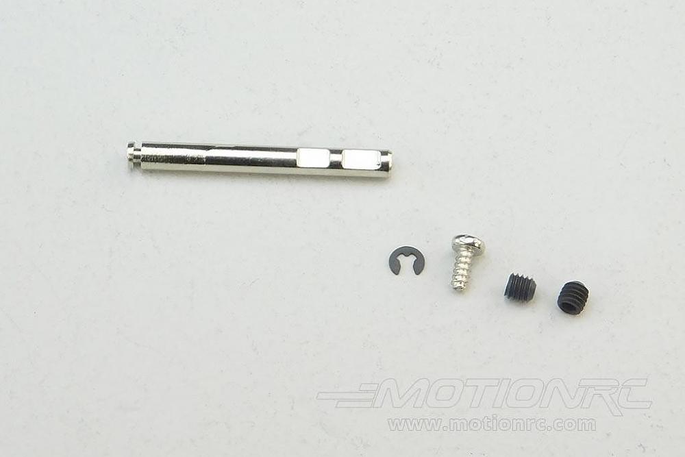

                                        Here is the link to the Stinger nose pin
                                        Click image for larger version  Name:	freewing-stinger-90-nose-landing-gear-connecting-pin-motion-rc-26234755596_1024x1024.jpg Views:	0 Size:	50.5 KB ID:	208901
