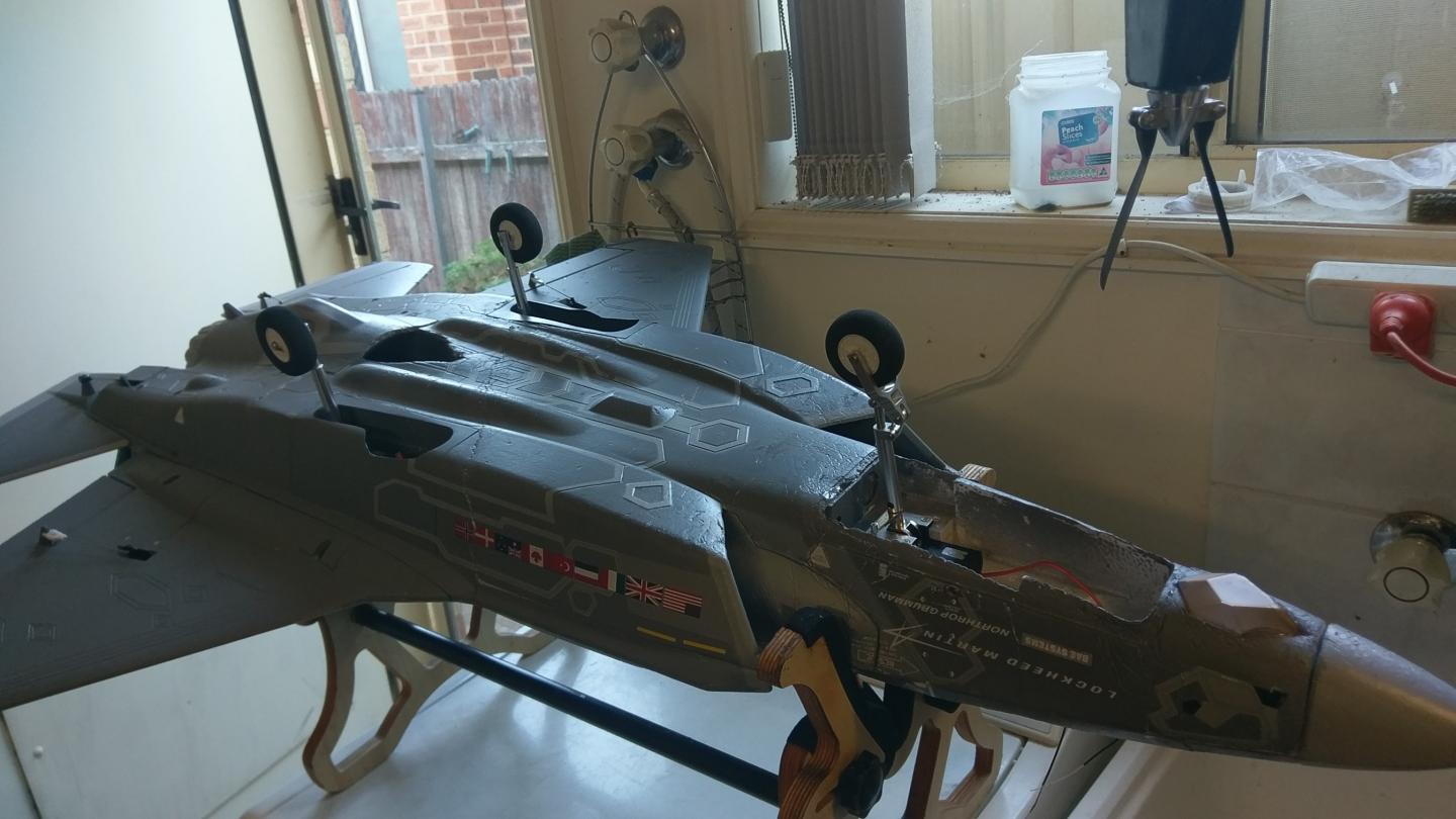

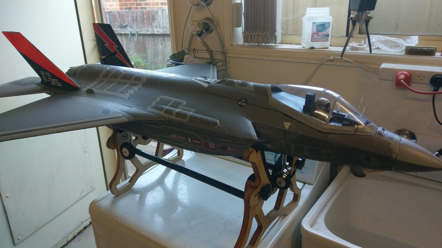

        OK the repairs are done lucky there was no damage to the flight surfaces and fixings for the next time I will set the CG a little bit more forward and of course reduce the travel throws but high rates on the elv will be there so I can get it off out grass strip I will also up the Expo it doesn't look too bad but certainly not pristine

              Pics

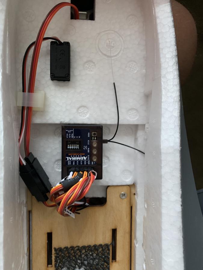

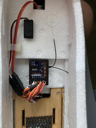

                                          I remounted my Admiral 600SP receiver and set up the gyro. I have about 30 flights without using it. I set this up in mode C on a 2 position switch to let me turn it off. Hope to fly tomorrow and check out some high alpha’s :)
                                          Click image for larger version  Name:	F2EA36F5-E8BF-499B-A97A-D9728CEEC127.jpeg Views:	0 Size:	61.2 KB ID:	209670
