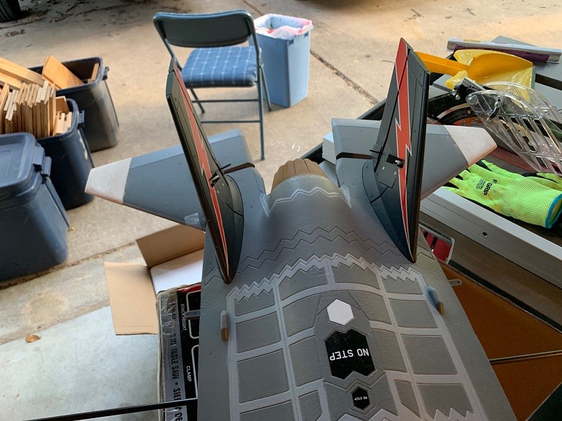

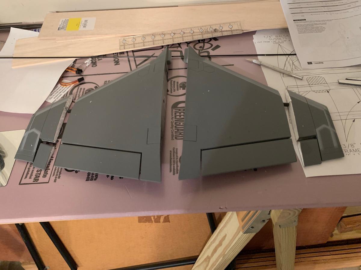

                      Got my F-35 in and started putting it together. The wings look a little weird though. Got a long ways to go because I don't think the scotch tape will hold up for long. 🙂
                        What exactly is on your wings in the picture? Are you masking off for painting?
                          Where's the end of your wings?

                            Here they are. Still a long ways to go and the tricky stuff is coming next.

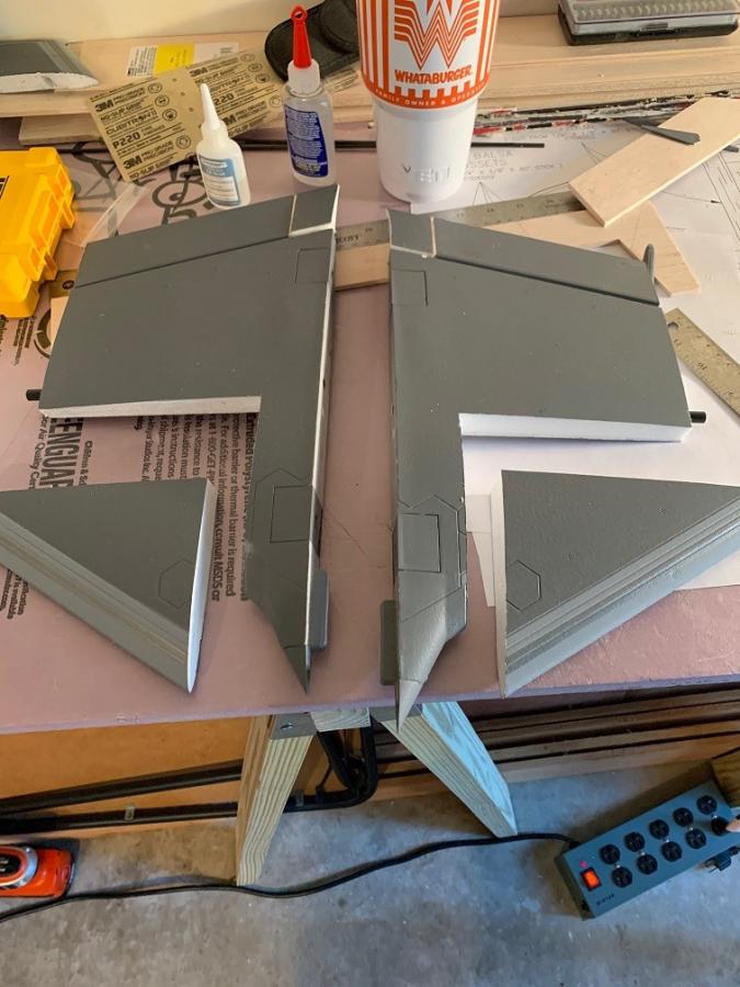

                                Did I miss your post about why you lopped off the wing tips? I'm curious what you're going to do.

                                  #676
                                  dradams2 - what are we doing in these pictures? Wing tips have been cut off, strange note cards taped to the wing. What did we miss here?
                                  Can you explain this project and hacking up the wings? I think i can speak for all of us when i say we are curious what you are doing.
                                  Cheers!

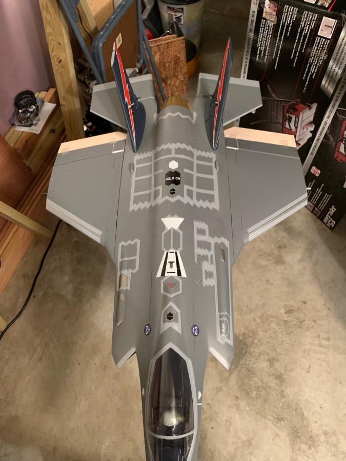

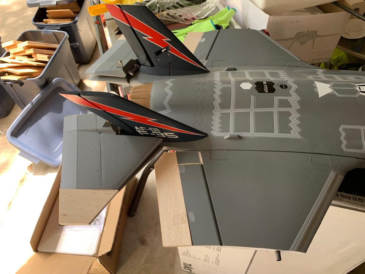

                                    Oops. sorry. Does this help a little. I just laid the elevators on top of the existing one so you could see the modification I am doing. I am not going for true scale but close. I am converting my F-35A to an F-35C.

                                      dradams2 I've been waiting for someone to do this conversion! Thanks for sharing your process and progress!

                                        #679

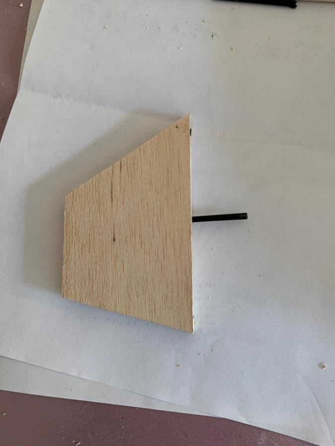

                                        A fun conversion. F-35C CF-01 tail markings would give a little extra visibility, as it did for the AF-01models.
                                        ​​​​​​One observation on your balsa horizontail tail extentions. Always a good idea to run the grain of the balsa parallel to the leading edge of the surface or to run it spanwise, instead of cordwise. Too easy to break off the tips when the grain is cordwise, even if you have some thin ply laminated between layers of balsa, a carbon rod added, or even when covered with light glass.

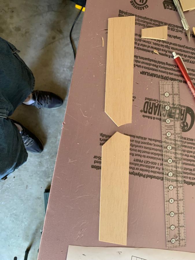

                                          I just did the major wing cut. I will be inserting a 1" block where the cut is to move the leading edge 1" forward. I will be messing with the airfoil some here but hopefully not too much. Lots of carbon fiber rods going in for strength.
Name:	IMG_6327 small.jpg
                                          I also did some sanding on the elevators so you can see better what I am doing to them.
Name:	IMG_6329 small.jpg
