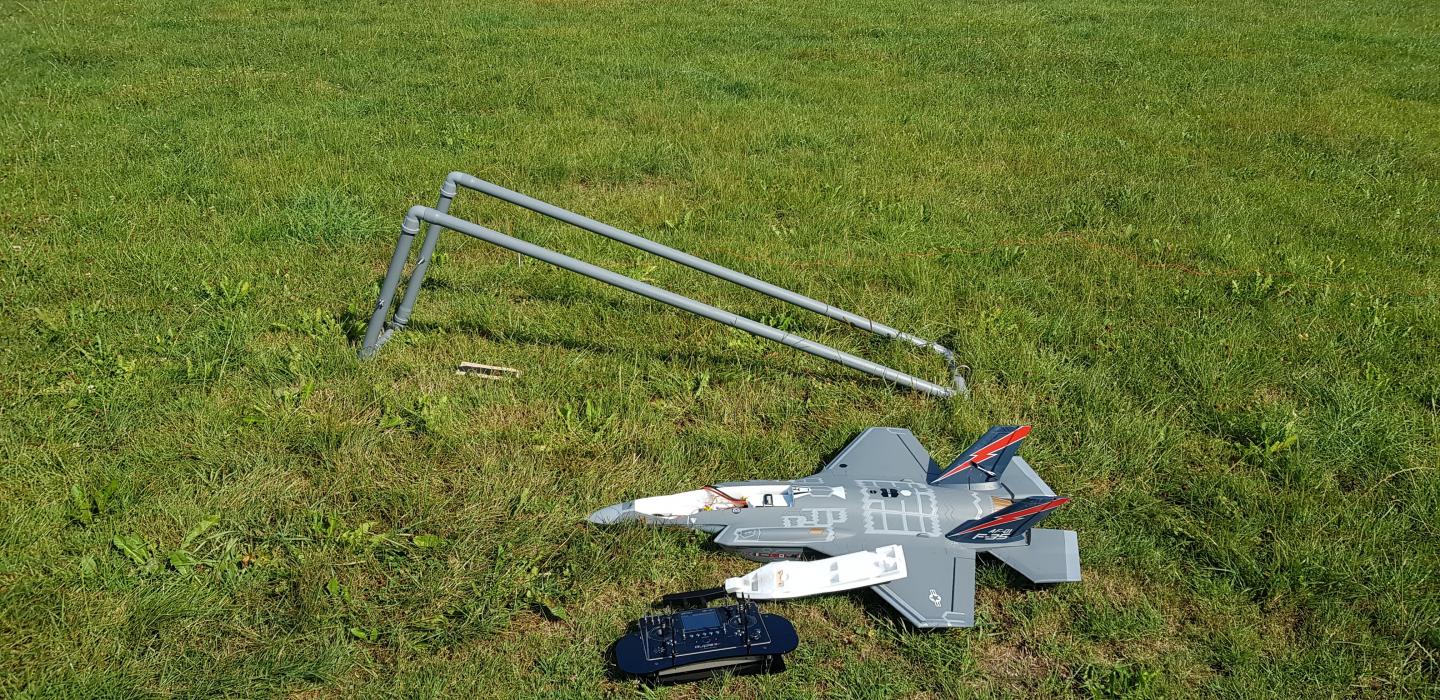

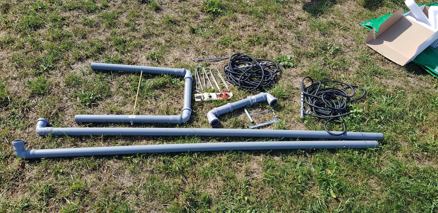

    Can you put up a picture of your bungee set-up one of these days? I've thought about this myself for a few of my "more difficult to grass take off" planes. However, my car is usually pretty full already with planes to find another spot to put all the gear required for this apparatus. Additionally, the grass field I fly at isn't convenient to leave a bungee set up on the runway as it interferes with others using it. The thought of carrying, assembling, installing, disassembling and packing it away in the car again each time, just turned me off the whole idea. I've even thought of modifying a spear gun for launching a couple of my planes.
    Sure. I am going to fly tomorrow morning and will take some photos for you.
    It is actually a pretty simple construction for the ramp itself: Just a few water pipes that can be linked easily by pushing them into their joints. It is anchored by metal hooks. The bungee connection is a little bit more complicated in order to have a tension-free release and almost no tension on the model until release. All in all it usually takes me about 10 minutes to assemble the entire system including the bungee.
    We usually place the ramp and bungee parallel to our main runway about 3 feet next to the runway. This way it does not interfere with the runway at all and can stay assembled for the entire day.

          #504
          As promised the photos. One with all the parts, the other one assembled and ready to fly together with the F35 for size comparison. The next flight, I will take some photos of the release mechanism.

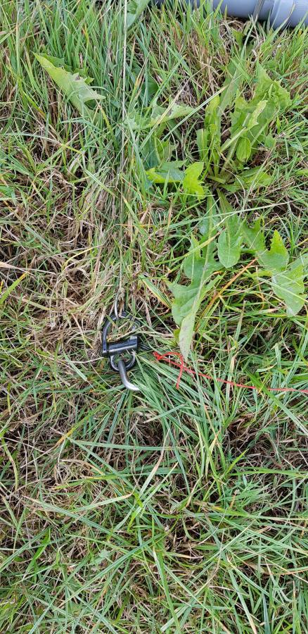

            #505
            Attached the photo of the release mechanism. It consists of a shackle (in black on the photo - hard to see) connected with a red rope that has a loop on the other end. So, whenever the rope is pulled using one foot, the shackle opens and releases the rope that is connected to the bungee.

              Thanks for those pictures. How long is the bungee part when it's all stretched out?
              • Quax
                • Jun 2019
                • 77
                • Bergisch Gladbach, Germany
                #507
                Depends on the weight of the model of course. I use bungees that need to be stretched about three times its length (my planes are around 2-3kg (4.5-6.6lbs) so I use a pull of 15kg (33lbs) or five times or more of model weight.
                The bungees are 7.35m (24.1ft) long, so 3x stretched it is about 22m (72.2ft) plus a single rope (about 5m or 16.4ft) from the bungee to a joint where two ropes are used: One about 2m (6.6ft) to the release shakle and another longer one to the model. So in total it is usually around 30m (98.4ft). Which is a little more than half of our runway length. As said before, we place the system about 3ft parallel to the runway so it will not interfere with the runway (of course nobody should walk exactly next to the bungee whenever it is under tension but that is usually just a very short period of time).
                I hope that helps.

                    #509
                    I usually put the two long pipes as far as possible on one side and the other parts below all models. The smaller parts (hooks, ropes and bungees) fit all in one single small bag.

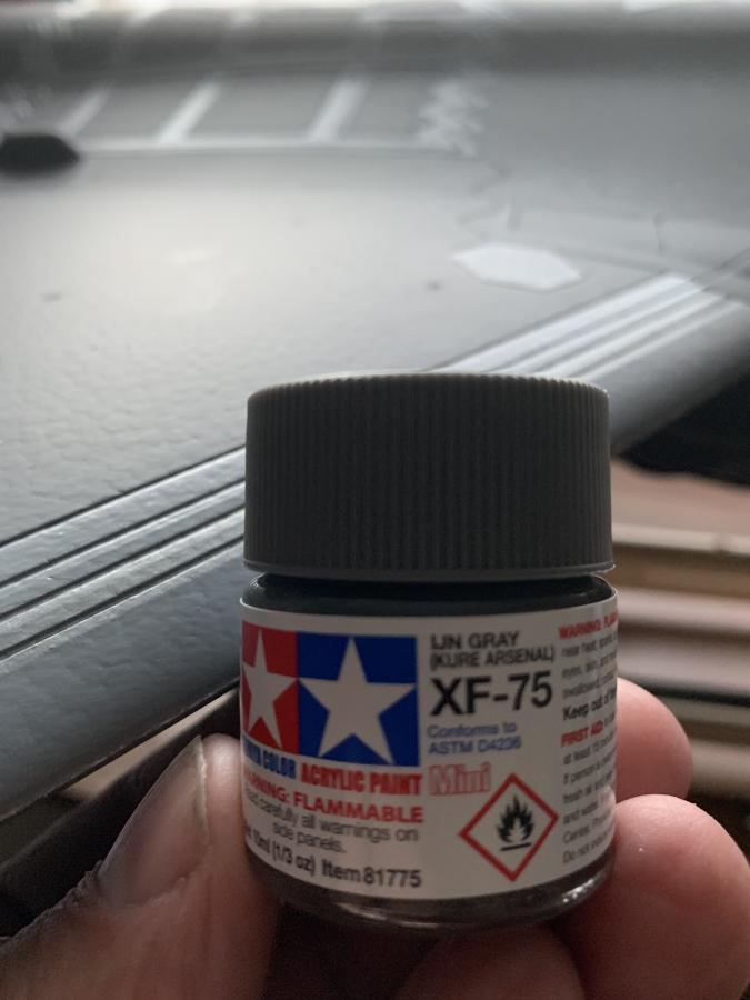

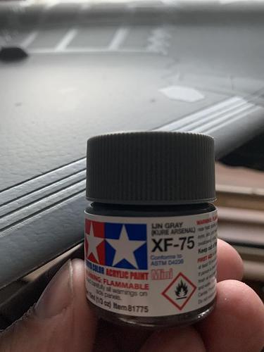

                      Originally posted by Aussie1
                      Guys, would anyone know what a colour matching paint for the dark grey is on the F35? Preferably a Taminya colour code. Thanks!
                      I needed to touch up my lower wingtips :)
                      the dark gray is a very close match to Taminya XF-75 Click image for larger version  Name:	83037B6E-00E3-44E4-9F8D-BFDD2E0ACE38.jpeg Views:	0 Size:	49.6 KB ID:	210287
                          Thanks, I went out and bought a can, very close!
                                I am glad it worked out for you. Sometimes its so hard to find the right color..... If you are like me, I have many other colors of gray on the shelf, so you can always tweak it a bit if needed.
