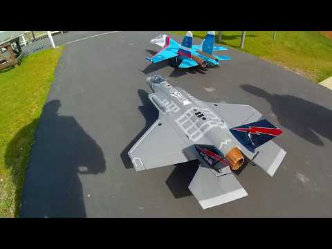

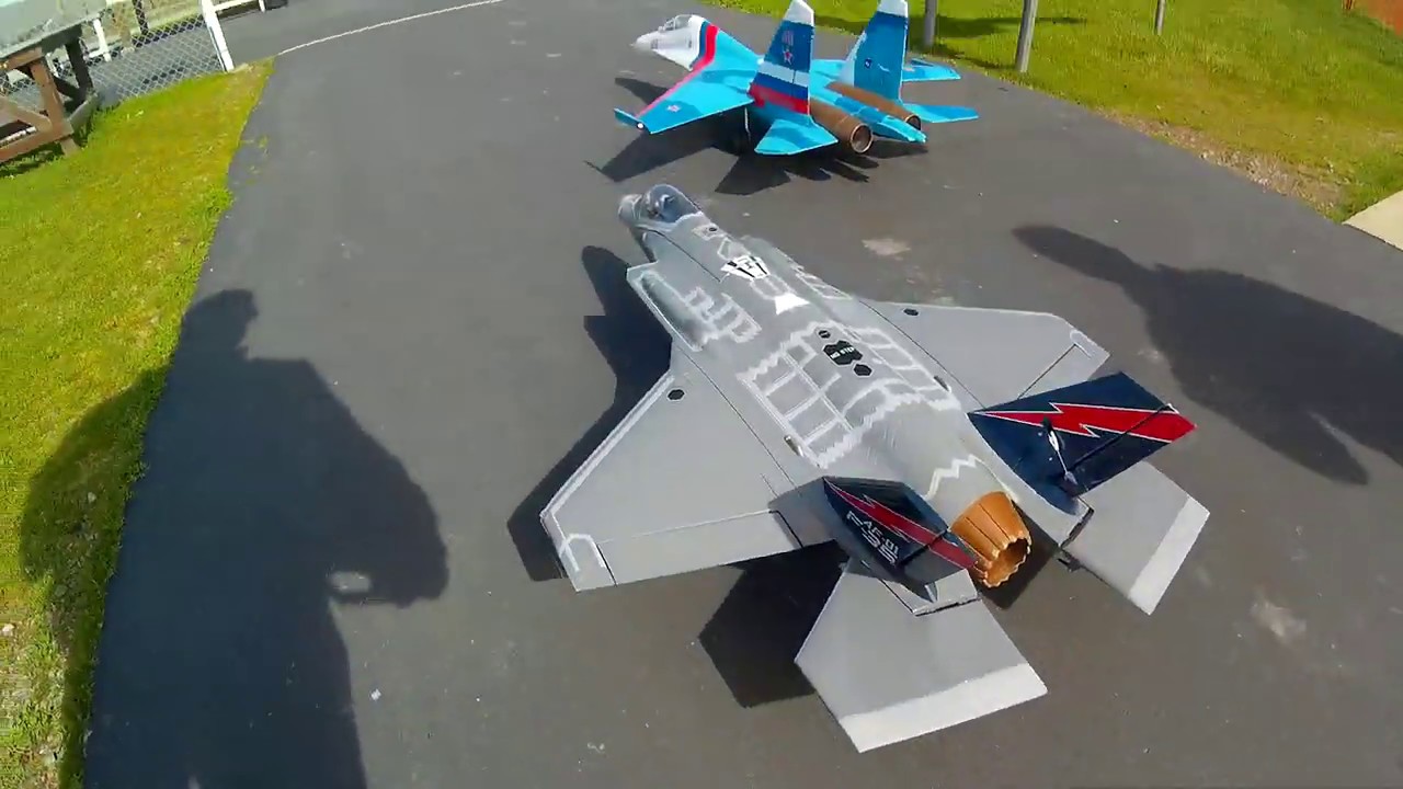

              I haven't posted here in a while but got a couple to share from my last outting at Crows Landing. I have settled on the 6s 30c 5000mah as my go to pack for this plane! Its the best combo of weight, punch and flight time. Yes I have flown with other packs, 40c and 65c Black series, as well as a lighter 70c 4000 pack... None of them perforned as good as the 30c 5000... sticking with that!! I did a 3 min full throtle flight and battery came down barely even warm with 3.8v per cell!! I still could have flown a little longer if I wanted!! take a look at the flights..
              here is a flights of me chasing my buddies Su-30. I think I surprised him with the speed of this lil thing!!

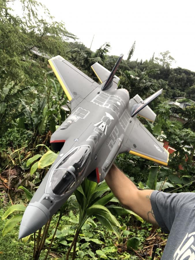

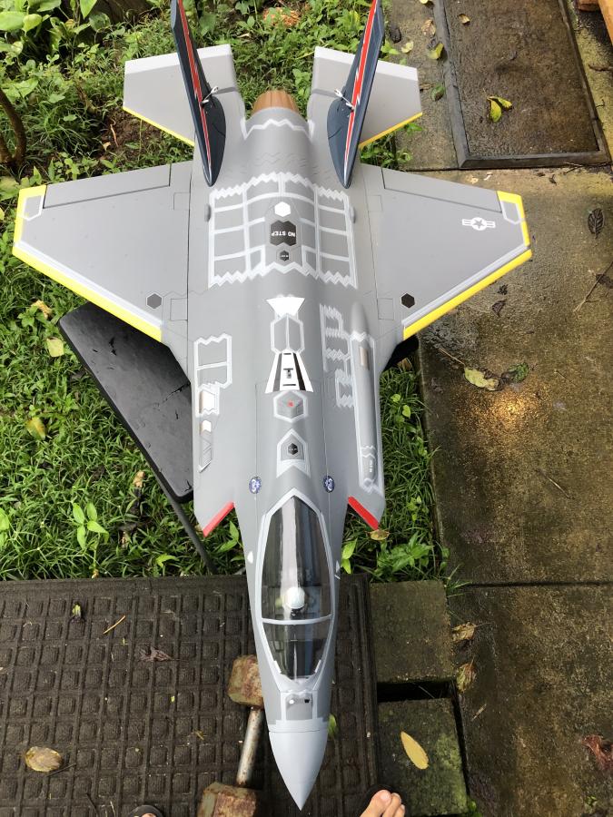

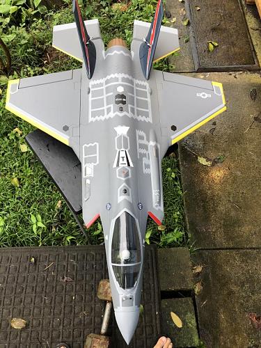

ID:	243033Click image for larger version  Name:	A2A89B3C-83C8-4696-8B66-1E6745DDC126.jpeg Views:	0 Size:	293.0 KB ID:	243031Click image for larger version  Name:	2A90699F-9113-4A52-A286-BB0E10AA9015.jpeg Views:	0 Size:	137.5 KB ID:	243030Click image for larger version  Name:	0894F911-619C-4AC7-96F6-7BE54B5D92EC.jpeg Views:	0 Size:	122.0 KB ID:	243029​ ​ ​ Love mine! Had to add some color....she will stealth out on you if you let it lol! ​

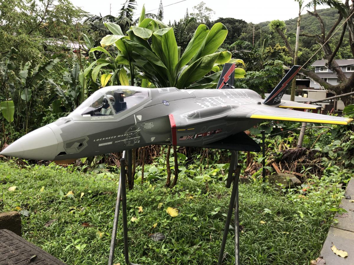

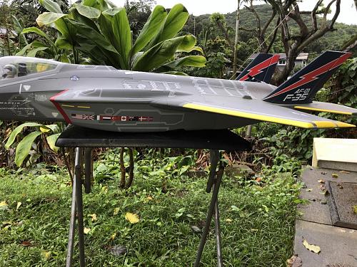

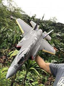

                        #611
                        Added pics😂
                        what.....no imagination?????😂Sorry I was trying to add them during the storm must not of got done obviously

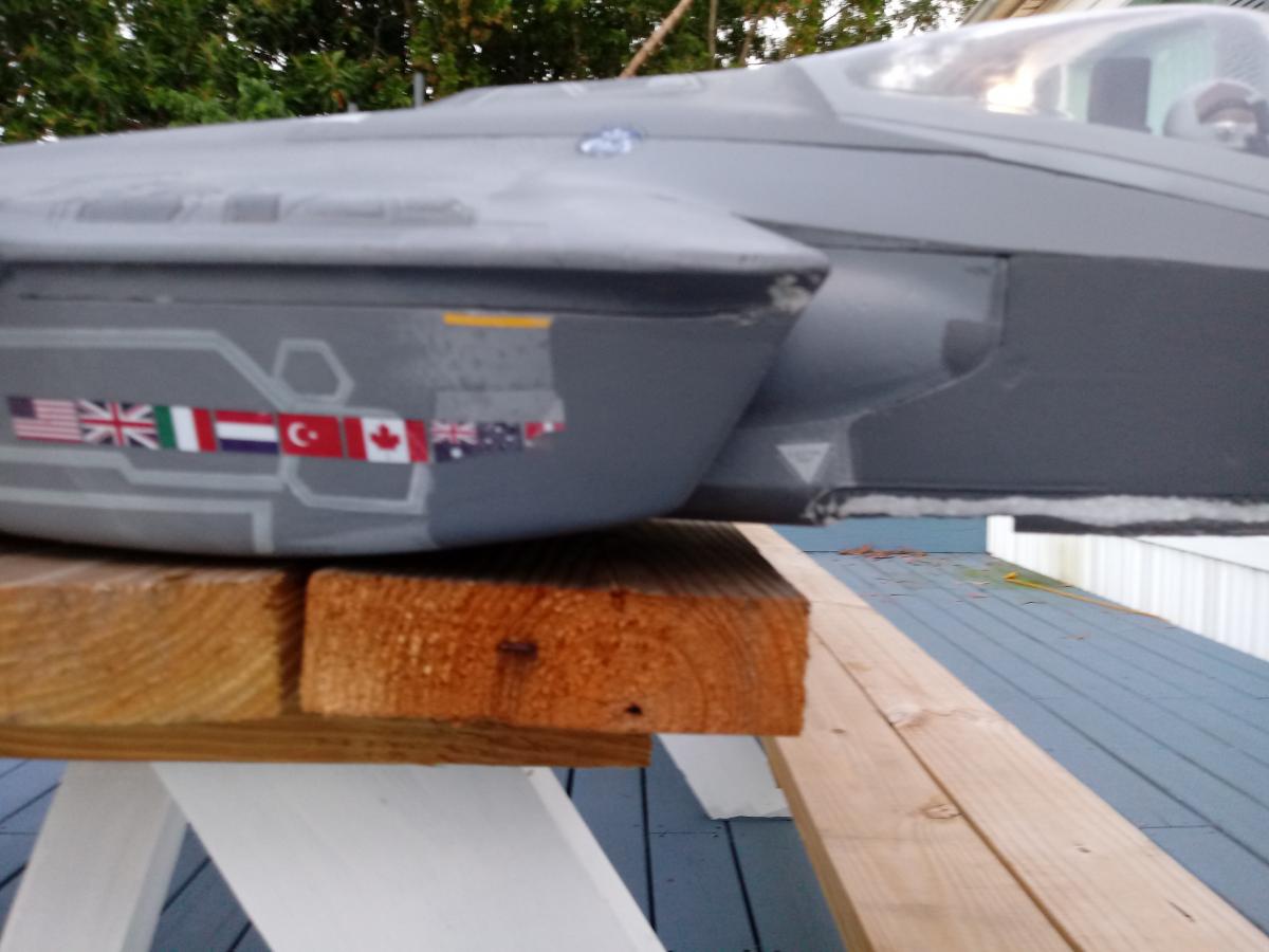

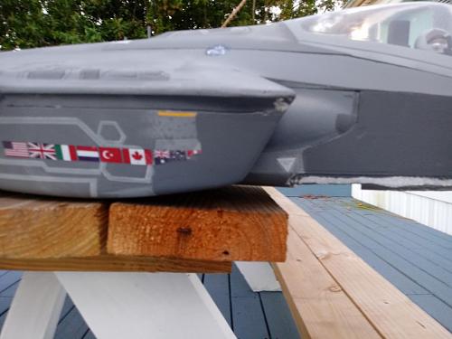

                          #612

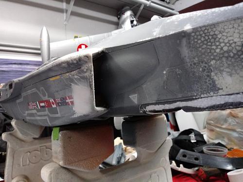

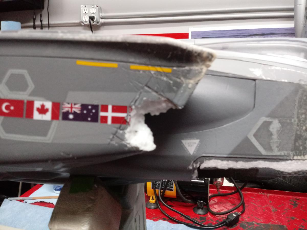

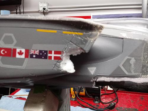

                          My maiden about 6 months ago was crazy. Flew it off our grass field. Took forever for it to rotate, and when it finally broke ground, it pitched straight up. Applied full down elevator and got it back. Retracted the gear, and it pitched down ! So I trimmed it and flew like it was on rails. On final, I dropped the gear and it pitched up again, and from that point on, basically uncontrollable. Got it back for a second about 3 feet off the deck when it went inverted and crashed into our flight line barrier. Never had a maiden like that ! So now we're about to finish our new geo tech runway, and I brushed the cobwebs off and started repairs. Only thing I can figure is the cg must have been too far aft. I had it 4mm behind the plastic wing mounting plate. Click image for larger version
ID:	243465Click image for larger version
ID:	243466Click image for larger version
ID:	243467Click image for larger version

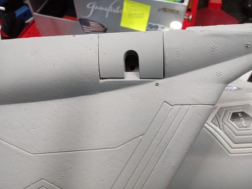

                            #613
                            I think that's way too far back. Here's where the updated information pegs it:

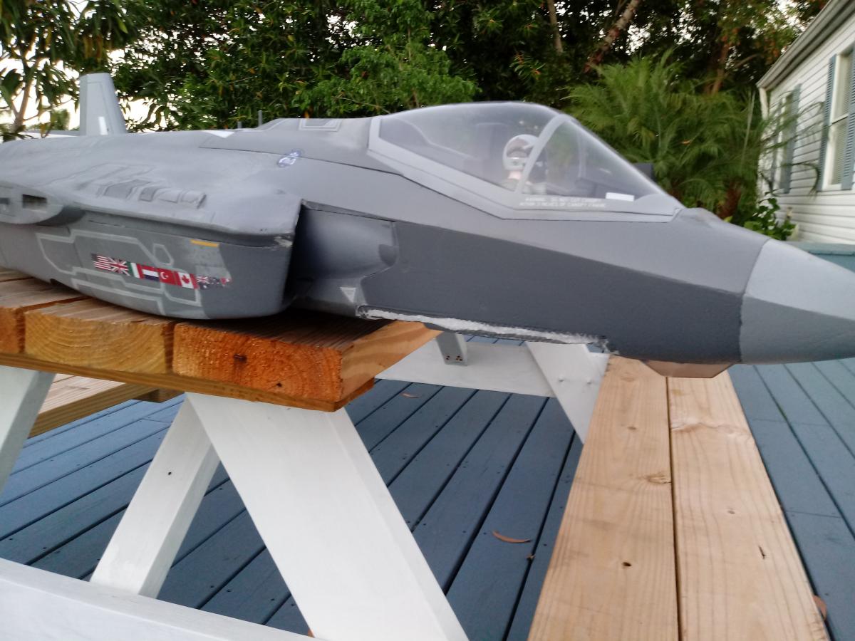

                              Here's where I cgd mine with the gear down. Click image for larger version
                                • 8825
                                #615
                                Although this is a personal preference thing, I CG mine with the gear up because that's the way the plane flies for the bulk of it's time. Gear down for me is only for take off and landing, so this occupies the minority of the time the plane is being operated and I can manually and easily compensate for the gear affect on CG since those are the times that I'm more "hands on" anyway.
                                I had to go take a look at my plane to see exactly where your reference point is since it's not what's used in the manual. However, examining it on the real plane, the reference piece (or line) on the plane is about the same on the top as it is on the bottom. That being said, yours looks like it's about 4mm "behind" the reference line (as you said) where the instructions show it should be "ON" that line (even though the written part of the manual states it should be "in front of" that line. Mine is 4mm "in front" of that line (as per the written instructions) and I'm going to move it even further forward for the next time I fly it to try and take out a bit more of the squirrelly-ness out of it. So, by comparison, your CG is about 8 to 10 mm further back than mine (at the moment). Having moved it about 4mm forward of the recommended reference line made mine much more stable and flyable. I think moving it a bit more forward will make it just about right for me.
                                However, I've always been of the belief that a few mm one way or the other for CG shouldn't make a huge difference. There may be something else at play in your case. Perhaps, you need to try more expo, lower rates, especially on the elevator. This is a fairly short plane (small pitch moment) and with those full flying elevators, it's very sensitive to elevator input and if the plane has any "play" in the elevator, pitch sensitivity is even more exaggerated.

                                  Good point, I had a lot of elevator travel in mine, and that could have contributed to the already bad situation with my botched cg. I'm going to correct the cg and tone down the elevator travel, and give it another go.

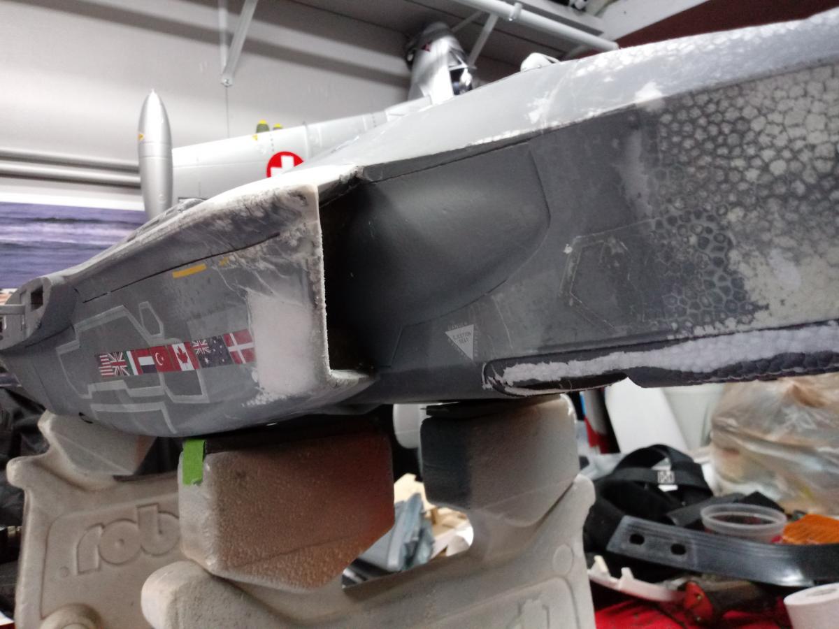

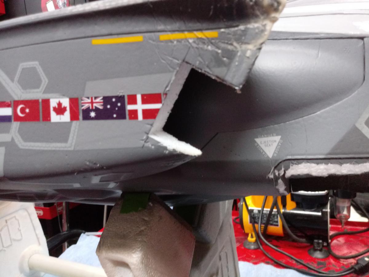

                                        #619
ID:	243658Click image for larger version
ID:	243659Click image for larger version

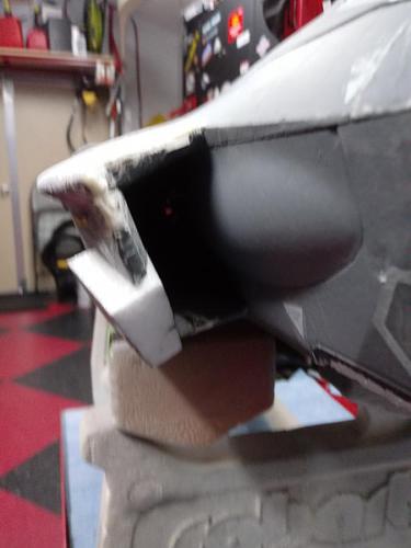

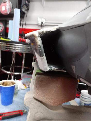

ID:	243660 Continued with the repairs today. Almost there. Gotta sand the base coat one more time, the I can break out the airbrush.

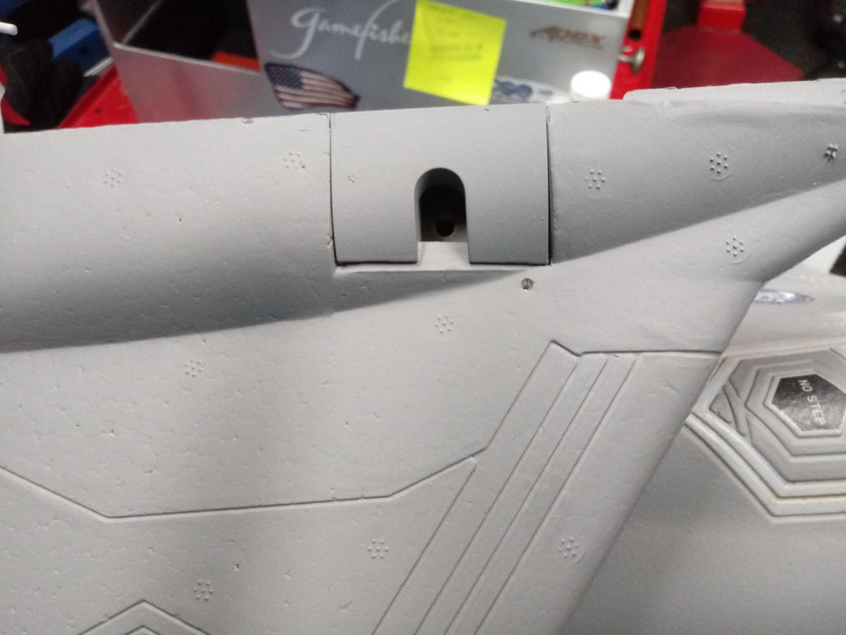

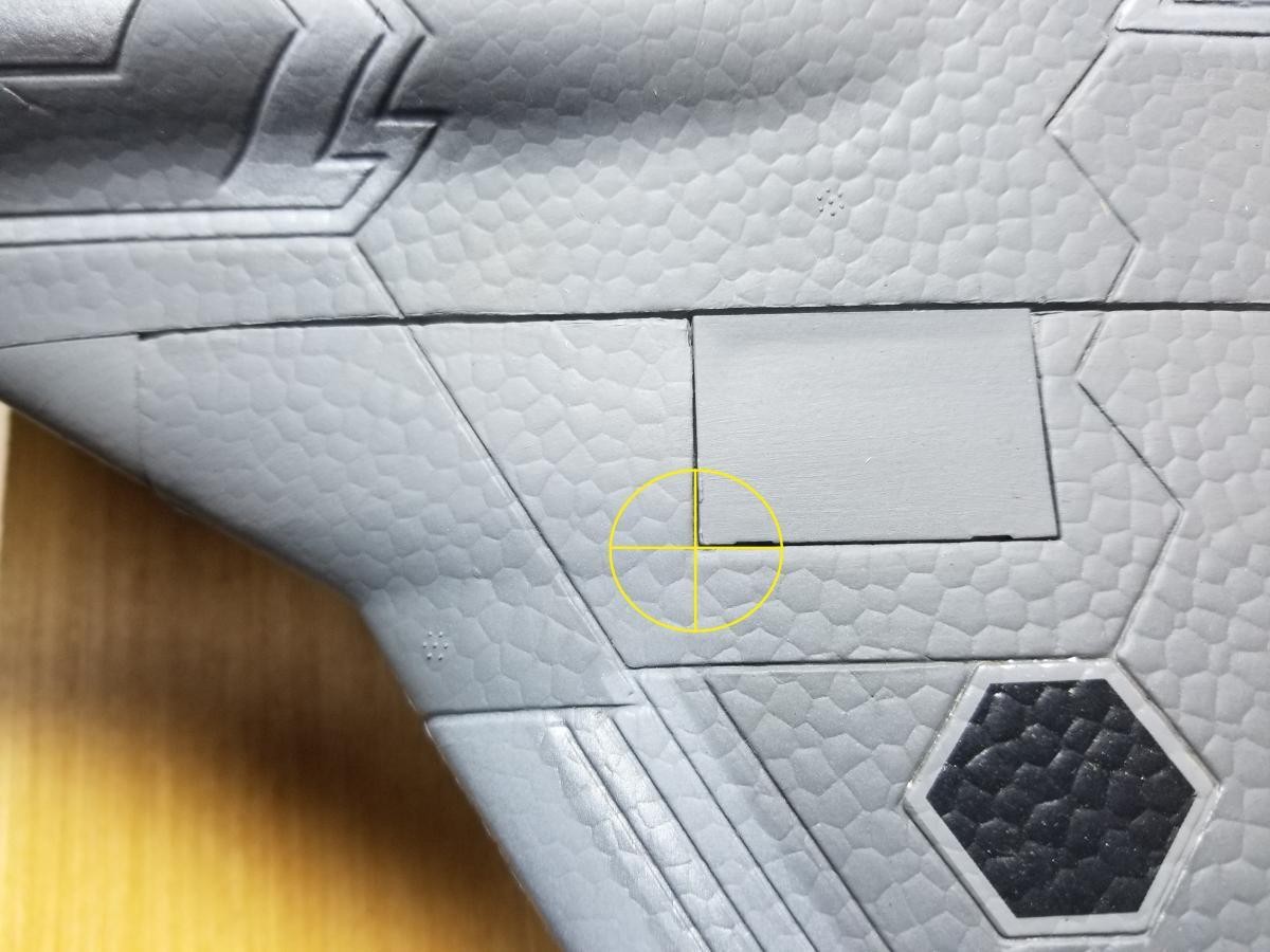

                                          #620
                                          xviper, my manual has a totally different cg. If I measure back from the break in the wing 4mm, that puts the cg way ahead of mine and yours. I made another mark on the bottom of the wing where I think Click image for larger version
ID:	243662Click image for larger version
ID:	243663 you have yours. Can you confirm this ? I would like to start there, if yours is flying good.
