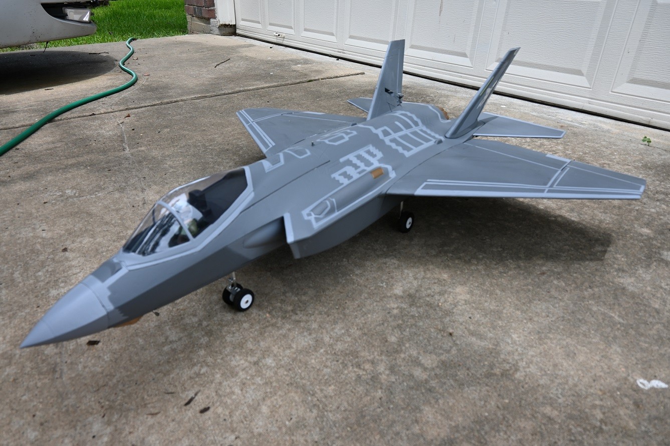

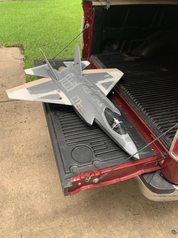

    The Phoenix is rising from the ashes. I'm at the scotch tape hinges stage for portraits. lol
    Click image for larger version  Name:	IMG_6810.jpg Views:	0 Size:	160.9 KB ID:	261869

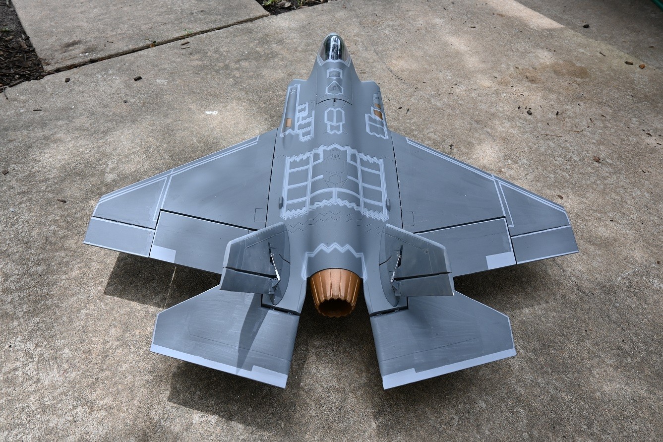

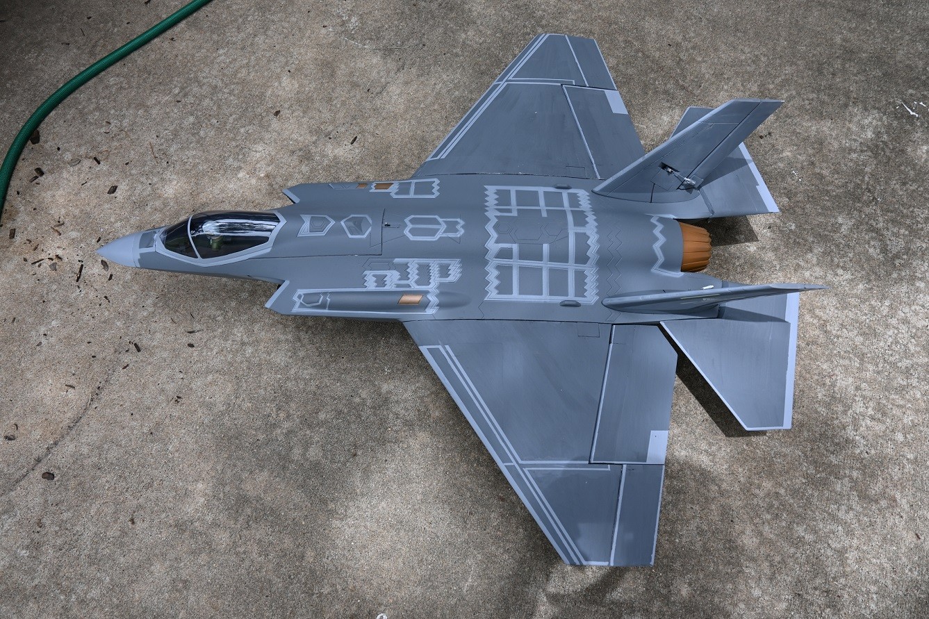

                              The rebuild of my F-35C is almost ready to fly. I really like the dual front wheels! I also got thte wing extensions right this time to be more scale looking. All I have left to do now is trim it out and set the low and high rates. I have read all of the comments on how much throw but this is an entirely different bird with flaps and much smaller ailerons than the F-35A. I will still be going conservative. Hope to get it in the air sometime soon.

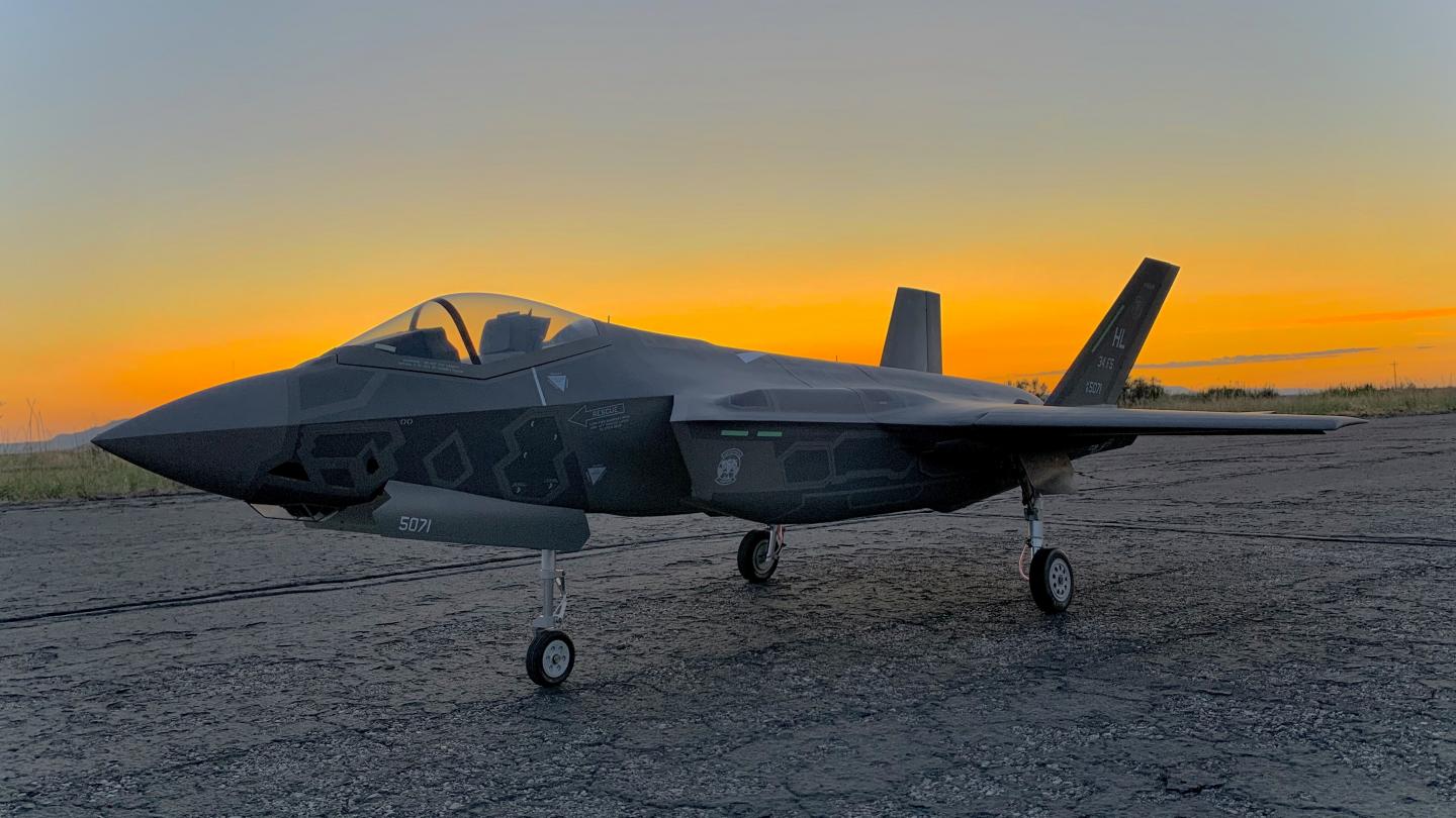

                                I did the first test flight on my F-35 this morning weather calm. Test flight went great. I had the ailerons on low 7 mm, Elevator on mid rate 14 mm and the rudder on low 12 mm. I have flown some EDF's with excessive throws and it was not fun, LOL!! ! As most of you have posted and a few guy's I know had told me, tame this one down a lot before your first flight. I followed the throws some have mentioned on this forum. Thank you guy's! The info I gathered here was very useful in making my first test flight turn out great and very rewarding with no problems. Landings are as suggested from the guys at Motion "just do not get it to slow on the landings. The Landing went great touched mains first then the nose gear. "Just another walk in the Park" I have the dual ail. and have them set up for Spoilerons, really helped on the landing I used the spoiler set up that Crick3t had posted earlier in this thread
                                Click image for larger version  Name:	F-35.jpg Views:	0 Size:	114.3 KB ID:	264823
