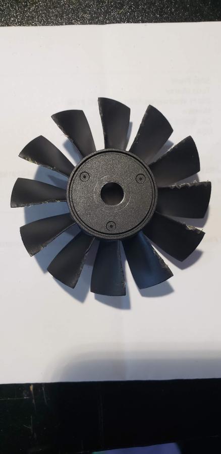

                                  Greetings folks,
                                  A member of my club just purchased this plane used and crashed it on his third flight. The plane lacked power certainly not the 100+ mph plane referenced on-line, it had a hard time taking off our paved runway and barely made it around the field on the first two flights.
                                  I have several questions.
                                  How would I know what version this is?
                                  It does have a 2957-2210Kv brushless inrunner motor 12 blade fan and 80A Hobbywing ESC.
                                  When I pulled the motor apart the fan blade had a bunch of nicks, not sure if it was like this before the crash, but could it have contributed to the lack of power?
                                  I'm not sure if I should buy a new fan blade or whole new motor.
                                  Thoughts.

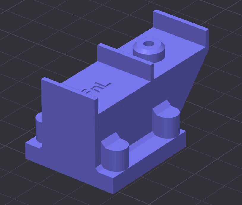

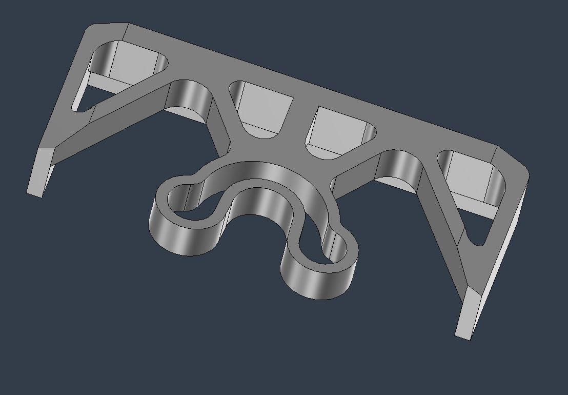

                                  Also where can I find a nose gear brace 3D file, I'm not seeing one on Thingiverse.
                                  Thanks!!​
                                  • kallend
                                    • 1877
                                    #937
                                    Originally posted by santanig5
                                    Greetings folks,
                                    Thoughts.
                                    Thanks!!​
                                    Check your RCG thread

                                      Upgrade options for a nose gear flex brace and main gear mount are posted on RCG.

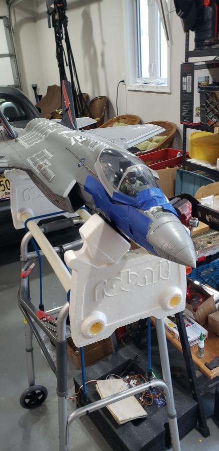

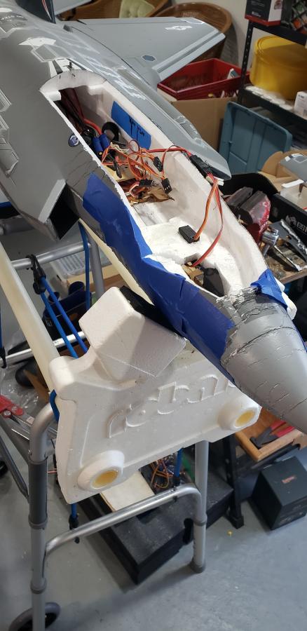

                                        Here's my F-35 in 65th squadron aggressor scheme
                                        I added nav lights and formation lights to improve the visibility and I guess the scheme will help also.
                                        Big thanks to my good friend Radar-Guy/Airborn Jetworkx for all his help with this project!

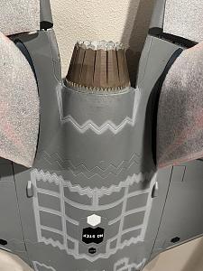

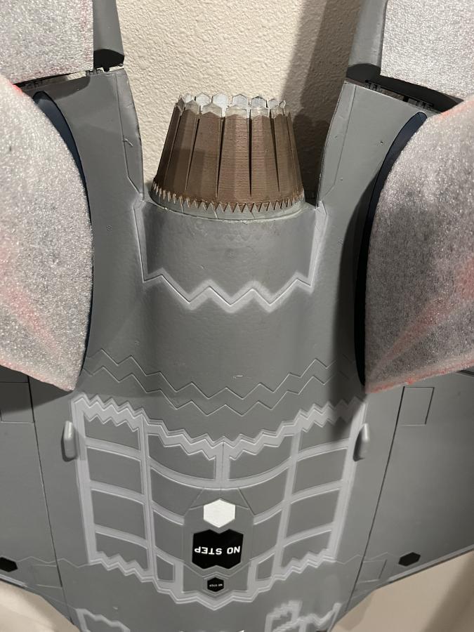

                                          #940

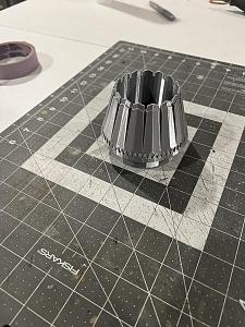

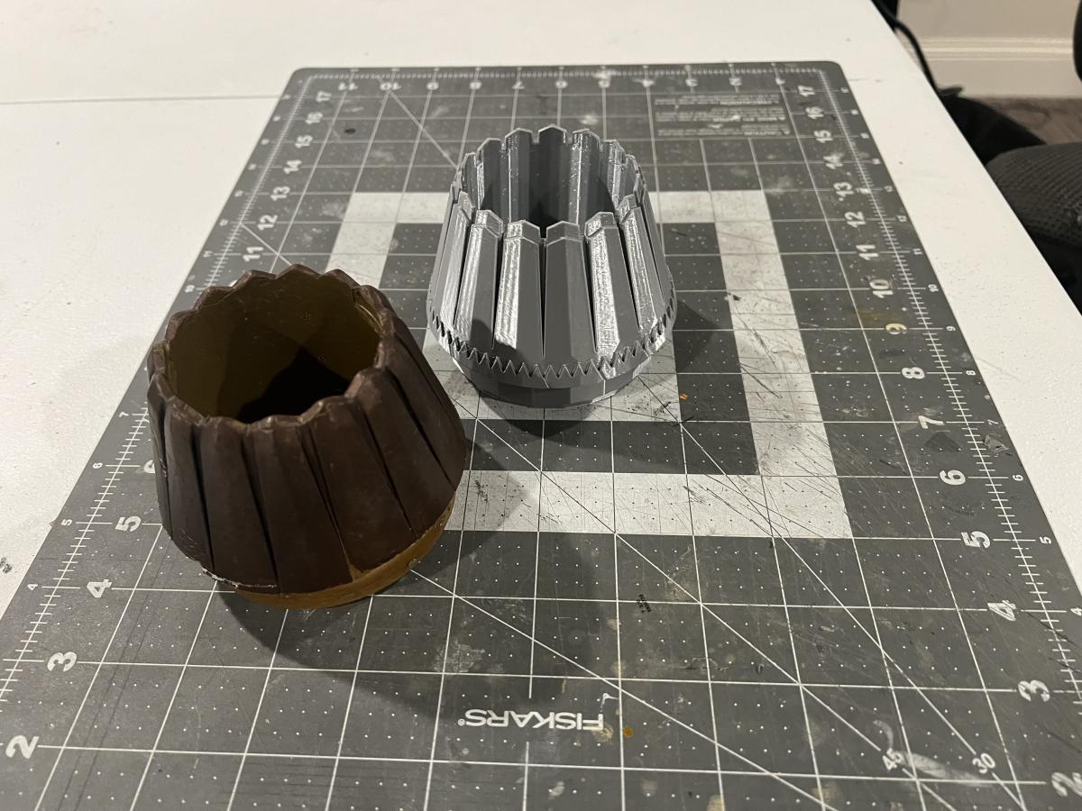

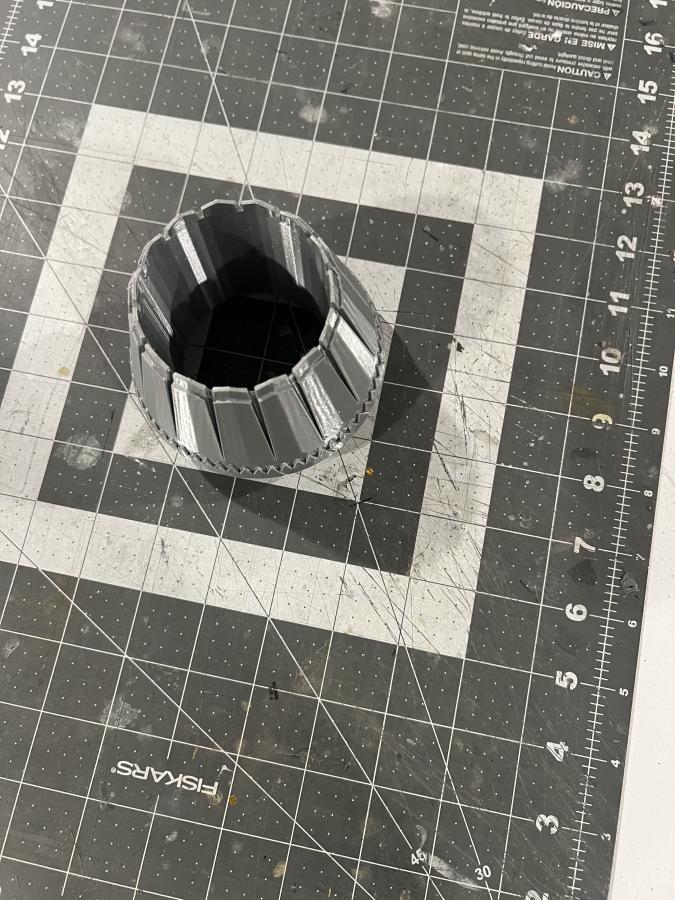

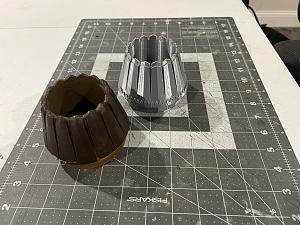

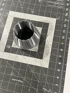

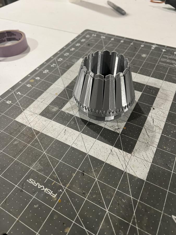

                                          I'm doing some mods on my F-35 after I had to do some repairs after a landing problem when a piece of foam strip on the bottom of the wing came out in flight. Fully repairable, although I did crack all three gear retract housings and am waiting for those to show up.
                                          In the meantime, I printed up a better afterburner exhaust over the foam one that comes with the kit. Will be installing a RC Geek afterburner which is supposed to arrive today. Maybe next week I'll get the replacement retract units and I'll be ready to fly.
                                          The beautifully designed afterburner tail cone was designed by our own Kallend of Hobby squawk. It came out great after I printed it up from Thingiverse. I'll attach a few pics.
                                          Cheers
                                          Davegee
