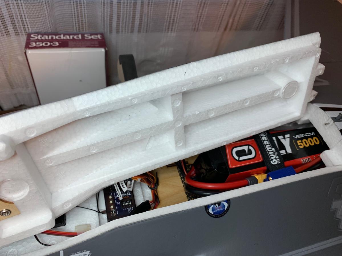

    Hi Guys

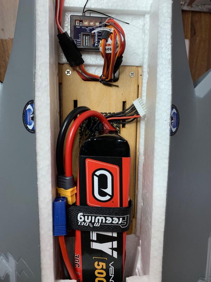

    sorry to report that my F35 has gone to the foam basket in the sky... I simply loved the way this little jet flew and had about 170+ flights on it.
    On the third flight of the day, I am not certain why but I lost radio contact with jet shortly after takeoff. Then I seemed to get it back and tried to make my downwind leg .. put the gear down and turned base leg at that point I lost it again. This time it turned and went straight into the ground about 300 feet from the runway :(
    battery was good 90% left
    connected to the RX okay
    esc was putting 6.6v out to the RX
    the only thing I am not sure of is the jet was bound to my spektrum TX with 11ms frame rate. These FW planes have digital servos so it shouldn’t matter. But recently I was told that the cheap digital servos probably can’t handle that frame rate. I would like to hear from all you regarding this question.
    I flew my glider and my L39 without issues and they are both on 11ms frame rate too
    Rich
    RichJ53 just a thought, but from looking at what's left of the fuselage and the rx antennae sticking out it looks like you were using the AR636. Not that it matters what rx you're using, but it also looks like the antennae was run along side where you put the battery. If the main antennae and the shorter 90 degree antennae for the AR636 is too close to the battery, it could cause a brown out. I learned this the hard way on 2 Stinger 90's that I had the main antennae run along side the battery. On the first, the brown out occurred only after the 70+ flights. On the 2nd with the same orientation, it occurred on the 30+ flight. It was only after posting a picture of my set-up on my F-18 that several "concerned Squawkers" (and later a Spektrum technician that I sent a picture to) noticed my main antennae was too close to the battery and they suggested I correct that and also install a satellite. Additionally, a friend who has an F-14 Tomcat that he flew over 100 times with no problem, just last week got a brown out after landing (how lucky is that). Turned out his antennae was run underneath the battery tray and this was the only thing we could determine that would have caused that, even after so many flights without a problem. If you read the manual with most receivers (which I never do of course), it will talk about antennae placement and the distance it needs (especially the active portion) to be away from the battery.
    This may not have been your problem, but I'm just saying it could have caused the problem. Hope you solve the mystery.

        Hi Hugh
        Thank you for taking the time and sharing your experiences! Really great information to consider for the future :)

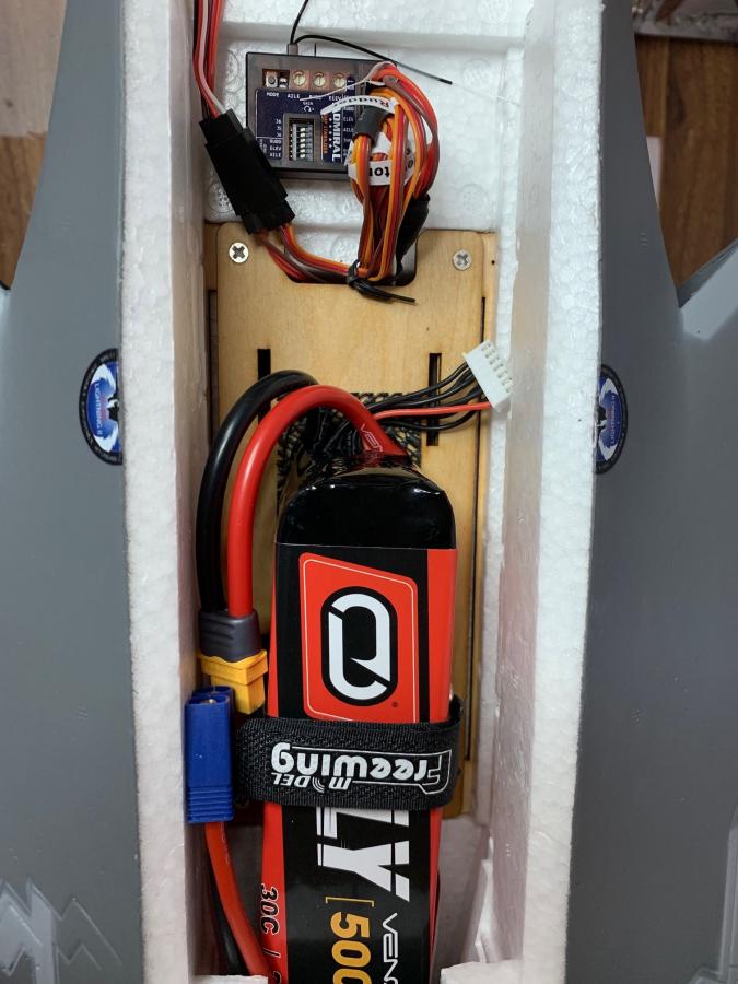

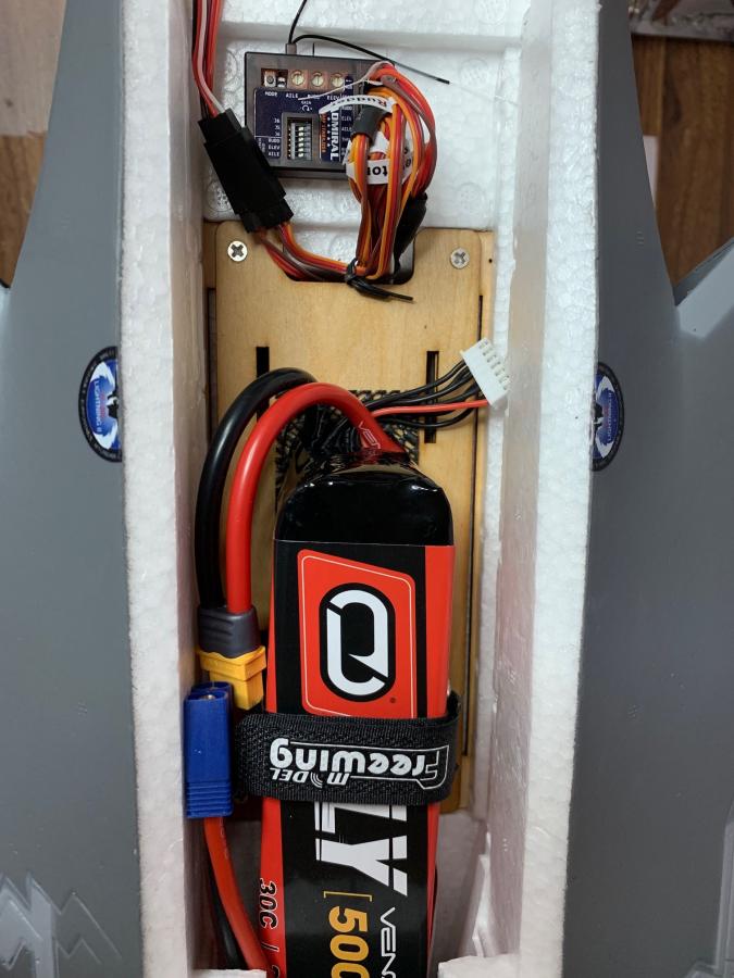

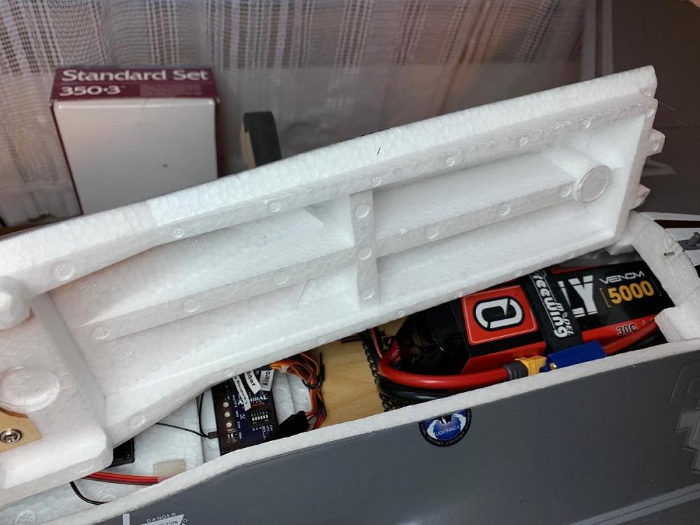

        I was using the AR610 RX at the time of the crash and the long antenna was facing forward away from the battery. .. When this first started I was using the Admiral 600SP with gyro and it worked great until one day it shot across the runway out into the rocks without any control from me I was happy the motor stopped or I would have had the chance to troubleshoot the issue. I found a couple of photos of my first RX installation. I will most like be buying another one of these jets soon.... it was so much fun and easy to throw in the car for the day of flying.
        Rich

            RichJ53 you definitely got your antennae significantly away from the battery so scratch that last thought of mine on the "brown out" mystery". It was worth a shot anyway. Suggestion # 2, your F 35 somehow got possessed by the corona virus :japanese_ogre: I'm sure my planes/jets discuss rebelling against me all night long while I'm out of ear shot, so I guess :poop: happens. :stuck_out_tongue_cl

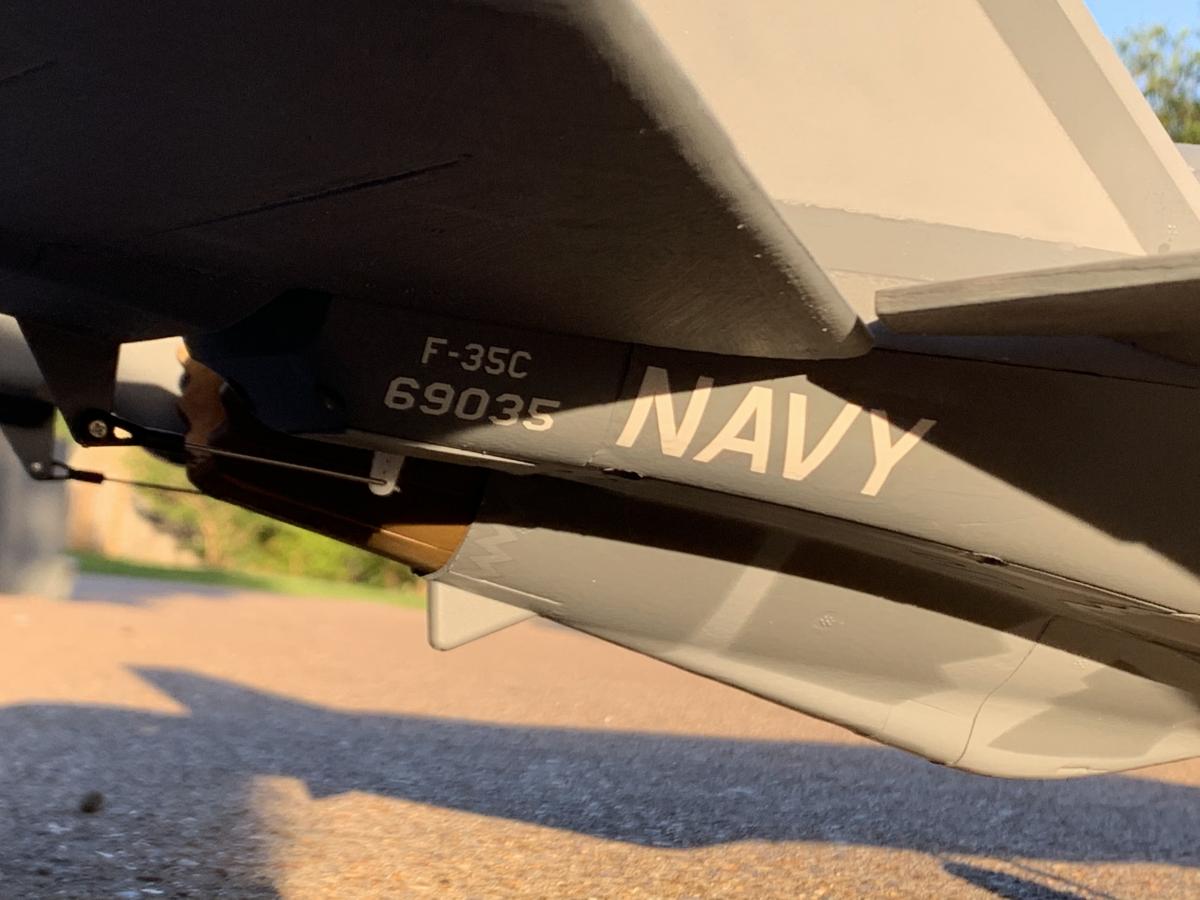

                              Originally posted by dradams2
                              I have my F-35C ready to maiden now so I am going to start taking it to the field (Bomber Field) with me and when the wind is right and my courage is right 😁 I will give it a try. I had never flown an EDF before so I picked up a Freewing 64mm F-22 to get some experience. I maidened it a couple of days ago with no issues. It flies a lot like some of my faster RCPowers park jets that I have built from scratch. It sure didn't want to slow down to land though. I did manage to get it down in one piece. I just need more experience with it I am sure.
                              No one replied to my request for help on the CG possibilities for the changes I made to the F-35 so I am planning on using the recommended corrected CG from the forum and go from there.

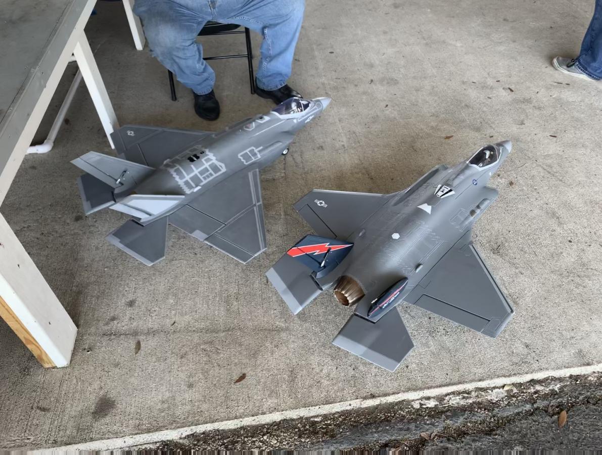

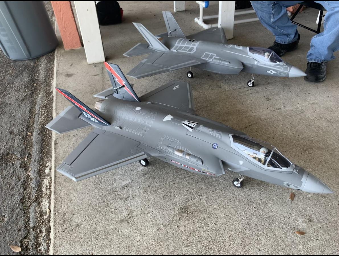

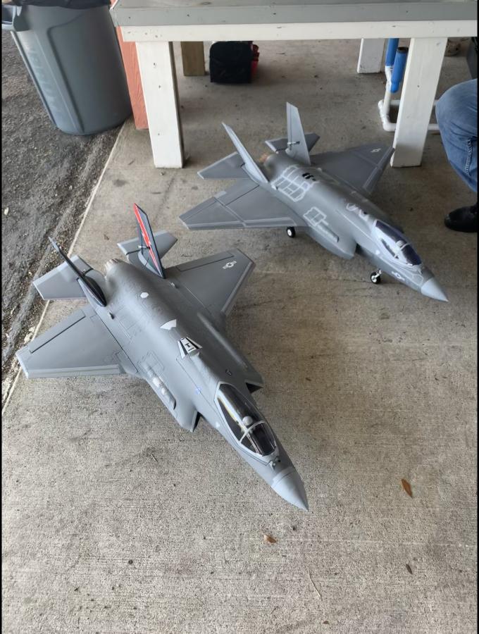

                              I was lucky enough to meet dradams2 at the big Warbird fly in at Bomber Field last weekend.
                              He brought over his F-35C conversion to get a group picture with my stock with modified paint and markings F-35A AF-01. His C looked even better in person than it does in the pictures.
                              As soon as I saw the model, I knew who he had to be. Hopefully, he will post the picture sometime soon.

                                I'm a little slow with this but here are the pictures. I also got to meet deltadart106 (I think that is right) at the fly in. I got the decals from Callie today so I will post that as well.

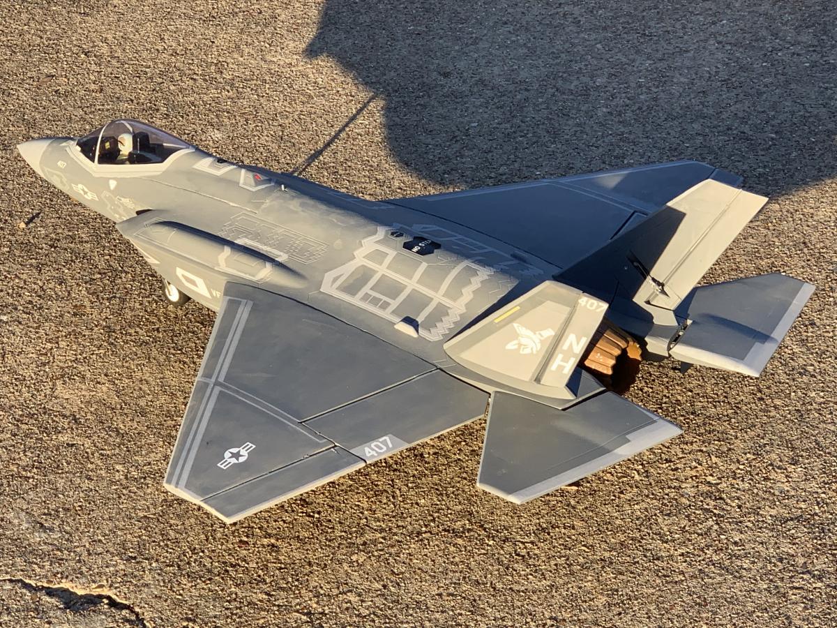

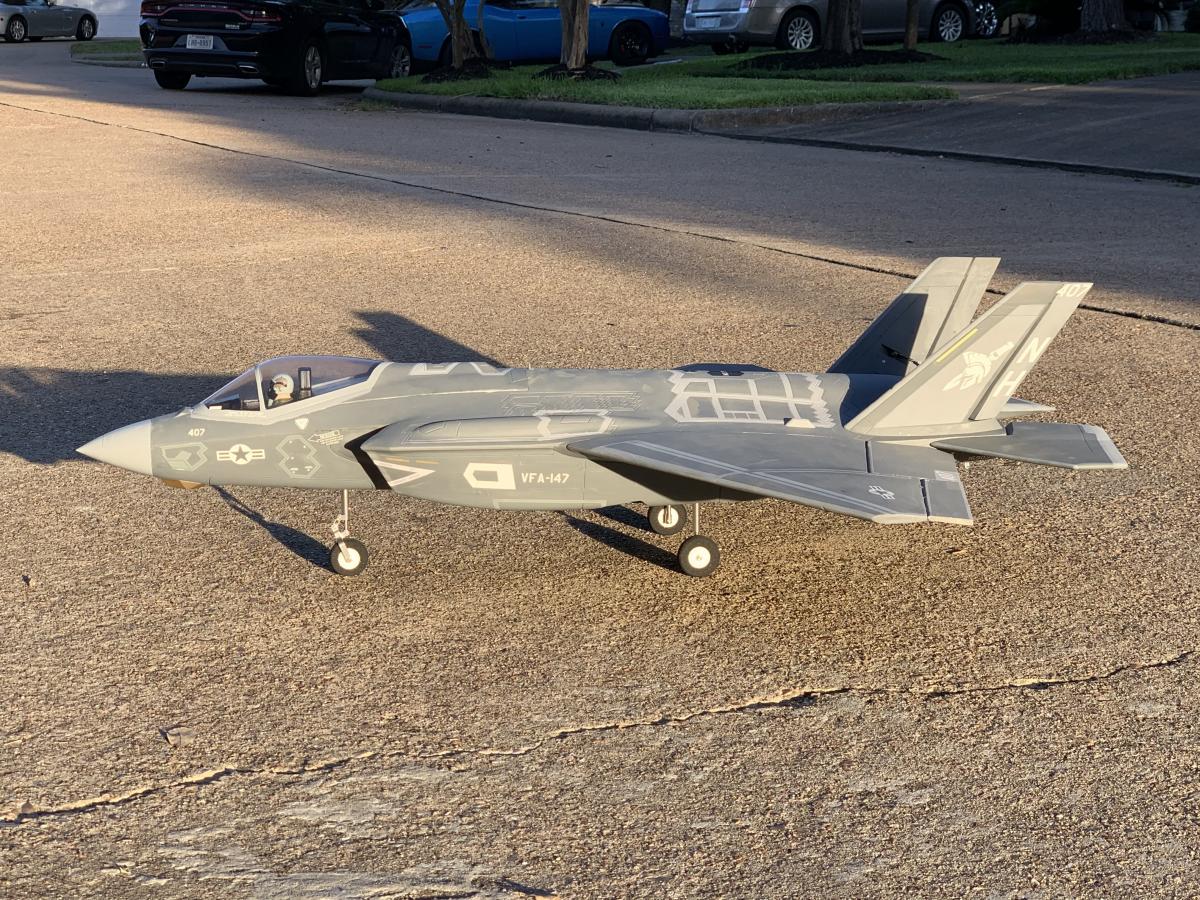

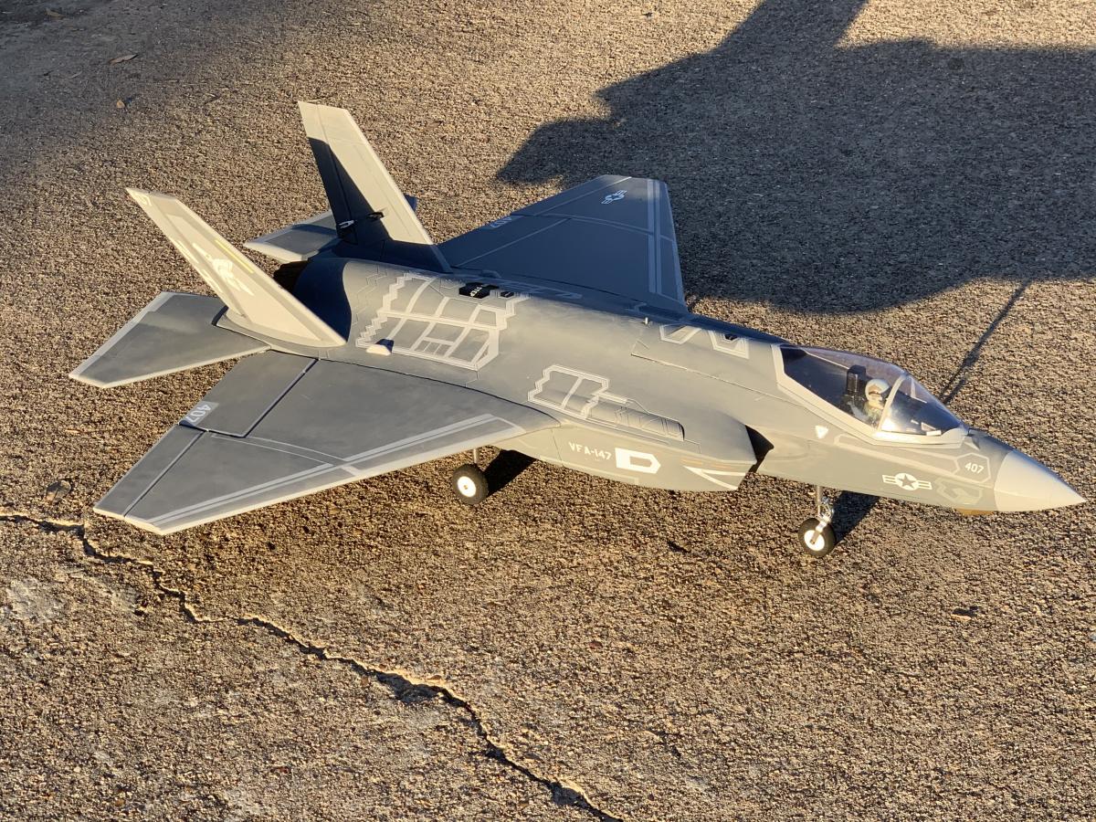

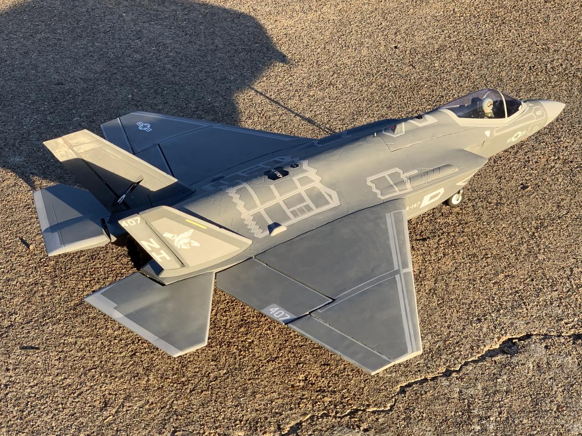

                                  I got the decals from Callie today and here they are. This is the VFA-147 "Argonauts" livery. I plan on filming the maiden this Tuesday when winds are forecast to be optimal if not sooner. I'm as anxious as everyone to get out there and give this jet a try.
                                  Click image for larger version  Name:	JPEG image.jpeg Views:	0 Size:	298.0 KB ID:	259297
                                    Looks awesome!!!!!!!!!!! Nice work!
                                    Please give us a full report after maiden.
