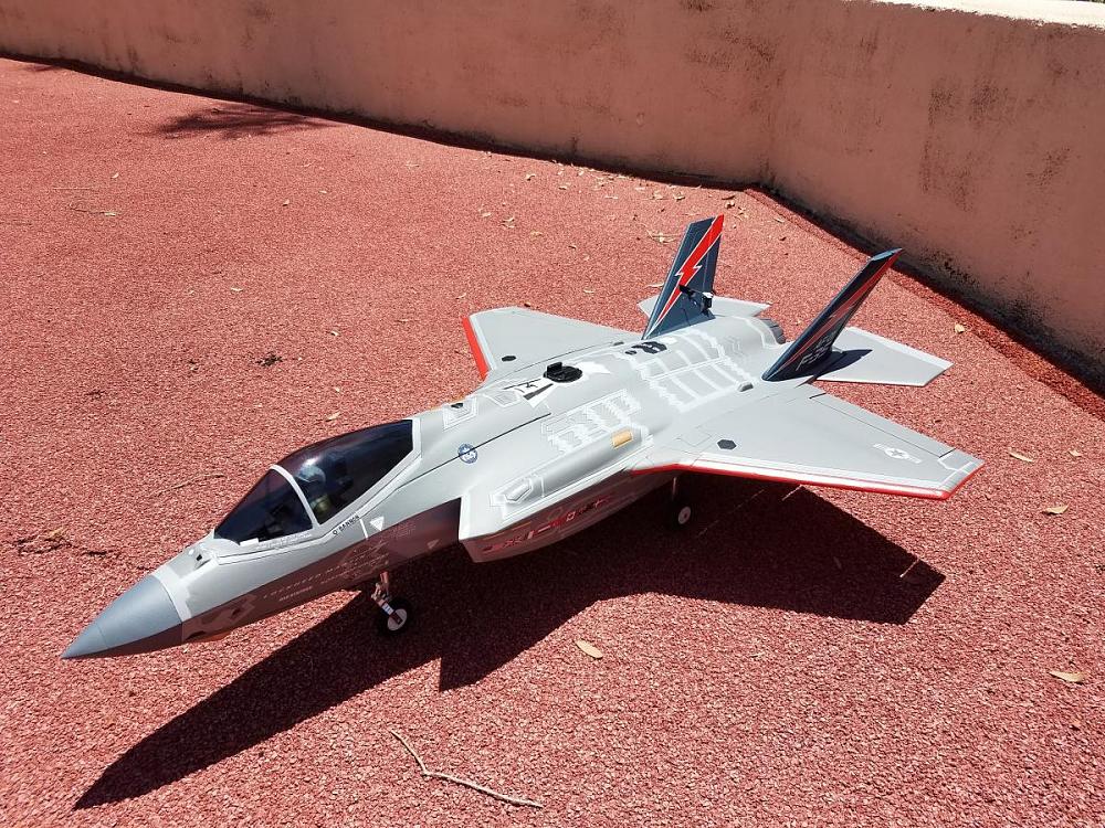

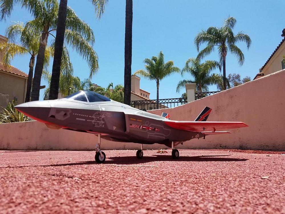

    great job! did you 3d print the ordinance? I so can u make me a set. Where did you get you decals as well. Your bird looks excellent and the way free wing should have done it.
    Thank you. They are downloaded and printed from thingieverse and resized to the f-35’s scale. The decals are from Callie Graphics.

        That 3D printed ordnance looks right on! Nice in-flight photos, too. Looks like a real F-35 in the hills around Edwards.

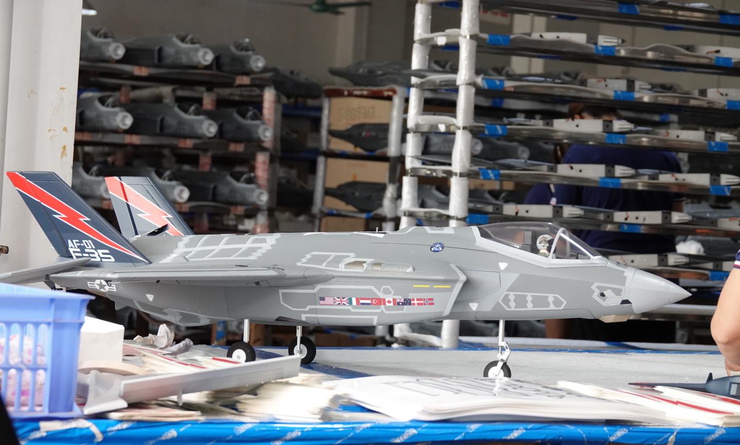

        Here's the master sample the decal team uses as a reference when applying all those dizzying decals on this bird.

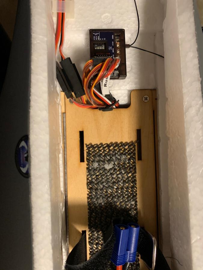

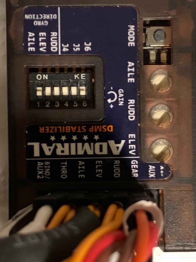

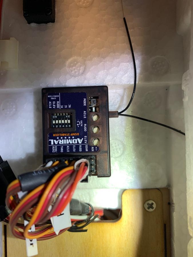

              So here are some photos of my receiver installation and gyro settings. FYI my F35 is locked in even with the gyro turned off, but I find it really helps at slow speeds with high Alpha landings :)
              I use the book throws and fly with the elevator on high rate all the time. Ailerons are usually on low rate with about 20% expo.
              Venom Fly 6S 5000 30*C battery slightly back from the recommended CG

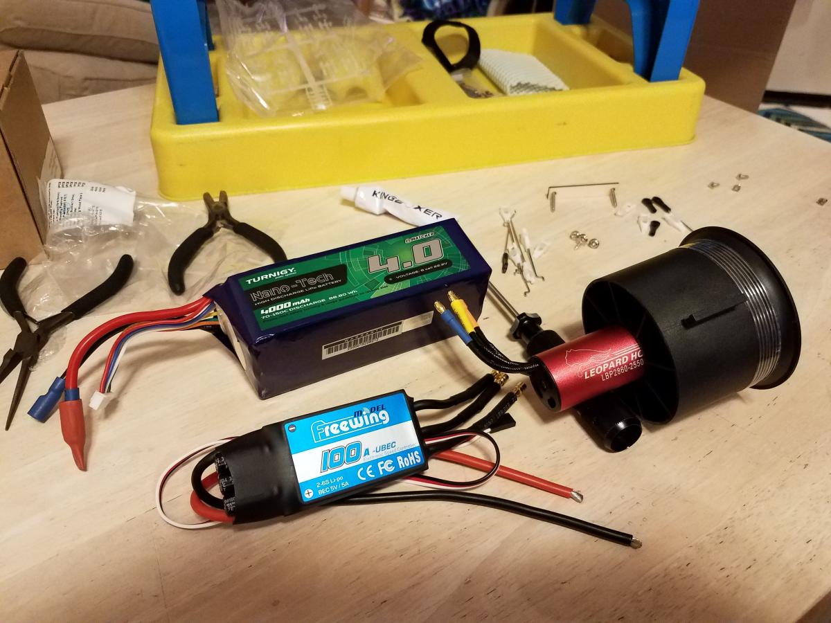

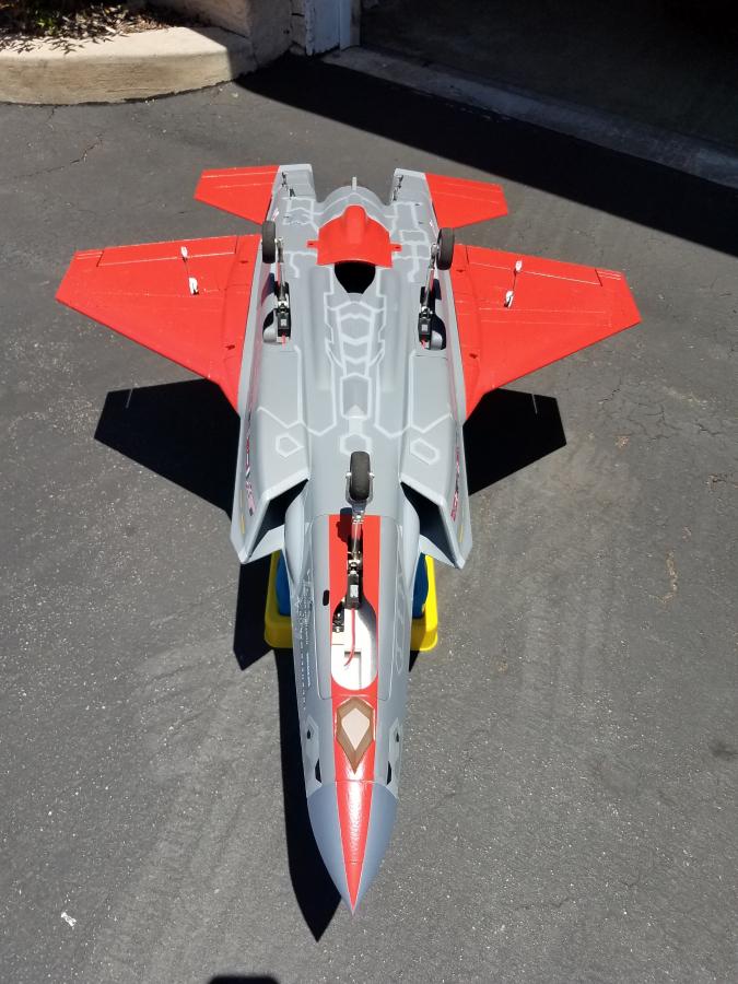

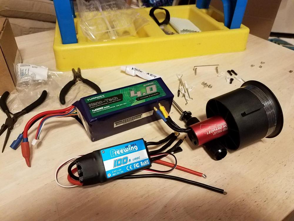

                      I can't leave anything stock and enjoy the challenge of trying to improve upon stock performance without going all out with larger fan units and bigger batteries. I use Leopard inrunner motors in my fast electric boats and found they have a nice 2860 line so I opted for their 2550Kv for this build coupled with a Freewing 100Amp ESC. I tinted the canopy and painted the wings/tail red after finding it very hard to orientate against a gray sky. Here's my recipe:
                      *Stock 12-Blade Inrunner Fan Unit: $11.99
                      *Leopard 2860 2550Kv Inrunner motor: $44.99
                      *FW 100Amp ESC (Avanti): $49.99
                      *Turnigy Nano-Tech Plus 6S 4,000mah 70C
                      The plane flies great! I did find using a gyro really helps with this one. It's very fast on the top-end but slows down nicely without tip stalling badly. The red accents really helped orientate it better and I think even look pretty good despite not being scale.

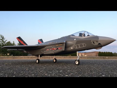

                          Still sorting out my F35, but here is a small video of it so far with a P20 turbine.

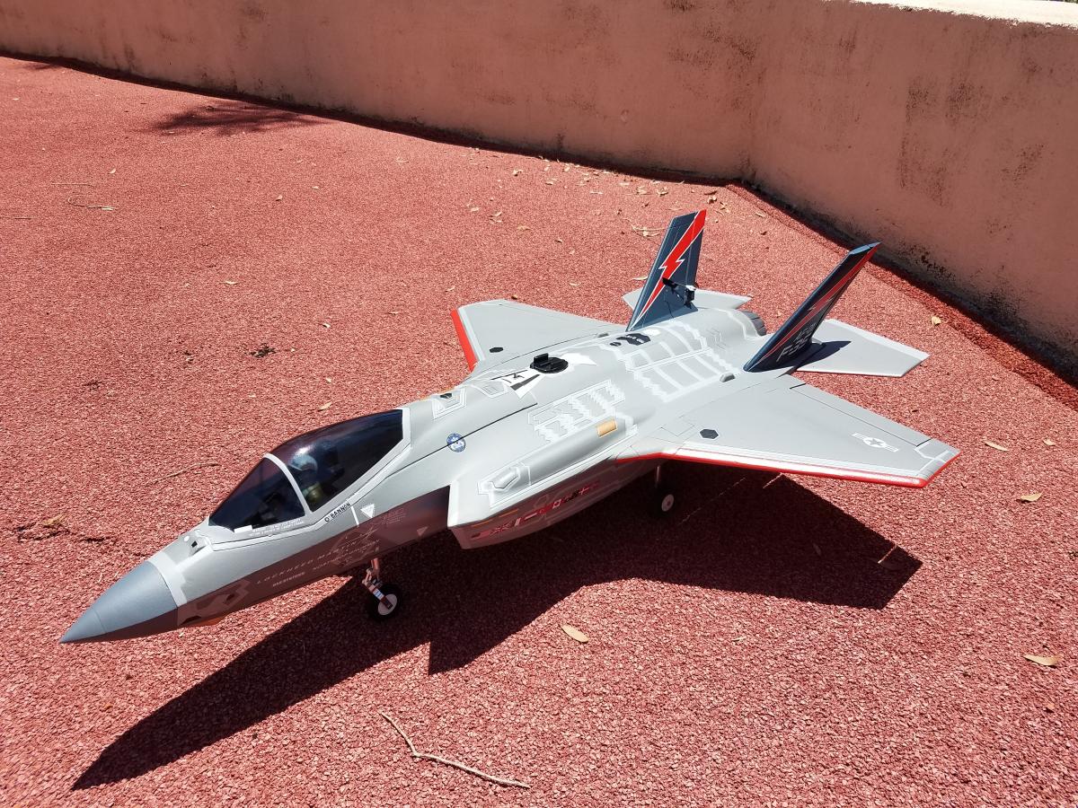

                                Pics from the Summer but no matter. Below is my custom F-35 in 617 Squadron Custom markings made by Callie Graphics, she definitely out did herself this time!

                                  Nice to see that someone else has found a Leopard motor that fits!! That is a dang good set up you got there!! I may have to try that same set up in mine!
                                      It's a bit of a secret for sure that not many know you can do. I have a 2730Kv I have yet to try. Imagine a pair of the 2550Kv Leopards in the AL37... :punch::muscle:
