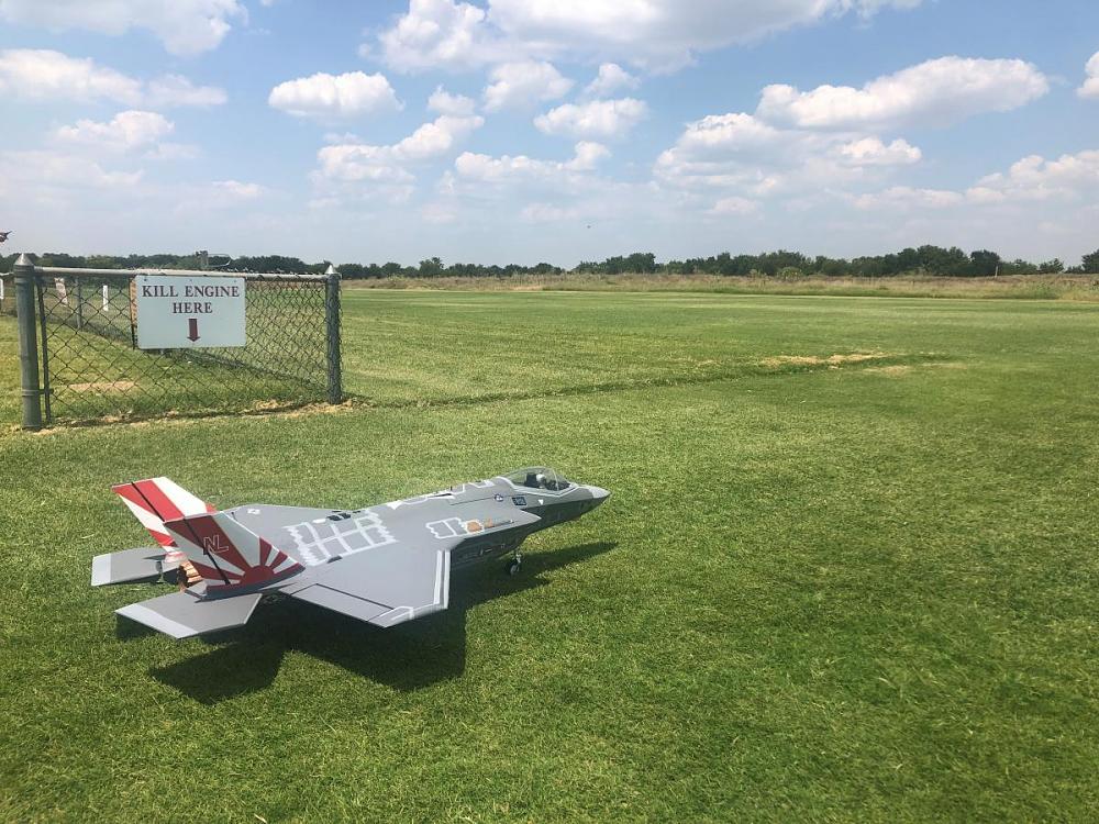

    • Well the maiden didn't happen tried but I couldn't get it to lift off, our grass strip is very smooth and grass is cut very short , I was using a 5200 6s 10c that I use in my F3a pattern plane but ran out of runway which by the way is 100 mtrs long, I had a old 5000 . 40c pack which is a bit swollen but I couldn't get the canopy to close, model seems to have plenty of power with both battery's , I have the cg set at the front of those plastic bits on the wing.

        • With a 5000mah battery, mine couldn't lift off the grass either.

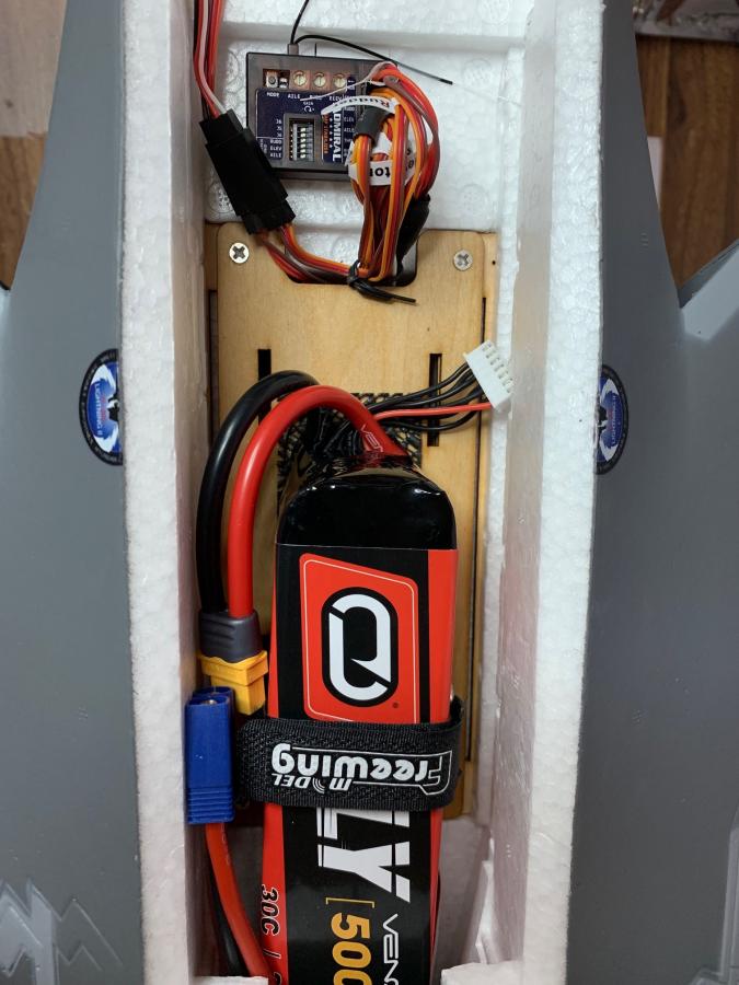

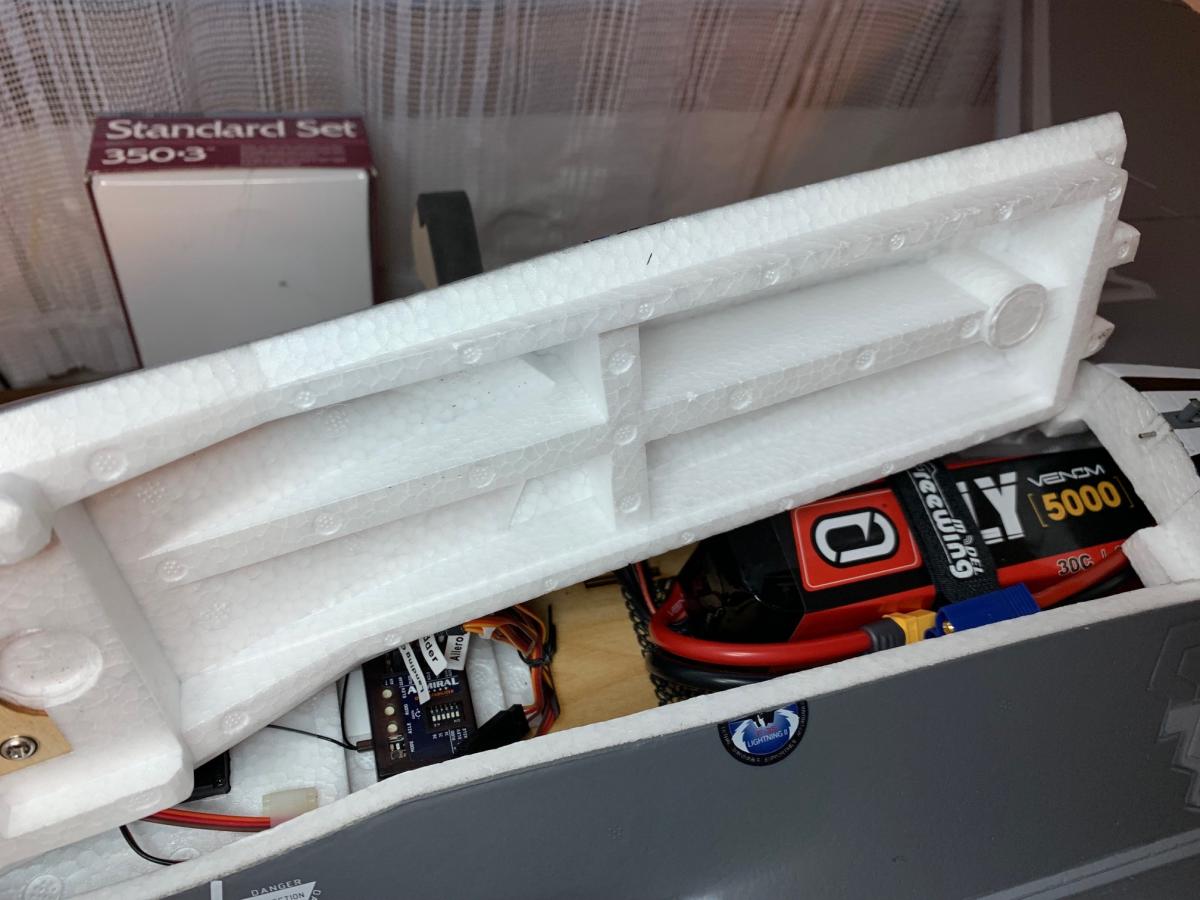

            I have found the larger 5000 6S packs do not allow the canopy to close because of the foam bracing inside. I had 2 Venom 5000 6S 30*C and the fit great with lots of power. Probably the 4000 packs are ideal size but I do not want to buy more batteries :) Sorry I do not fly off grass, but the 5000 pack needs to go back towards the tail to get the CG right (for me)
            Here is the link to the Venom battery so you can see the measurements.
            Rich

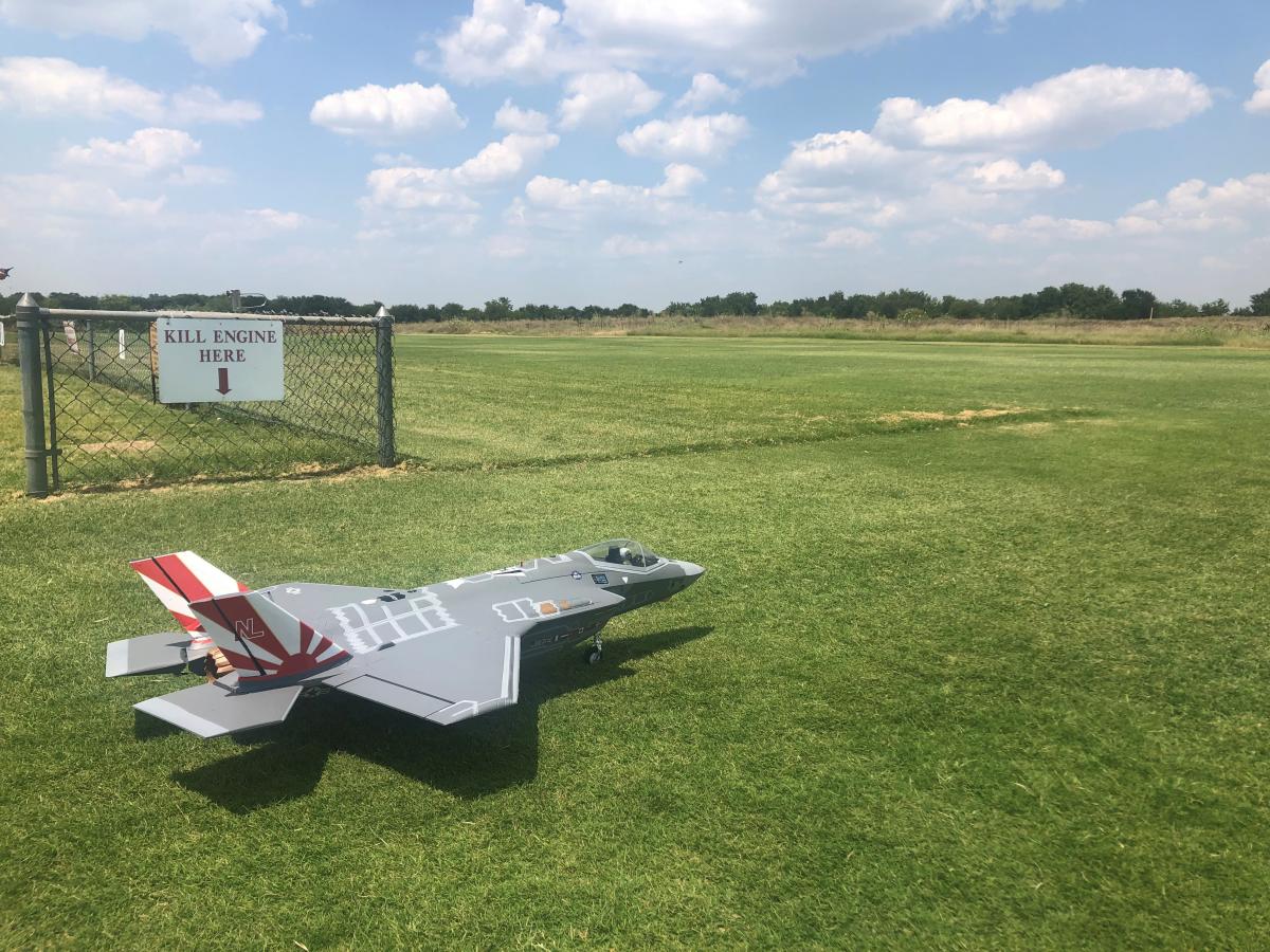

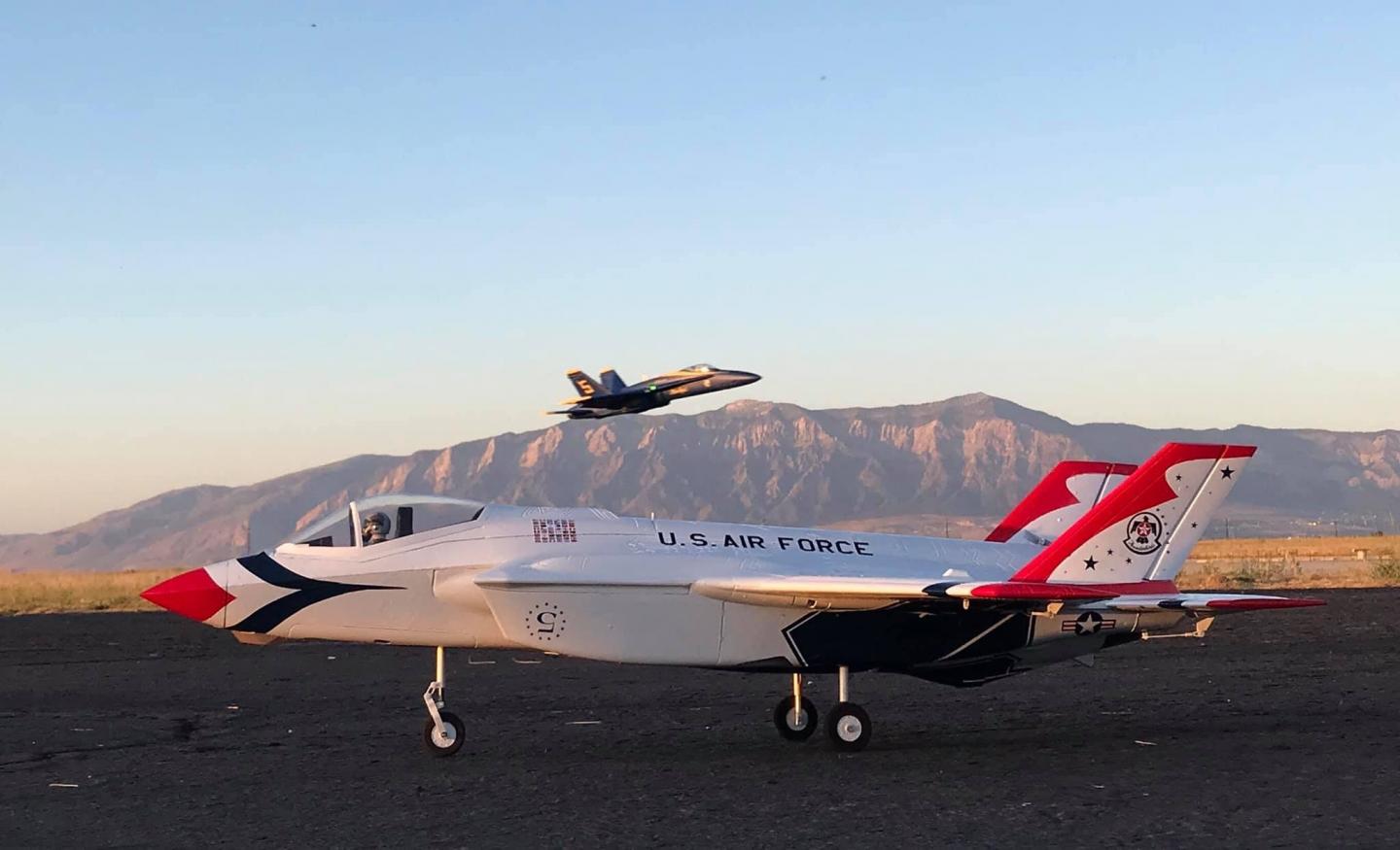

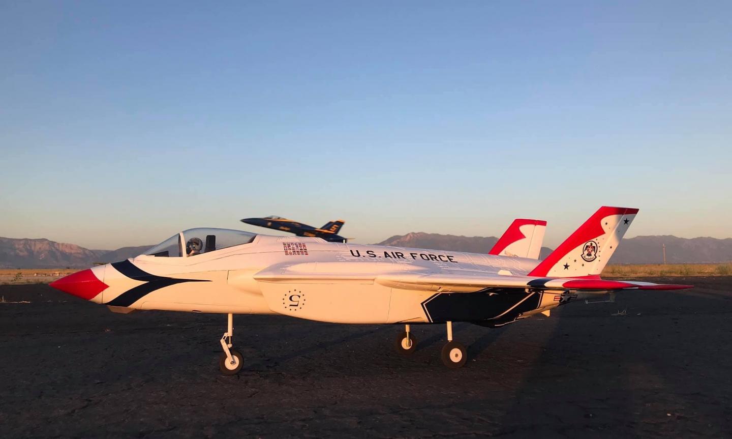

                        • Pictures of my Custom Freewing F-35 v3 in Thunderbird scheme.

                                • I could not get mine to rotate off our grass field either. It did need to be mowed at the time. Plan on trying it again after our normal mow day. I was using a 4000 pac. The FreeWing Avanti and F22 both flew great off the same field. Of course they have larger wheels..

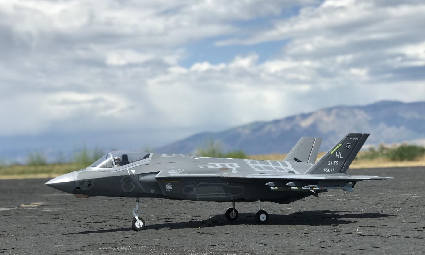

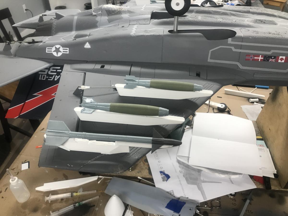

                                  • Custom F-35 dressed in 388th FW, 34th Fs “Rude Rams” scheme. Also I added external pylons and added JDAM’s and AM-9’s.

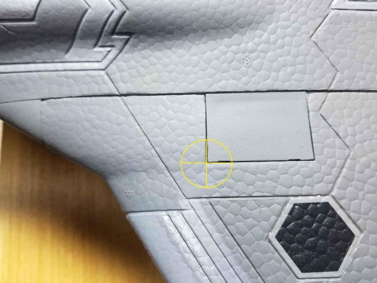

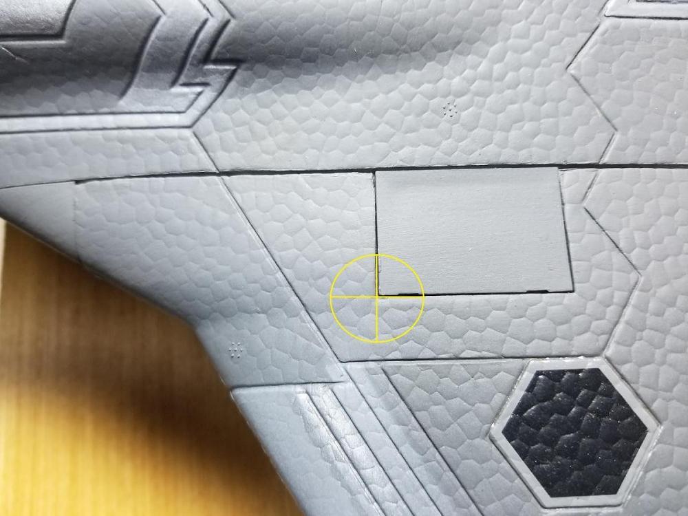

                                    • So what is the actual CG? I see people talking about different CGs and I'm honestly quite confused.
                                      • Originally posted by DaFlyingSnek View Post
                                        70mm F-35 Lightning II EDF V3 from Freewing - Receiver Ready (PNP) - FJ21612P Motion RC and Freewing are excited to announce our all-new 2019 F-35 Lightning II! To bring this model fully into the modern EDF era, we started from the ground up and redesigned a completely new mold for Freewing's most popular 70mm jet over
                                        F-35 V3's proper Center of Gravity (CG) For the proper CG point refer to the photo at this link.
                                        • [QUOTE=RichJ53;n208425]
                                          Thank you very much! But I have seen that some say even at that point it becomes tail-heavy and can easily crash.
