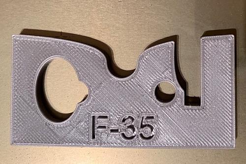

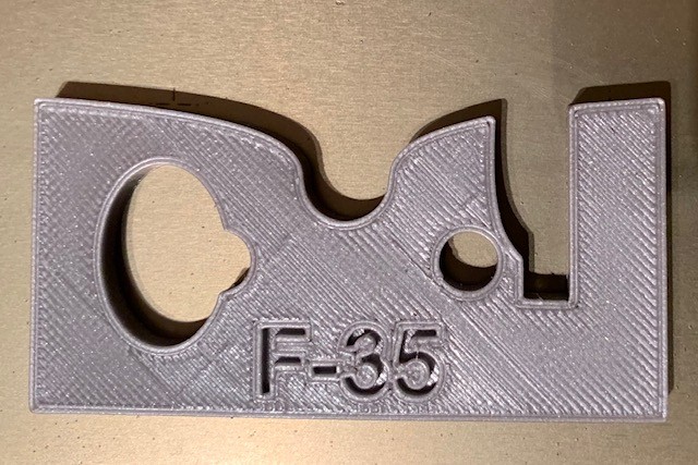

                                  I've revised the 3DP Nose Gear Brace. There is a bit more room now for the tiller arm and the aft mounting screws remain accessible as well now.
