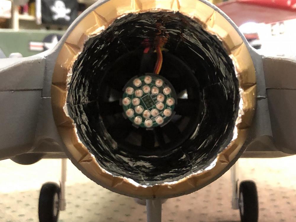

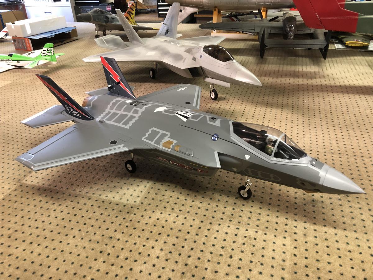

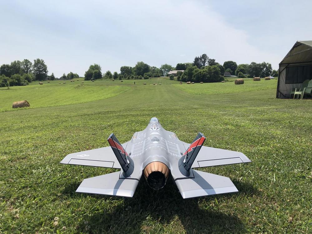

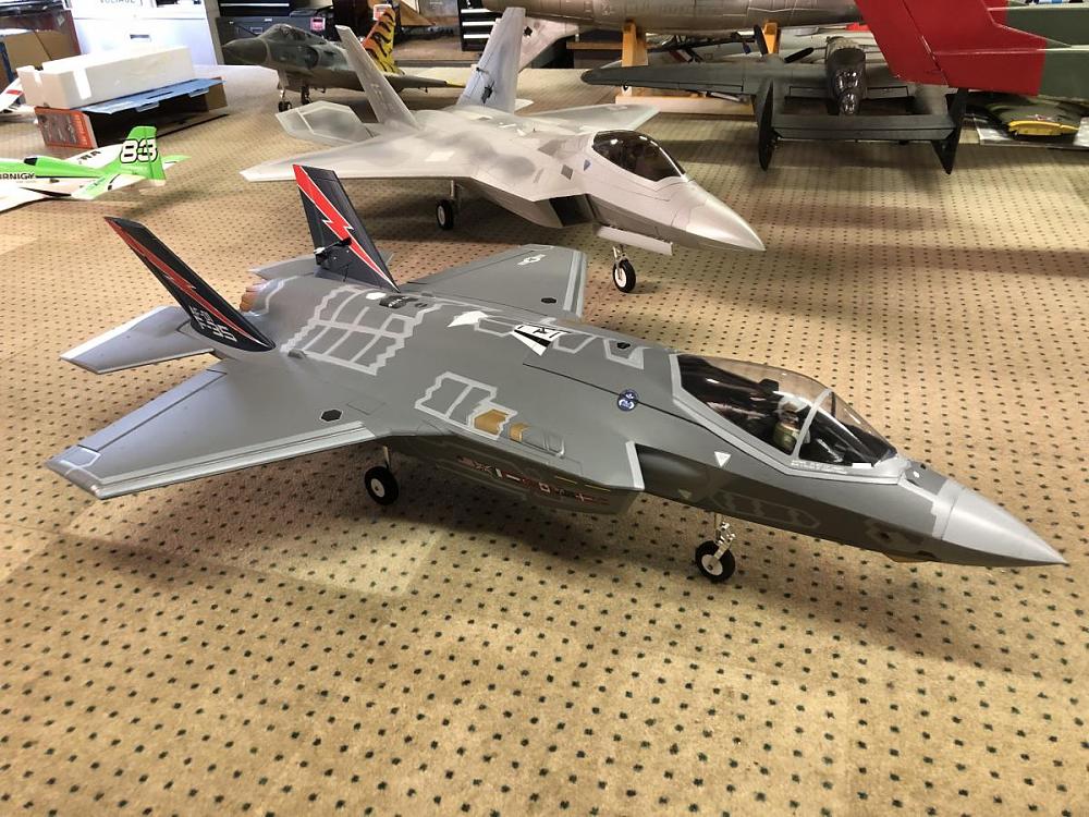

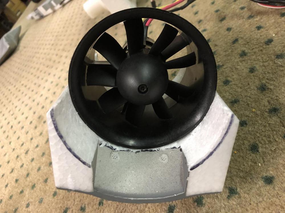

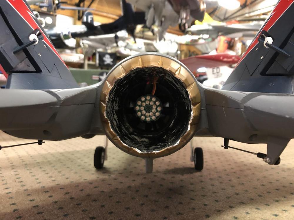

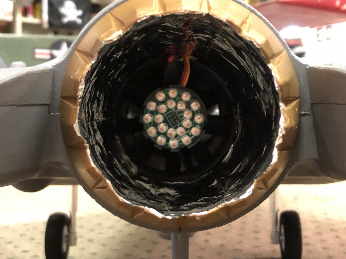

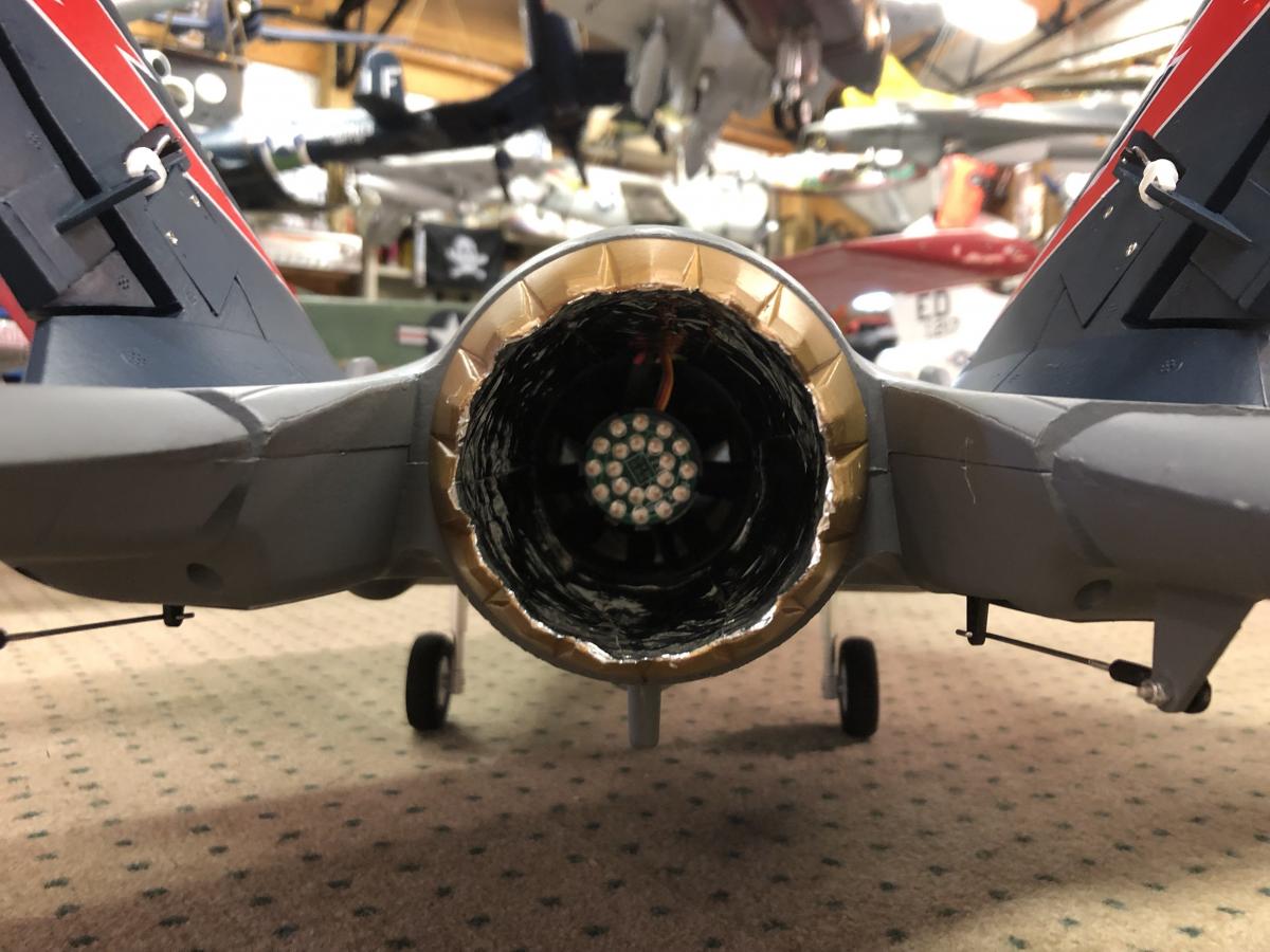

              I put the 80mm Mirage 9 blade and 100A ESC in mine :Silly:

                    Cool, have you flown it yet?
                              Yes, I have 4 flights on it...pretty fast ;)
