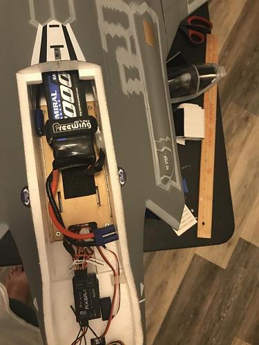

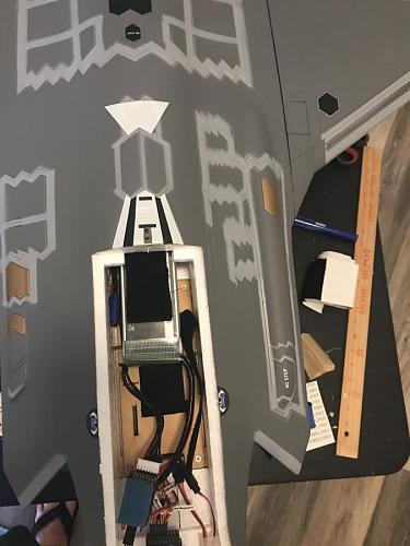

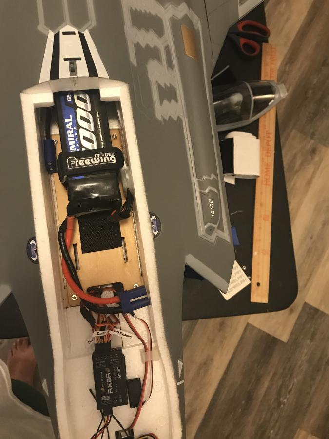

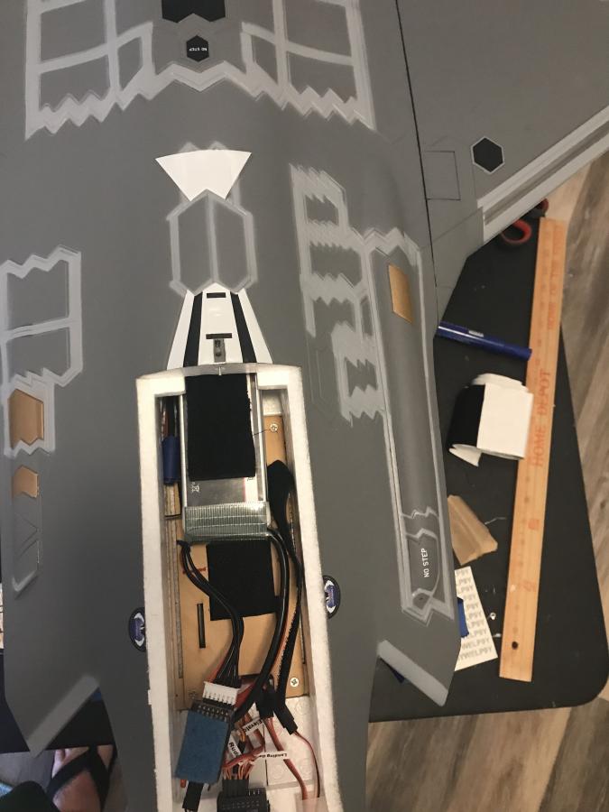

    • CG and LiPo placement.
      I have 6S-5000 lipos from Admiral and HRB, below are my placements...both are as far back as they can be pushed. They both balanced on the corner of the panel that Alpha/James highlighted in Yellow.
      Click image for larger version  Name:	F35 Lipo HRB.jpg Views:	0 Size:	61.0 KB ID:	198551Click image for larger version  Name:	F35 Lipo Admiral.jpg Views:	0 Size:	69.0 KB ID:	198552
      • Looks good! What's plugged into the balance tab in the first pic? Telemetry?
        • Yes, Evan FrSky setup with lipo monitoring for the lowest cell and total voltage on an audible callout, it's the feature I like the most about my Horus radio...although the rock solid ACCST system doesn't hurt either!
