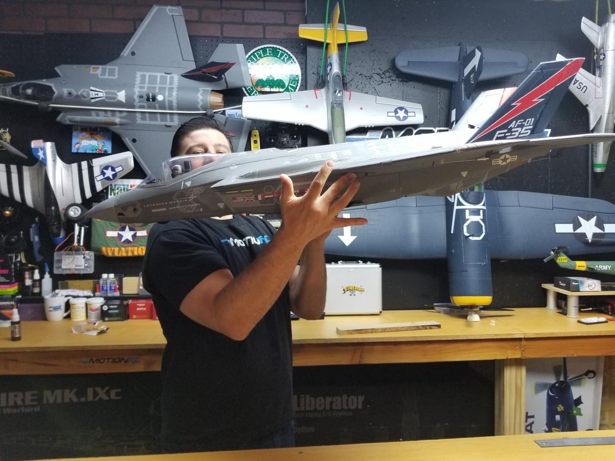

    Your battery shouldn't be "all the way forward".... more like "most of the way back". See James' photos that show his battery position and finger balance placement:

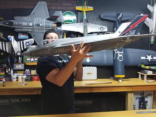

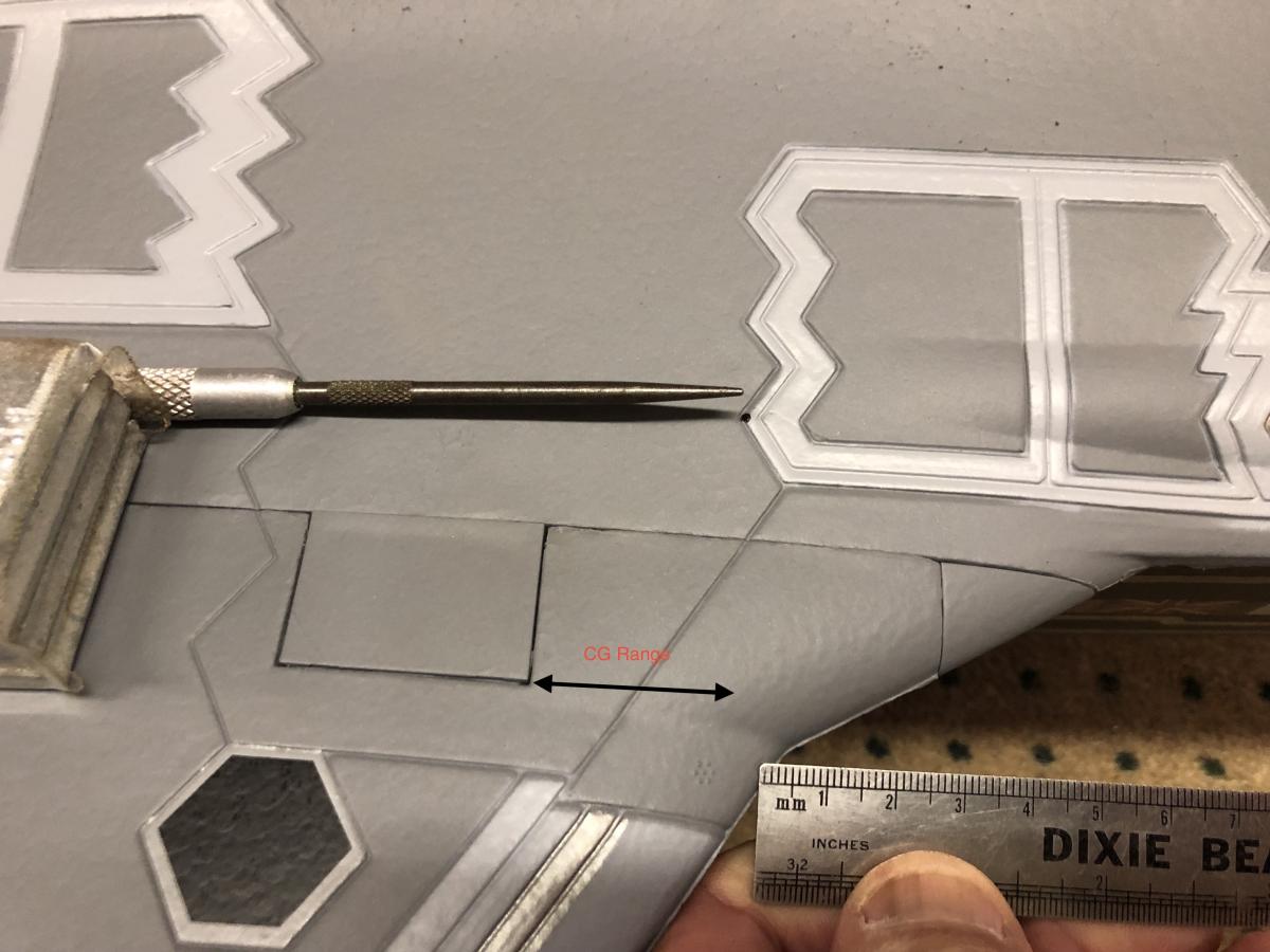

              #186

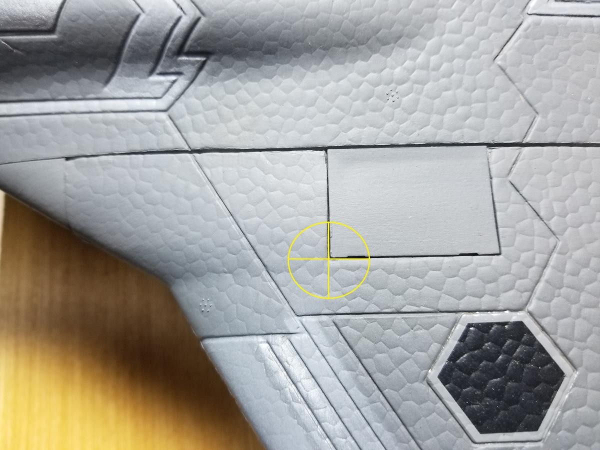

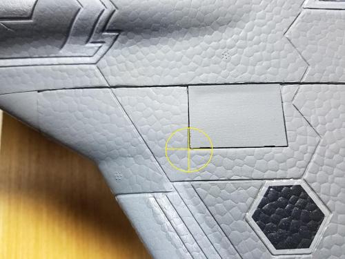

              Hi guys, please see James' photos in this post #133 two pages ago to clarify the CG at which he and everyone else at Joe Nall flew the F-35:
              https://www.hobbysquawk.com/forum/rc...931#post197931
              Measurements vary based on the point from which you're measuring... That's what's contributing to the confusion. The downsized reference drawing didn't help. But if you look at James' photos it clearly shows a physical reference point that is on everyone's aircraft that is visual (where the foam and plastic meet), and doesn't require a ruler or any guesswork. Look at the picture, match it, and you're good for maiden with slight nose heavy. Adjust per your preference from there on subsequent flights.
              Step 1) Locate this position on your aircraft:
              Click image for larger version  Name:	image_40714 (1).jpg Views:	0 Size:	156.2 KB ID:	198385
              Step 2) Put your finger at that position under the aircraft, with the aircraft upright, as shown in James' picture. That's the CG where all of our F-35 flight videos were flown. It's a more than safe starting point.
              Click image for larger version  Name:	image_40713.jpg Views:	0 Size:	192.5 KB ID:	198386
              Freewing's CG is about 4mm forward of that point, which is still a safe CG, it's just hard to decipher from the diagram, hence these real life pictures.

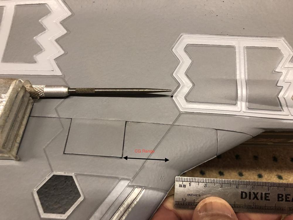

                    After several flights on mine I have the CG set here (which is within the range in the manual) and it handles great if you like to fly high alpha stuff which I do :Silly:
                      #190
                      To simplify, how many millimeters forward of the plastic edge is your preferred CG located?
                      James and others are flying at the plastic edge. I fly ~4-6mm forward of the edge. It looks like you're flying about 25mm forward of the edge, if I'm reading your picture correctly. Which would be approaching tail-heavy but as you said, nice for high-alpha flying.
                      This bird has quite a wide CG range.
