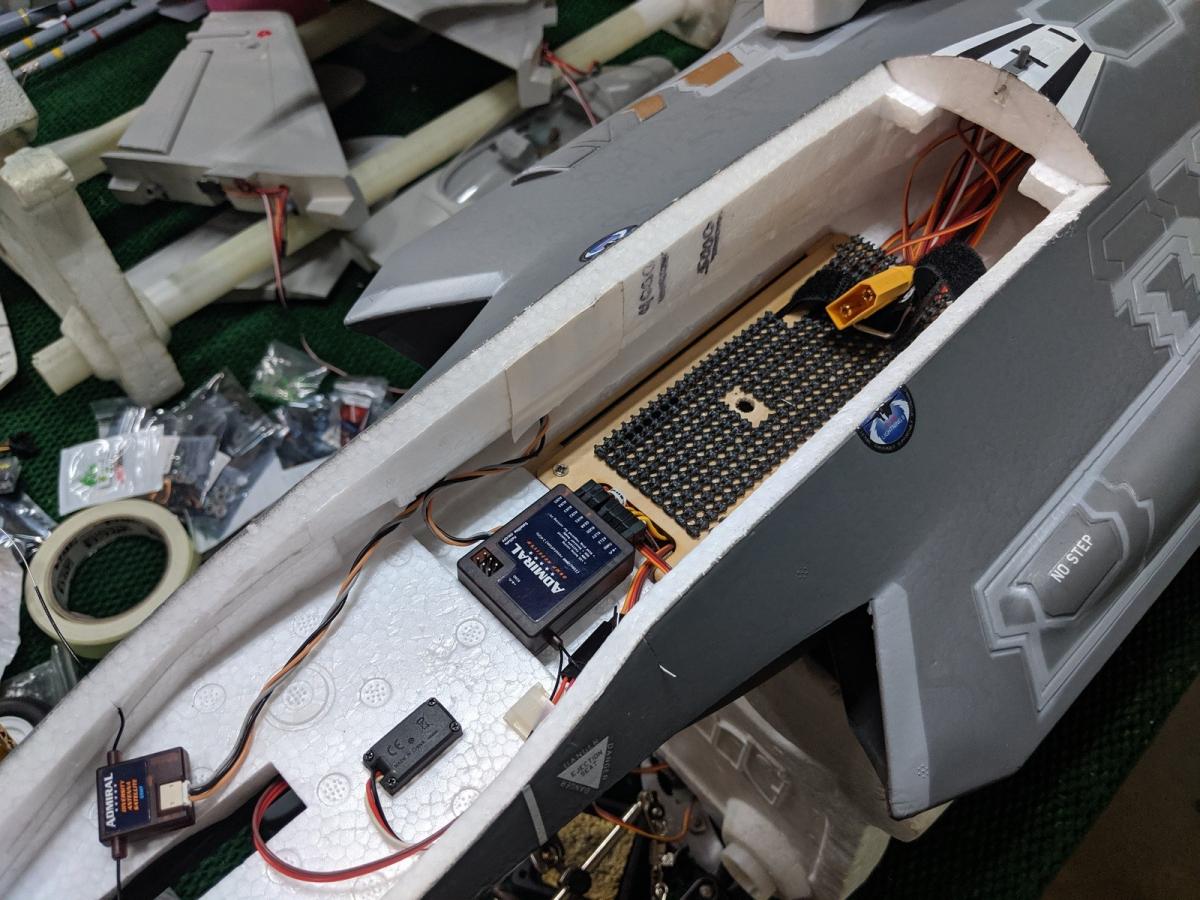

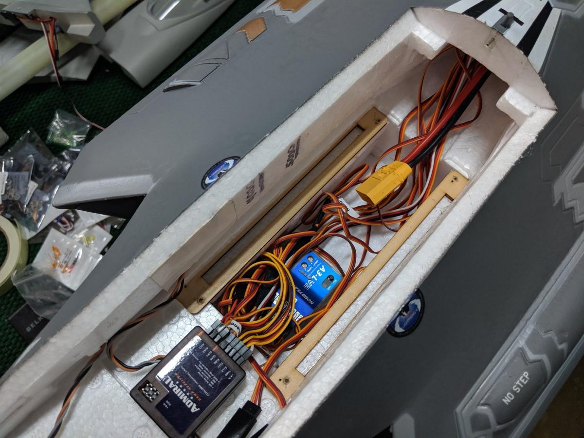

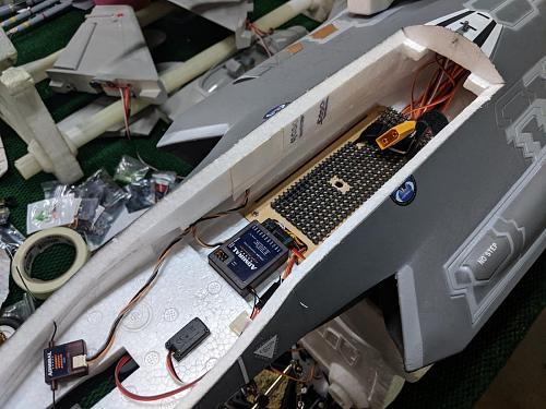

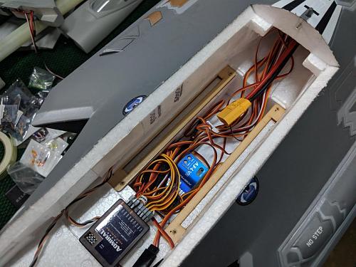

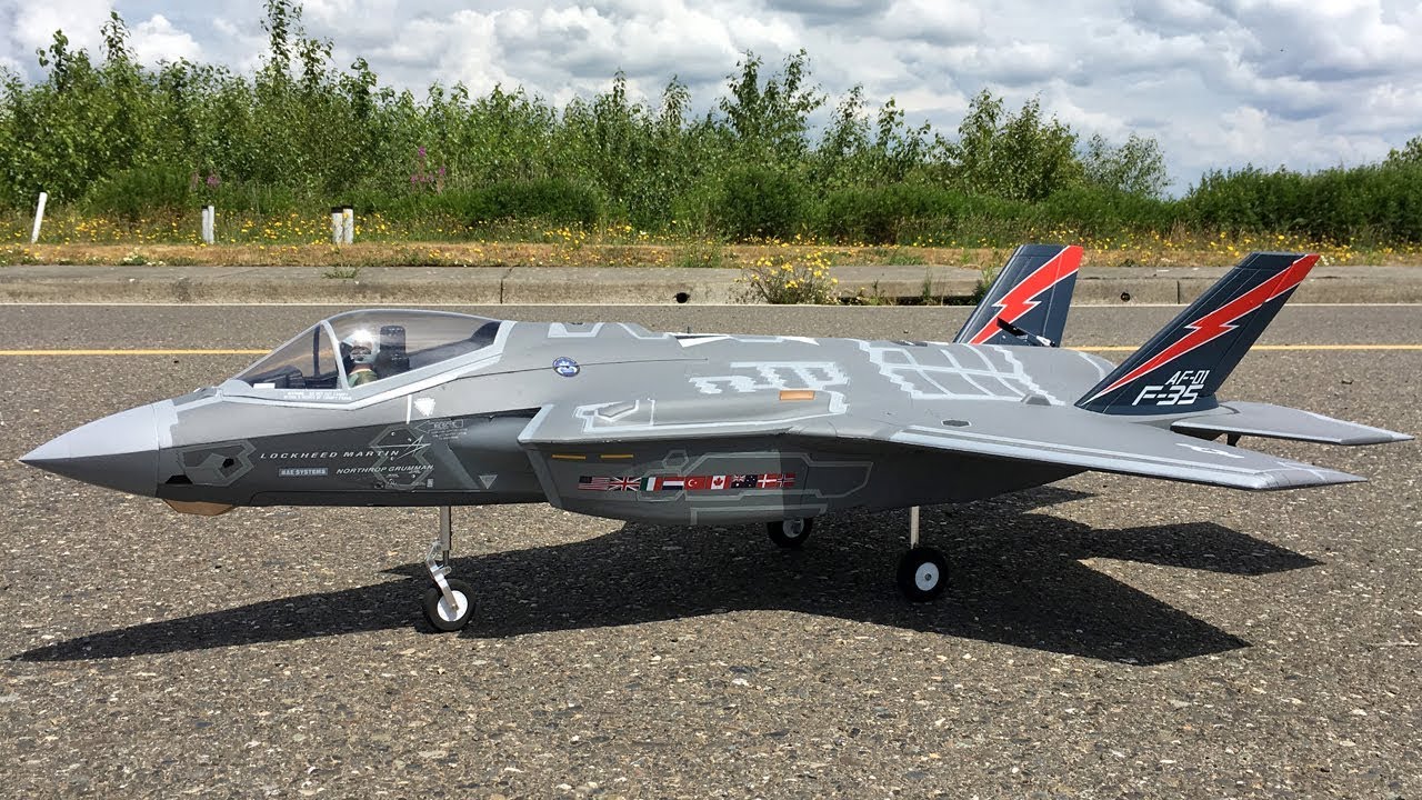

Sorry for the delay. Here is how I have mine set up. Gyro is mounted under the battery tray. There is a hole in the tray to allow adjusting the gain if necessary but once set it typically doesn't need to be messed with anymore. I turn gain 2 all the way down and set gain 1 to about 10 o'clock to start with. You can tie it to a switch to turn it on or off from your Tx and adjust the gain in flight if you desire.Just make triple sure your directions are correct.I have been told the Gyro needs to be installed on the point of the G of G .I have my C of G on the little plastic square on the wing making all most impossible to put the Gyro there in the fuselarge .So where has everyone put their Gyro in the fuselarge ?Does it have to be right on the C of G or will it OK up in the front of the Battery bay next to the recediver
Thanks a lot for that .That look fine and even I can fit it there .Thanks a lot for that .It is really good of you .Thanks again :Goodbye:Comment

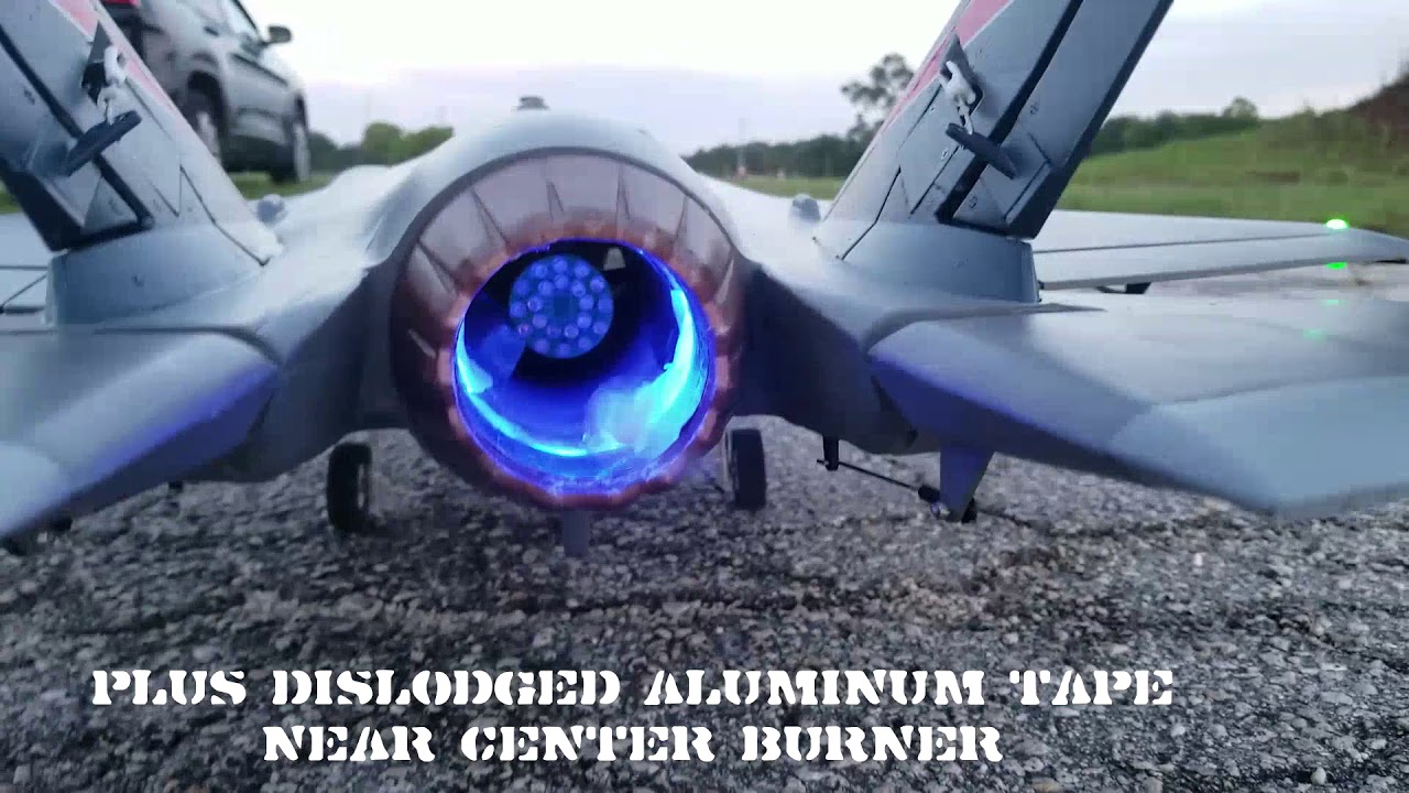

Fortunately it came down in one piece. Gotta be more careful when installing reflective tape in the exhaust. I think I will just remove it all or install a t...Comment
