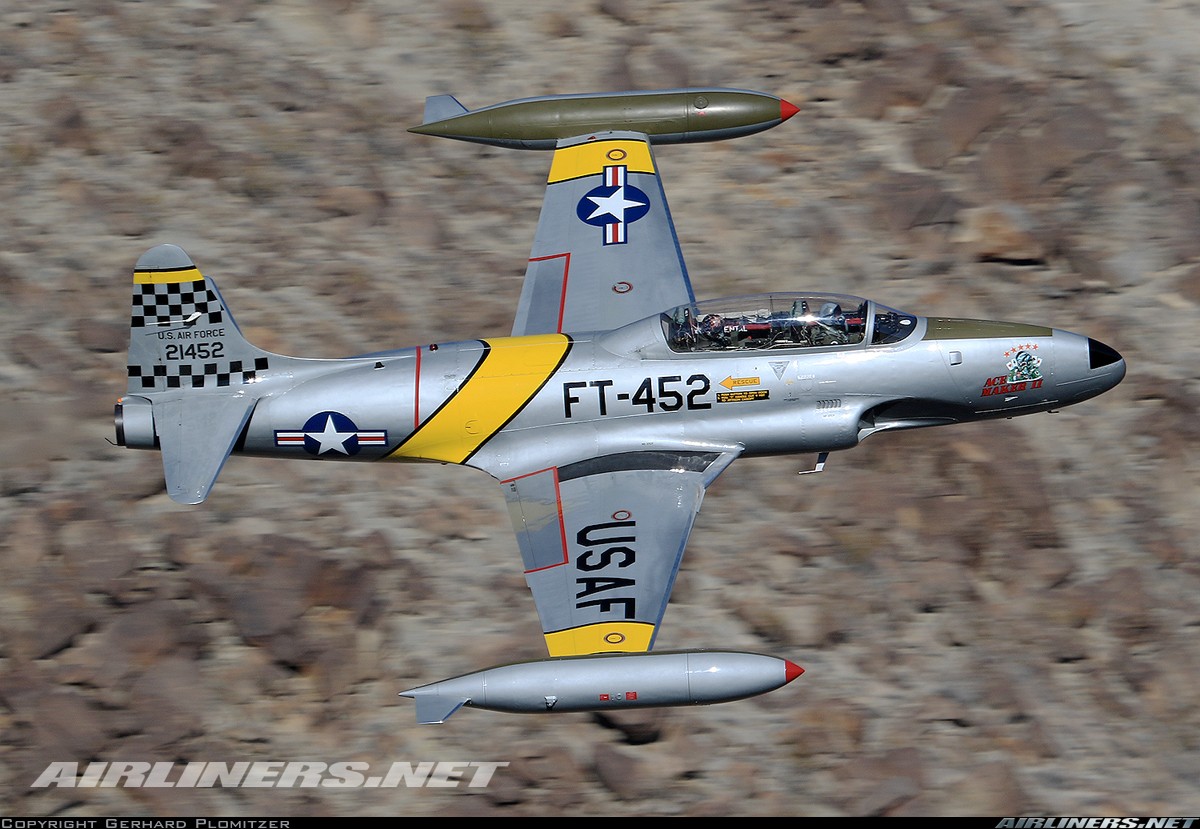

        Originally posted by Russ
        Nice Alpha...so THAT's why my next new 6 Cell T-33 is taking so long ;)
        Yeah...... mine too!!

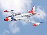

            Beautiful! Click image for larger version  Name:	T33 tbird.png Views:	0 Size:	29.5 KB ID:	201489Sorry for the aside...back to F-35.
