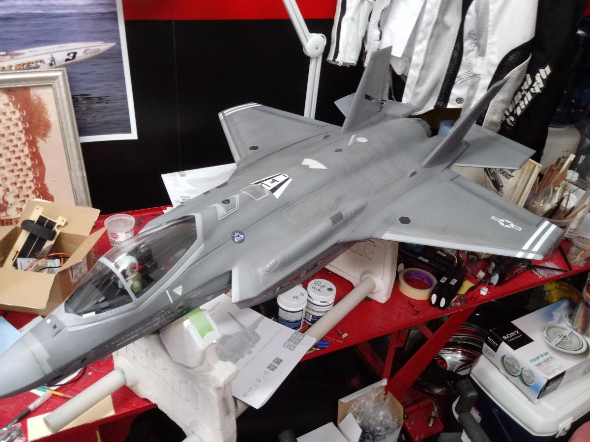

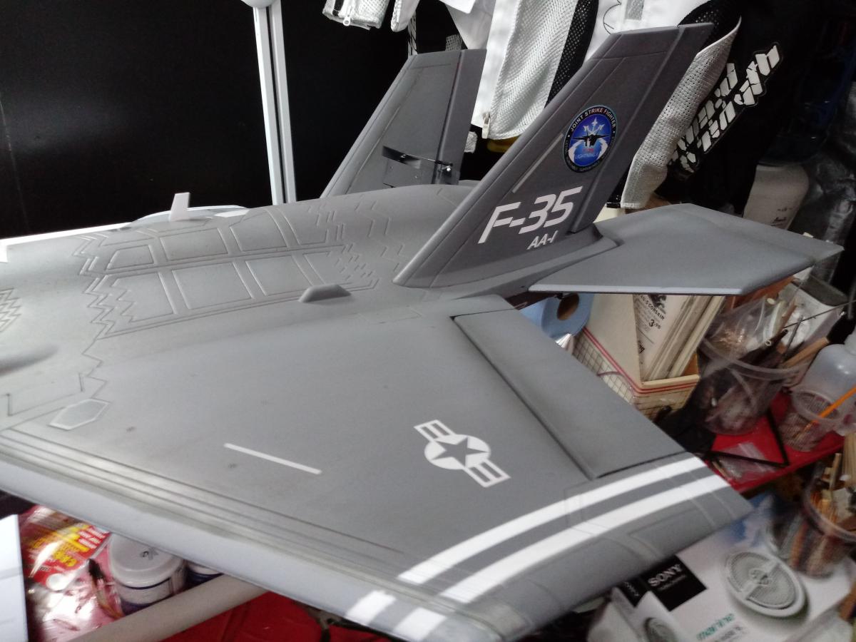

                        Almost ready for maiden. waiting for Callie graphics for the verticals, and the light burner.

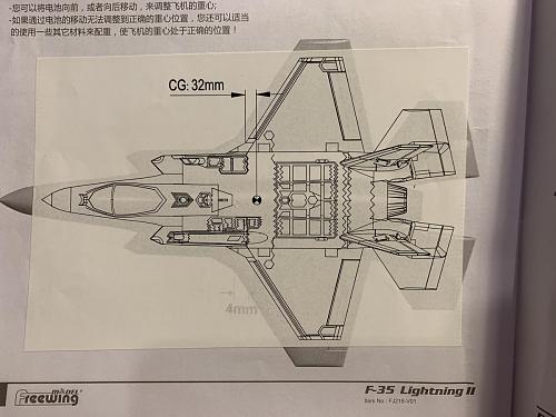

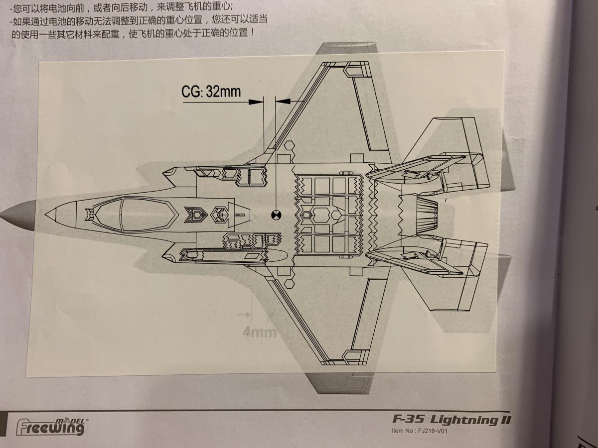

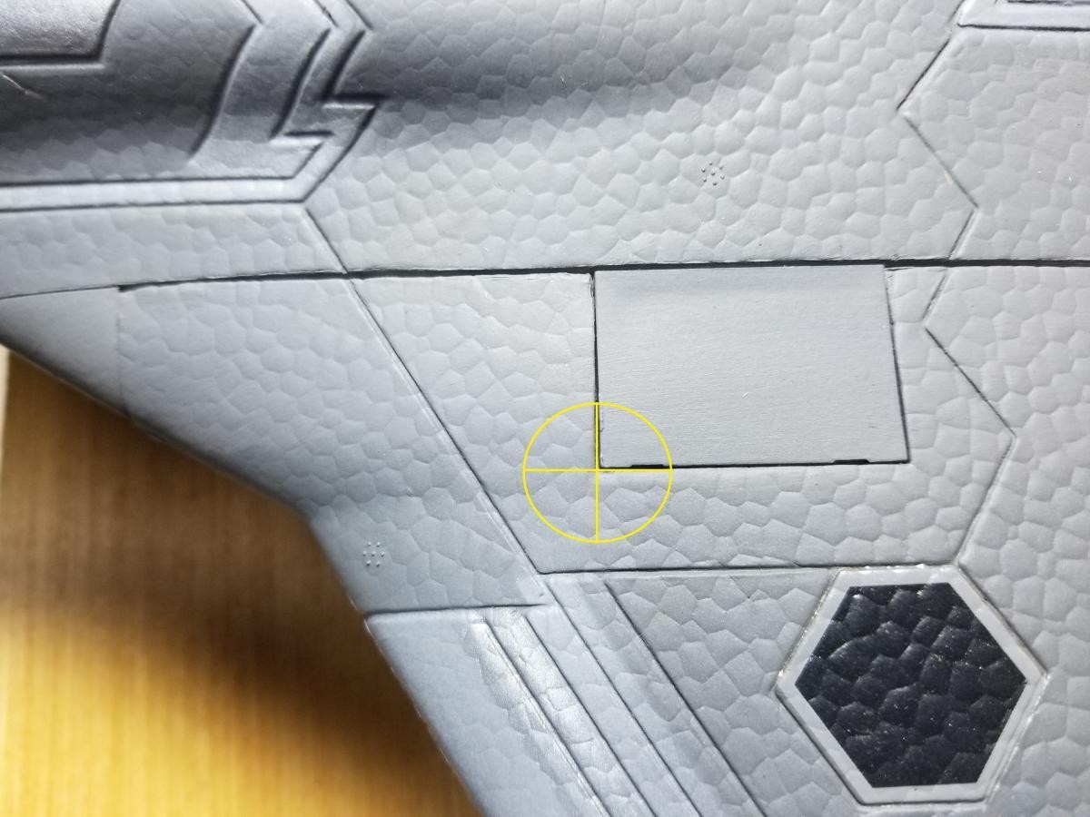

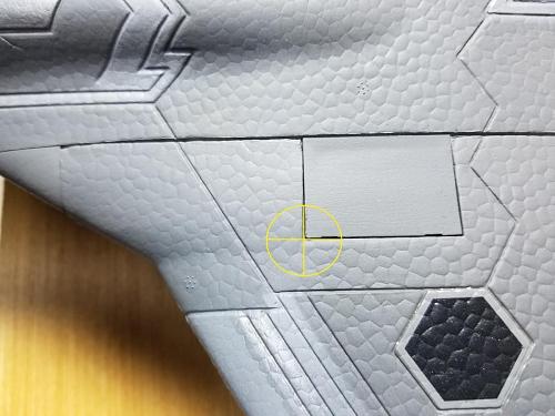

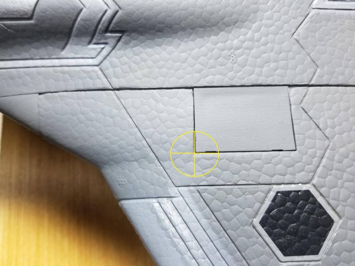

                                    I'm looking for guidance with CG. I'm having trouble taking off from grass and I have had a few keyboard warriors tell me the CG is to far forward. When I asked them specific questions they admit they don't have this plane but it is "common knowledge". Geezzz
                                    I'm in Kansas City which is 1000 feet above sea level and it is August, so it is hot. I know I need to be trying this on fresh cut grass on cooler days. I am using the Admiral 6S 4000 packs and I balanced at the forward edge of the plastic bit on the bottom of the wing as shown in earlier posts. I balanced right side up with the gear down.
                                    Question 1 - Anything wrong with my balance technique?
                                    Question 2 - How far back can I push the CG without getting in trouble with flight stability?
                                    Any and all help with be appreciated.
                                    Thanks

                                      "Keyboard warriors" and "Armchair aeronautical engineers" - gotta love 'em. I do have this plane and I have given up taking off from grass. I'm using a Admiral 4000 and a Graphene 3000, both of which weigh very close to each other. I balance upside down with gear up. I have my own rationale for doing it this way. Others don't like this and have their own reasons for doing it their way. I've always done this way and shall continue to do so. I've got the battery shoved back about 15mm further aft than what is stated in the "revised" addendum of the manual. Below you can see the added revision that was stuck over top of that page in my manual. That's what I started with but tried moving it aft for grass. Still no luck on fairly plush grass. There's just too much resistance and the plane reaches its terminal velocity and stays at that speed for the whole length of the runway. It's just not fast enough to take off and that's with elevators on high rates.
                                      Click image for larger version  Name:	IMG_3445.JPG Views:	0 Size:	118.7 KB ID:	210077
                                      Here is the latest information provided by Motion RC in the support section of the product page:
                                      Click image for larger version  Name:	f-35v3cg.jpg Views:	0 Size:	156.1 KB ID:	210079
                                      As you can see, the revised CG from my manual and what's updated on the product page are very close. Unless your grass is like a golf green or is mowed prairie stubble, think you'll find it hopeless to take off. I only fly this plane now from a smooth surface (GeoTex).
                                      If you've seen Stuart's video of his plane's mod's and his grass field, you'll also notice that his field is not very plush. I could have taken off at my old grass field, which was mowed prairie stubble - very rough and bouncy but much less resistance. In fact, the roughness and bumps would help bounce a plane like this into the air. I have the F-16 with the same power system as this plane and it could take off from that old field. I can't take off from the new grass field.
