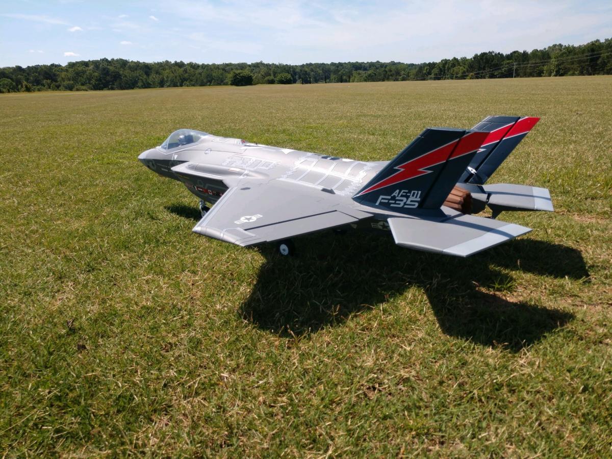

                  Maiden on mine went very smooth Saturday. No gyro for me and it flew great. Really impressed with the speed and on the 2nd flight, I didn't have any trouble slowing it down.
                  As a side note, now that the 2210kv fan/motor setup is available, I have one on the way for my FW Hawk as well.

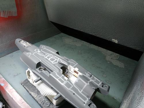

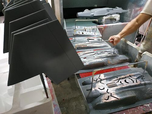

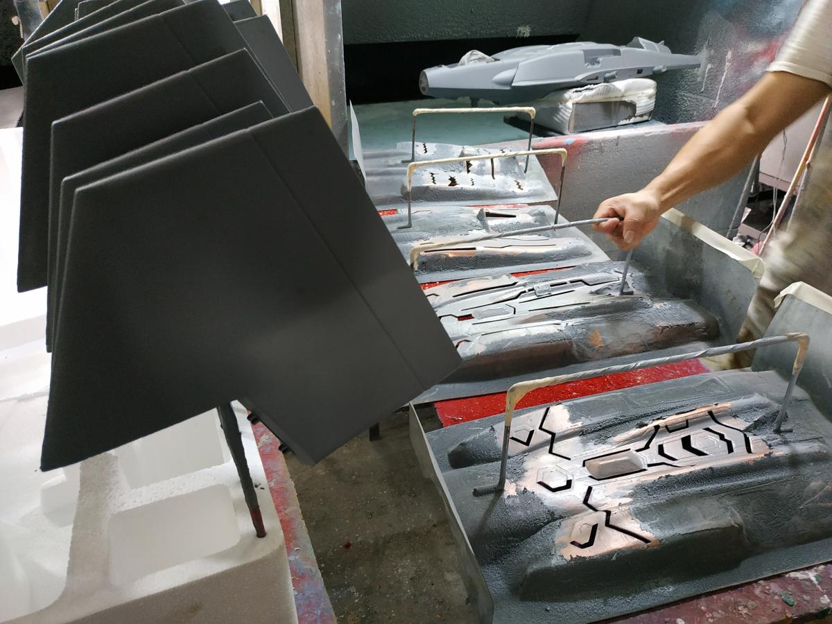

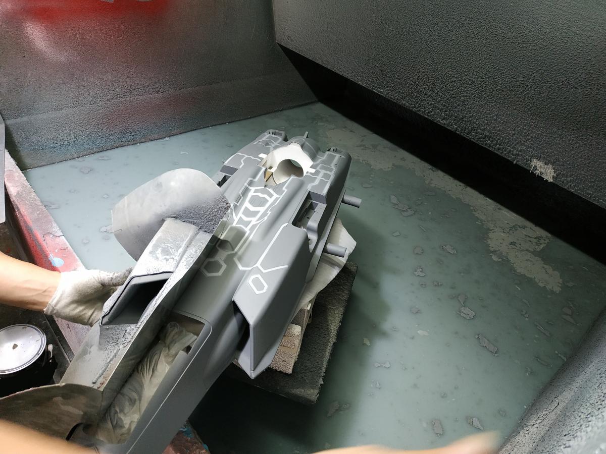

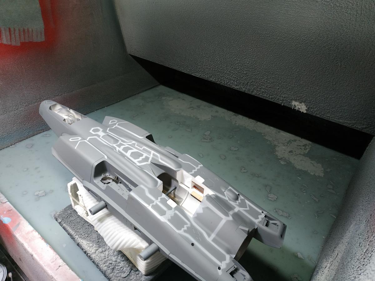

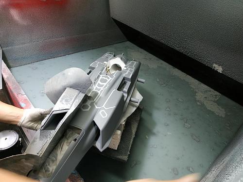

                              Pick up a copy of this month's Model Aviation to see a special "How It's Made" article we provided to show a bit more behind the scenes to bring models from our desk to your hangar.
                              One of the steps we discuss in the article is painting. I could spend an entire magazine discussing this process, but in the meantime here are a few more centering on our newest Freewing 70mm F-35. The paint masks are made from sheets of copper. They are molded and hand shaped to conform to the surface of the foam down to every panel line. Due to the size of the model, many masks were required to depict the intricate RAM paneling typical of the F-35. It is far and away our most complex 70mm class EDF to date.
                              Click image for larger version  Name:	IMG_20190619_145543.jpg Views:	3 Size:	141.8 KB ID:	201211
                              The bottom fuselage alone requires six of these overlapping masks, plus the topside fuselage, wings, intakes, nozzle, and other parts, comprising a single masking set. Below we can see the large paint mask needed simply to mask off the intake color. The copper isn't visible under the paint, but the mask is cleaned frequently to maintain performance.
                              Click image for larger version  Name:	IMG_20190619_145337.jpg Views:	2 Size:	153.9 KB ID:	201212
                              Multiple sets of paint masks are created to meet the production rate across multiple painting booths. Each painting booth uses water catchment systems (the blue/gray "floor" seen in these pictures is actually circulating) and air filtration/ventilation systems that meet increasingly strict environmental standards. After painting the F-35's six colors, the models are cured then set for decaling, yet another process along the way...
                              Click image for larger version  Name:	IMG_20190619_145327.jpg Views:	3 Size:	138.1 KB ID:	201210
                              Hopefully this peek behind the scenes gives you yet another reason to value your F-35. Thanks again for your support!

                                        Very well written Alpha, I enjoyed it immensely. So in other words there's a bit more going on than my painter's tape, shake the rattle can and go? ;)
