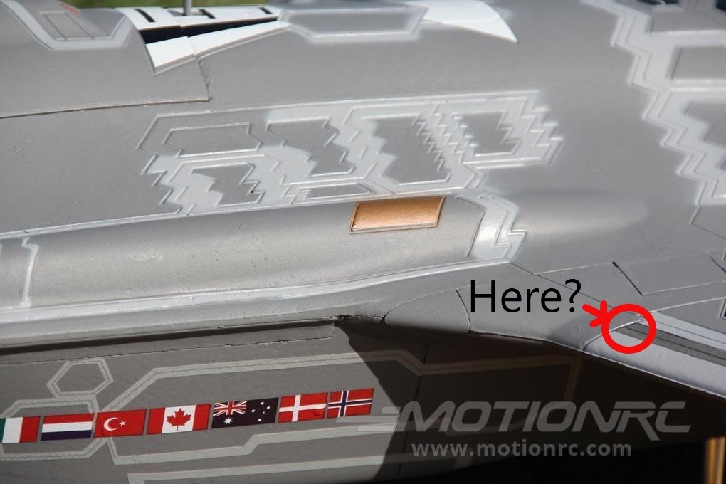

                      I maidened mine this afternoon. My CG was set at the molded leading edge flap panel line.
                        • 5397
                        #131
                        Like this? I assume it flew well since it's just a little aft of how I flew yesterday and it was a little nose heavy for me.
                        • fredmdbud
                          • 451

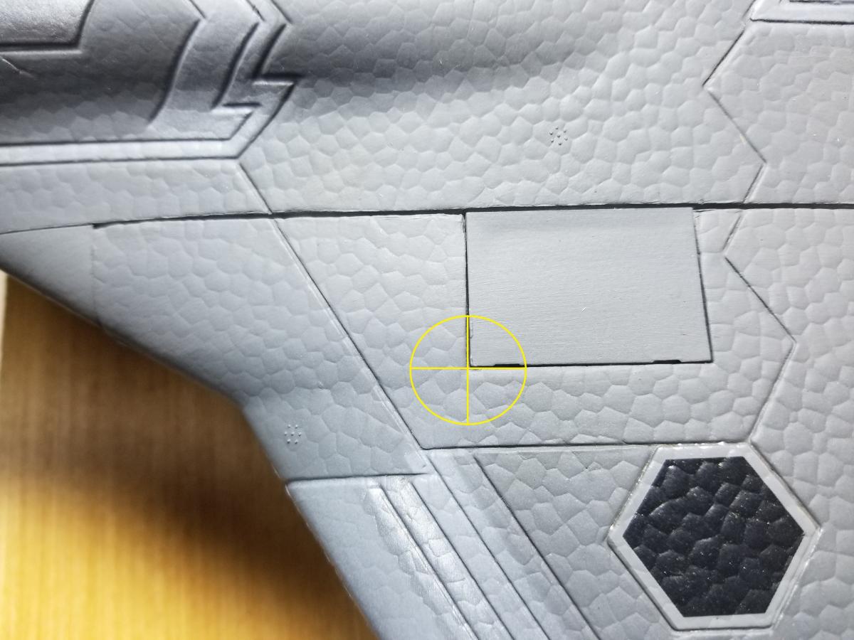

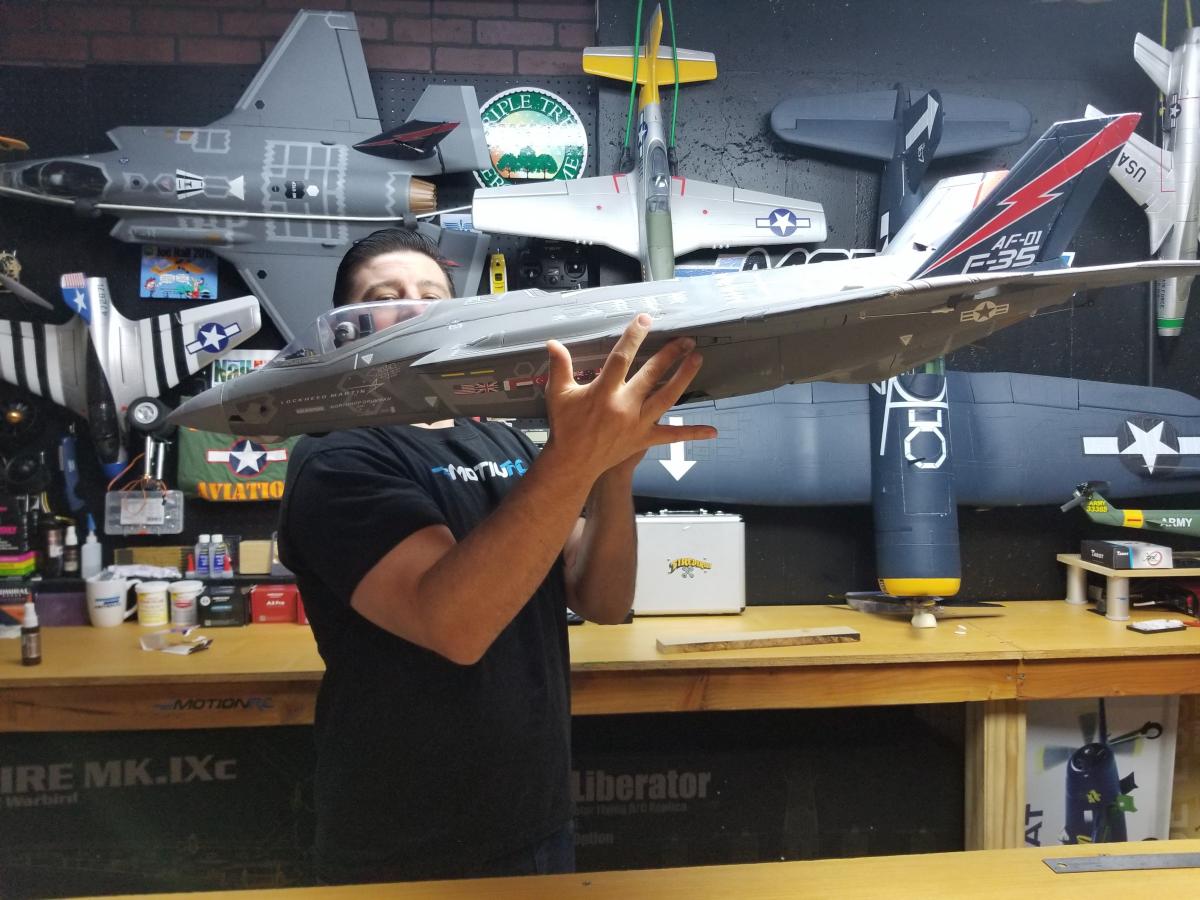

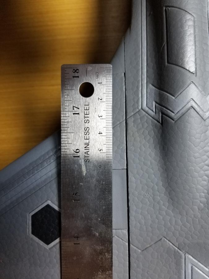

                            Hey Guys, apologies for the book CG markings, that is definitely confusing. I got the model way before I had the book CG and Alpha had me place my fingers on the nose forward corner of the plastic mount for the wing.
                            I took a picture here and an easier measurement was 60mm from the aft plastic piece at the front of the wing to the front of the plastic wing mount as seen here:

                            Basically, put your fingers right here for the proper CG point:
                              • 5397
                              #134
                              Thanks! That’s pretty far aft of where I flew it... may be why we needed more elevator.

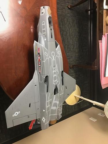

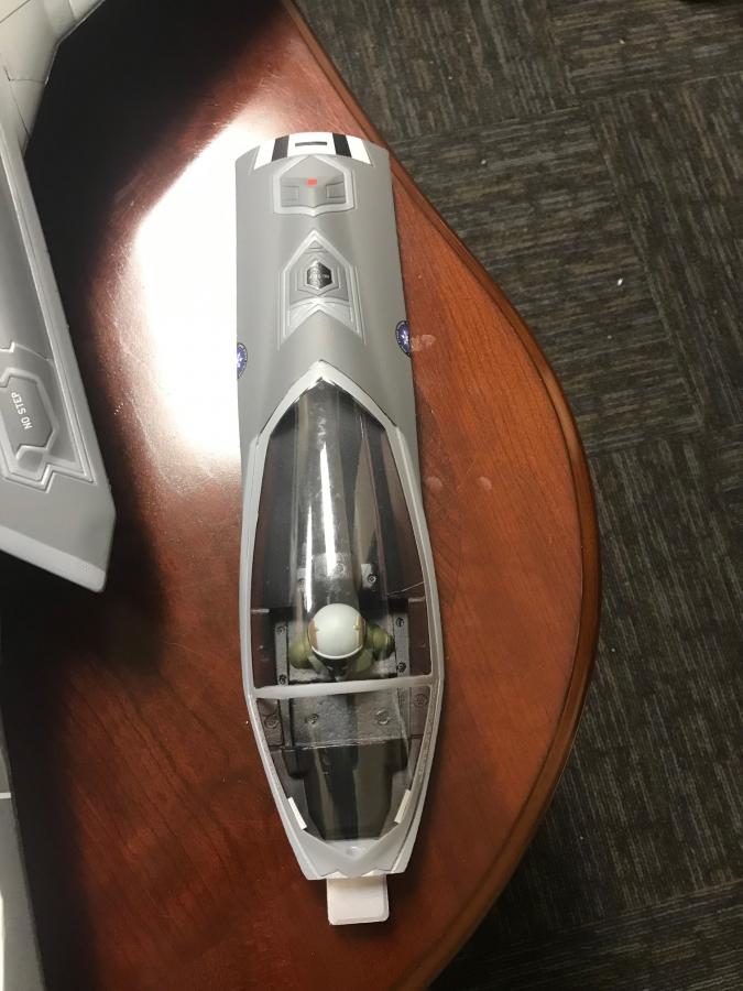

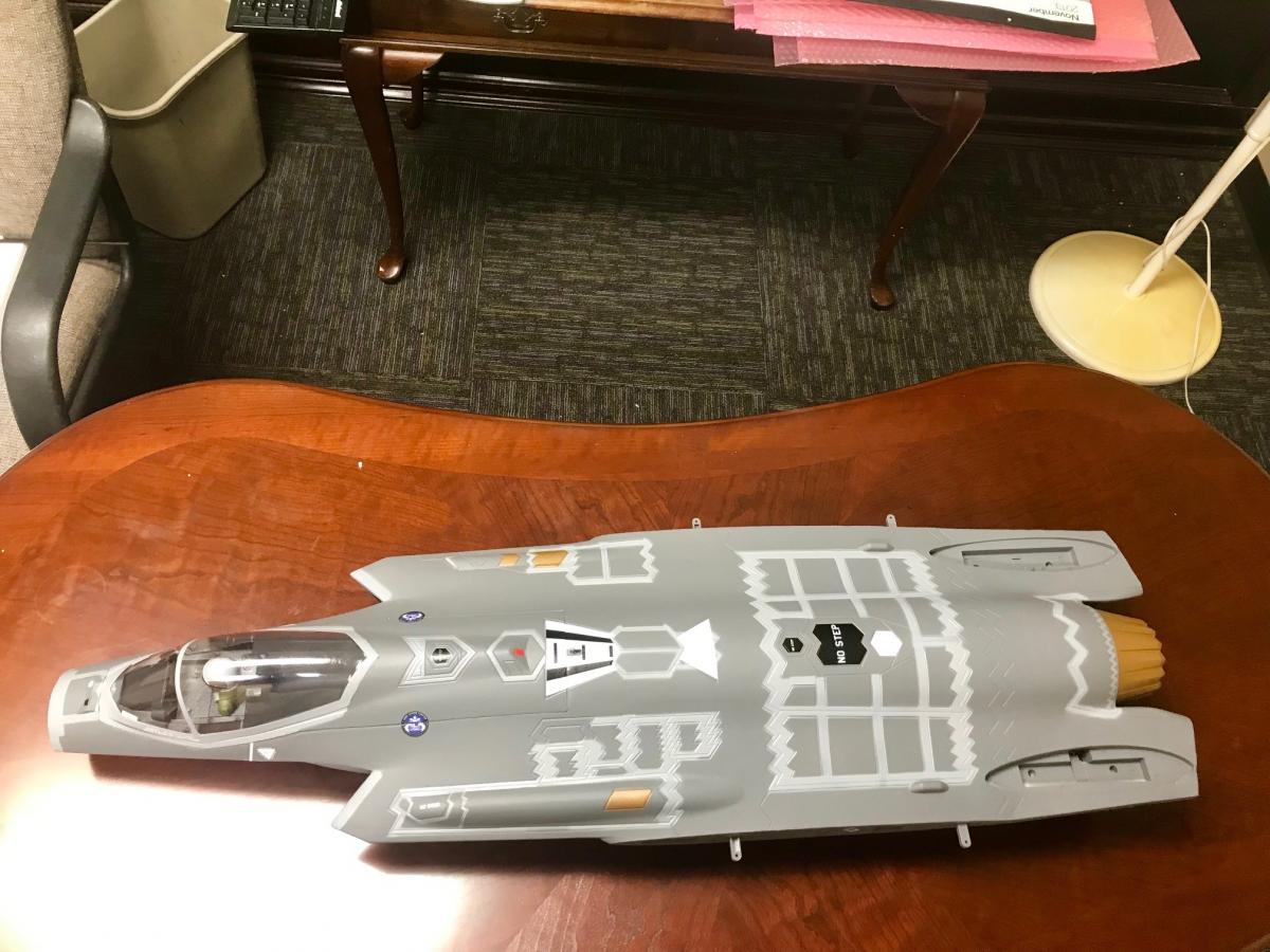

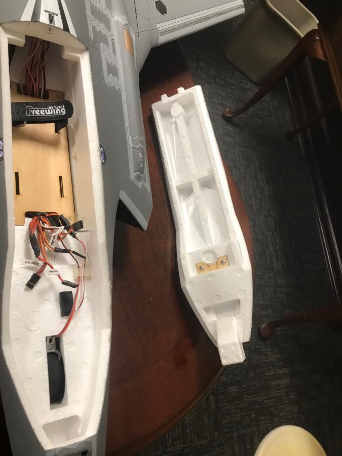

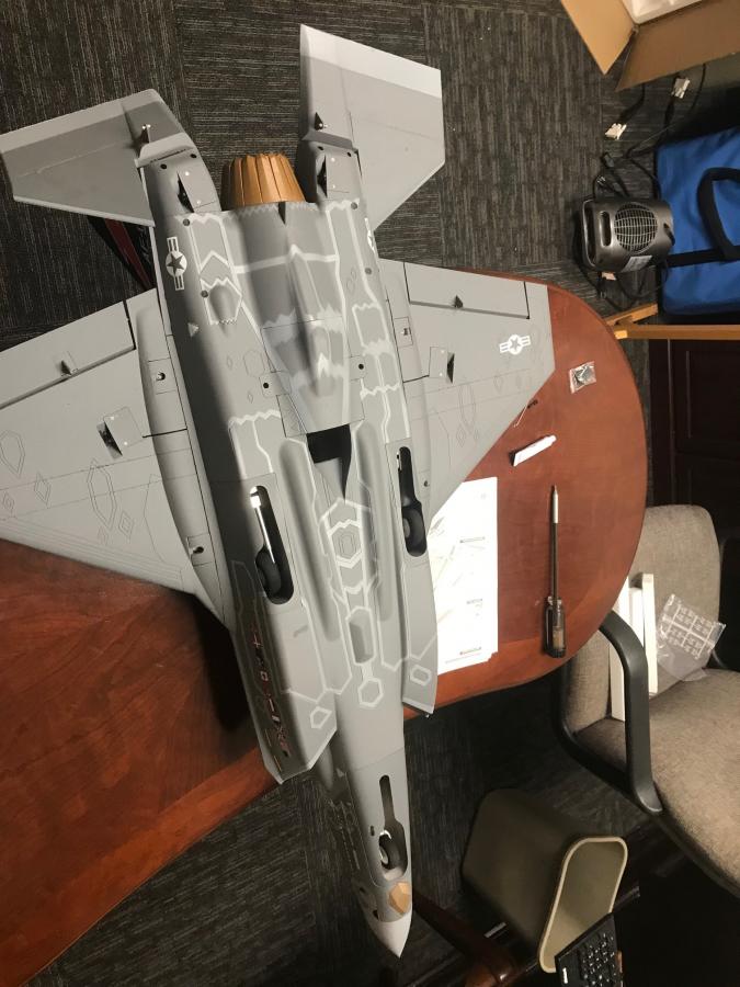

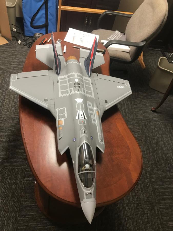

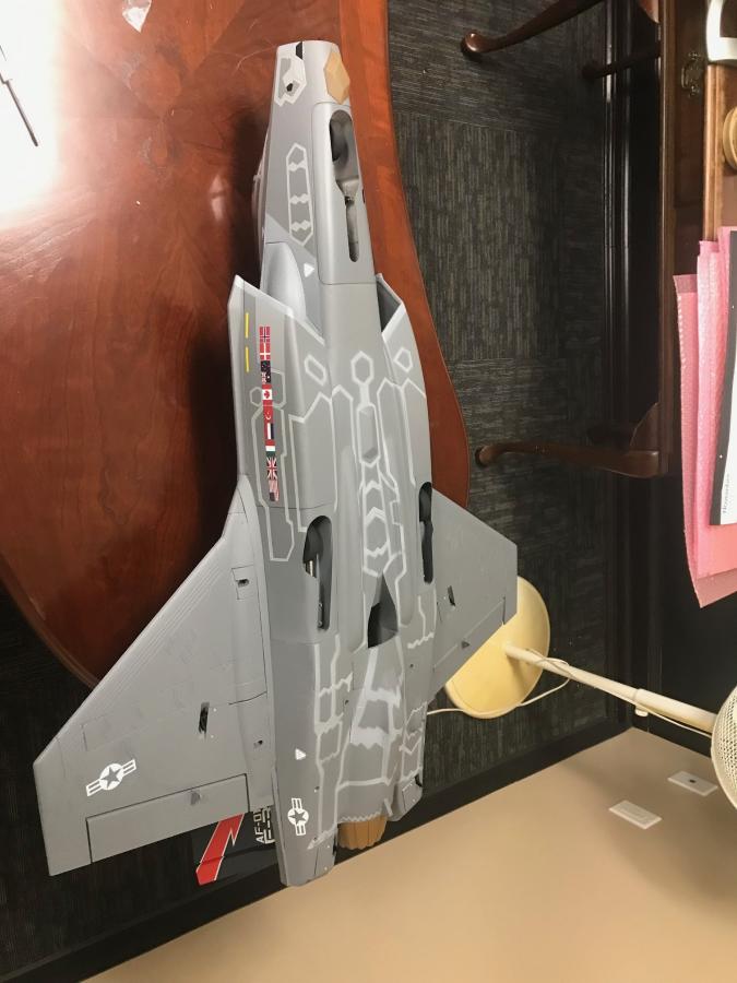

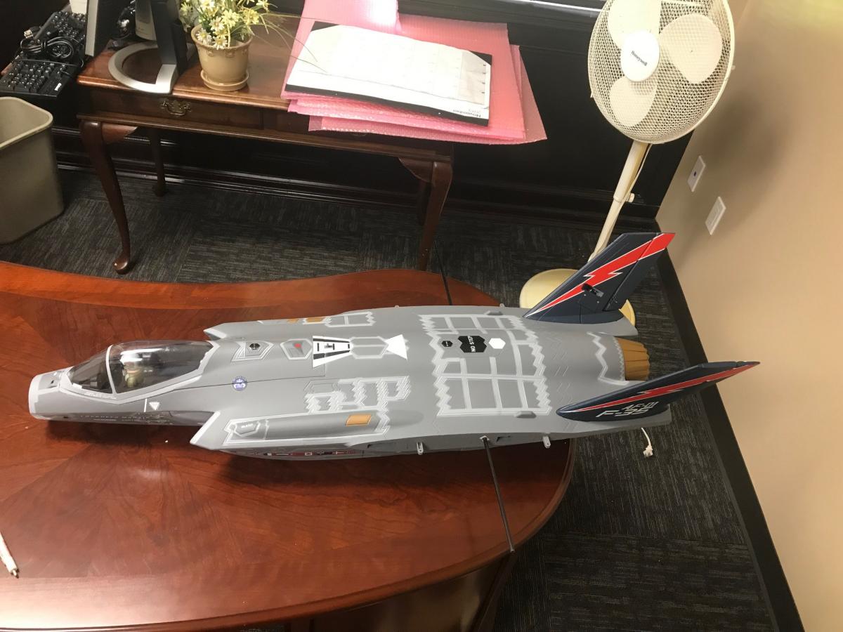

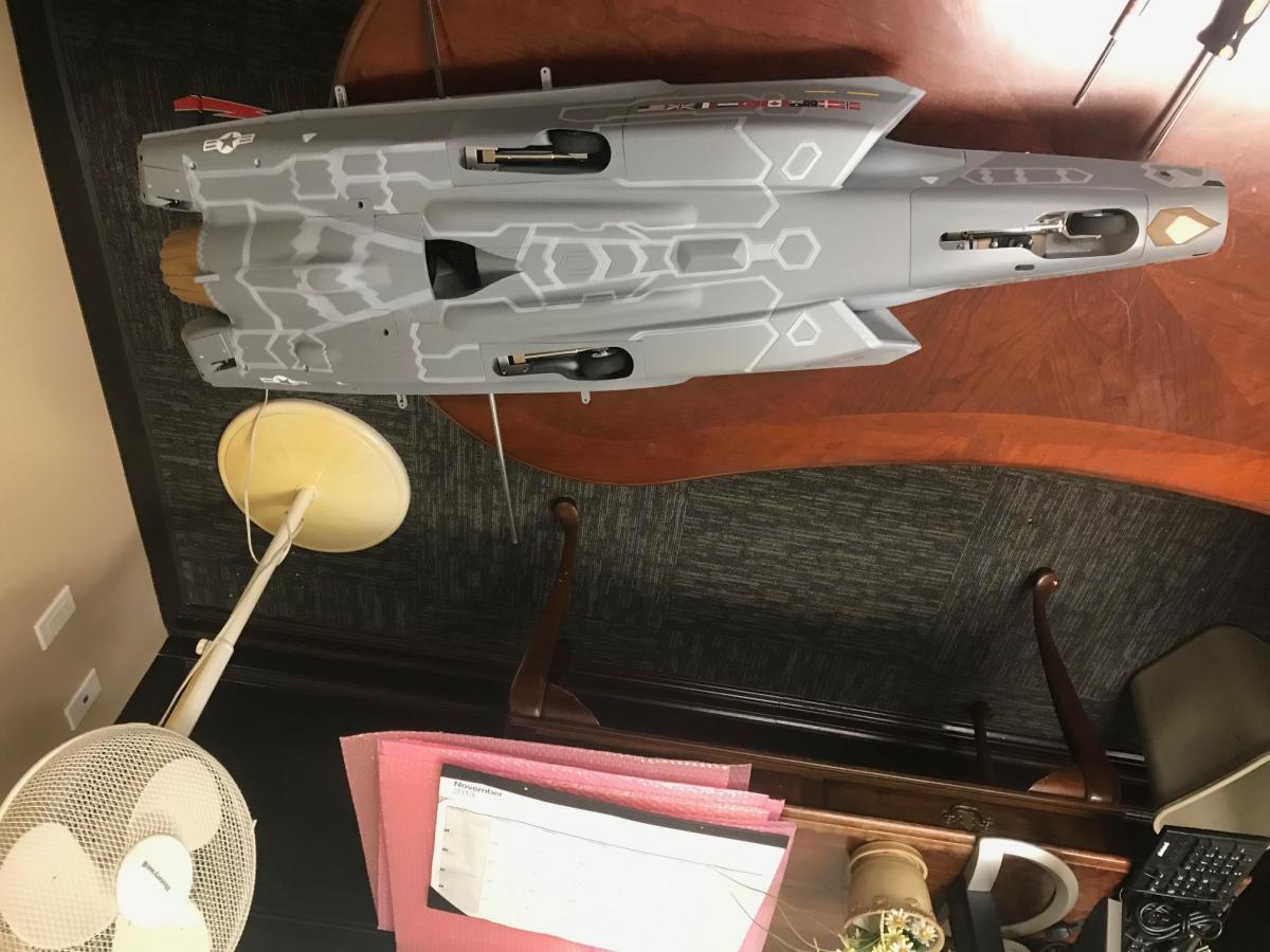

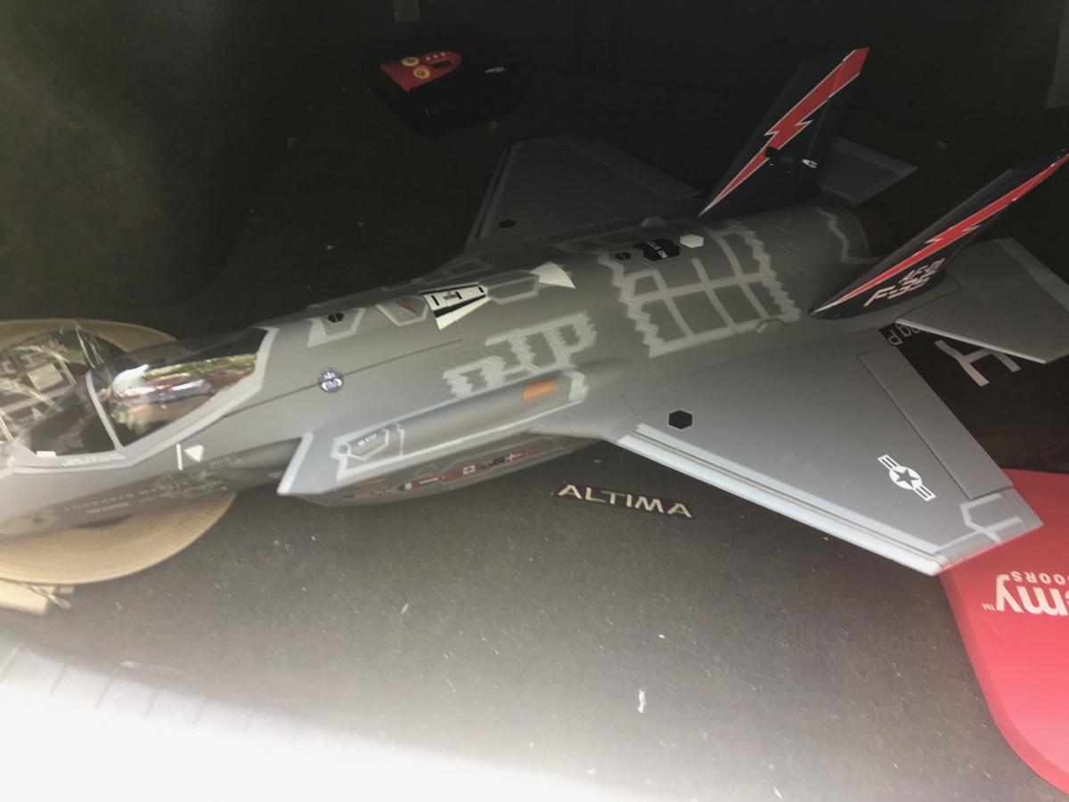

                                        Click image for larger version  Name:	F-35 trunk.jpg Views:	0 Size:	71.6 KB ID:	198000Click image for larger version  Name:	F35 bottom.jpg Views:	0 Size:	63.2 KB ID:	198001Click image for larger version  Name:	F35 Cockpit bottom.jpg Views:	0 Size:	63.4 KB ID:	198002Click image for larger version  Name:	F35 Almost completed.jpg Views:	0 Size:	80.1 KB ID:	198003Click image for larger version  Name:	F35 Cockpit.jpg Views:	0 Size:	71.6 KB ID:	198004Click image for larger version  Name:	F35 Fuselage.jpg Views:	0 Size:	128.4 KB ID:	198005Click image for larger version  Name:	F35 Rudder installed.jpg Views:	0 Size:	119.6 KB ID:	198006Click image for larger version  Name:	F35 wing bottom.jpg Views:	0 Size:	121.5 KB ID:	198007Click image for larger version  Name:	F35 Wing install.jpg Views:	0 Size:	128.4 KB ID:	198008Click image for larger version  Name:	F35 Completed.jpg Views:	0 Size:	83.7 KB ID:	198009

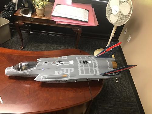

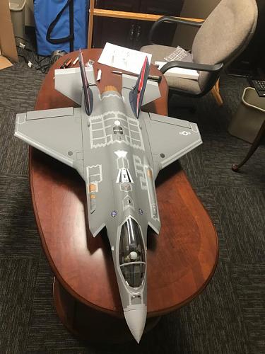

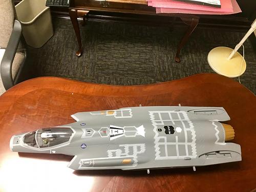

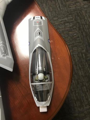

                                        I just completed my F-35 in EXACTLY one hour during my lunch at work!
                                        No radio setup just build of pieces in the box.
                                        Impressions:
                                        PROS:
                                        1. Drop dead gorgeous finish!
                                        2. No-glue build is easy and no alignment issues. (Although I'm kinda iffy on those plastic elevator hinges for longevity)
                                        3.Had an owner's manual with mine, all the basics were there but not much more. Most of you won't need it.
                                        4. All hardware included but it would have been nice if they included a phillips head screwdriver cos I don't have screwdrivers at work
                                        5. Retracts and landing gear look good and substantial
                                        6. Perfect fit in the trunk of my Nissan Altima !!!
                                        CONS:
                                        1. No screwdriver included
                                        2. Hinges were not installed at factory
                                        ...cmon Freewing that was lame! All my other Freewing come with em installed. Also, that sheet of plastic hinges looked terrible...I would never use them...I'll put in my own good quality ones (after a successful maiden)
                                        3. Underside paint flakes off easily...I barely touched it with a fingernail while installing horizontal stab and a little piece flicked off. Easy fix and I will be putting several coats of WBPU on there for sure.
                                        Looking forward to setting up the electronics and flying her sometime soon.
                                        Here are some build pics...
