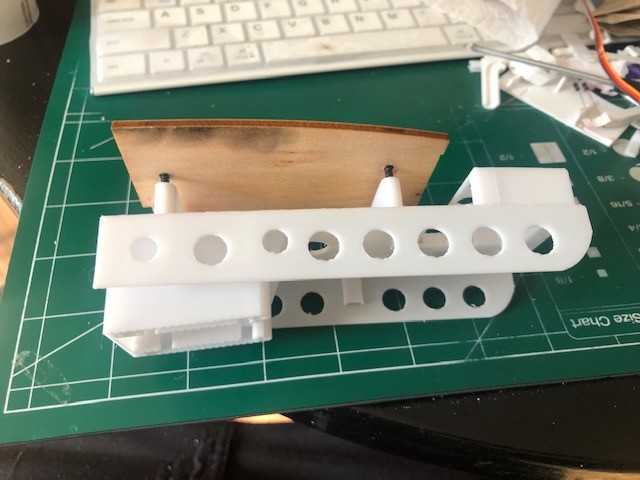

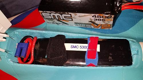

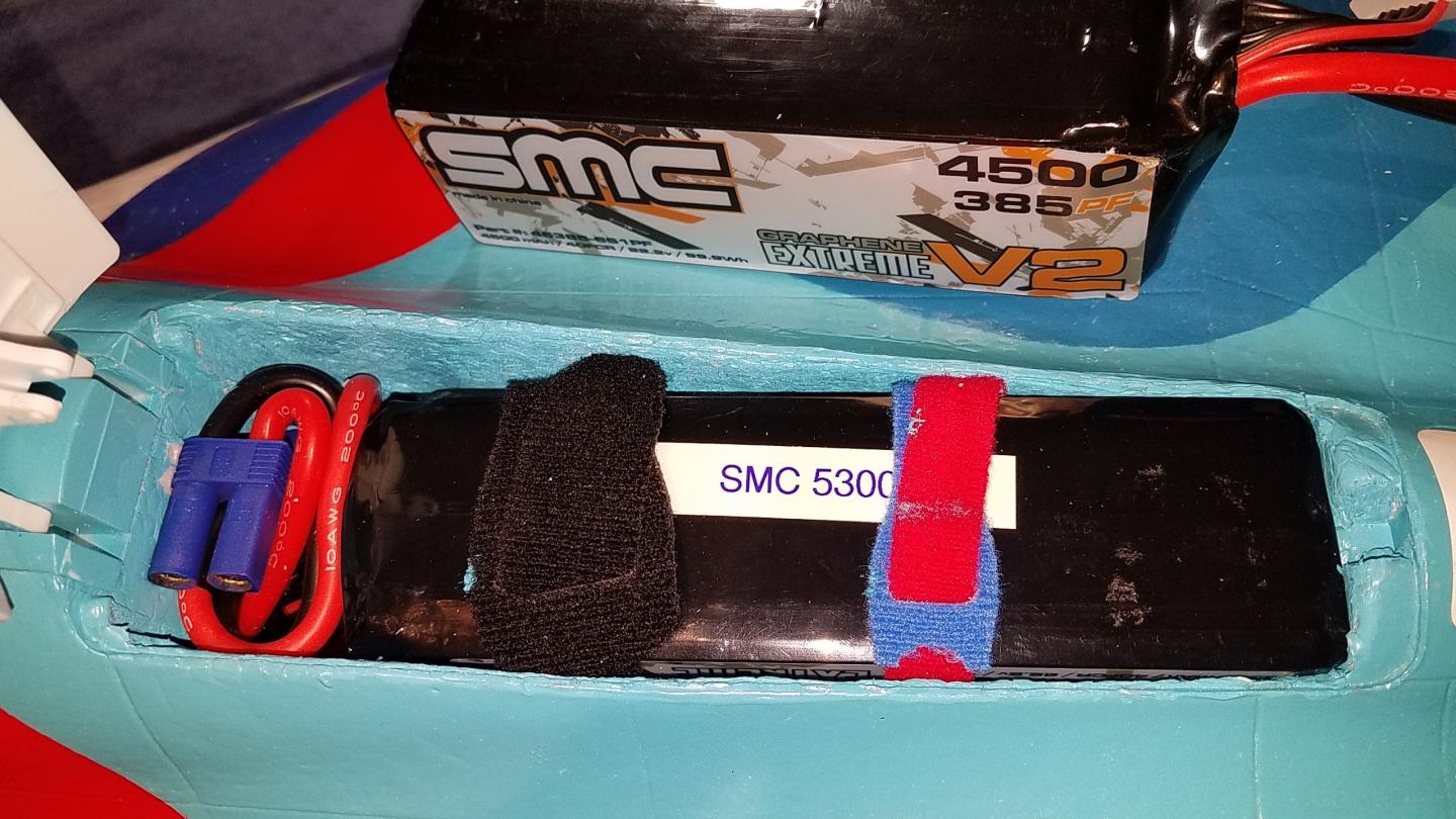

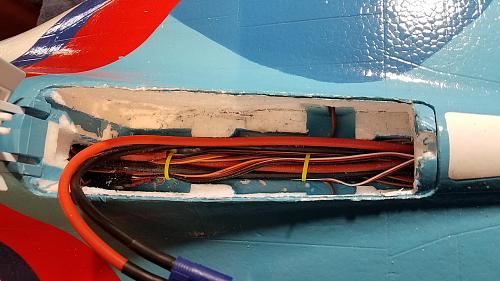

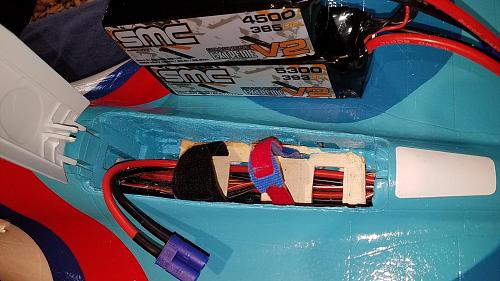

    Now that my "experiment" :exploding_head: with the 8100 mah battery didn't go as planned, I finally bit the bullet and did the radfordc twin battery mod. Thanks for sending me a description of how you did it. So it turns out I'm able to fit either the SMC 4500 mah 40C (weight 588 gr 46X46X141) or the SMC 5300 mah 40C packs in (weight 684 gr 43X43X160) while being able to put a tray in the floor with velcro straps. Still need to add the rare earth metal magnets and balance it but I'll definitely be able to get some lead out of my rear (no jokes please) as I had it balanced at 150mm with the 903 gr 8100 pack. Unfortunately, Danny doesn't have any more of those 5300's with the "lithium" wars going on, although I do have 8 in inventory as I was planning on using them in the Mig-29, but have mostly used the SMC 6200's.
    The only question now is fly it with 9000 mah of juice or go fully loaded with 10,600 mah. May be enough to get me into action over Kiev from here!
    I don't mind doing mods to aircraft, actually enjoy it, but this one shoulda never left the factory with those crappy E-Flight fans both operating on a single battery. Not that they would have kept it around any longer, but it really does fly great (and looks great in the air) with those FMS fans, even fully loaded with all ordinance! Small price to pay loosing the air brake!

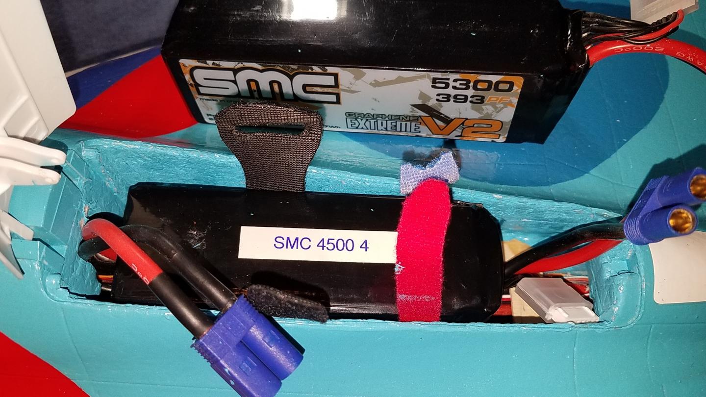

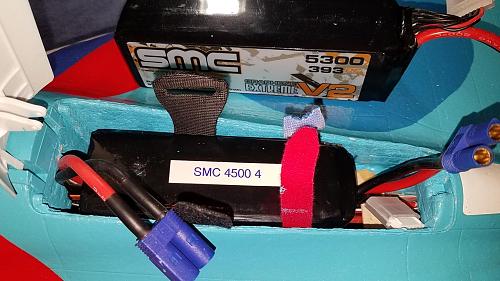

    So I think I've answered my own question on whether an 8100mah battery performs as well as 2 4000mah batteries. After 15 "test" flights with my SMC 8100, I'd have to say, based upon radfordc reports, that the optimum set-up must be 2 batteries instead of 1.
    The facts as I know them:
    1) Both of us are flying at a balance point of 150mm and the weight of 2 4000's was about 1190 gr vs the single battery plus lead in the tail to get to 150mm weighed only 1040 gr.
    2) Flight time on 2 batteries is 4:00 hard flying, and 6:00 or more just cruising
    3) On 1 8100 battery got to 4:00 of lazy flying and at the pits the pack was at 48% remaining. That sounds OK, but here's the rest of the story:
    I've got in-flight battery voltage telemetry that I set to announce the pack voltage every 30 seconds and a voice alarm telling me when voltage drops to 21.7 volts (about the lowest you want to go on 6S while in the air-voltage will come up a bit as you ease off the throttle). On take-off, pack voltage is 25.2 volts. Within 30secs after take-off (about the time to get in the air and into the first downwind leg), pack voltage had dropped to 23.4 volts. As I ease off the throttle and cruise at 50%, pack voltage slowly comes back up to 24.4 volts. Anytime I push the throttle for a vertical maneuver, voltage drops dramatically (much more than with any other EDF I have). The voltage alarm is constantly going off/on as I reach 3:40 and I land at/after 4:00, by the time I taxi to the pits, pack voltage is back up to 23 volts (50%). It's been a rough ride for those packs.
    The twin 70mm FMS fans at full power draw about 150.9 Amps and about 3590 watts (Stock E-Flight fans were at 120.7A / 2800W). The SMC's are probably some of the best packs around and with the 8100, their individual cell amps are around 170 A each fully charged. The 2 fans together pulling on one battery really cause a roller coater of a ride with cell voltage based upon the throttle usage. Not a great way to treat a battery.
    Now with 2 SMC 4500's, those packs have individual cell amps around 125 amps, so with only 1 fan pulling about 75 amps at full throttle, it should be a more balanced drain on the battery. At least that's my latest theory. :exploding_head: Boy, do I need to stop thinking up these stupid theories!

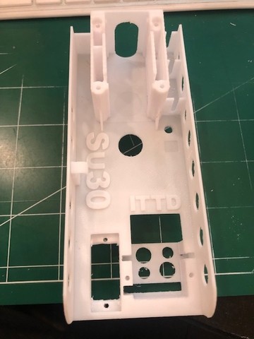

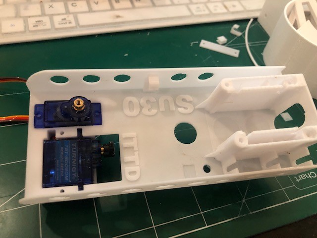

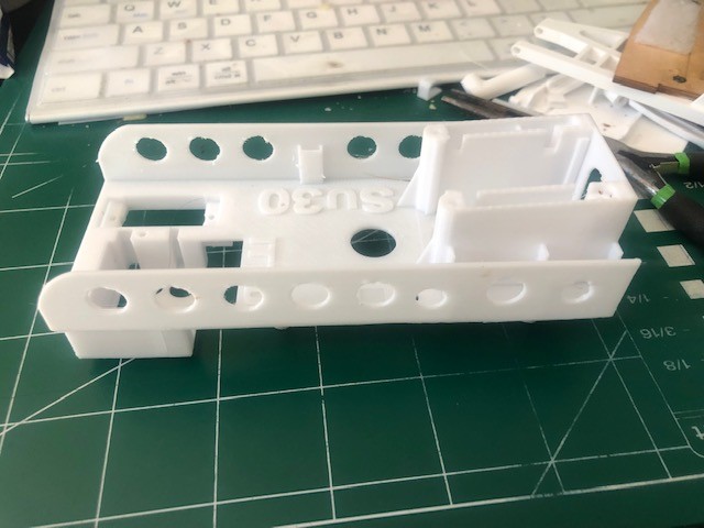

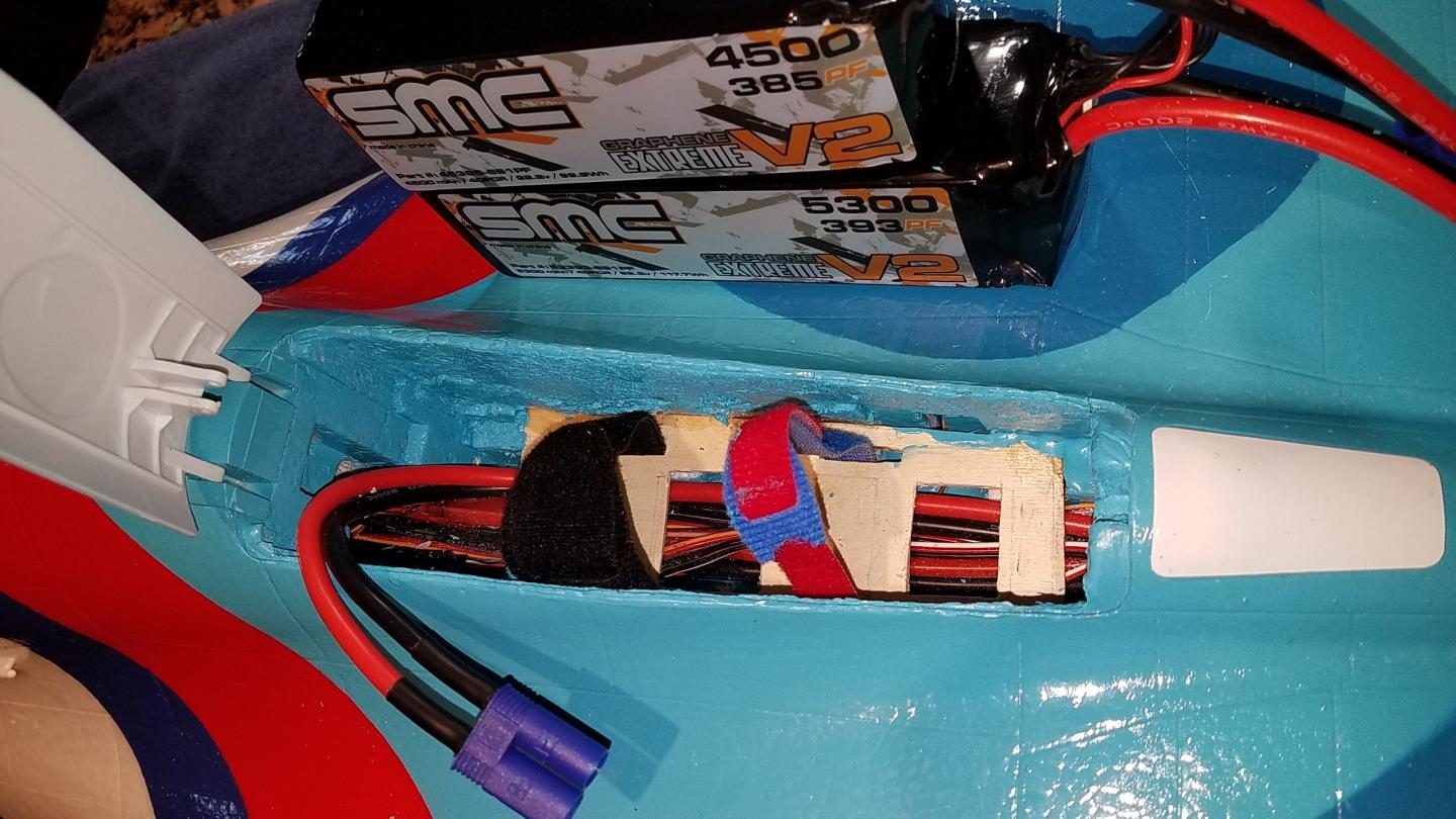

    So as soon as InTheTubeDeep gets his 2nd battery tray with the speed brake remaining mod perfected, I'm going to have to go to the 2 battery plan!
    Originally posted by InTheTubeDeep
    Thanks Hugh- the airbake batt bay will consist of 2 moving parts, the airbrake will remain stock, the bay will be hogged out a bit and a 'cover plate' will have a clip lock, when opened will expose the bigger batt bay for easy removal/insert of SMC 4500. Gonna take me a month I reckon to get a working prototype. For all you Su30 pilots I 3DP a replacement Nose gear Retract base, link for Classifieds- I made 2 versions one stock, other with a built in shim to lower nose wheel when retracted so gear doors do not hit it
    https://www.rcgroups.com/forums/show...P#post49272111
    OMG, you're doing this and ending up with the air brake still operational? You're a genius. That's all that's been holding me back, losing the air brake. If this can be done with it still functional, you need to be the head of "Skunk Works"! Now I gotta have it. I'm sending you my bird, COD of course, although when your finished doing mine, I'll consider paying half the return shipping! Hell, for that I'd drive it cross country to you! You've just earned yourself a new "pain in the drain" as I'm going to be all over you till you get it just right for consumer consumption. And lets keep this just between us, no need to let all those other frustrated SU owners horn in on this breakthrough. OUTSTANDING!!!! Haven't been this excited since I made my first successful RC landing (and that was finally just last week).
  • InTheTubeDeep

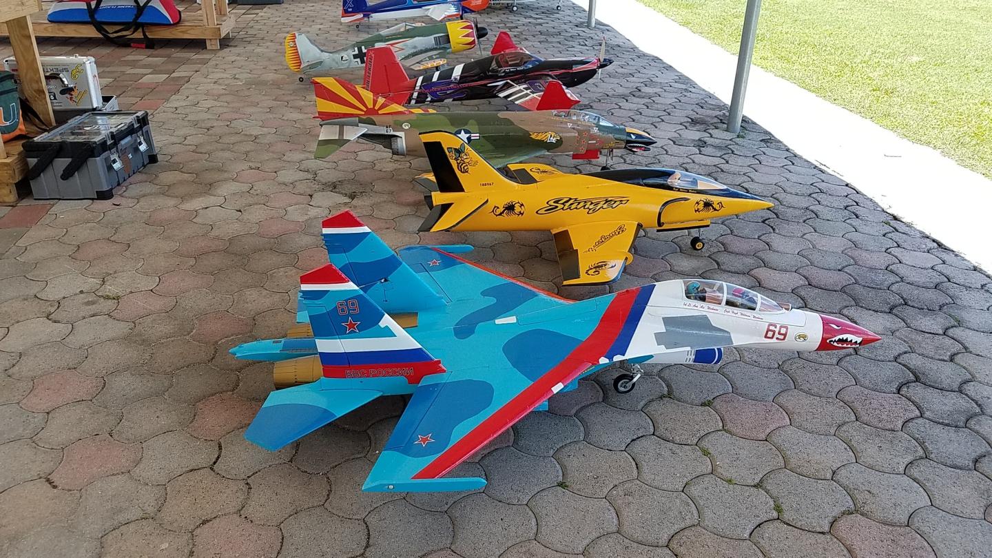

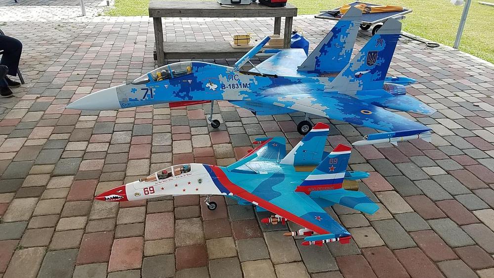

    Whoooaaaah whats the huge Su27 in Ukraine livery??? at first look I thought the Su30 was the new Xfly twin 50 painted like the EF Su30!! I've been Tinkercad'ing with the Airbrake Batt bay design, I'm bombed with other stuff so its a slog, but I will get it done eventually and will use 2 x SMC 6s 4500s. I'll have a few extra LED Blue Su30 Burner's for sale next week if any of you Suu30 pilots are interested, here is a grab of my Alenka on first Blue Burner test (secret mission since Alenka is still sanctioned by wife) Hugh has filled me in on the FW 90mm F18, I just got the Blue Angels version !
    Great photos of Alenka! Love your blue burners, possibly the correct color for your location?
    Anyway, the Su27 was a custom turbine job by one of our members for another member. Out of about 400 members in our club, the majority fly either large scale gas or turbines, and we've got our fair share of fairly well known pilots/designers/manufacturers. Several of our group are multiple top gun winners as well. Sometimes it's like going to an airshow to see the incredible turbines show up with guys like Pablo Fernandez (Elite AeroSports) who's probably the top 3D jet pilot in the world (and a hell of a nice guy) and creator of all kinds of jets you see at every major event and others like Marvin Alvarez (MarvinF14 on You Tube if you want to see some of his incredible work) and his father who custom paint/design incredible turbines for clients all over the world and guys with so much money/time on their hands they show up with a new $20,000 jet every month. Sometimes those of us in the minority flying "electric" models feel like Hillbillies showing up at a swanky party in Beverly Hills!
    As I told you before, I'm really interested in your speed brake/battery bay mod with the 2 SMC 4500's, so when you finish, I want all the details, including exactly how you modified the bay (photos and idiot proof instructions, obviously for a idiot), any clever methods you use to "latch" the speed brake cover and your data on flight performance and time. radfordc has already convinced me 95% to ultimately follow his lead and drop the single SMC 8100, but you using the battery I would use would push me out of the plane (a reference to my first parachute jump many years ago before they ruined it with tandems).

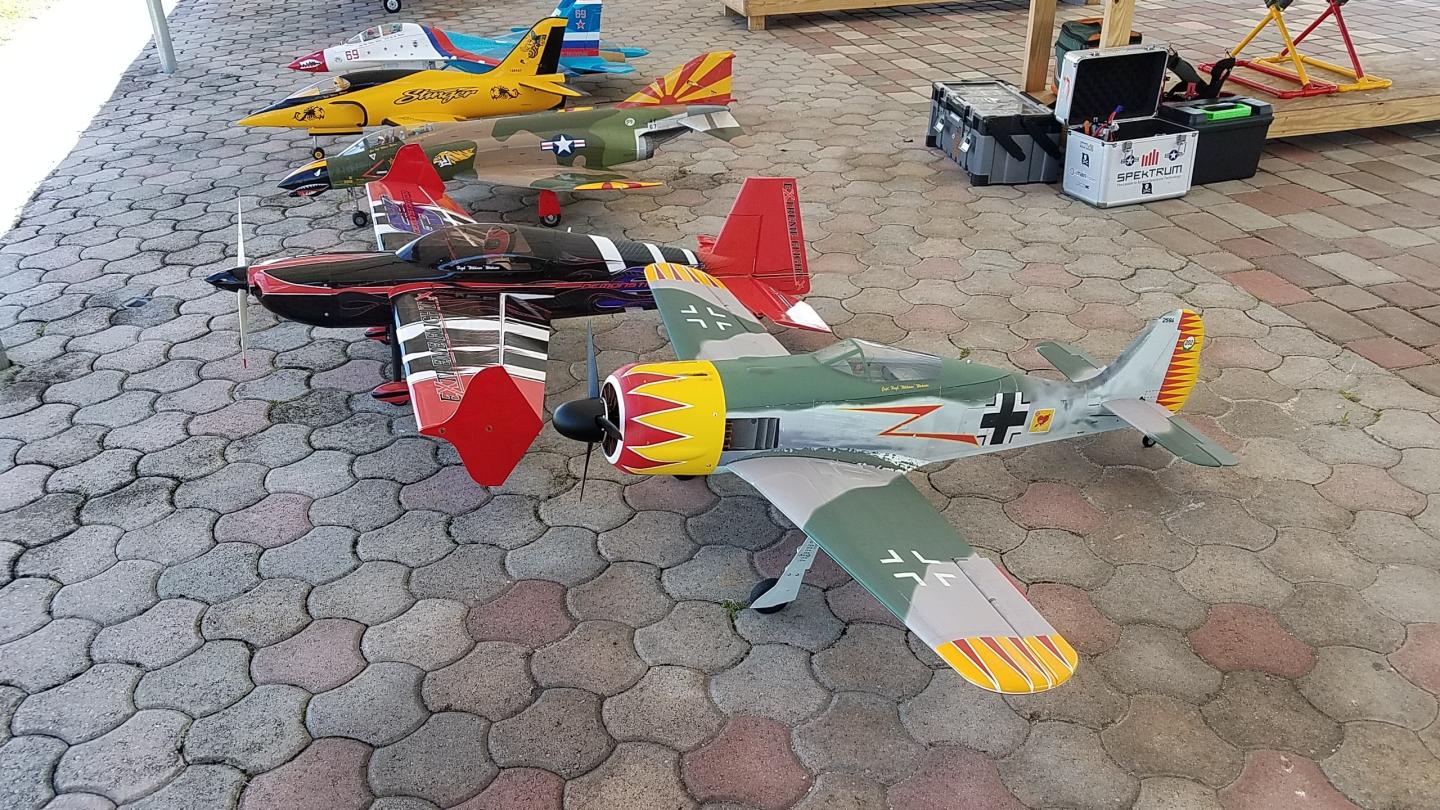

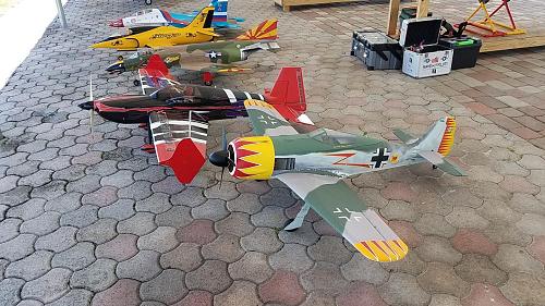

    Got out yesterday with an odd collection of 5 aircraft, including the maiden of the 62" Extreme Flight-Aces High FW 190 "Red Tulip" (detailed in "What did you fly today thread") and the now "defunct" SU-30 among others. I've been planning on doing the 2 battery mod radfordc "pioneered" but just haven't had the heart to cut out the speed brake yet, but was resigned to the idea that it had to happen one day. I really like the way the speed brake helps slow it down on landing (and looks too cool) and always fly it with full ordinance which helps as well on an SMC 6200 for just over 3 minutes. :face_with_symbols_o Get it up, fly it a few laps and 1-2 aerobatics, and it's time to land, and quickly I might add!!!
    Then I got to thinking (always a bad idea in my case), and if I'm not mistaken, I remember he was using 2 HRB 4000's which weigh about 1190 gr (please correct me if I'm wrong). Well, I actually fly my 90mm F-16 (with the 12 blade inrunner) on an SMC 8100 20 C for 5 minutes of aggressive maneuvers (actual tested C is 24C-still higher than most and the same tested C of my HRB 6000's). The SMC weighs 903 gr, but I needed to add 5 ounces, or 140 gr of weight in the tail of the SU-30 (none to the F-16 thankfully) to get it to balance at 150mm. So total weight for me is 1043 gr, still about 150 gr less than radfordc has with the 2 4000's, and I get to keep the speed break. In theory, that should work (said the just released mental patient :exploding_head:). Well after 5 flights yesterday, I'm taking the position that it was a success. Easily got 4 minutes of flight time, and frankly, with those FMS 70mm fans, it got off our thick grass (my biggest issue with these heavy jets-but did put a larger nose wheel on even before changing fans which works fabulously) in almost the same distance and seemed to me to fly just as well as it does on a lighter battery (but then I drive a truck and not a Porsche, so what do I know). I don't know why I didn't think of this earlier, except I did try the Hobbystar 8000 (100C not even close-18C) but that was with the E-Flight 70mm "rubber band" fans and it flew like :poop: and had no vertical (kind of like it had with any other pack), so I blocked the idea out of using my SMC 8100's (until I did some weight calculations of using 2 batteries), which are a higher actual C than the Hobbystars (those are now swimming with the fishes). SMC is also coming out with HV graphene packs of 7700mah (@25.2 volts), but you can charge to 26.1 volts, so if I can reprogram the ESC and cut off points, I'll get even longer flight times with less weight. I suspect, but don't have the electrical knowledge to know for sure so just a gut feeling, that radfordc's twin 4000's each powering only one fan will give longer flight times than a single 8100 being sucked down by 2 fans, but for now I'm going to go with it for a while. Please, stop me from thinking or this planet is doomed! :dizzy_face: Now I need to just fly the heck out of it and learn that it doesn't need to be flown at max throttle-actually cruises nicely at 50-60% throttle, kind of like my Winnebago!
    Click image for larger version Name:	20220601_114940.jpg Views:	0 Size:	269.4 KB ID:	347374Click image for larger version Name:	20220601_114924.jpg Views:	0 Size:	293.9 KB ID:	347375
    Guess which one has an issue with flight time!
    Click image for larger version Name:	20210513_123301.jpg Views:	0 Size:	246.3 KB ID:	347376

    Originally posted by radfordc
    Hugh, sounds like a good plan. If I fly easy I can stay up for over six minutes. Flying hard drops that down to 4-4:30.
    The only issue I see with using one 8000 pack is that all the current for two fans goes through one EC-5 connector. When I was doing that my connector got smoking hot so I'm sure there must have been some significant power loss there.
    Makes sense. I'm sure that using 2 batteries is much more efficient than the one 8100. I'll fly it like this for a while and if I'm not completely happy, I'll do the "radfordc" mod. Just don't have any decent 6S 4000's and I'm not looking forward to adding to my already overblown battery inventory. Before I tried this latest "experiment", I was planning on measuring the speed brake bay to see if I could get an SMC 4500 in there. I think they would being 46X46X141 and weighing 588 gr each which would put me at the same battery weight you have. Those I do have and fly them in my Extreme Flight 3D planes, but got lazy and went with the big boy for now.
