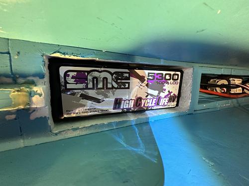

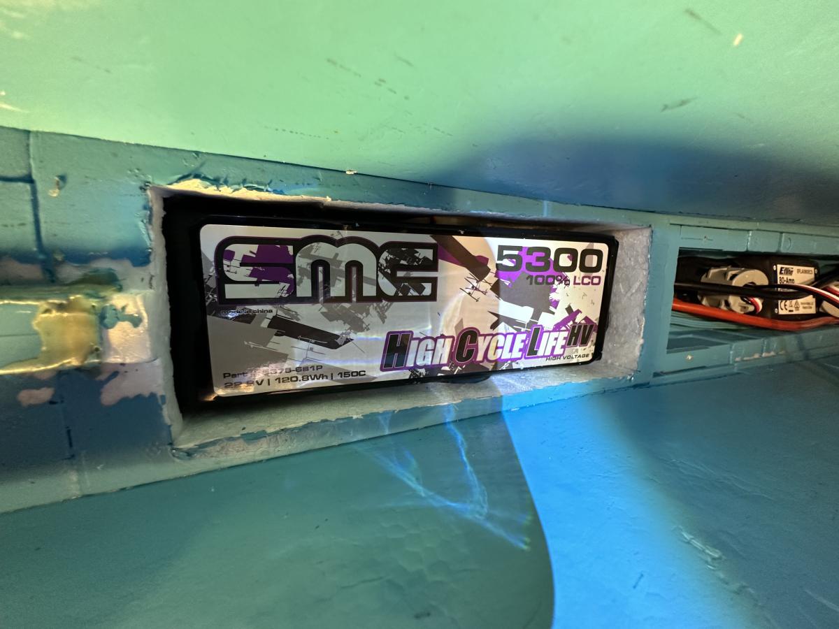

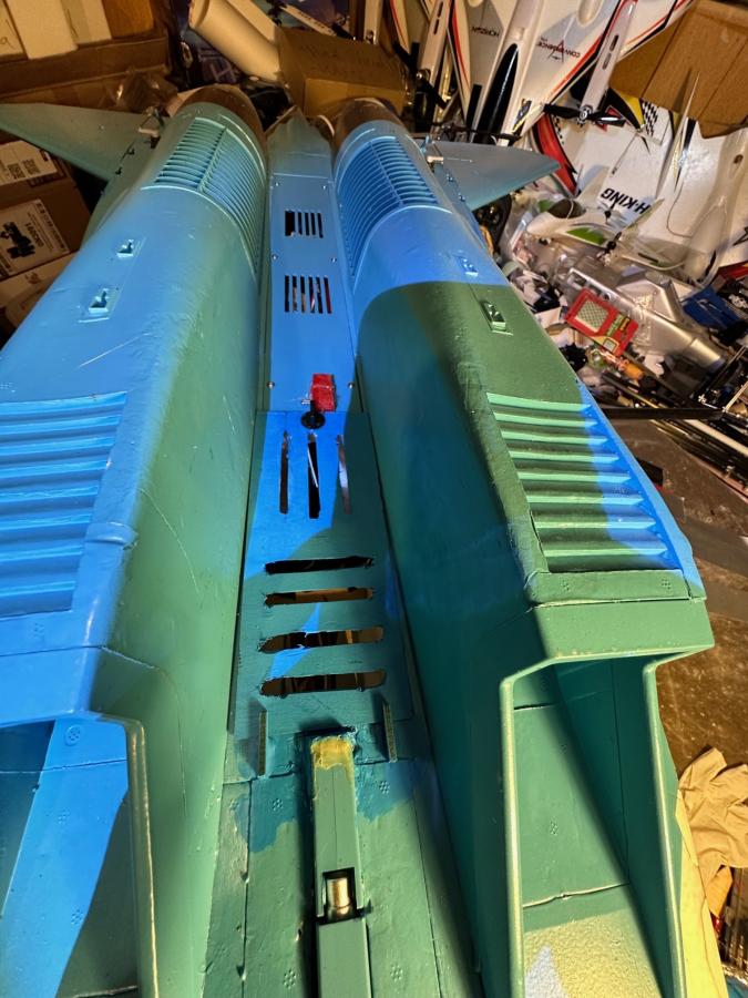

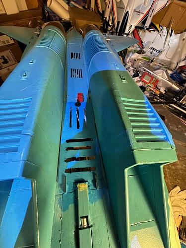

                          Spurred on by a couple of the fellas here, I've just finished my 2nd battery compartment mod. I opted to go from below to maintain the airbrake function.
                          It was a lot of foam excavation and one has to be very careful not to cut any of the wiring that runs through that area. Installed a battery strap, hatch cover and ran the battery lead out the top via the airbrake opening. Because the 2nd battery is over the existing CG, balance at that CG has been unaltered. 1st picture shows the SMC 5300 HV in plane. I'll also use my Coddar 6000 HV. 2nd picture shows it all buttoned down with a new ventilated hatch.
ID:	361744Click image for larger version
                          True that this model has been discontinued by Eflite but I know that one of my LHS still has a new one on the shelf. I'm sure there are others out there that still have stock. Nevertheless, FMS has come out with their latest SU-27 and J-11 (see RC Informer). Both of these are nearly the same plane as the 30. The 27 is a similar blue paint scheme as the old 30 but with fewer decals and the 11 is a grey military version. Both can easy be purchased from various sources. A flying buddy here is waiting for his 27 directly from FMS.

                              THE Quintessential Dual Battery Mod!!! Not sure what that word means , but well done xviper and I'm just a bit jealous. :clap:

                                I don't know about that. You're very kind. If not for you guys, I would have gotten a bit disappointed in this plane and let it hang even longer or let it go. I really like the plane but 2.5min. of flight time just doesn't work for me.

                                    Hello. How did you connect the two batteries together? I assume they're in parallel?
                                      • 8835
                                      #818
                                      Actually, not exactly. Each battery powers one ESC. The original ESC power wires were Y'd together. I separated them. Neither battery is connected to the other. The throttle leads are still Y'd together. I must run 2 identical batteries to keep the proper current balance.
