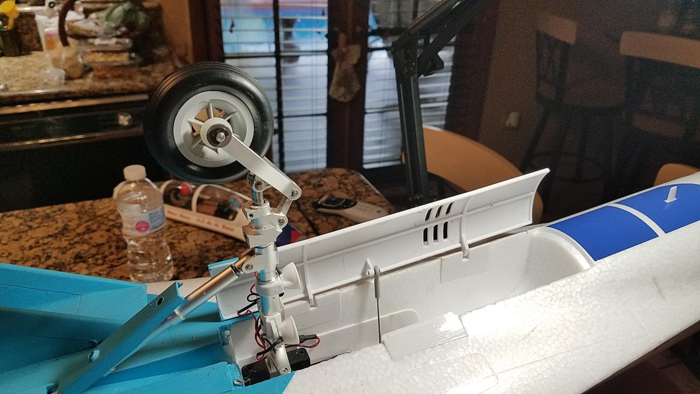

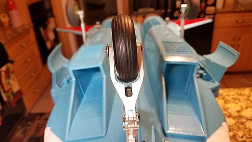

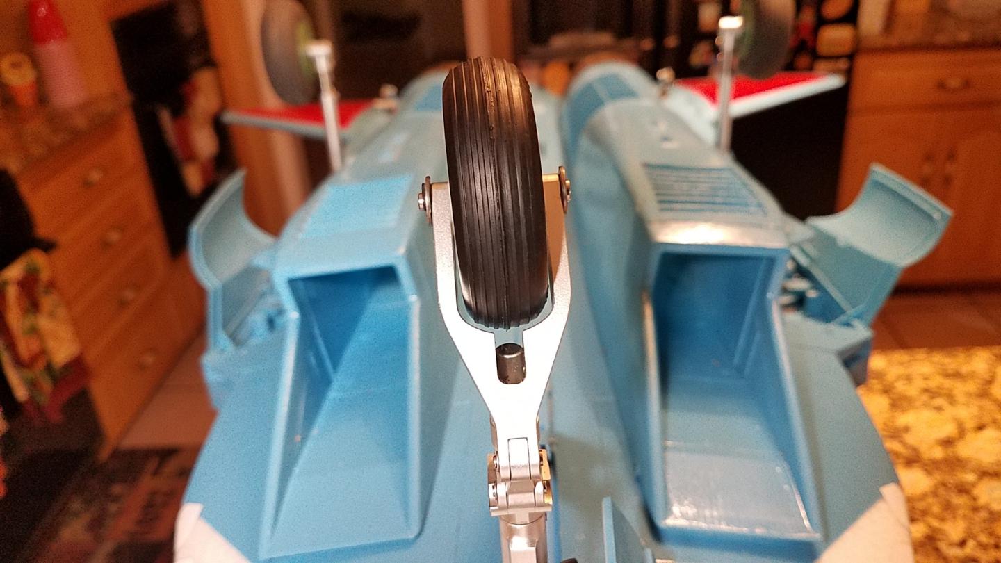

                            I would definitely switch out the RX (especially if yours came with the old AR636) to the AR8360T AS3X and absolutely connect the included flight pack battery voltage cable, IMO, a must have for this power hungry beast! Then you'll be able to set up flaperons or tailerons or whatever "blows your skirt up" while still using the air brake (unless you go to 2 batteries, which I'm thinking is the ultimate final solution). I would also invest in a satellite remote and stick it up in the very front of the nose. As I said before, I wasn't able to get a decent signal on the original AR636, or even the old 7 channel AS3X I went to until I finally upgraded to the new 8 channel with remote satellite. With the other 2 RX's, it was probably just a matter of time before it appeared on Smithsonian's channel for "Air Disasters".

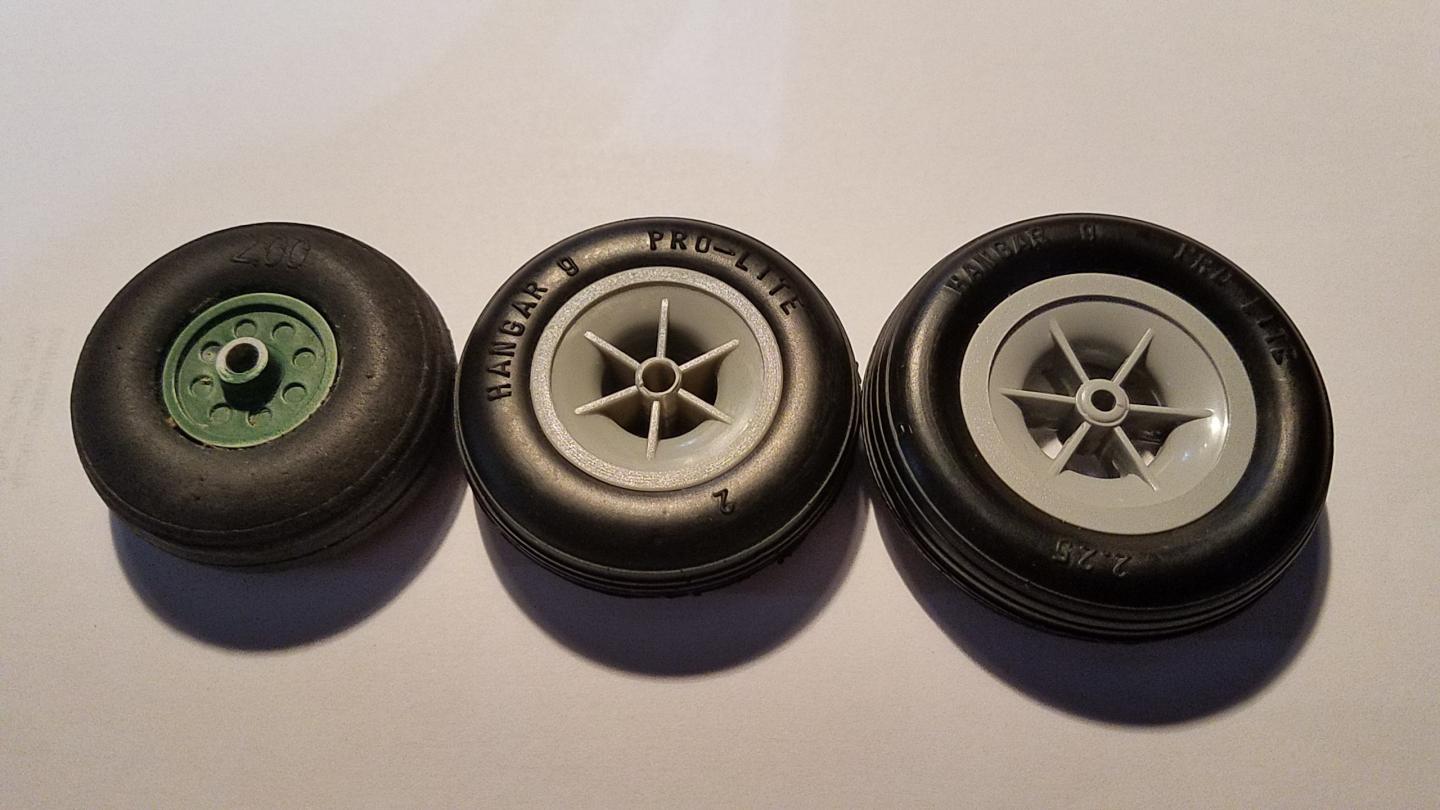

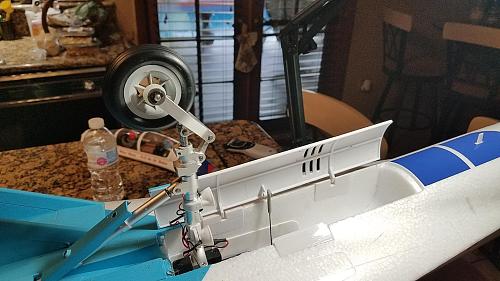

                            Regarding the nose wheel, I'm not sure you really need to upgrade it unless you're flying off grass. I had a hell of a time getting it off grass with the original nose wheel, flaperons and the stock E-Flight fans, and in fact on a couple occasions with no head wind it never got off, even after 300 feet!. In fact a HH rep who was at one of our events when it first came out even told me that he would not recommend it for grass, but would this bone head listen to him, absolutely not, had to have one. Took a lot of messing with, but with the larger nose wheel, flaperons and especially the FMS fans, get's off very easily now.
                            So the wheels I used if you want to give it a go are the Hangar 9 2 1/4" Pro-Lite Wheels (HAN303). I use Pro-Lite's in a number of planes (Spitfire, all my Extreme Flight planes as well as a larger nose wheel for the 90mm F-16) where the Robarts are too wide. Of course, these have been discontinued for some time, but the last time I looked you can still find the 2 1/4" on Ebay. The width is about 17mm and the axel size is 1/8" (approximately 3.175mm). Fit was just right, gear goes in perfectly (no room to spare) and fits in the strut without any modifications. I seem to remember that the axel size was perfect, but may have slightly enlarged it to spin freely, which is no problem since it is plastic and easily enlarged. I also liked the slight increase in AOA with the larger wheel. On grass, the smaller wheel seemed to dig in like a tick and keep the nose glued to the deck with an actual nose down attitude (maybe just an illusion and wishful thinking).
                            1st photo is stock wheel next to Pro-Lite 2" (which I put on the F-16) and the 2.25" installed on the SU-30
                            Looking at the photo, I may have enlarged the axel hole, definitely did on the 2" for the F-16
                            2nd photo 2.25" installed (also used thin nylon bushing to keep it lined up)
                            3rd photo shows head on view

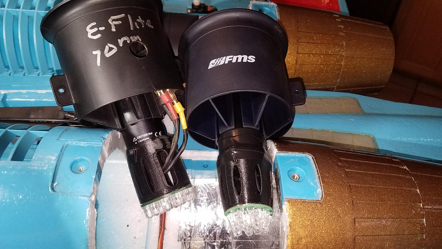

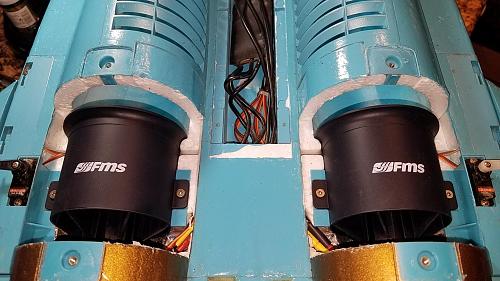

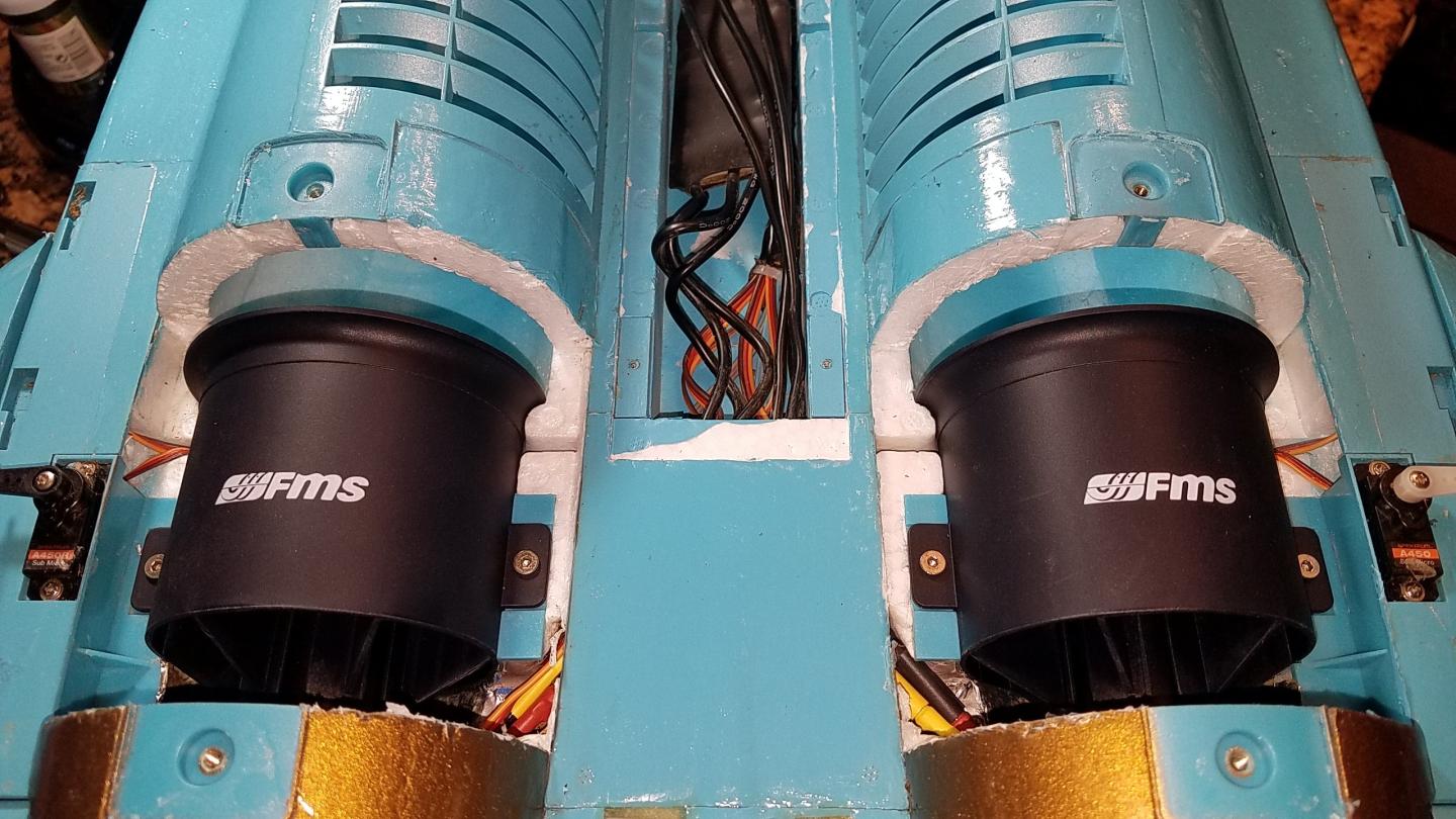

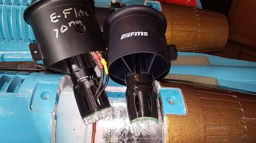

                            4th & 5th photo FMS Fans, drop in fit, and the newer RC Geek slimline AB which also reduced some of the thrust lost over the original
