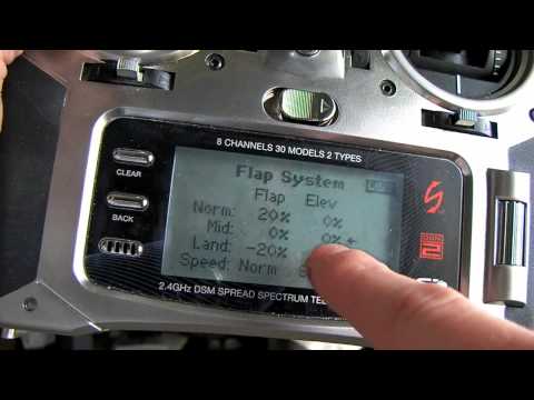

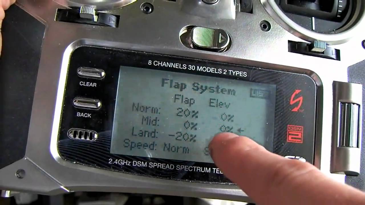

          Looking to buy a used Su30 this weekend and would really like some advice on setting up flaperon and tailerons if someone can point me in the right direction?

                  Flaperon setting uses AIL & AUX1 channels for the ailerons, and elevons/taileron setting uses AIL & ELE channels, so you'll have to work around that.
                  I'd suggest setting up flaperons, and use mixes to ELE and AUX2 channel to get the tailerons. You can trim roll on the flaperons, and pitch on the tailerons, provided you don't inhibit that in your mixes. You'll also want to disable the AUX2 switch on your transmitter.
                  AIL - left aileron servo
                  AUX1 - right aileron servo
                  ELE - left tail/stabilator
                  AUX2 - right tail/stabilator
                  Flying tailerons only with the ailerons as flaps-only is another option.

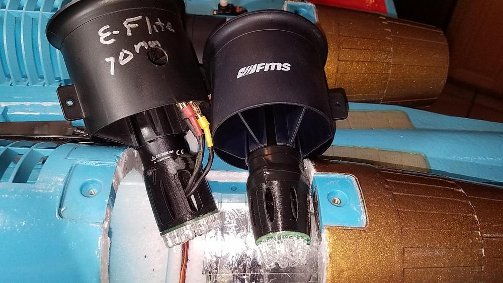

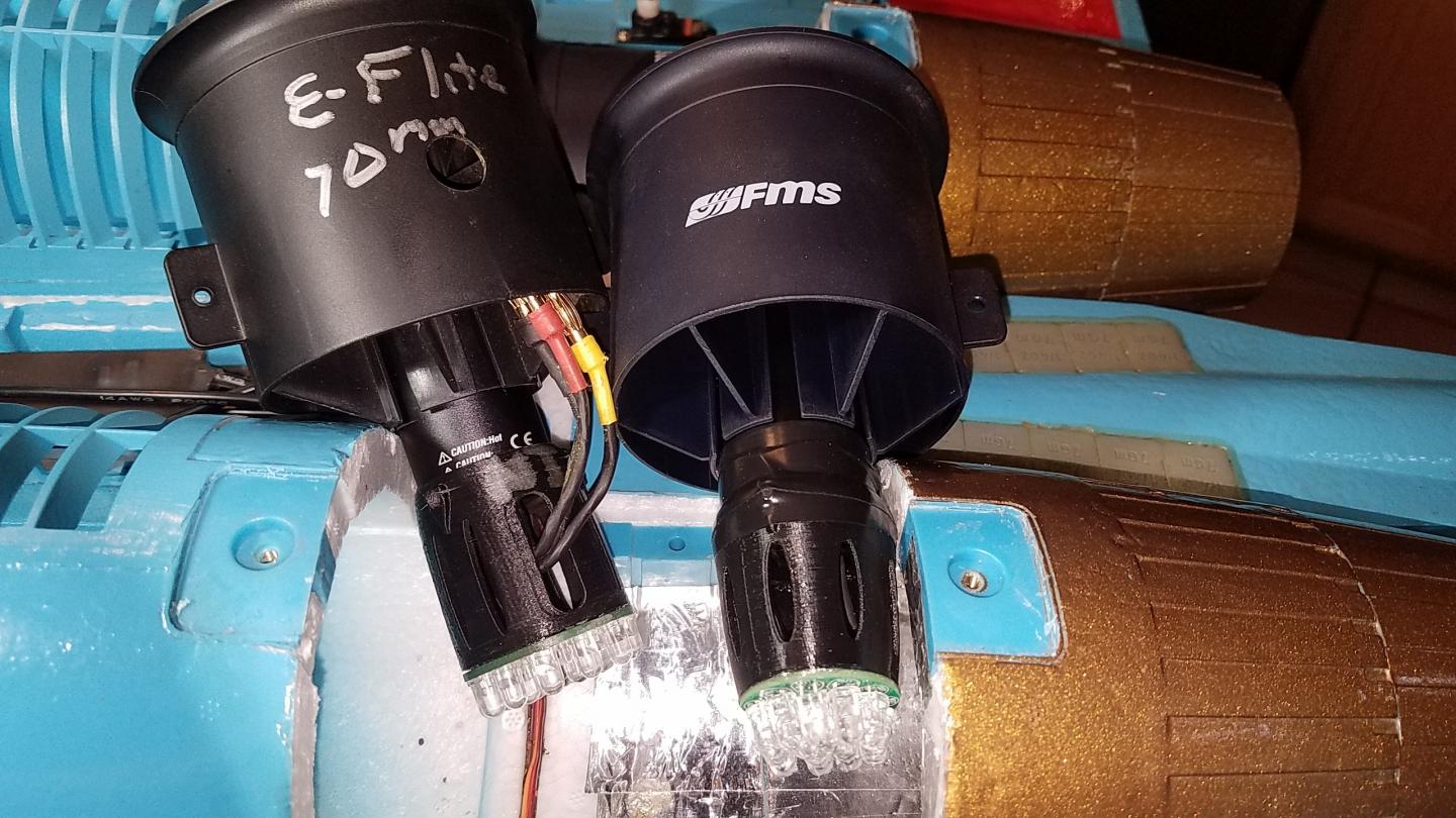

                          Finally received the FMS Pro 1900 kv fans from RC Castle. Not bad, received them just over 2 weeks from when I ordered them. I have to thank you profusely for recommending them as I was about ready to give up on this pig. Haven't got it out yet, but after bench testing it these fans are putting out at least 20-25% more than the E-Flite "gerbil wheels". I can feel the difference, but can't tell you the exact difference in thrust.
                          What I can say is that on a GT Power Meter, the maximum Amps and Watts drawn on the E-Flight fans with a real 40C battery was 118 Amps and 2860 watts. On the same battery, the FMS fans draw 148.65 Amps and 3657 Watts. That's about a 25 % difference. On the RT 6250 35C (which really tests out to a 25C rate), the numbers are still respectable at 142.3 Amps and 3221 Watts.
                          I also changed the afterburners from Chris's older larger diameter ones to his most recent Mini Burner which creates less obstruction and reportedly a difference in about 10% versus the older style. After all I've done now with the larger nose wheel, flaperons and upgraded fans and afterburners, if it still flies like a dog I'll be out of ideas. But I think this will make a marked improvement but not counting my chickens before they're hatched. More to come after I get her out again.

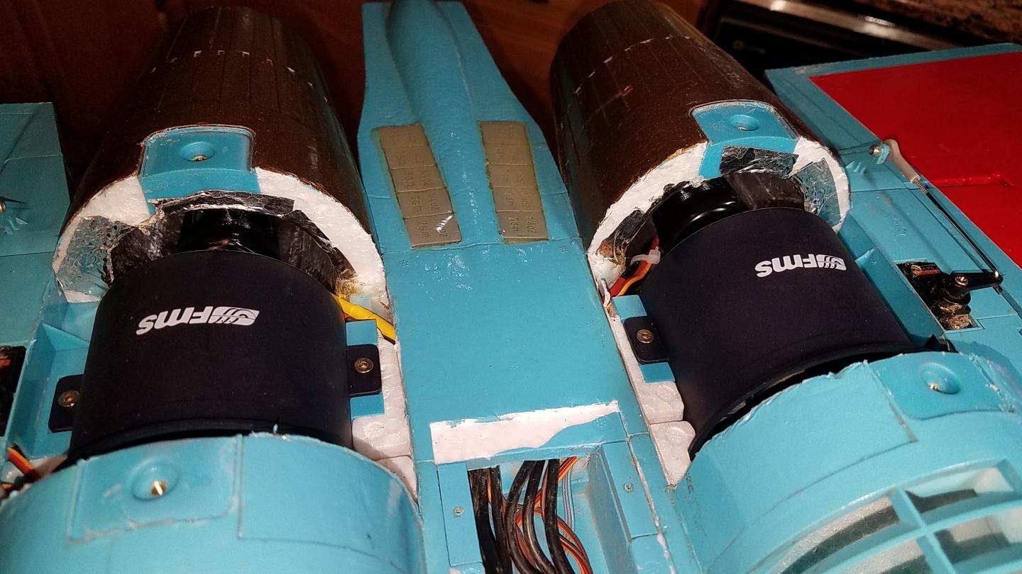

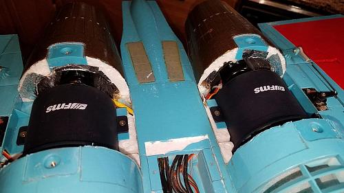

                                    Finally got the SU-30 out with the FMS 12 blade 1900 Kv inrunners Gvasiloff recommended. Holy Cow, what a difference!! This was this birds last chance after 70 flights on the E-Flight "gerbal treadmills" before it got relegated to the garage rafters. Went from a super dog, to flying incredible. Man, what a difference a little more horse power makes (actually more than a little, at least 25-30%). Got off the ground in less than 100 feet and all the vertical you want. I even stuck the ordinance on (first time I dared to try that) and it made virtually no difference. It's now actually fun to fly. Incredible that HH and E-Flite sold this thing in the US with those TERRIBLE 1850kv fans, while the FMS version sold in Europe had these fans. I have to say that if you have the E-Flite fans, deep six them and get the FMS fans, the $120 is the best money I ever spent. Only took 2 1/2 weeks to get here from Hong Kong. I got a total of 25 flights in on 5 different birds, 5 for each. My 90 mm's all have the 12 blade inrunners in them and those all now fly great as well. Used a 5000 40C, a RT 6250 35C (actual C of 25) and a couple HRB 6000's 50C (actual C of 32). Flew the best on the 5000 40C, followed by the HRB which gave the most flight time. Waiting on some SMC 6200's that are a true 40C and about 35 gr less in weight than the HRB's. I will definitely fly this a bunch more now! It does look great in the air, especially with the afterburners being so close to the end, and seems like it lands much better as well, but who knows, maybe I just was so ecstatic over it's flight characteristics that I was very relaxed when it came time to land!
