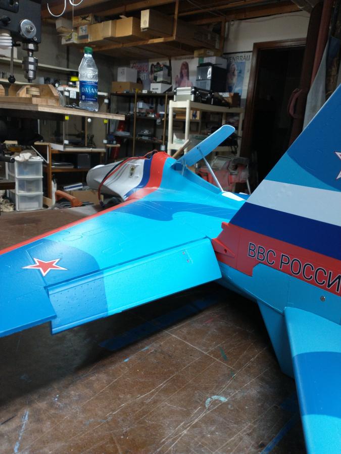

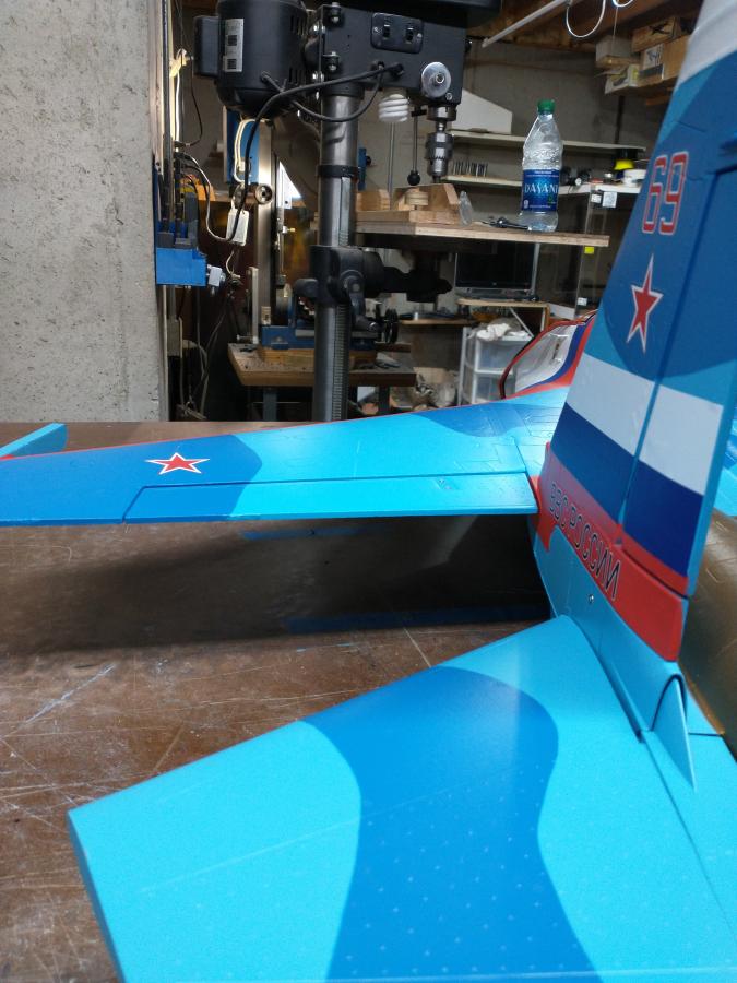

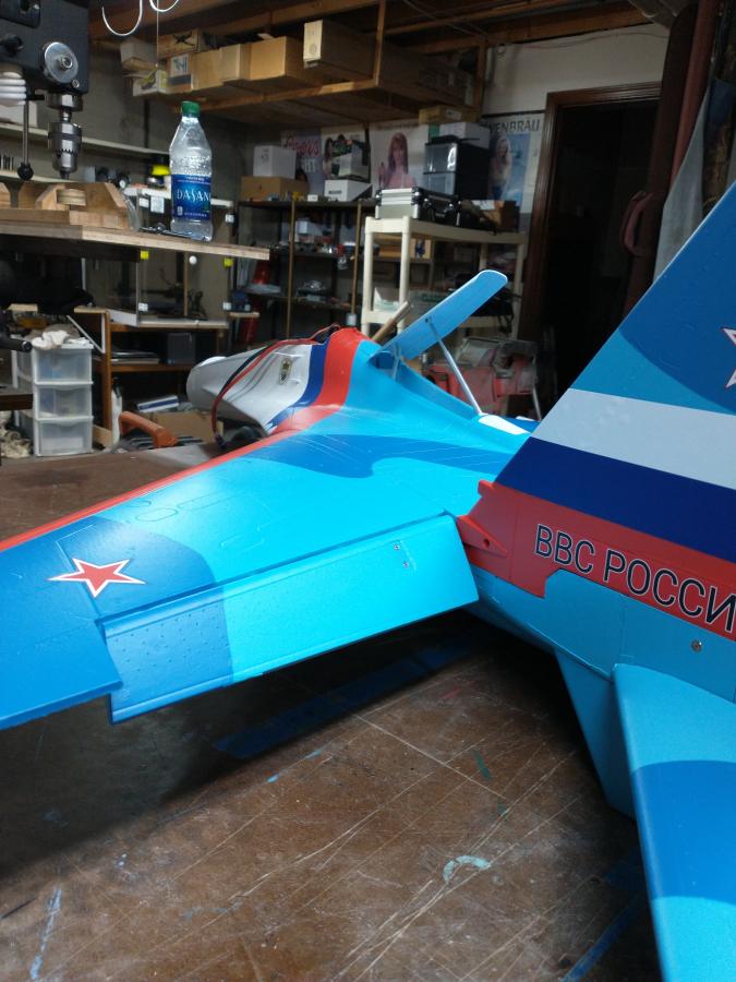

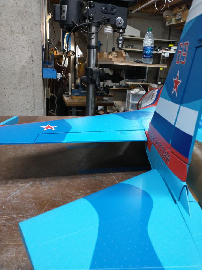

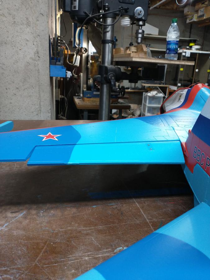

    Here is how it looks.

      Originally posted by radfordc
      Reconfigured the controls so that the tailerons control pitch and roll and the wing surfaces are flaps only. The flaps have full up, take off position, and full down. The airbrake is also actuated when the flaps go full down. I mixed in a bit of up elevator with the full flap position.
      How’s the roll authority with only tailerons? This is a pretty big, heavy plane.
      • radfordc
        • 375
        • Lansing, KS
        #583
        Haven't tried it yet...too much rain and wind for the foreseeable future. Nuts-n-volts says his flys great like this.
        • nuts-n-volts
          Duke City Electric Flyers
          • 262
          • Albuquerque, New Mexico
          #584
          My tailerons roll very scale with room for more rate. If you want even more roll rate you can always mix in ailerons as well to compliment. But then you're getting into crazy, insane stuff that real airplanes just don't do.
          Fly low, fly fast, turn left
          • radfordc
            • 375
            • Lansing, KS
            #585
            When I used full throws on the tailerons and ailerons the roll was way too fast for me....blurry, power drill fast.

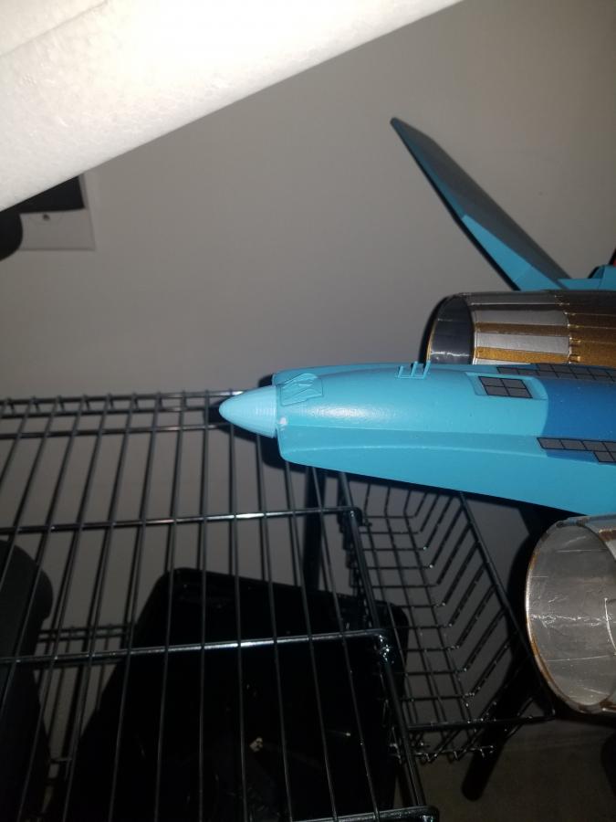

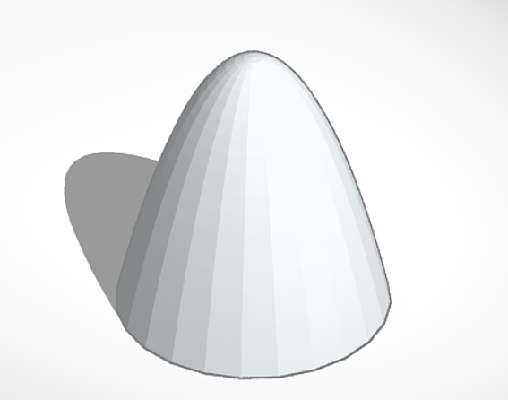

              3d Printed a cap for the tailcone to stop hangar rash in that very squishable area.

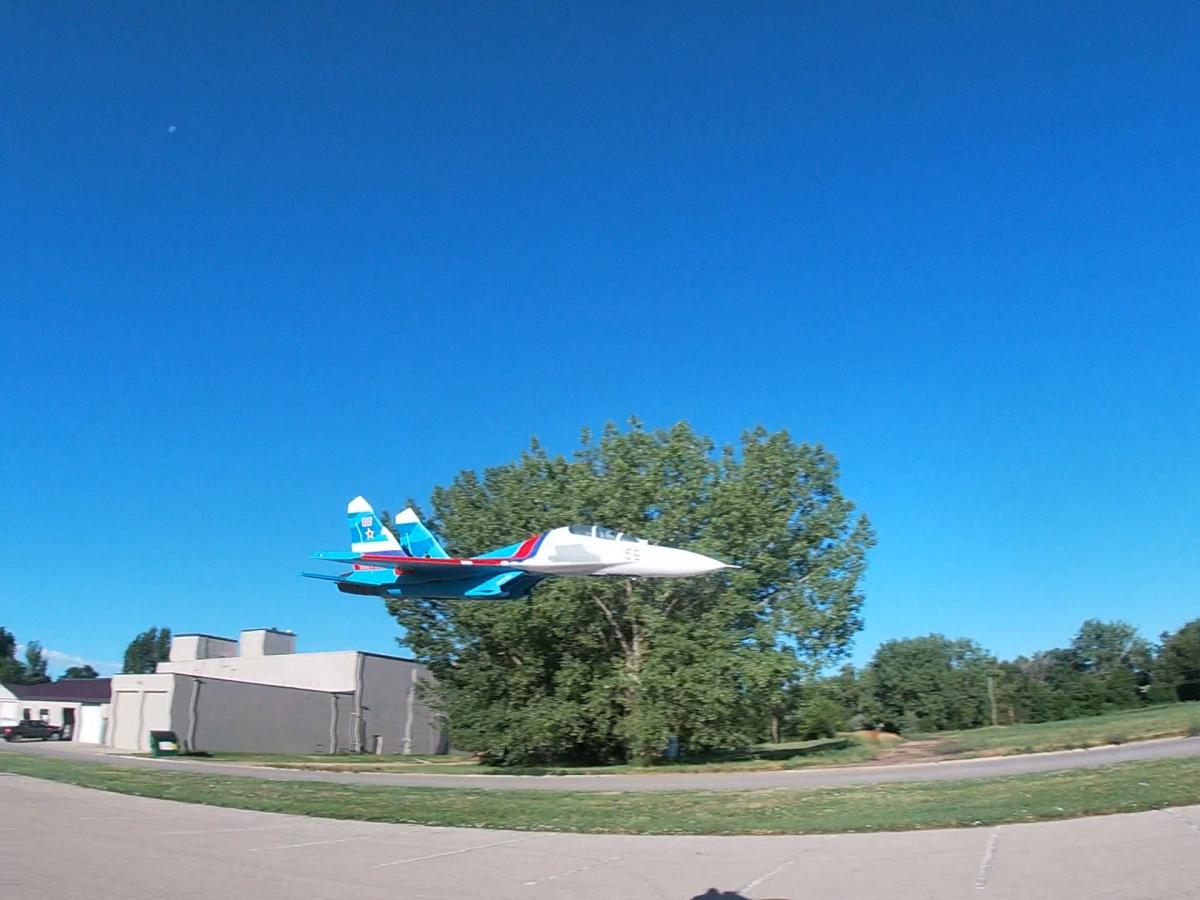

                    There are pro's and con's for every one of these, but in the hands of a person, that does the research and has the ability to solve these little problems. All these EDF's can be sorted out and made to fly great I for one have the E-Flite Su-30 and have had no problems at all with it. As for as snapping main gear and bending nose gear is a Bad landing problem I have watched many video's of this one and pay great attention on how people land many get it to slow and stall the Su-30 to high and ruin the gear then complain how week the gear is landing these planes is where most all the damage is done due to bad piloting skills. I will say that some have had the gear come out to due to not enough glue on the mounting plates on the retracts but only on a few planes You are right the SU-30 is a heavy plane and could use more power and the roll rate is rather sluggish. So the SU-30 has to be flown with all this in mind. Due to the higher wing loading the stall speed is higher then most other EDF twins that are lighter and have more power so all this has to be considered when flying. I have programed in tailerons and by doing so the roll rate can be adjusted as slow or as fast as you want it. lets get back to the landing gear if flown by some one with good piloting skills the SU-30 can be landed on the mains first. let me say that again FLAIRED & TOUCHDOWN THE MAINS FIRST with out having any problems, then let it settle in on the nose wheel. When you do what I call a lawn Dart landing that is where the nose gear gets bent, or if touched down slightly on the nose gear which then inadvertently starts the plane to porpoise down the run way wish only gets worse with every bounce I have many flights on my SU-30 and have not had any major problems with it. in conclusion. Keep your speed up on landings, Flair it correctly if you bounce it get on the power, abort the landing and go around. The Su-30 could use more power, it is heavy, and with just ailerons the roll rate is slow but can be changed by adding in tailerons, landings can be made slower by adding Flaperons. some are even using spoilerons mixed in with up elevator. in fact I use spoilerons on my free wing F-35 works great With the advance computer transmitter's programming capabilities are endless that's why we test fly these planes. FWIW

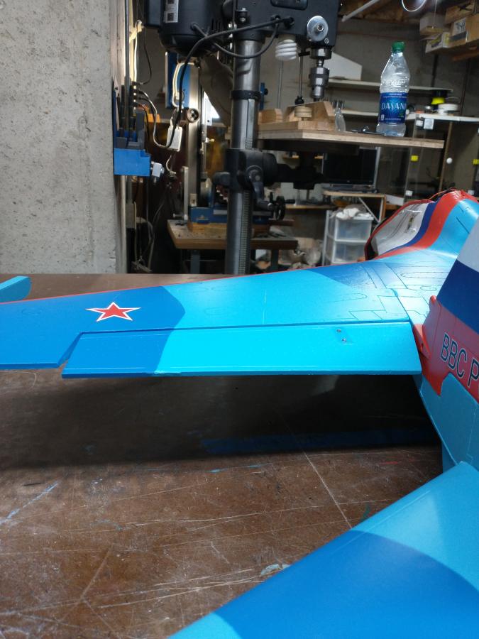

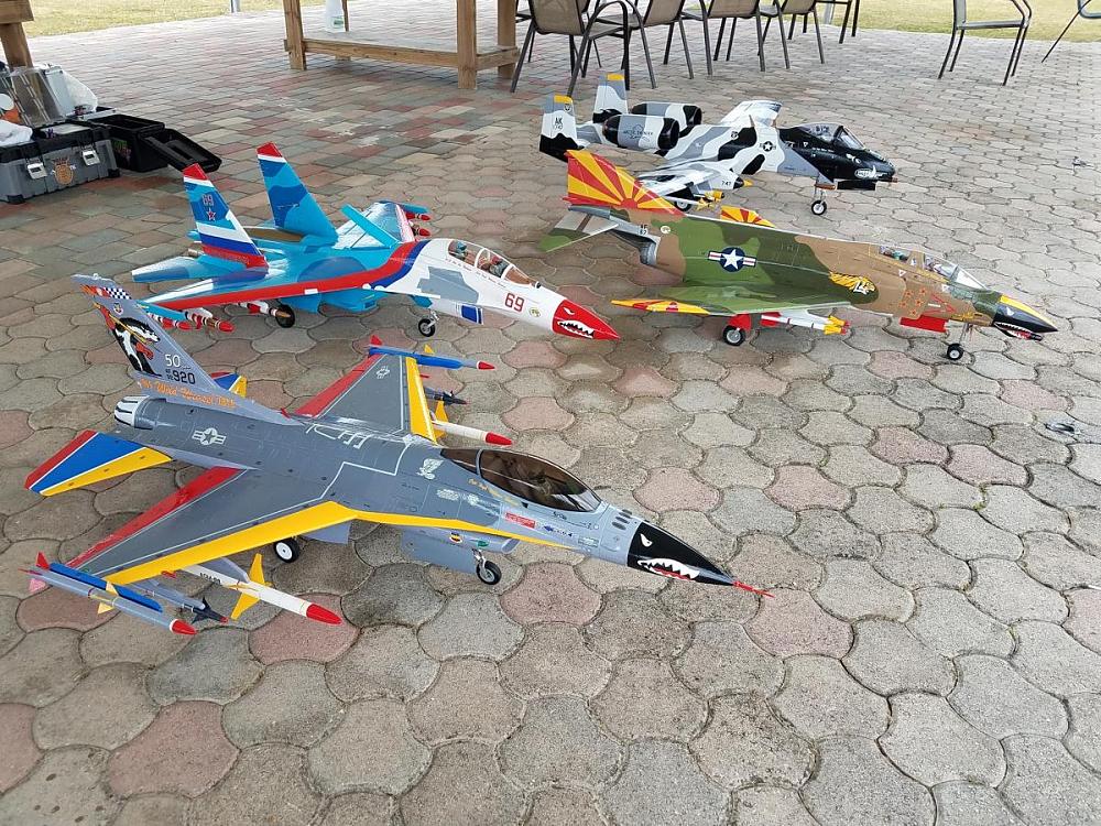

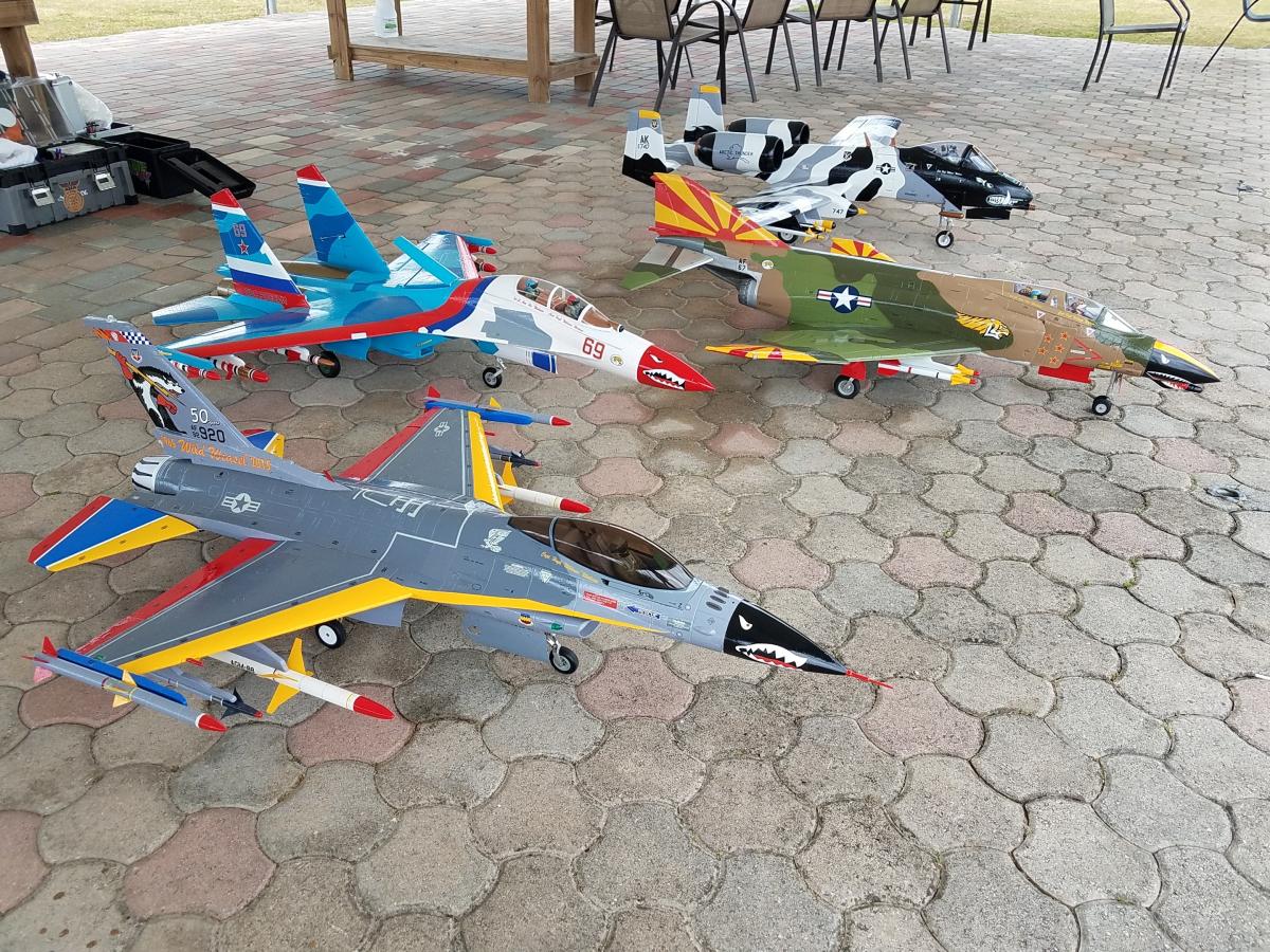

                            Got my SU-30 out with 3 other EDF's and put 5 flights on it with a 5000mah battery. Still flies like a pig, but I'm learning to deal with it (only took about 60 flights and trying 5 different batteries). Cutting back on weight to a 5000 improved it's performance substantially, but still only get 3:20 out of it, which ain't bad since the 6000's only gave me the same, but had to use more throttle and at least now it climbs decently.
