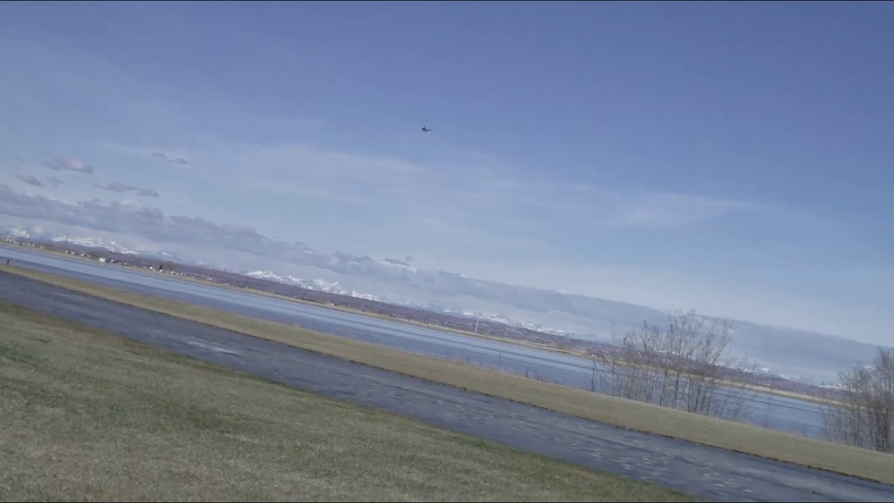

                                Hugh Wiedman Got it out today for a couple more flights. Still working on that high alpha landing. This vid, it landed on the grass beside the runway (not on purpose but still good as this plane tends to roll forever on the smooth surface).
                                  • 2716
                                  #416
                                  Great video, you fly that thing way to well for having only a few flights on it, I'm green with envy and quite jealous. Seems like you got the best of both worlds, taking off on asphalt and landing on grass. Love your field with the water on the one side, but don't think I could fly there because at some point I'd probably end up "in the drink".

                                    It's interesting that you mentioned the "lake". Another flyer was there today and he said that was THE one thing he hated about the site - the lake. Most of us have just gotten used to it being there. I've lost 2 planes in the lake - one I got back by paddling out with the club row boat, the other is likely still embedded in the mud at the bottom. The one I never got back was the Freewing F5. I didn't like it anyway. Not bad for flying there for 4 years.
                                    (The "lake" is actually an outflow pond from the gas plant right next door. Up till last year, you wouldn't dare touch the water. It was so badly polluted, even the ducks and geese would not land there. They've cleaned it up now because they are trying to sell the property. Back then, when a person retrieved a plane, it had to be carefully cleaned and disinfected - kinda like what they're doing now with the Covid-19 thing.)
