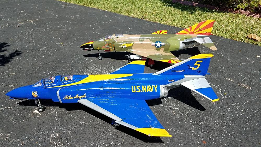

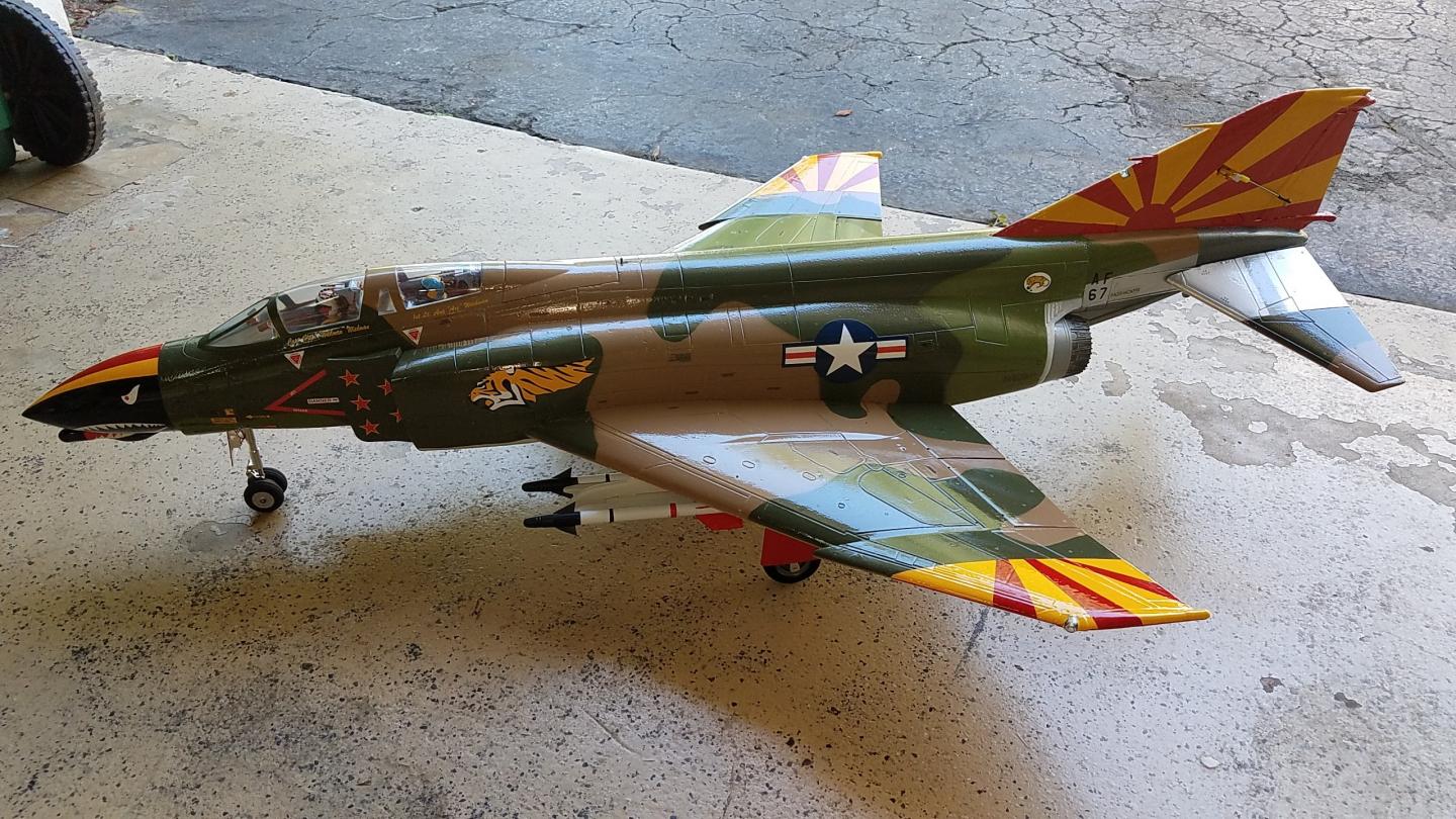

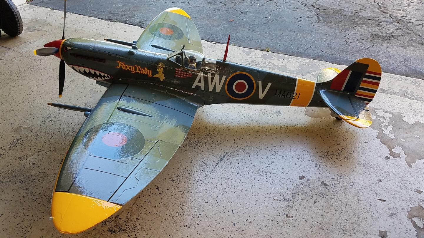

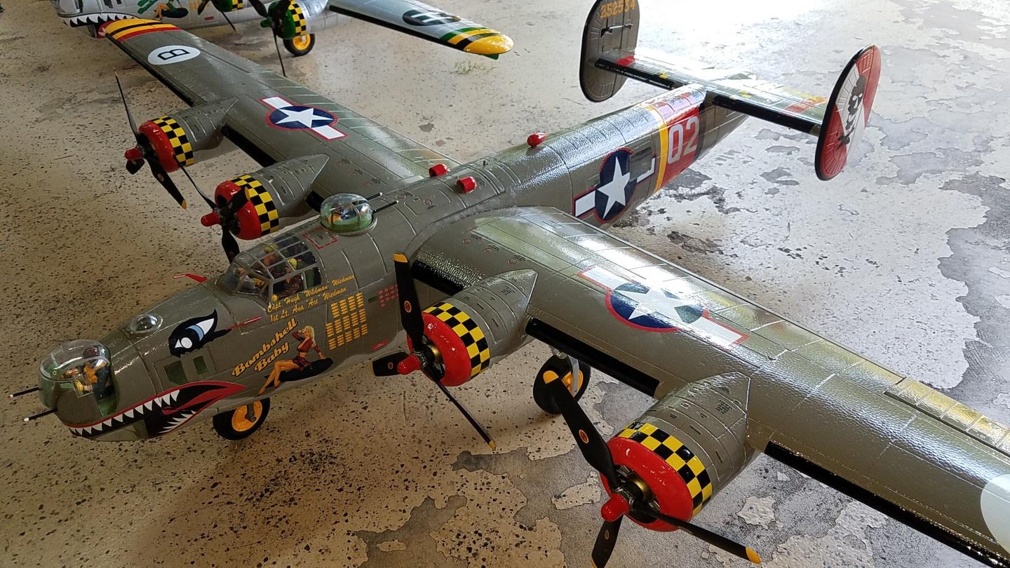

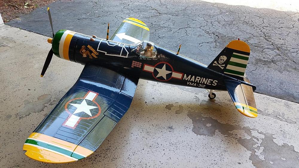

                      I use the Varathane Spar Urethane Water Based Exterior, comes in Gloss, Semi-Gloss, Satin and Flat. I've been using mostly the gloss and as xviper, I hand brush it with a foam brush. With the Gloss, I end up doing 3-4 coats to get a nice finish. The Satin and Flat would require less coats. I've done this to about 15 foam planes so far, and although it is somewhat a pain in the rear, the finished product, in my opinion is excellent. Just don't get it on control hinges, control rods or any surface that moves and comes into contact with another surface (like interior of flaps/ailerons/rudders or were detachable wings attach to the fuselage) as it may stick together even after it is dried. Use masking tape if you have to or just don't apply there and any area that you intend to remove at some time, don't get it in the cracks cause it almost seals it in.
                      And yes, you can absolutely paint over it. I use this is some places almost as a primer. Once sealed, you can put masking tape over it to paint a certain area and the factory installed paint will not be removed (most of the time-use a masking tape that is for trims or delicate surfaces as this has less sticky stuff on it). Before applying, wipe the foam area with a diluted solution of rubbing alcohol, especially on bare foam areas, as there will be some remaining oily stuff that is used in the foam molds to pop it out (forget what that's called) and this should remove it. During application, if it bubbles a little over a certain area, that's the oily stuff still there. Just rub it with a paper cloth and it removes it, let it dry, and reapply another coat.
                      It really does protect the foam and paint a little better than without. The gloss shows any imperfections and the foam bubbles more, but in the sun while it's in the air, it "glistens". Following are a few I coated with the gloss: Click image for larger version

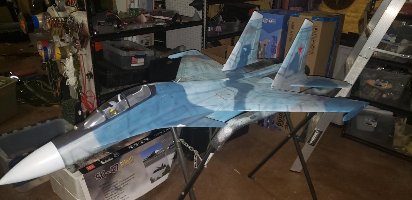

                        Nice work on those!
                        i will have to try that stuff on a a few planes and see if I can get the same results. This plane wasn’t easy to work with since everything peeled from the foam so easily.
                        I just covered mine in some flat clear to hopefully lock everything down. I got some graphics done but I’m waiting on some markings from Callie to finish that up. I next need to address this cockpit that is so basic. Pilots and some standard stuff are much needed!

                          #232
                          Sorry for the multiple posts, phone is not cooperating!

                            Excellent work, she is beautiful. Can't wait to see the graphics and any cockpit mods. I'm finishing mine up and all that's left is the urethane coating which will take me several days. Your exactly right, the cockpit is a bit plain, did a few things with mine and added a second pilot. When I finish, I'll post some photos, but it's nothing like the repaint you did, I kept the same scheme. :triumph: Don't have the patience for another repaint with this one (it was supposed to be an unbox and fly thing for once), as I'm still a long ways off of finishing my F-18 Canadian scheme and cockpit mods (will that ever get in the air-maybe by summer, gotta to stick with the more flying less modifying mode)? :disappointed:

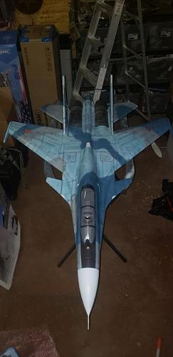

                              #234
                              Originally posted by dusmmdb
                              Anyone else converting theirs to a SM version?
                              im almost done with mine, I have a little painting left and graphics to add, but here’s where I’m at
                              mike
ID:	236006Click image for larger version
ID:	236007Click image for larger version
                              Really loving the conversion, you did a great job! What did you use for the conversion? Balsa, Foam or 3D Print? I'm waiting for mine to turn up here in Aus and planning on doing a similar conversion, but slightly different scheme. There is a few other things i want to do to this one as well one of which is the cockpit as either yourself or another post has mentioned, It is very plain. Also the IRST is that moulded into the canopy or glued?

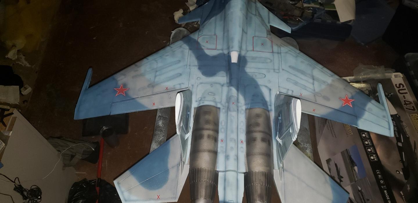

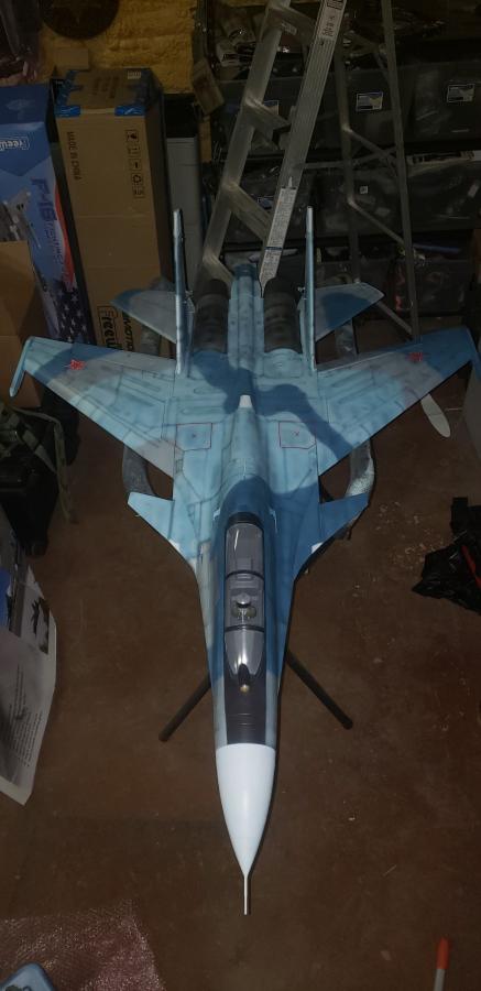

                                    It is molded into the frame which prevents some difficulty in moving.
                                    i used foam. I had some layered foam from an old kit (don’t remember the name) that I simply used the wings (see pic). The foam is stiff enough to stay rigid. I then used a small piece underneath to keep the canards from flexing.
                                    mistake I made was not removing the canopy before starting. Trying to remove it now has presented further difficulties. I’m not sure what they used to glue it on but it doesn’t want to separate from the foam as easy as a free wing planes does. I may simply insert a second pilot from underneath for now
                                    mike
