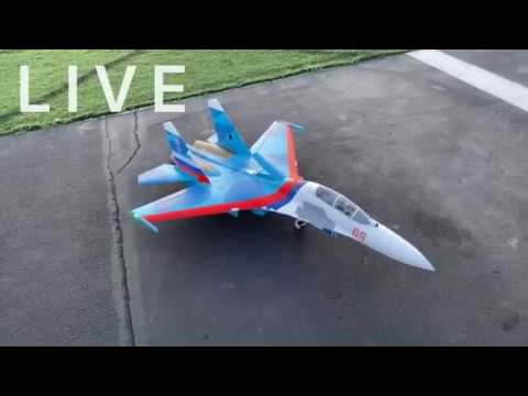

            Live video sunrise first tracks from Saturday at the 2020 Presidents Day fun fly in GORGEOUS St. George, UT. The Remote Possibilities RC Club flying field here in Southern Utah is absolutely gorgeous. Got up early to show everyone this fantastic EDF tearing up the pinky skies.
