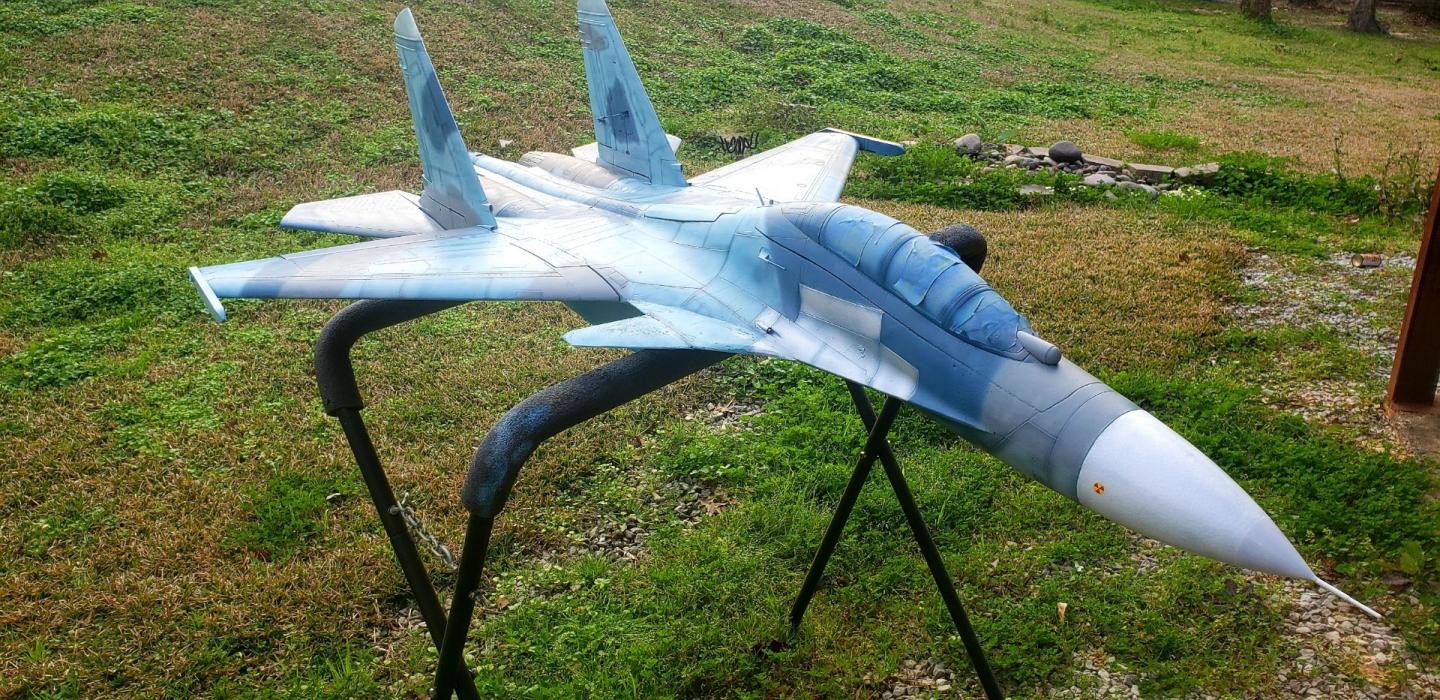

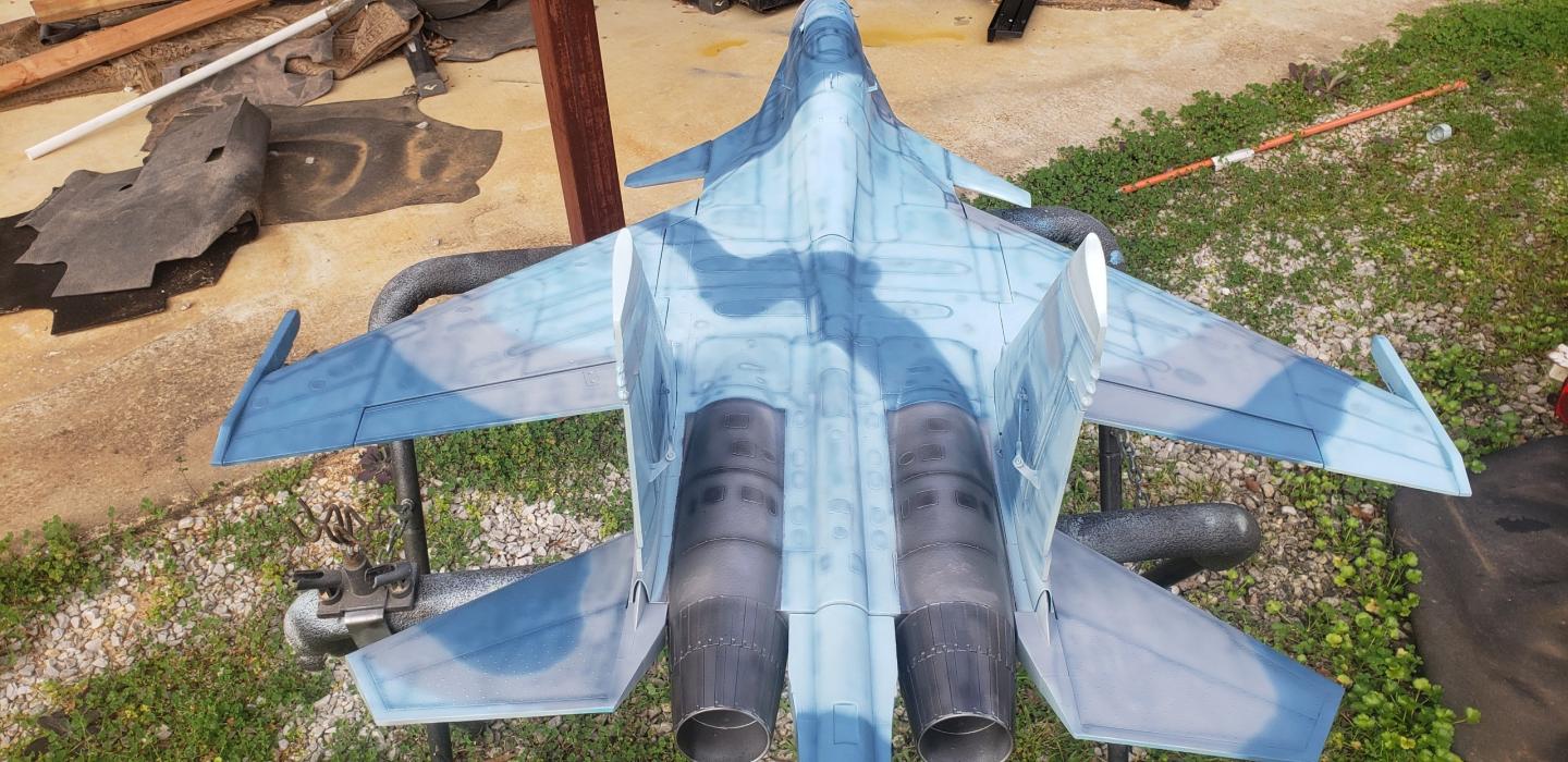

                Anyone else converting theirs to a SM version?
                im almost done with mine, I have a little painting left and graphics to add, but here’s where I’m at

                  dusmmdb That second photo is very impressive to me because it shows the subtle and intricate shading you've executed on this bird. Would you mind sharing your technique? Is this airbrushed with pre-shading or post-shading? Or is it surface pigments/chalks, or some other method? Whatever you did, it's looks great and I'm eager to see the finished result with its markings applied. I always like peeling away the canopy masking as "final step" Very satisfying.

                      thanks! All the shading is post painting. Basically once I get my painting done I begin with a mix of clear and grey/black about 75/25. I do the lines and edges. I then do another mix of about 90/10 to do my weathering.
                      The trick I learned is to then mix the original paint with clear... about 50/50 for a lite coat over the areas that I deem too dark and random other areas to create depth in the weathering.
                      Also during the base painting I will paint the majority of each color area and then finish with a mix of 90% paint and 10% clear for the missed spots. All in the effort for subtle differences in tint.
                      the engines are done the same with metallic paints and then the grey/black and clear over that.
                      All of this is is done with enamels via airbrush.
                      Mike

                        oh, one last thing. I hate to weather a plane then throw on markings and they are bright. So after I get the graphics on, I will do one last “dirty wash” with the 90/10 clear to black and once dry I will cover the plane in a final lite dull coat to lock it all in.
                        mike

                          Damn nice work :ok_hand:, just reminds me of another thing I can't emulate. :triumph: If I can't get it done with spray Rustoleum or hand painted testor's enamels, it doesn't get done. Seriously, that repaint is exceptional, congratulations, absolutely awesome job and I can't wait to see the finished product.

                            Hugh Wiedman thanks!
                            yeah I’m better at painting then flying them!! I took along break from the hobby and I’m getting back into it by working on getting some cosmetic work done. I did this and the avois MiG to kick start the hobby again. I haven’t addressed cockpits yet, but won’t due that until after maidens.
                            i really like picking out a scheme and then matching it.
                            thanks again
                            Mike
