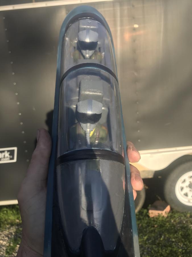

ID:	237670Click image for larger version
ID:	237671Click image for larger version
ID:	237672 I threw a second pilot, seats and a HUD into mine to make the cockpit not look so... plain
            now I have to clean paint up and do touch ups but I think this will do for now

              #246
              Originally posted by dusmmdb
              Nice, I guess E-Flight couldn't spring for the 2 bucks for a second pilot, either that or the cut-backs in the Russian economy are everywhere.
