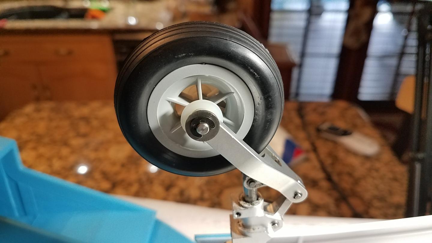

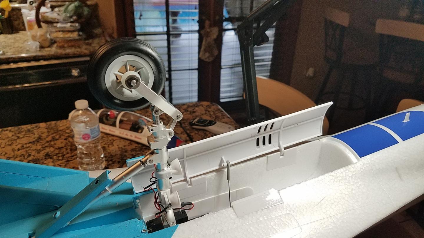

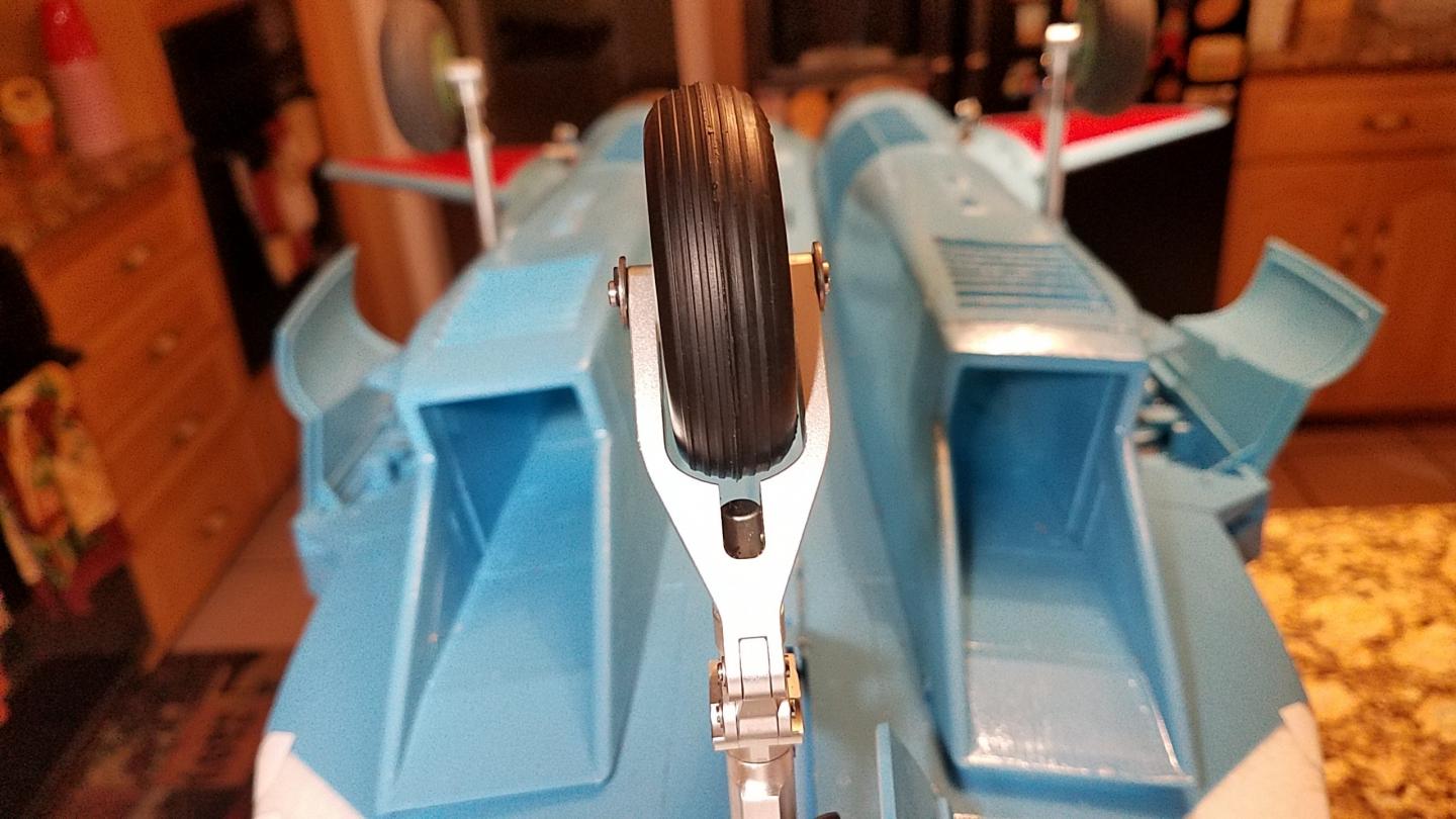

        Not much happening on this thread! Anyway, from my last post above, I could no longer get the SU-30 off of our grass field with the grass mowed from our new mower, it was 5/8" and now it is almost 1". It got off fine before about 30 times (not great, but needed 3/4 of the runway, but at least it got off). Tried it on 2 different days now and no luck. We are trying to get the dealer to allow it to cut a little shorter, but in the meantime, I thought I'd try using a different nose wheel. The majority of our members fly large gas or turbine, so the length of the grass is not an issue for them. I'm definitely in the minority with all my electric jets (all the prop planes are fine, just the F-4 and F-18 which do get off, barely, and the F-16 and SU-30 which do not get enough ground speed with the longer grass). :triumph: So I took off the grass shield and found that a Hangar 9 Pro-Lite 2" and 2 1/4" fit, with only a few modifications of enlarging the axial hole on the wheel and adding some spacers to keep it centered. No modifications to the nose wheel bay are needed even with the 2 1/4". This also gives a slightly higher angle when sitting on the runway. The stock nose wheel, although it has a 2" label on it, is more like 1 3/4".
        Any thoughts on if the larger wheel will create more drag? Not sure if the 2" or 2 1/4" is better, but going to try the larger of the 2 first. Maybe sometime this week if the rains and wind stop.

        The Stock wheel is on the left, the 2" Hangar 9 in the middle and the 2 1/4" on the right. Photos above are with the 2 1/4".

          Hugh, so ALL those wheels will fit inside the axle assembly? The physics of it would tell me that the bigger the diameter of the wheel (given the same wheel width, more or less), the easier it will roll, regardless of what it's rolling on.

            Larger nosewheel is always better in grass. Sorry about the grass issues. That sucks. Our club president is Covid paranoid but we're still flying. He keeps pushing masks but in 95 degree weather with 95% humidity that's just not practical. We have permanent shaders so we stay relatively cool. Back to topic, have you tried the FMS 3060 1900kV inrunners? They fit perfectly right into the Eflite fans. Helped my performance quite a bit. Got mine from RC Castle in Hong Kong. Great service. One week HK to SC. Our grass is mostly Bermuda and is cut to about 1 1/2". Our field has a slight downhill SSW to NNE so I can only fly edf's in the hot months when the winds are out of the north to northeast and I can takeoff downhill. Cooler months are no problem either way. Another option is to put a shim under the nosegear to increase the wing angle of attack. I added a 3/16" plastic shim under the nose gear of my Freewing MiG-21 and now it'll lift off in about 100 feet.

              Thanks xviper and jetdoc , your help is greatly appreciated. First off, yes all the Hanger 9 2" & 21/4" fit inside the axle assembly and retract into the nose gear bay (the grass catcher took up some space so with it gone, they all fit nicely). Just had to enlarge the axle hole on the wheels and add some No. 6 stainless washers on the outside of the assembly to take the place of the plastic grass catcher thickness. Then the plastic wheel hub rims are narrower than the stock (although the rubber wheel itself is the same width) so had to add some 8-32 Nylon flat washers on the inside of the axle assembly to keep the wheel centered.
              Secondly, I haven't tried the FMS 3060 1900kv inrunners but if you are able to get off on 1 1/2" of bermuda grass, they must have a lot more guts than the stock 12 blade 1850 Kv inrunners because originally our bermuda grass was cut at around 5/8" and now it's just over 1" and I can't get off. Instead of adding a shim, I figured the extra 1/4" in wheel height from increasing the diameter by 1/2" might do the same thing.

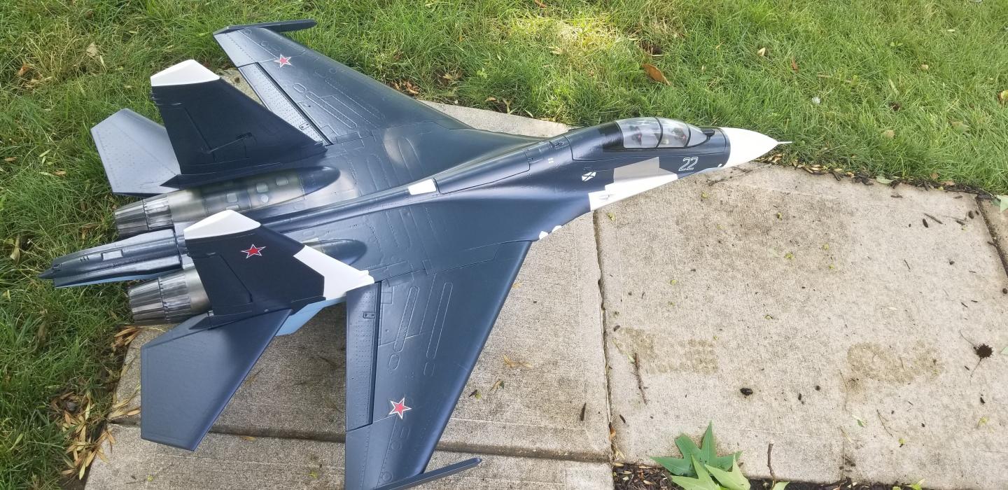

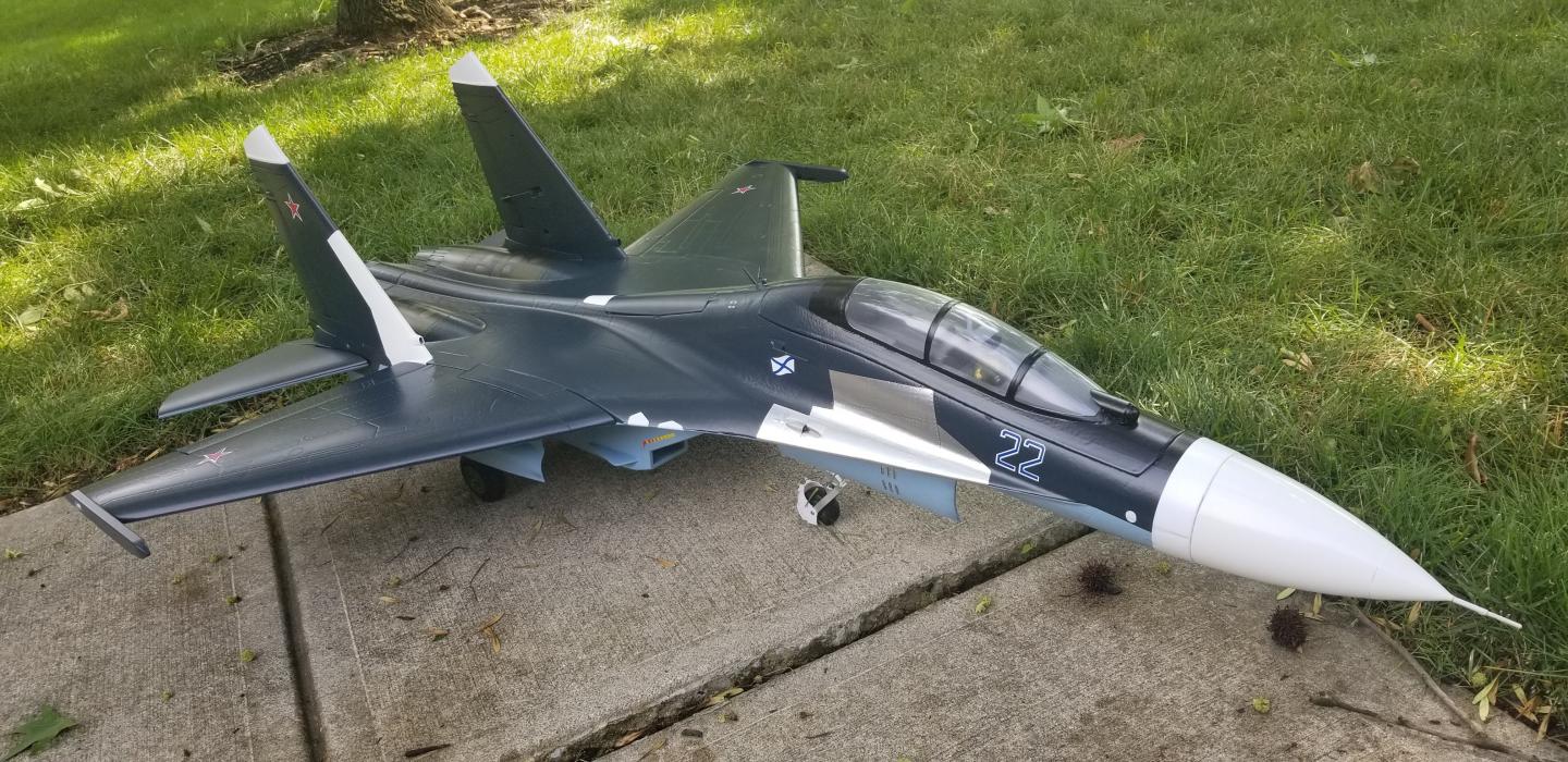

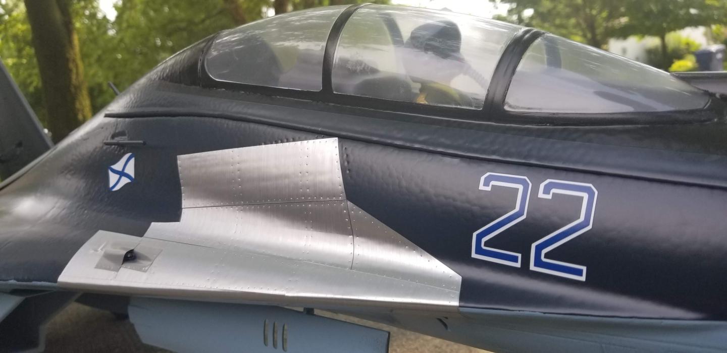

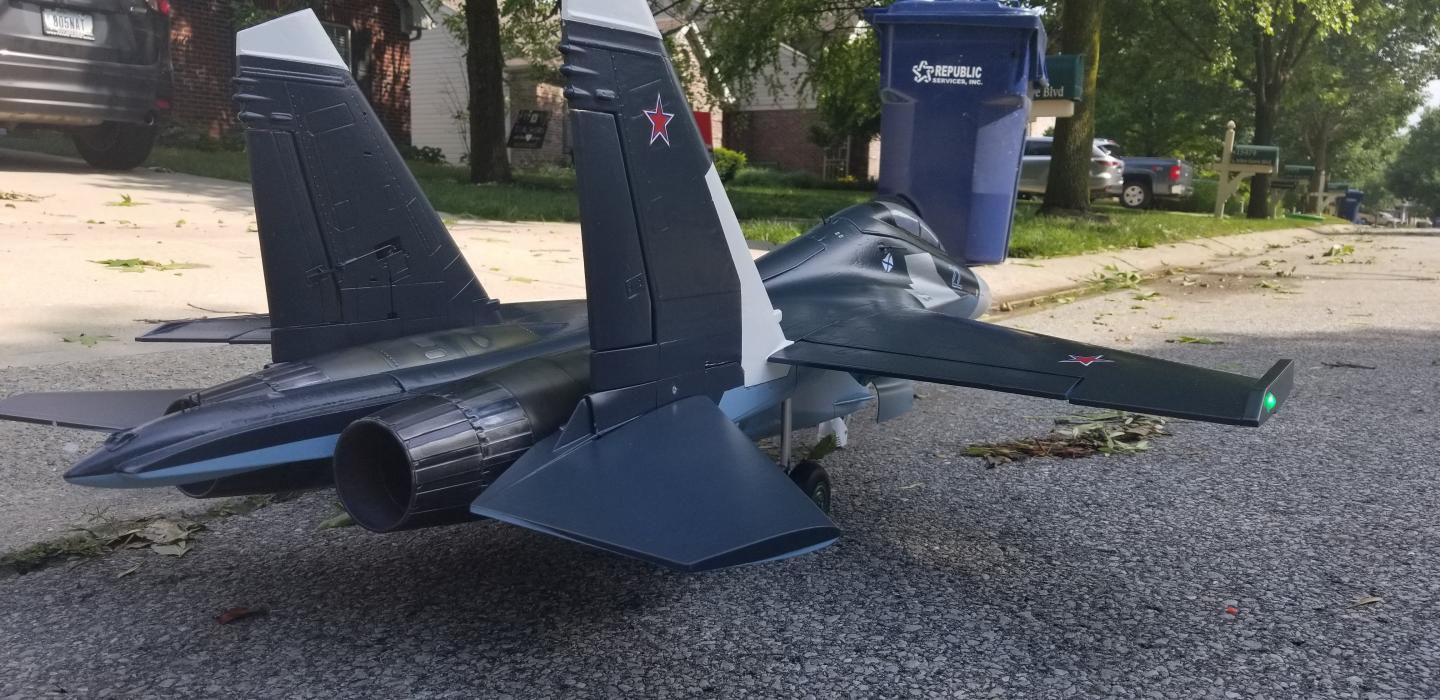

                Just wanted to say hello and show off my SU30 that I haven't flown yet. Still stock but I haven't bought batteries for it yet. I'm leaning towards the HRB 6000 and was curious about what other's thoughts are. Also the CG spot is between 115-150mm, how does that work? I actually made decals for the spot as you can see on the top of the wings near the wing root. Anything I need to be aware of.
                  Any CG numbers given in any manual for any plane is purely a "recommendation". What you see for this plane is a recommended "range". I always start with something in the middle and change it by moving the battery until it "feels" right for me. What is recommended and what any pilot ends up with may not be the same. What feels right for you and what works best for you might even fall out of the recommended range. However, I tend to go for a bit nose heavy when doing a maiden and go from there.

                    Clooney nice repaint on the SU-30. I agree with xviper 100%. I think you'll find this to be a "heavy" flying jet (I call it "the bus"). It is definitely not very agile and rolls even with high rates on the aileron fairly slowly. Once it does get going, it carries a lot of momentum, so landings can be a little tricky at first, guess that's why they installed an air brake and most use it on landing, not the typical use of slowing it down after landing. I programmed flaperons in it as well solely to help in take-off since I fly it off of grass, although landing with full flaps and the air brake is nice for me. On landing, make sure you try to get the nose up, at least slightly to avoid too much pressure on the nose gear, so you're air speed is critical.
                    Regarding batteries, I use the RT 5500 70C or the HRB 6000 50C, both of which give decent full throttle thrust. The only negative (especially with the 5500 mah) is the limited flight time of 3:15-3:30, so I now have some Hobbystar 8000's to try, but am having a problem at our field with the grass length and even taking off now with the 5500-6000 has suddenly been a problem. Put a new 2 1/4' wheel on the nose and hopefully that will help.
                    Regarding the CG, which as xviper said is a personal preference, I maidened mine at 125mm, but fly it now more like 135-140mm (helps get it into a nose up attitude on landing for me better) with the battery all the way back, but follow his advice and you won't be mislead! Happy Hunting, but keep it clear of any Freewing US fighter or it will easily get smoked!

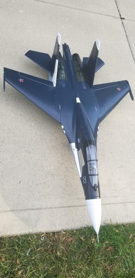

                                    After limited success with the a-10 this su-30 has really pushed me over the hump. I've put about 40-50 flights on it in the last week and it's been awesome! Learning alpha and better approaches. This thing is a bit hard to keep on the short runway, but getting better every time! Love this jet, although it's a bit under powered. I can pretty much hit the landing like this or better every time.
                                    My mistake was taking the a-10 up as my first EDF ever; not that it's a poor flier. Honestly I probably would have crashed this su-30 the same or worse had I tried to make this my first jet flight.

                                      You'll get it. It's just a matter of setting up the final so your wheels touch down closer to the start of the runway. My runway is about the same length. Most landings come to a stop before the end but a couple still sees it running into the grass at the end. I keep my fingers crossed that the speed is low enough when that happens. So far, the nose gear has held up quite well.
