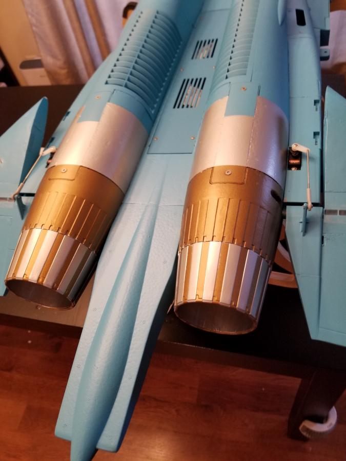

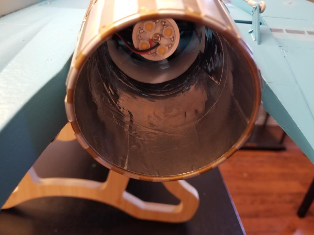

              Su-30 detail up project part 1.
              So far what I did:
              1. Cover many of the foam slots in the airplane with scotch tape to reduce drag (these are those little slots that are made by the foam mold that holds the carbon fiber rods inside the foam in place while the foam is filled around it) They serve no purpose after the foam is molded except to create drag. Doing all of it around the plane adds up.
              2.Mask the canopy & Spray the entire plane in Minwax Polycrylic Satin.
              3. Add Cyclone power centerburners
              4. Add foil tape to inside nozzles to reflect the AB
              5. Paint alternating turkey feathers silver, and paint a silver section on the bottom. (haven't done any sections on the top yet)

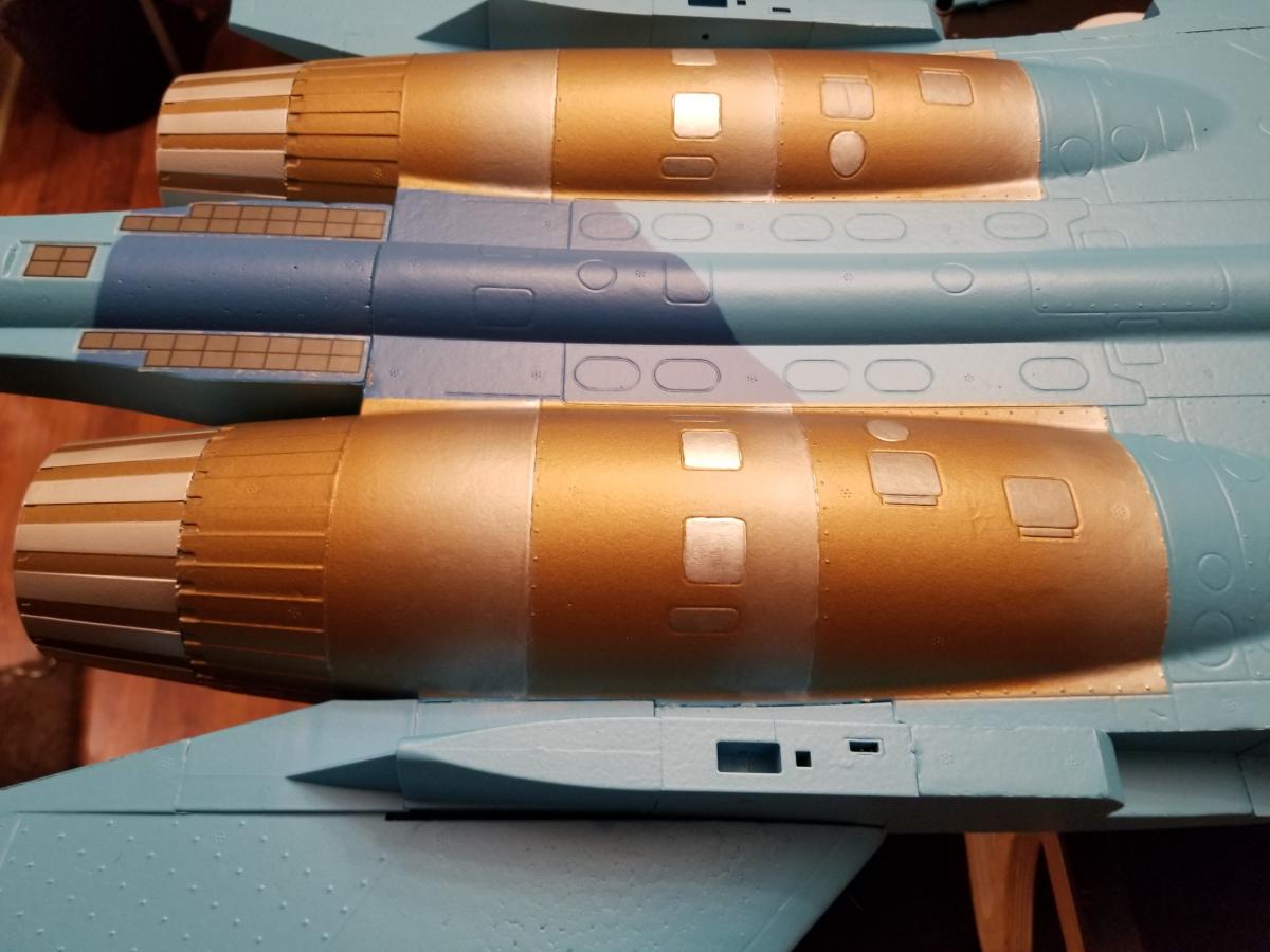

                    Su-30 detail up project part 2.
                    1. I painted the pitot tubes silver
                    2. Painted the upper level engine sections. I used a steel colored oil paint, and then you blend the paint to make a fade effect.

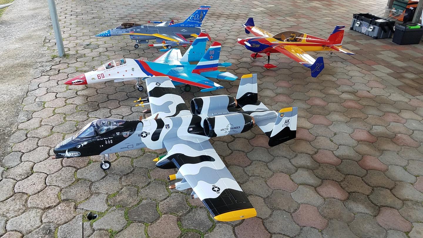

                                    Got out today and got another 5 flights on 4 different aircraft. I'm now using a lighter 5000 mah battery in the SU-30 and I think I've found it's sweet spot. That's now the permanent power source for mine. It was just too sluggish on a RT 5500 or an HRB 6000 but the lighter 5000 really helped it's flight characteristics, although it still takes a good 150 or more feet to lift off of grass. And I still get about 3:20 of flight time, the same as I got with the 5500 and the 6000, as it needs a bit less throttle to achieve the same flight maneuvers. Unfortunately since this is such a heavy jet and IMO underpowered, any little extra weight just destroys it, so the lighter the battery, at least for me, the better. I've been trying all sorts of batteries to get better flight time, but it just isn't happening, so might as well go lite and at least it flies better (not great, just better and barely acceptable). If it didn't look so good in the air, I probably would fly it maybe once a year.
