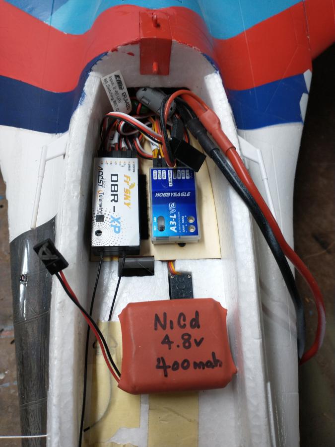

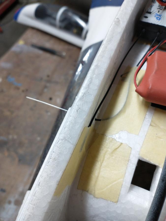

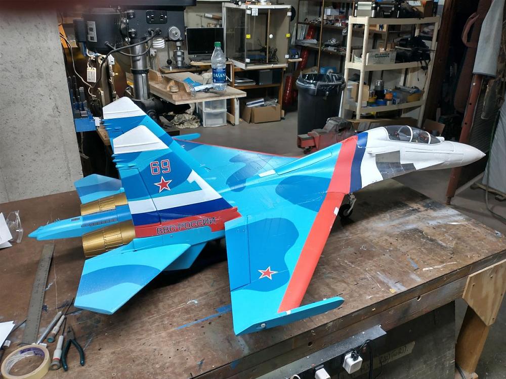

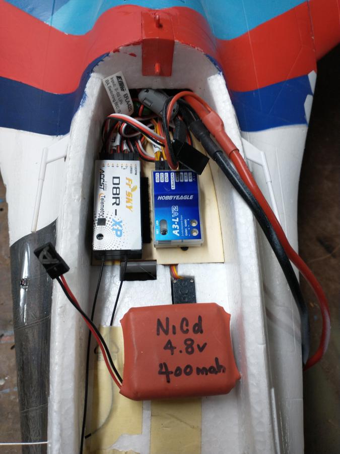

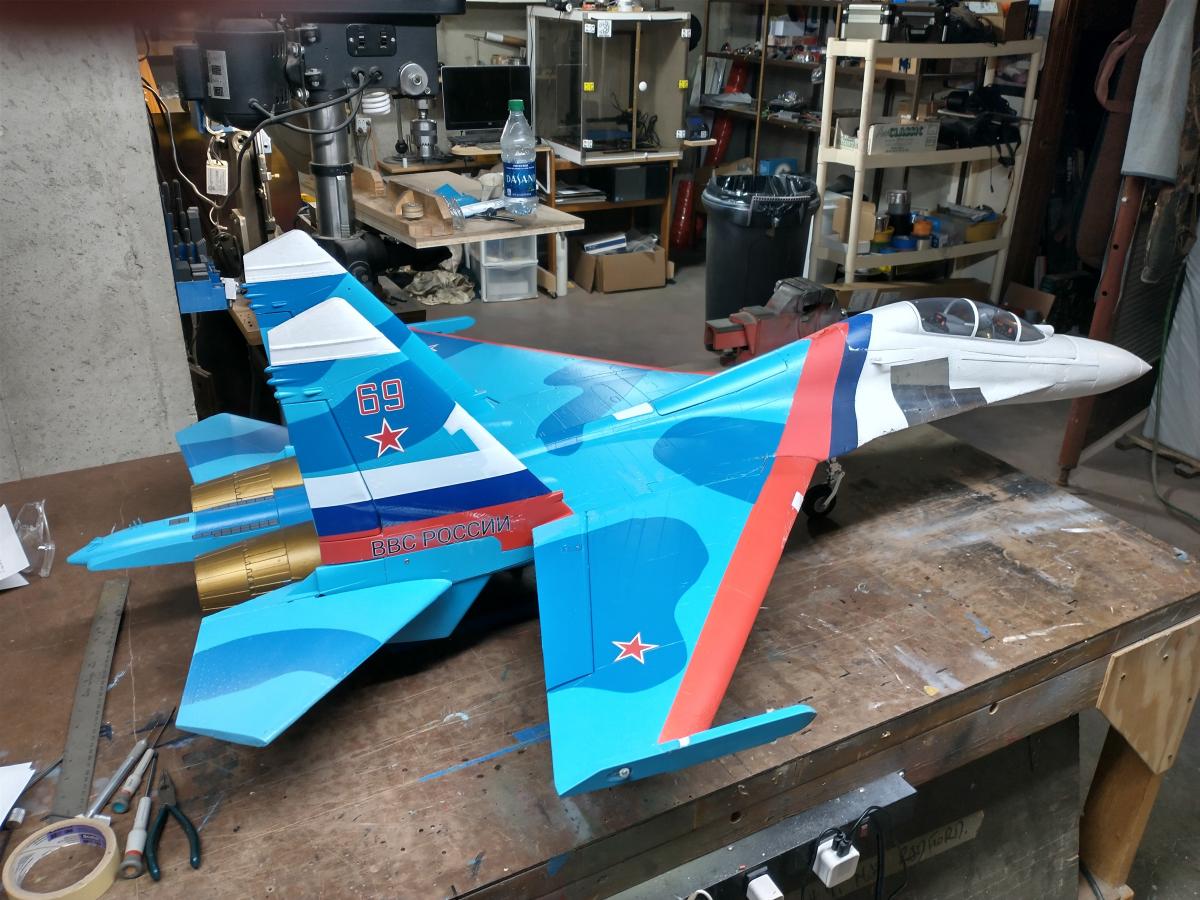

        All repairs finished and ready to fly again. Things to notice... added a gyro; not because the plane needs one but it was the easiest way to get tailerons and improve roll rate. Added a 4.8v NiCd pack as a redundant Rx battery. Routed the Rx antenna outside the fuselage to prevent getting blanked by the battery when the plane is coming head on.

          Looks as good as new, well done. Let us know how she flies now. BTW, what CG are you at and what battery and weight are you using. Interested to find out how it performs with the tailerons. Also, are you landing with or without the speed brake, inquiring minds what to know!

            CG was ~145mm...about a half finger in front of the 150mm marks. I will need to recheck after the repairs. The plane may be just a little lighter....The gyro and battery added weight, but I removed all three gear doors and door servos. Two of the doors were broken so just removed them all.
            I used the Zeee 5200 (770g) and the CNHL 5000 (824g). First landing was without air brake and then the next ones were with the airbrake....lands better with.

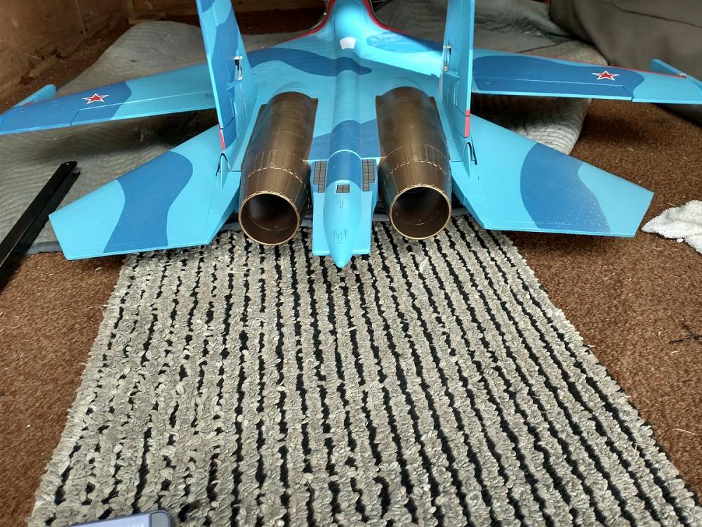

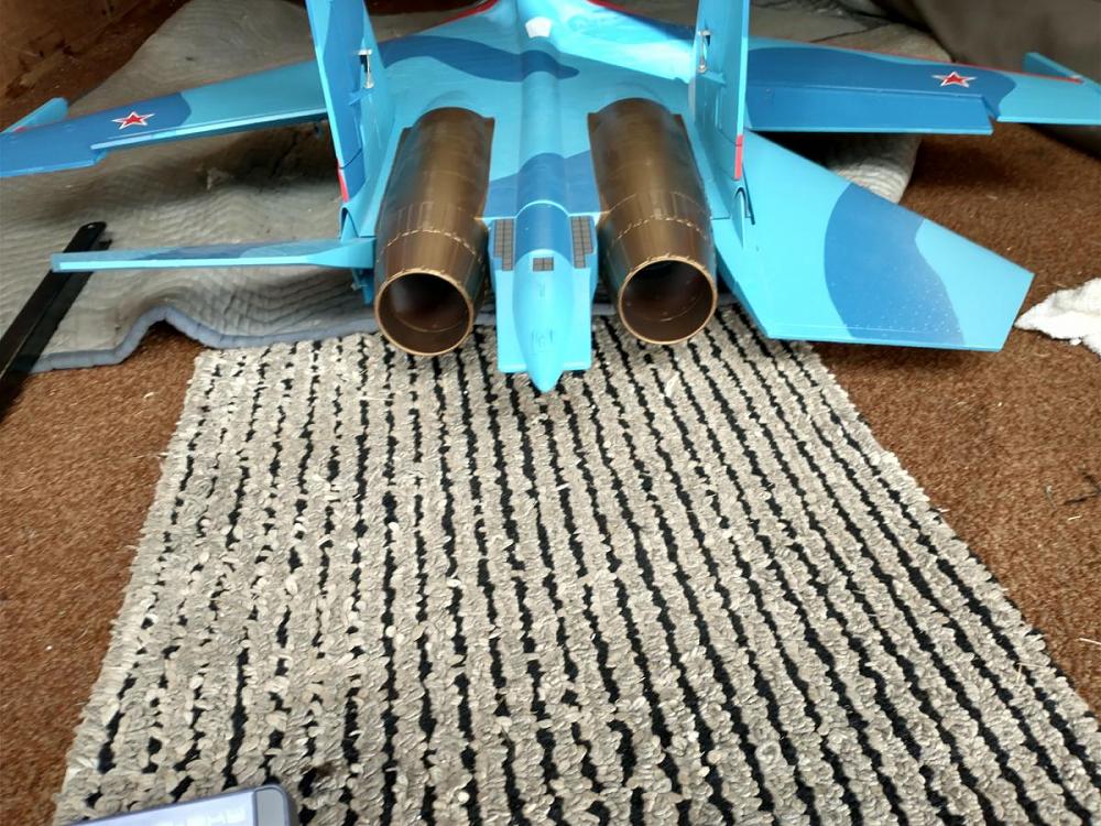

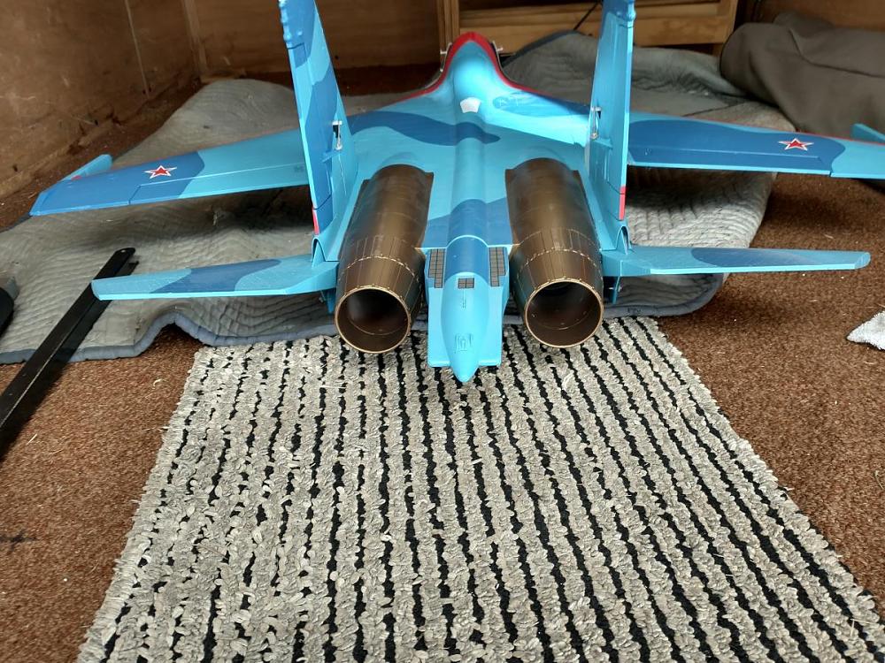

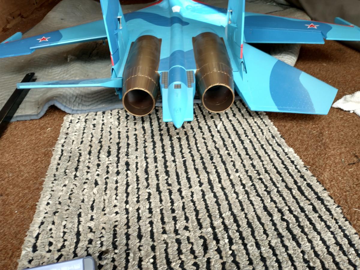

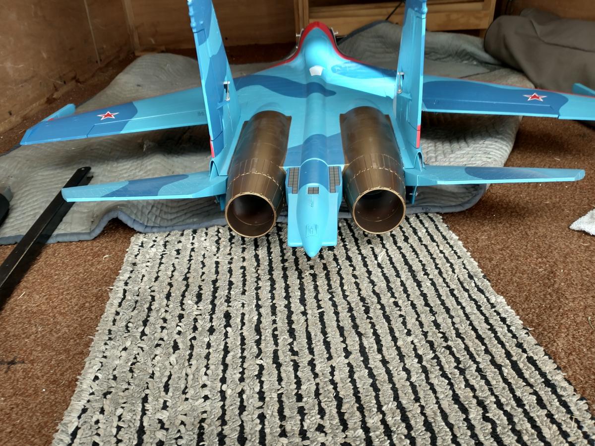

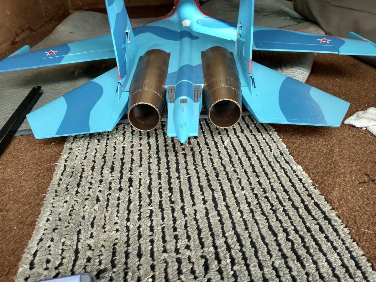

                    I will measure later. This is high rates. Low rates are 60% of this. Click image for larger version  Name:	IMG_20210311_100320960_HDR.jpg Views:	0 Size:	203.0 KB ID:	303715Click image for larger version  Name:	IMG_20210311_100315348_HDR.jpg Views:	0 Size:	231.9 KB ID:	303716Click image for larger version  Name:	IMG_20210311_100311591_HDR.jpg Views:	0 Size:	230.1 KB ID:	303717

                      Got a break in the winds today and flew five flights. With the tailerons set at max throw as shown above the rolls were blurry fast. I ended up with the following settings: End Points for ailerons 60/60; elevators 80/80. Tail movement measured at the trailing edge of the stab: aileron High rate 23/23mm; Low rate 17/17mm; elevator High 35/35; Low 20/20. Expos all set at 40%

                            Adding the tailerons to this plane did require just a little "tweaking". I used a cheap Hobbyeagle A3L gyro. The gyro does the mixing for the tail internally so you don't have to do anything in the Tx. But, because the tail and the wing ailerons needed to move in the same direction I did have to reverse one of the tail servos. I took the servo apart and switched the motor wires and the two outside wires on the pot. This of course meant removing the servo from the plane which meant removing one EDF and the ESC cover to get the servo wire unplugged. Not a big deal.
                            A way to avoid this would be to not use the wing ailerons at all. Configured like that you wouldn't have to change the direction of the tail servo physically, but could do it in the gyro programming. I think the plane would roll great with just the tailerons. Then you could use the wing surfaces as flaps only. I might give that a try.

                                    but using a HobbyEagle A3L will limit the gyro control to only the tail.
                                    In rate mode and the gains at 50%, the gyro was too sensitive and the plane was rocking side to side. I turned the gains down to 25% to get things smooth again. This plane really doesn't need gyro stabilization at all. Solid in the air.
