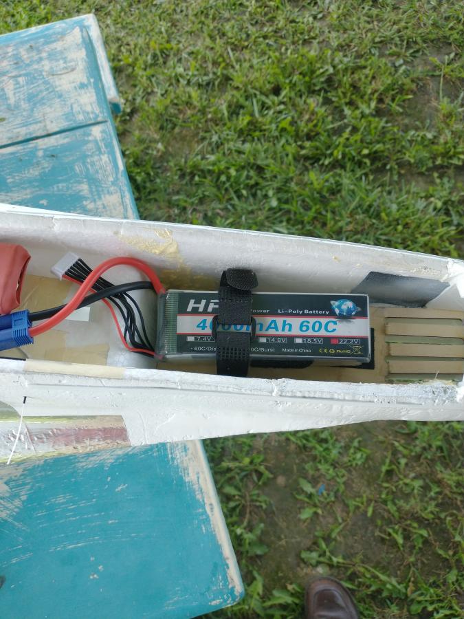

                I'm with Hugh...get the CG back to 145-155 and you will enjoy the plane more. I put the front battery as far back in the battery compartment as possible and that gives about 145mm for CG.

                      You had your battery all the way forward and added some more weight? Doesn't compute!

                        My CG is here with batt all the way to the rear. Click image for larger version
