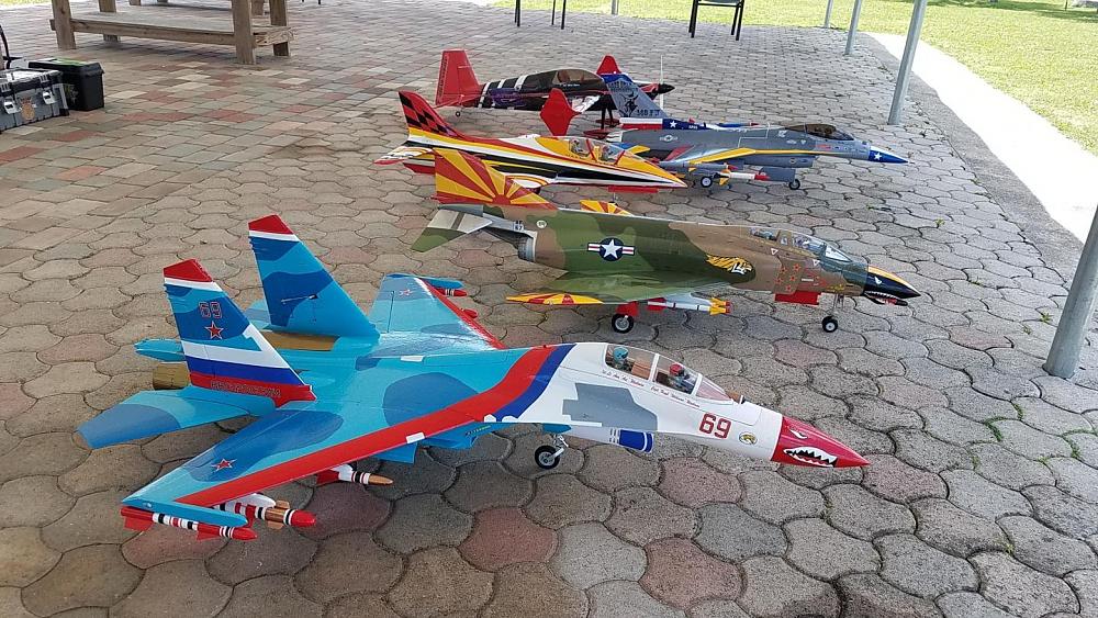

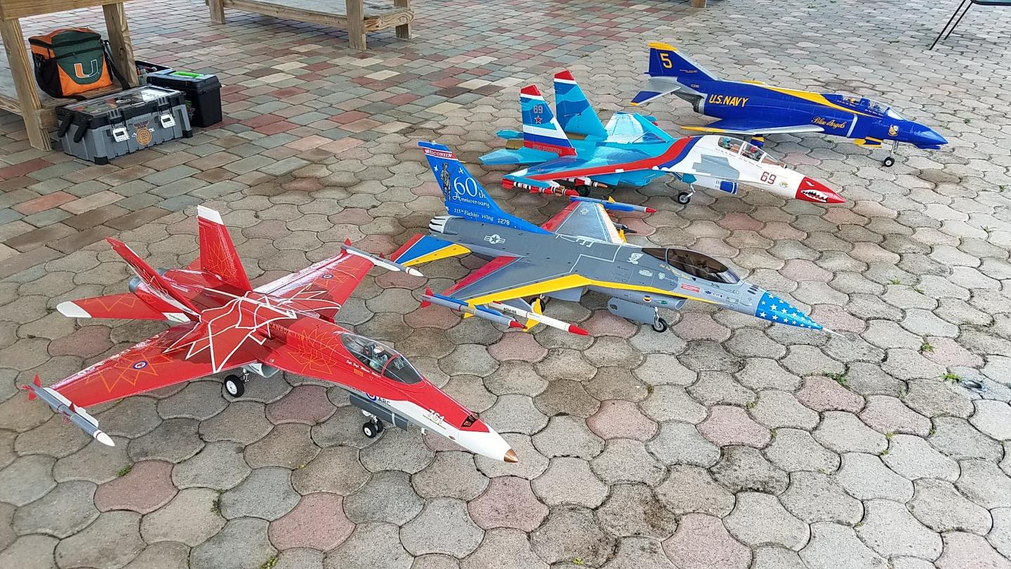

        • Got out again today with the SU-30, as well as the F-4 Blue Angel, F-18 Canadian and the F-16 (all of which have the 12 blade FW 90mm inrunner). Not to sound like a broken record, but those FMS fans really make a huge difference on the SU-30. Actually I like flying it best on the 5000 mah true 40C battery better than the HRB 6000, which has a lower true C. With the lighter weight and higher actual C, it just get offs so quickly and goes vertical like a rocket, I just can't pass it up. Only getting about 3:20 on the 5000 but then I really only got about 3:35-3:45 on the 6000. I kind of screwed up my final landing with a 15 gusting to 20 mph swirling wind, and tried to overcompensate with too much throttle and bounced the first touch, but like an idiot, punched the throttle and kept the nose down and it lifted up like a rocket instead of ending up in a really bad crash. Surprised the hell out of me and RudyD54 who was standing next to me. Never could have done that with the old fans.

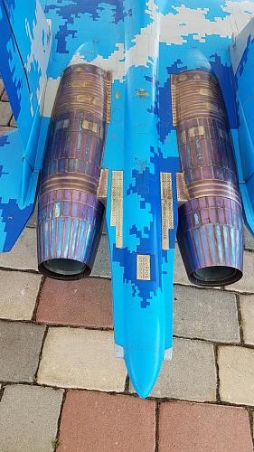

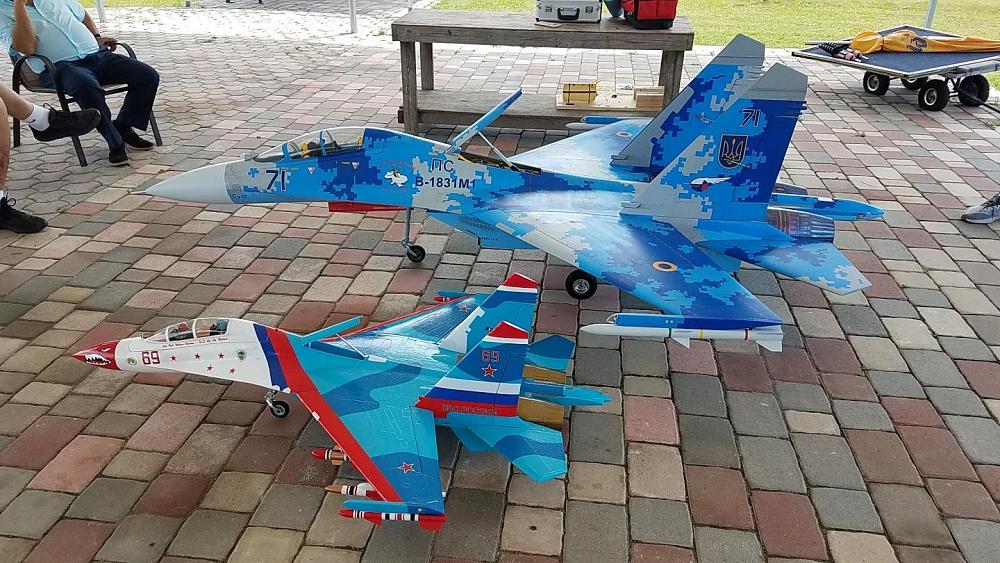

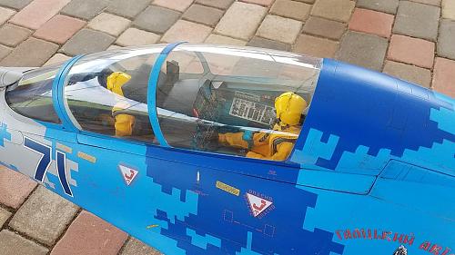

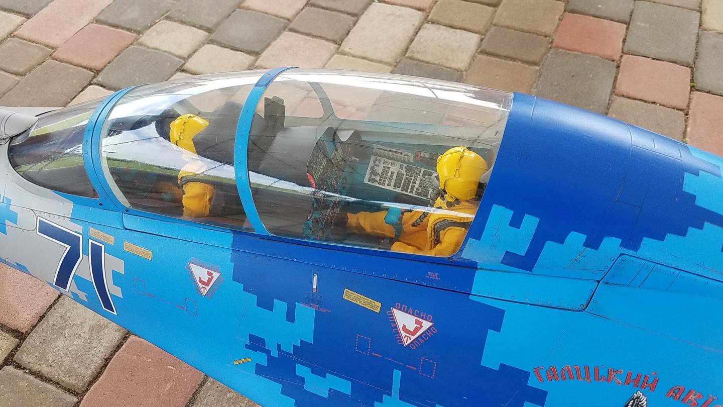

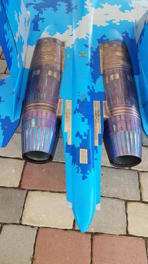

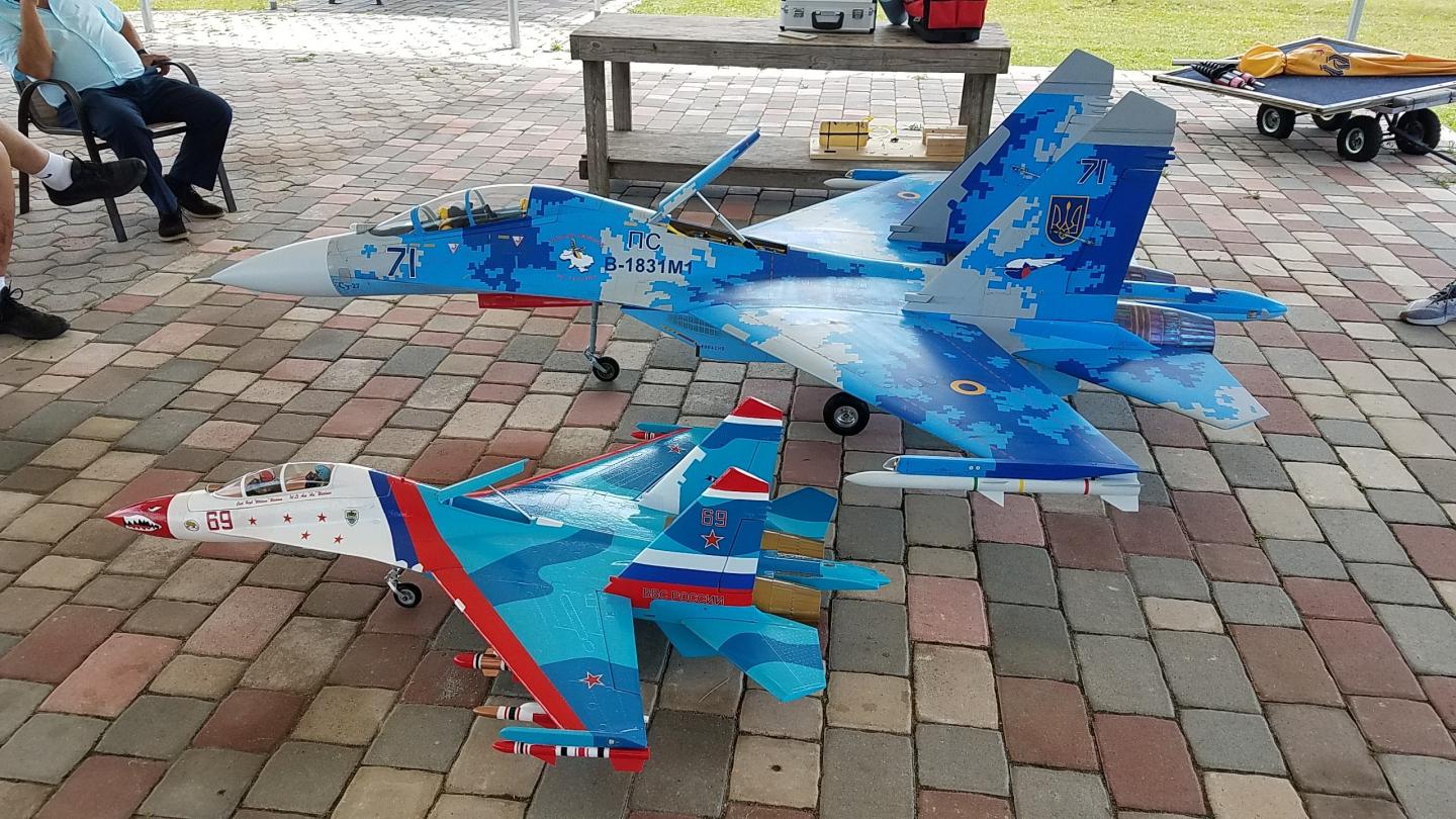

          Another member showed up with his $15,000 Turbine SU-27. Damn, that's one sweet bird, flies incredible, lands smoothly and gives over 10 minutes of flight time. And the vertical on that one is off the charts (FAA height limits be damned). If I had the cash, that's the one I'd get, but not to worry, I'll never get close to being able to afford something like that! Costs more than my "red neck trailer home" located in the swamp!
          Click image for larger version  Name:	20210513_122940.jpg Views:	0 Size:	325.2 KB ID:	312631
          Can you tell which one is mine? If not, you definitely need some new spectacles
          Click image for larger version  Name:	20210513_123311.jpg Views:	0 Size:	244.6 KB ID:	312632Click image for larger version  Name:	20210513_123054.jpg Views:	0 Size:	166.1 KB ID:	312633Click image for larger version  Name:	20210513_124950.jpg Views:	0 Size:	98.7 KB ID:	312634
          Love his "Heat Weathered Nozzles", or whatever you call it. But for that price, it should be able to take you out to dinner at least!

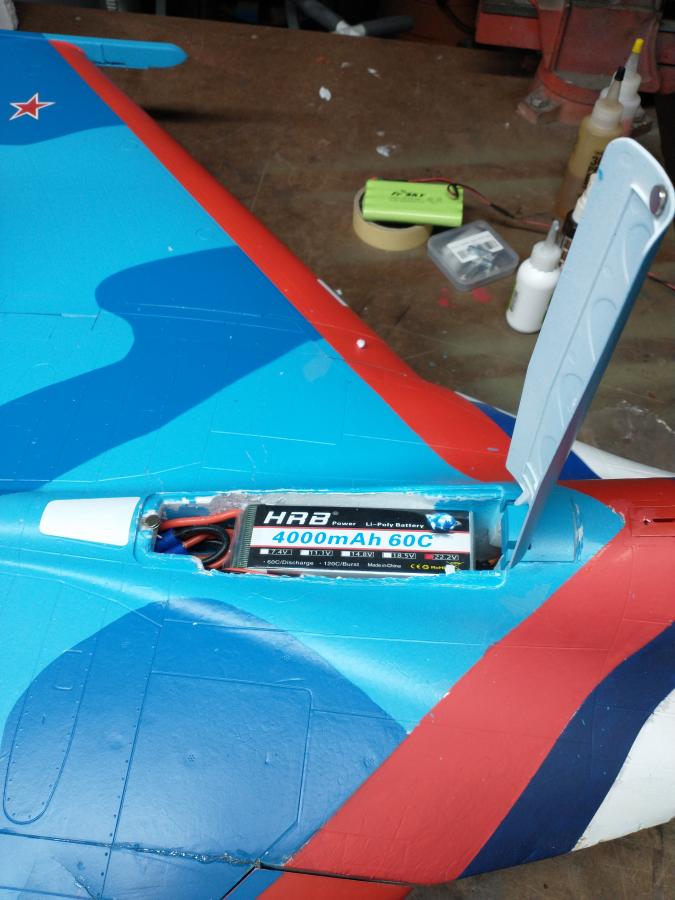

                        I saw on RCG that some guys are using two batteries in parallel in this plane. One 4000 mah battery in the nose and a second 4000 in the bay under the air brake giving 8000 mah of total capacity. Weight gain of two batteries is somewhat offset by removing some tail weight.
                        What do you think?
                        Red Alert said: "HRB 6S 4000Mah fits in the airbrake compartment, with a little bit of foam removed on the sides. My setup is 2 x 6s 4000Mah in parallel. 120g dead weight removed from the tail.
                        This plane should have never been designed / marketed to run from a single 6S 5000Mah IMO. A modern (heavy EPO) twin 70mm jet needs 2 batteries.
                        I strongly recommend this mod, for the following reasons:
                        - Easier to setup the proper CG. It's nearly impossible to get a good (not nose heavy CG) with a single pack on this jet.
                        - Less voltage sag, more power, even on stock motors
                        - Easier on the batteries, the wiring and connectors. 150A should be ran off 2 packs.
                        - More flight time"

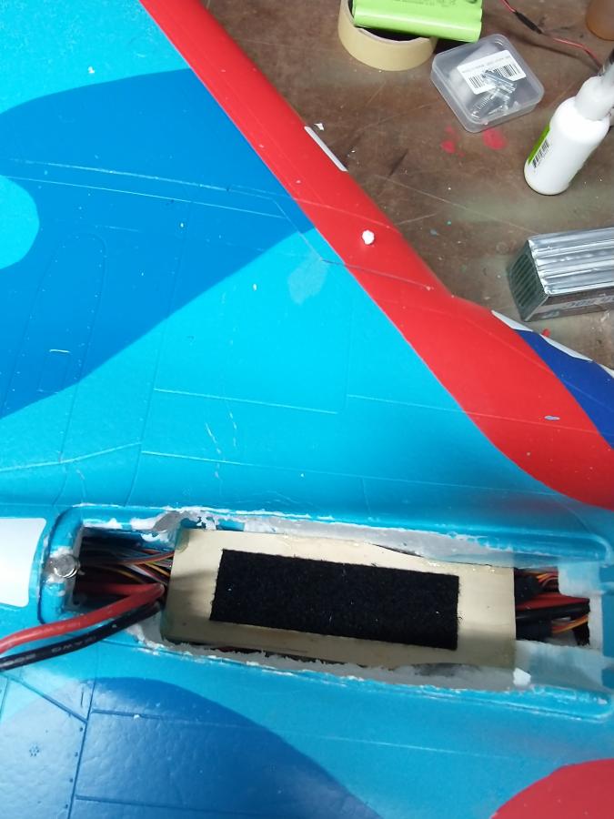

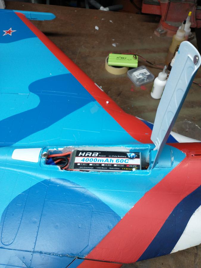

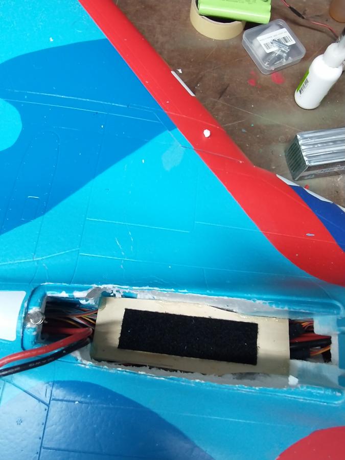

ID:	315493 I did the dual batt mod today. First, removed the air brake servo and cut away as much foam from side walls as possible. Rewired the ESC's so as to have each one connected to a separate battery...like the Mig-29 does. Total weigh is up to 10.5 lbs, CG is at 150mm. Test fly tomorrow.
                          • And...now I'm happy with this plane! The dual batteries make this thing fly like it should....good performance (with the FMS fans) and 4 min's flight time. Flys very much like the FW Mig-29.
                            • Are you using 2 X 4000 mah batteries? I use a single 5000mah and get about 3.5 min. I'm surprised you get only 4 min. with 8000mah. I would have thought you could break 5 min with that much battery in there. It was amazing to see it lift off grass with the extra weight, even with stronger fans. It did appear to land very fast with no air brake.
                                With 5000 batts I flew 2:30 and they were at 5% charge. Also the batts were extremely hot, as was the EC5 connector. I'm sure that the two FMS fans pull over the 120 amp spec for the EC5...maybe close to 150. With two separate batteries each EC5 only sees about 75 amps max.
                                It was a zero wind morning so I made sure to keep my landing speed up a little. I never found the air brake to be of much use. I find flying with two 4000 batts to be great. With just easy flying I'm sure I could come close to 6 min's.
