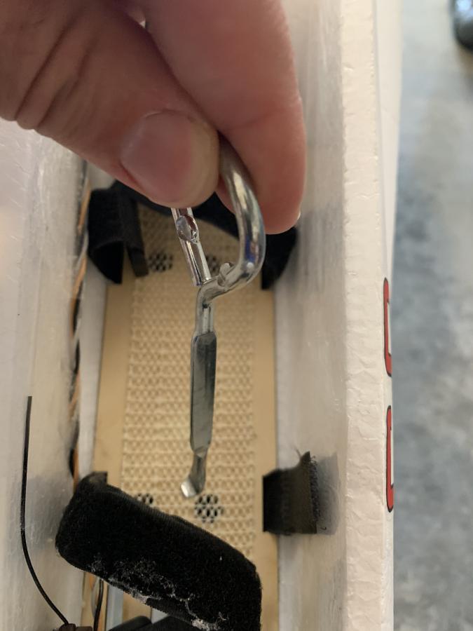

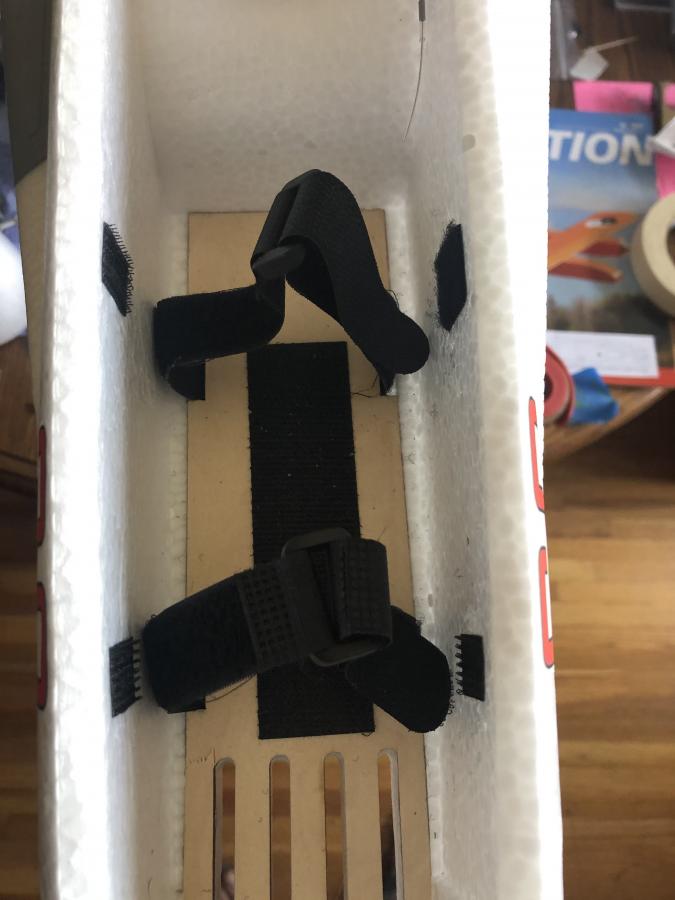

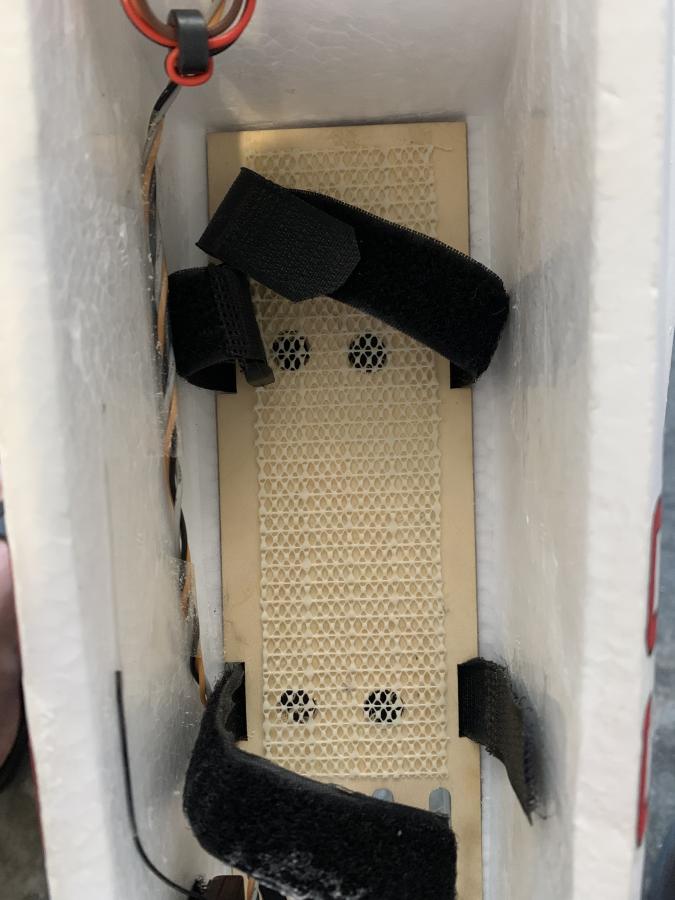

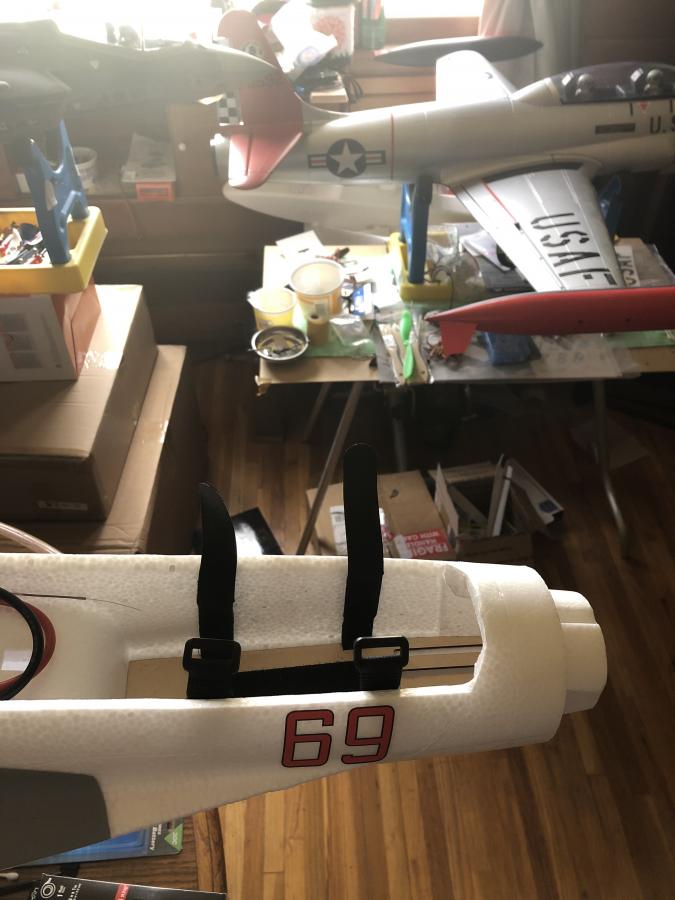

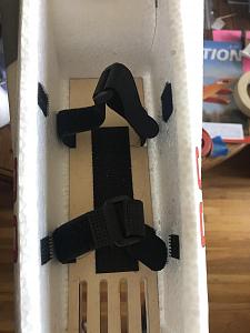

    Thanks gents! The drilled hole idea worked! I drilled 2 x 1/4” holes where each strap was and then used a paint key in the hole to help separate the rest of the strap from underneath the plywood. No need to pull up the whole tray. Thanks guys!!!

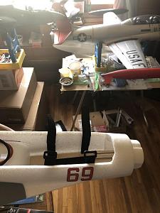

    Here is another little tip I like to use on all my straps, so I do not have to fiddle with keeping them out of the way while installing the battery

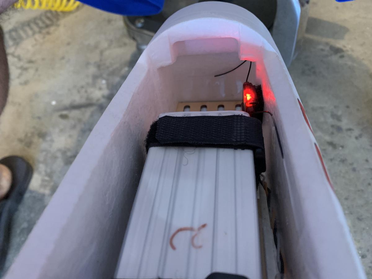

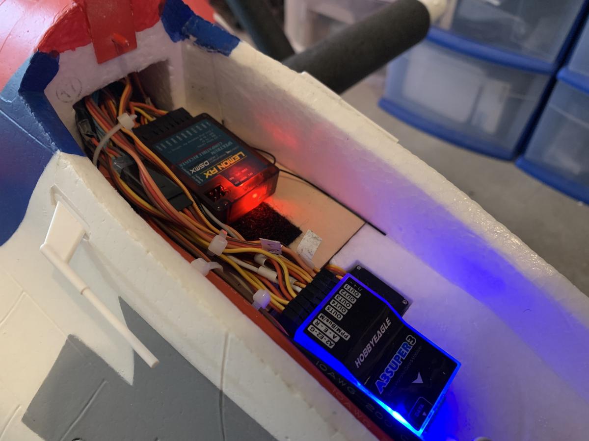

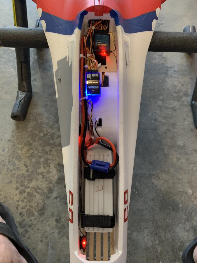

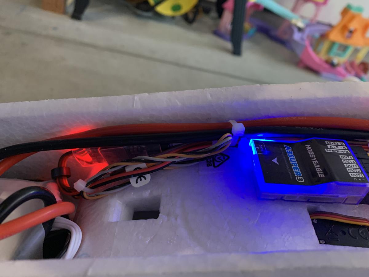

    Also, here’s my setup if anyone is interested-
    -Lemon Rx 10Ch with satellite
    -Castle BEC 2.0 14a
    -Hobby Eagle A3 Super 3 gyro
    -FMS 1900kv Platinum motors
    -Hitec HS-5065MG servos in the elevators
    -Swapped the stock 13g elevator servos into the ailerons to replace the stock 9g servos.
    -Roaringtop 6250mah 35C battery
    -Custom programming: Tailerons, Flaperons, separate nose wheel steering channel tuning on the knob. 33% Gyro stabilization on the flaperons for roll, tailerons for elevator, and rudder. First notch of flaps is flaperons down, second notch of flaps just adds the speed brake extended.
    You can also see my antennae and satellite placement which seems to work well. Needed a 600mm extension to get it up there in the nose. I previously had it in the nose gear well and had a small dead zone when the model was head-on. Getting the satellite in front of the battery fixed the issue.

    Not only E-flite but Free-Wing, Flight Line and FMS, and others. I have cursed all these manufacturer's for this very annoying problem, it is usually an easy fix, but a real pain in the rear Sliding a feeler gage between the strap and the ply works well rather then drilling holes in the ply and then poking it with a screw driver, but if there is a lot of glue on the strap an ply drilling holes and using a screw driver to work it loose is also a good way to fix the problem
    Originally posted by Gvasiloff
    Has anyone successfully pulled the battery tray out of this thing? I fact that the straps are glued down and you can’t rotated them is driving me nuts. The buckle on the strap is always right on the corner of the battery. I’ve yanked on the tray pretty hard and it shows no sign of coming loose. If you managed to do it, please share the method that you used.
    Mine was like that from the factory as well (as many others were). I first drilled about an 1/8" hole in the center of the battery tray where the strap is, careful to only drill through the wood. Then inserted a philip head screw driver (or some other tool) in the hole to force the strap down and loosen it. On both straps, I had to drill holes at various locations, moving toward the edges, until I was able to get the straps loose. One strap required 3 or 4 holes spread out, the other about 8 :face_with_symbols_o. Once you get them free, it will make installing the battery sooooooooooo much easier! :hugging: Can't tell you how often I cursed HH/E-Flight over this simple thing when I first started flying this bird. Of course found a bunch of other reasons, but done with this one issue.
    Both the straps in my SU-30 were loose and moveable. Another guy I know had the Same problem you have. The straps have glue on them from the manufacturer getting to much glue on the plywood tray and it spreads out and glues the straps in place. What he did was to take an exacto knife and cut along the strap on both sides, removed the strap with the ply glued to it, removed the glue from the strap and carefully reinstalled the strap and the ply making sure not to get any epoxy on the strap. I have had this problem in a few other planes but was able to pull them loose in some other planes when removing the battery the ply wood tray has pulled loose from the foam and came out with the battery. one thing I have done is to take a feeler gage and try to slide it in between the trap and the plywood plate to break it loose. good luck
