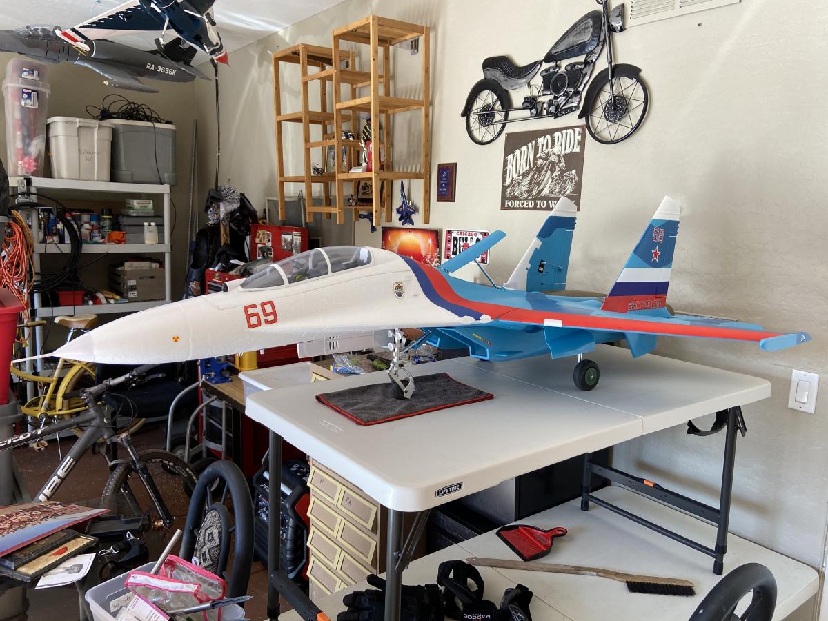

    Almost every EDF/Prop plane out there has something for someone and clearly each has it's fans and foes. I personally like the SU-30 and the Mig 29 (you can enjoy flying each, sometimes for entirely different reasons), but then I've never owed an aircraft I didn't like for some reason or another. Sometimes the ones that are the most difficult and offer more challenges keep my interest longer trying to conquer it. The SU-30 IMO has some pros as well as cons (although most of the cons are because I fly off of grass which this EDF is not well suited for-a HH rep even told me that at one of our events and he was not necessarily mistaken).
    The Pros:
    • It is a stunning looking EDF on both the ground and in the air (a top 2 reason I get any aircraft), especially with afterburners since the LED's are very near the end of the exhaust nozzles.
    • It flies, IMO, OK once in the air, although it is no where near as nibble as the Mig. But then we still haven't figured out the cause of some of these crashes yet, so that's something that is always on the mind when getting the Mig in the air!
    Some of the Cons: (Many of these are associated with grass Ops though)
    • It's definitely underpowered compared to the Mig (or any other large EDF I have) but frankly that problem affects taking off of grass primarily.
    • Flight times are shorter than the Mig since it only has 1 battery powering 2 70mm inrunners vs 2 powering 2 80 mm inrunners.
    • It is about 10 inches shorter than the Mig and 8 inches less in wingspan, but I feel the weight of the SU-30 is just about at the limit for these 70 mm fans. The Mig seems sized perfectly for 2 batteries and the 80 mm fans, giving it plenty of power for getting off of grass and flying at 50% throttle. The SU-30 needs a bit more throttle. I've tried many different capacity and C rating batteries in the SU-30 and a 6000 mah is about the biggest it will take at a weight of 824 g. Tried an 8000 mah 100C battery weighing 890 g and it barely was able to get off and had no vertical, so IMO a 825 g battery is this jets maximum.
    • I've spent a lot of time modifying the nose gear to help getting it off of grass. The nose gear spring is too soft, which allows it to be compressed while just sitting on the runway to almost 50% if I use a RT 5500 or HRB 6000. So I modified the spring and put a 5 mm collar under the spring so it now sits fully upright with no compression. This affects the take-off AOA and leaving it stock it would go down the grass field (even with full up elevators) with a nose down attitude, making it almost impossible to gain enough take-off speed. I also changed the 1 7/8" nose wheel to a 2 1/4" nose wheel to keep that nose up and help it on the grass. Additionally, I put a 1/16' spacer under the nose strut to get as much height out of the gear.
    • The battery compartment has no structural support so if you use a heavy battery, it puts a lot of stress on the nose section. I did notice some cracking of the foam after about 40 flights and have since reinforced that section with carbon fiber tubes and marine plywood.
    • Changed the AR636 to the discontinued Spektrum 7 channel AS3X so I could program in flaperons and leave the airbrake on a separate channel. Again, the flaps help in taking off of grass but also help in landing as this thing carries a lot of momentum into the landing and definitely does not "float" in like the Mig. It's like a heat seeking missile heading for the ground and you need to be at just the right speed to land with the nose up, but just under that it drops like the space shuttle.
    With that said, keep in mind I still love to fly it. I listed some of the cons only to give anyone else out there flying on grass a few things to think about in helping getting it off.
    The Pros:
