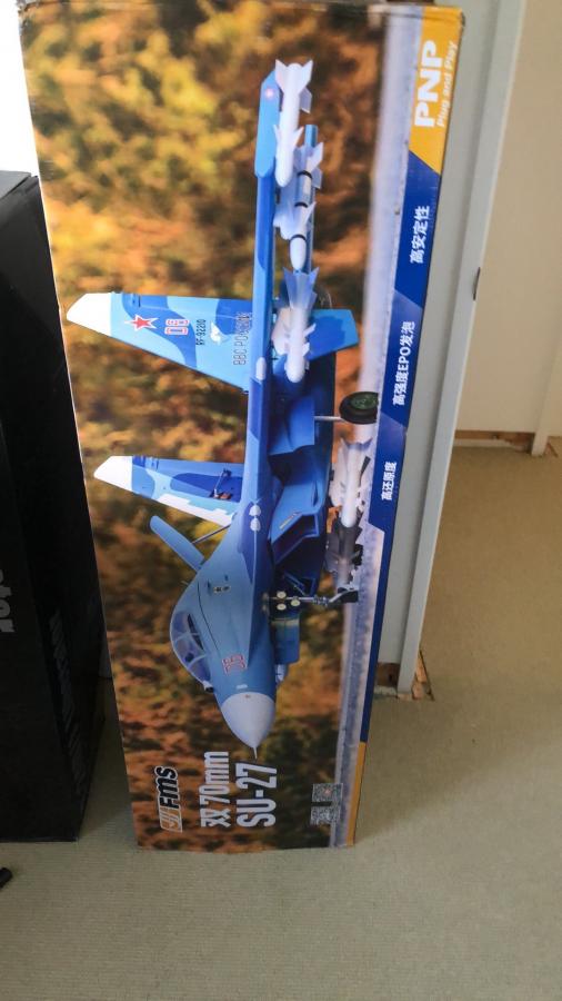

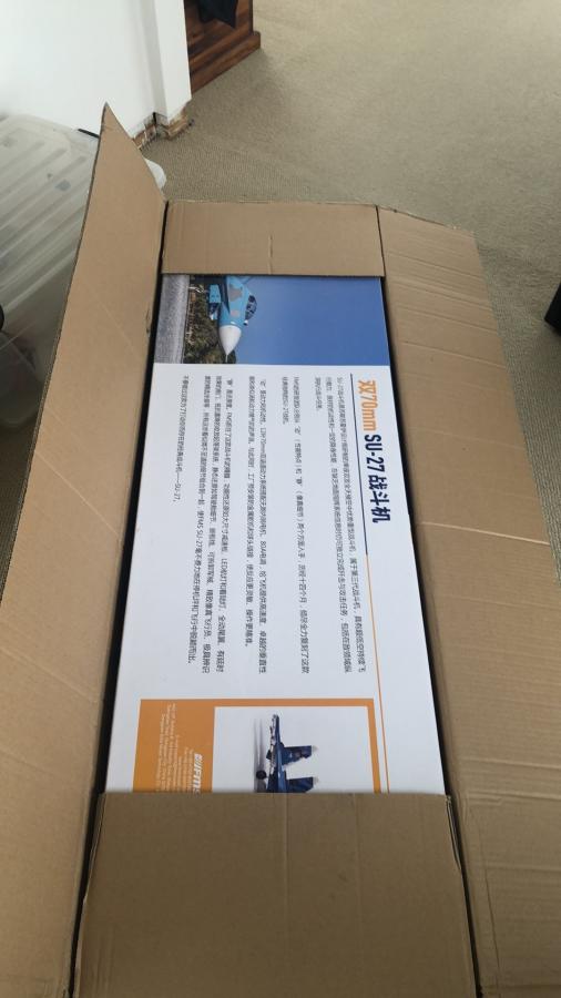

    Finally got one💪 Now i just need to get it together-might sit in storage with Rafale and a bunch of others until next summer though as i have too many aircraft so need to get my moneys worth out of a few then sell to make room! Lucky my wife is tolerant of my addiction i have a dozen still in boxes dotted around the house😂
