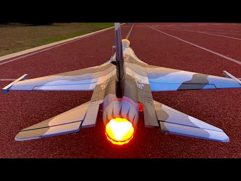

    While I don’t have a luminosity meter, the new ones are just as bright in a side by side comparison. Using the old large cones on my 70mm F-16 showed a degradation in performance.
    It is largely based on the diameter of the motor coming back to the afterburner cone. The bigger the motor diameter, the bigger the cone you can have without interfering with the airflow. The new 70 mm inrunner motors are quite narrow compared to the older and out runners. This necessitates a smaller board and cone to not interfere with the airflow aft of the motor. The newer light boards with the flicker are smaller to keep the cone narrow from the motor all the way aft. This way you have an realistic looking flicker from a custom board that has a very slight difference in ignition timing on a twin setup, all without affecting performance, which like the batteries, I’m huge on. Definitely looks more authentic than using LED turn signals in the jet! 👍🏼👍🏼

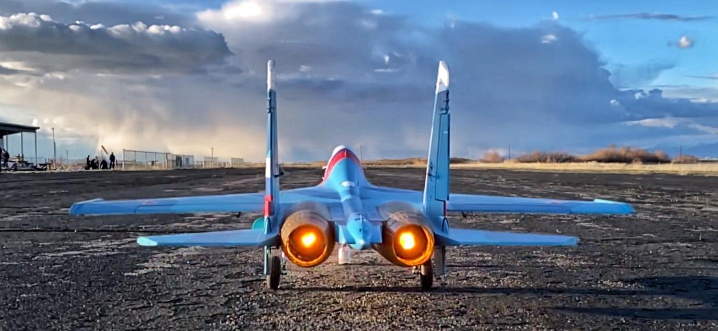

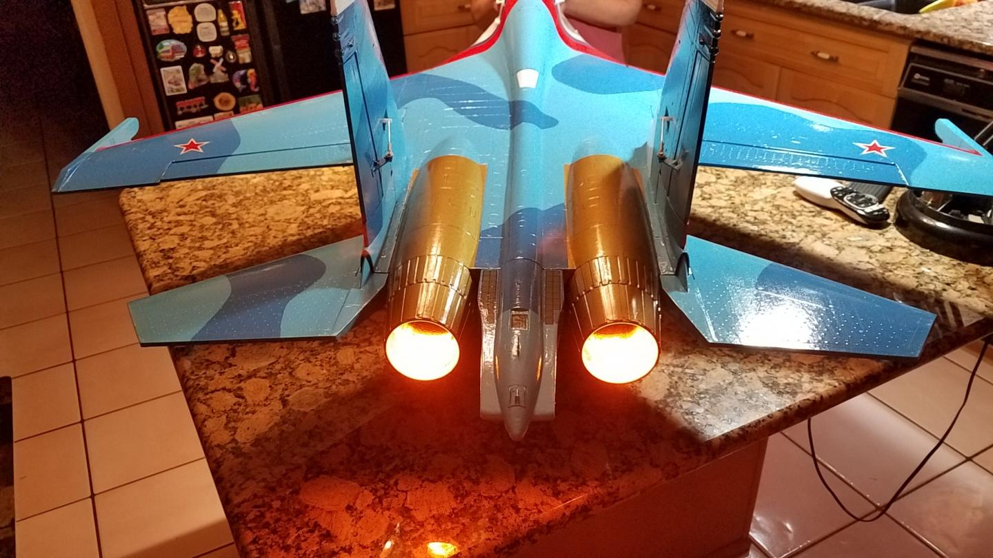

    Nice install video, I too installed Chris's AB in the SU-30 and absolutely love them. The inrunners are fairly close to the end of the nozzles (unlike some other jets) so the "fire" shows up great even in the Florida sun. Installing the AC aluminum tape is a must with this jet and unlike the F-4 or some others is fairly easy to accomplish using the method JLambCWU describes. I use some long 1/2" to 3/4" dowel rods (rounded at the end) to lay each piece in (with a piece of tape on the end holding the aluminum foil) then press into place and rub down securely.
    Chris usually includes M3 set screws to screw the AB onto the motor. I use the M3 set screws that are 4-6mm in length and they work perfectly without having to cut any screw head off. You can pick a set of those up from Amazon.
    I now have Chris's AB in all my jets (sadly only 7 of them), and wouldn't be without them, such an easy to install mod that really shows off. Chris just came out with an afterburner that has 2 cones sitting on one motor for the twin tail pipe F-4 and F-18. I just received 3 of them in the mail today and will replace the single LED cone with those on my 2 F-4's and F-18.

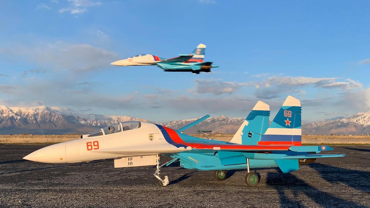

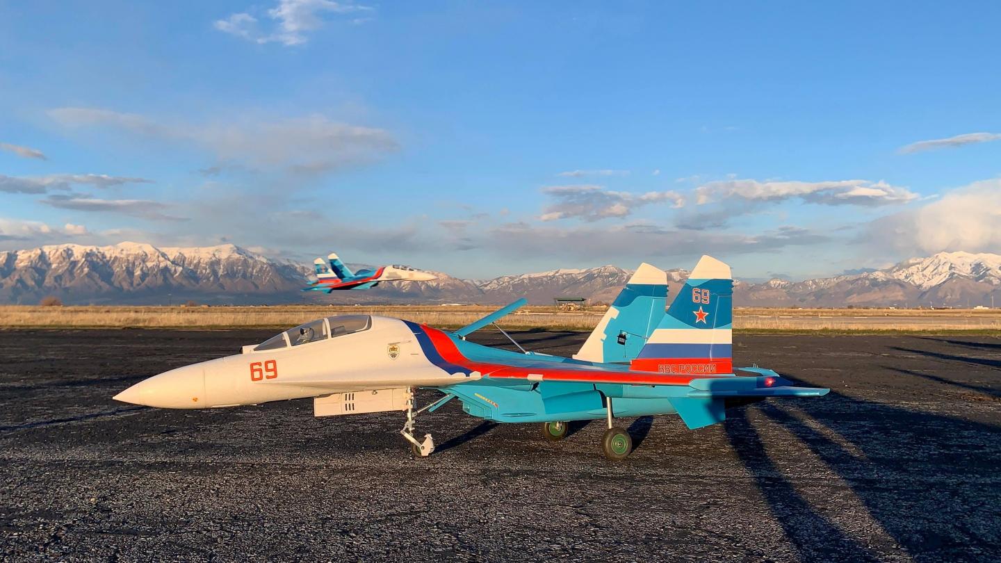

    Great night to get out and put a few flights down. Though I have to admit I was distracted by my friends throughout the hobby who don’t get to fly right now. I hope everyone that can’t fly is building, mod’ing, or researching how to. Looking forward to getting through this together and seeing what everyone is coming up with.
    Kind of a special night, 200 flights on this gorgeous bird now.

    Jeremy needed some low passes for pictures. Spring has definitely sprung in the mountains of Utah. The whole group was able to get together and fly during this craziness. Hope everyone else is getting some air time too!

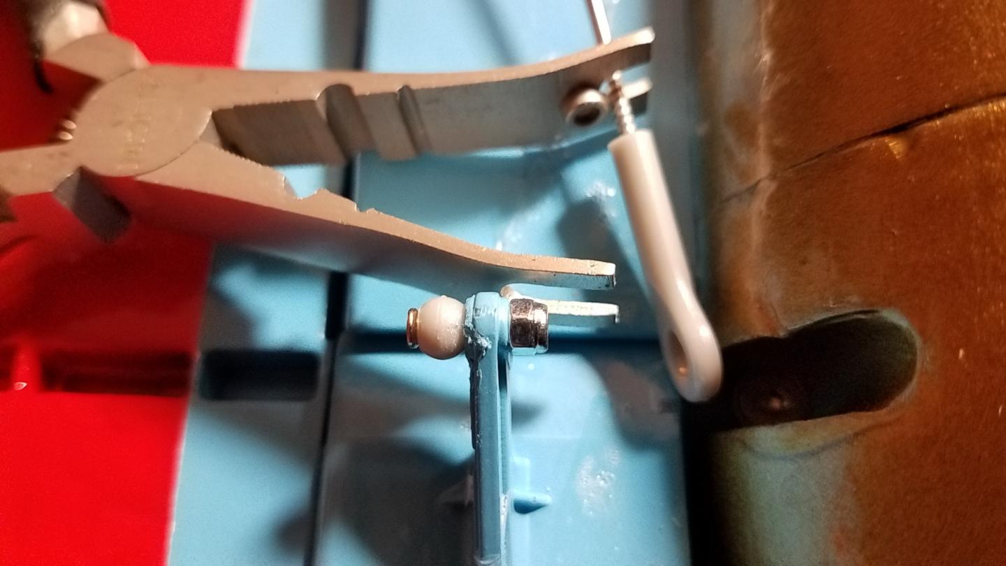

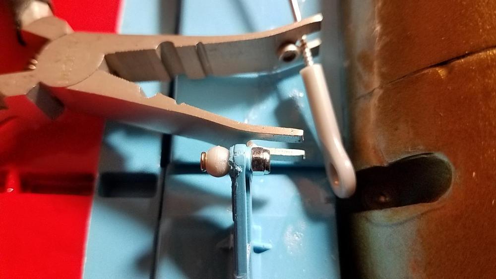

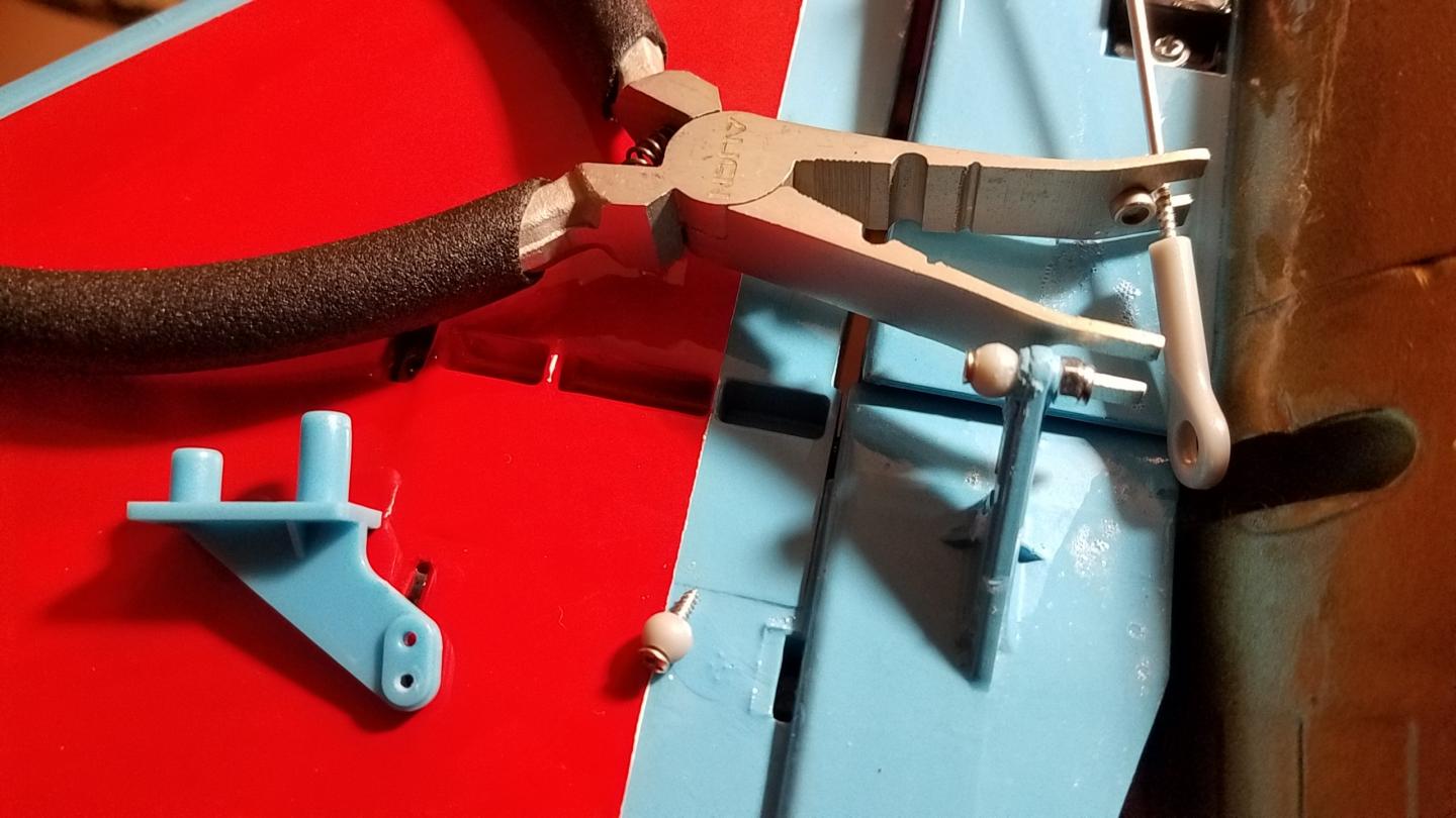

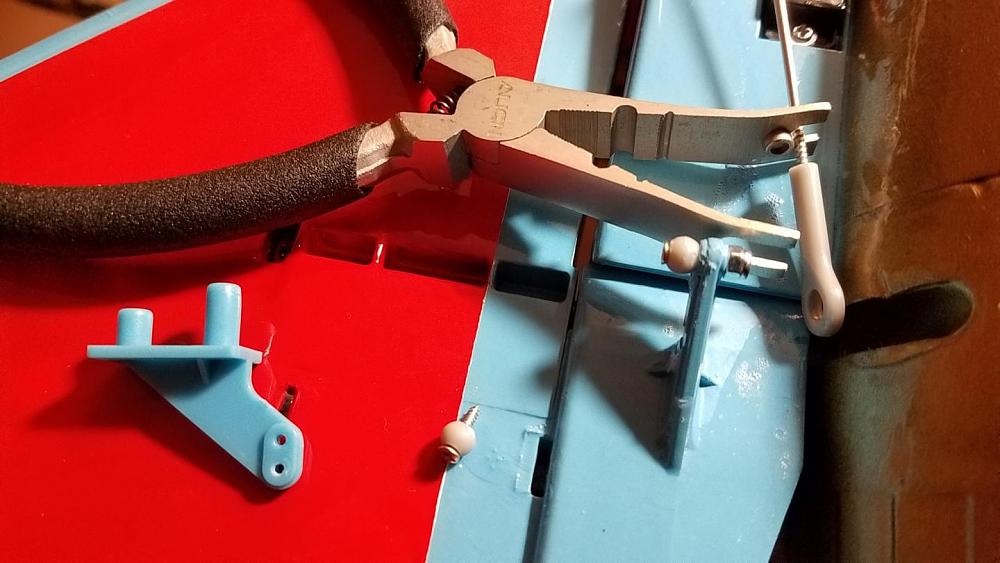

    On another note, I'm sure you're about ready for your SU-30 maiden, yes? I'm Interested to get your take on it. About the only mechanical thing I changed on mine was the way the balls were secured to the control horns. Mentioned earlier that I actually broke a horn with my "meat hook" fingers and felt that the little screw holding the ball in was a weak point. I'm probably just paranoid, but it looked like it could strip easily and pop out. So I changed it to the FL metal balls and bolts (see photos). Changed all surfaces to that, but the only concern I really had was on the elevator, as I could just imagine that little screw coming out and loosing one of the stabilizers-doubt the jet would make it home in one piece after that. No one else has complained about it, so most likely I'm just making a mountain out of a mole hill.
