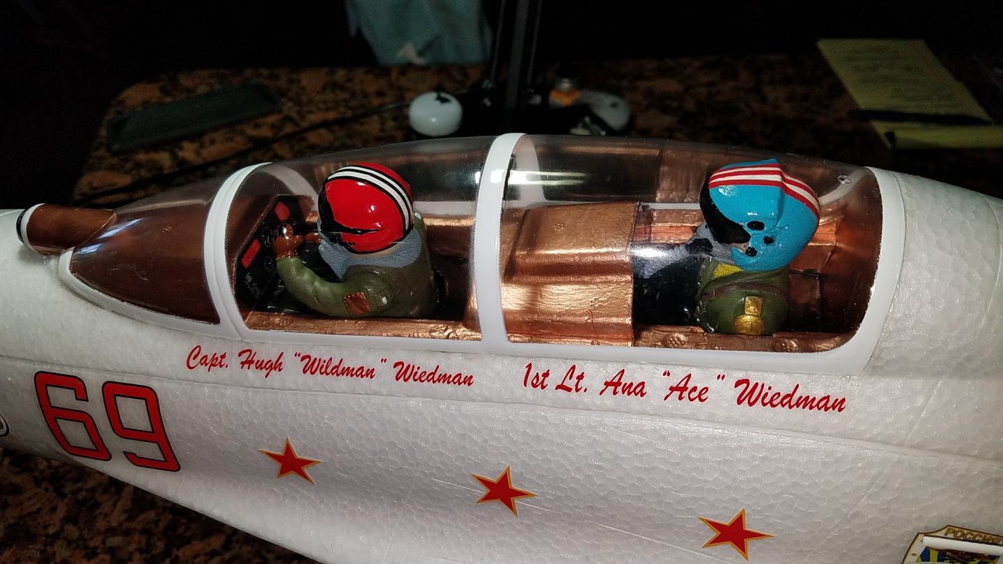

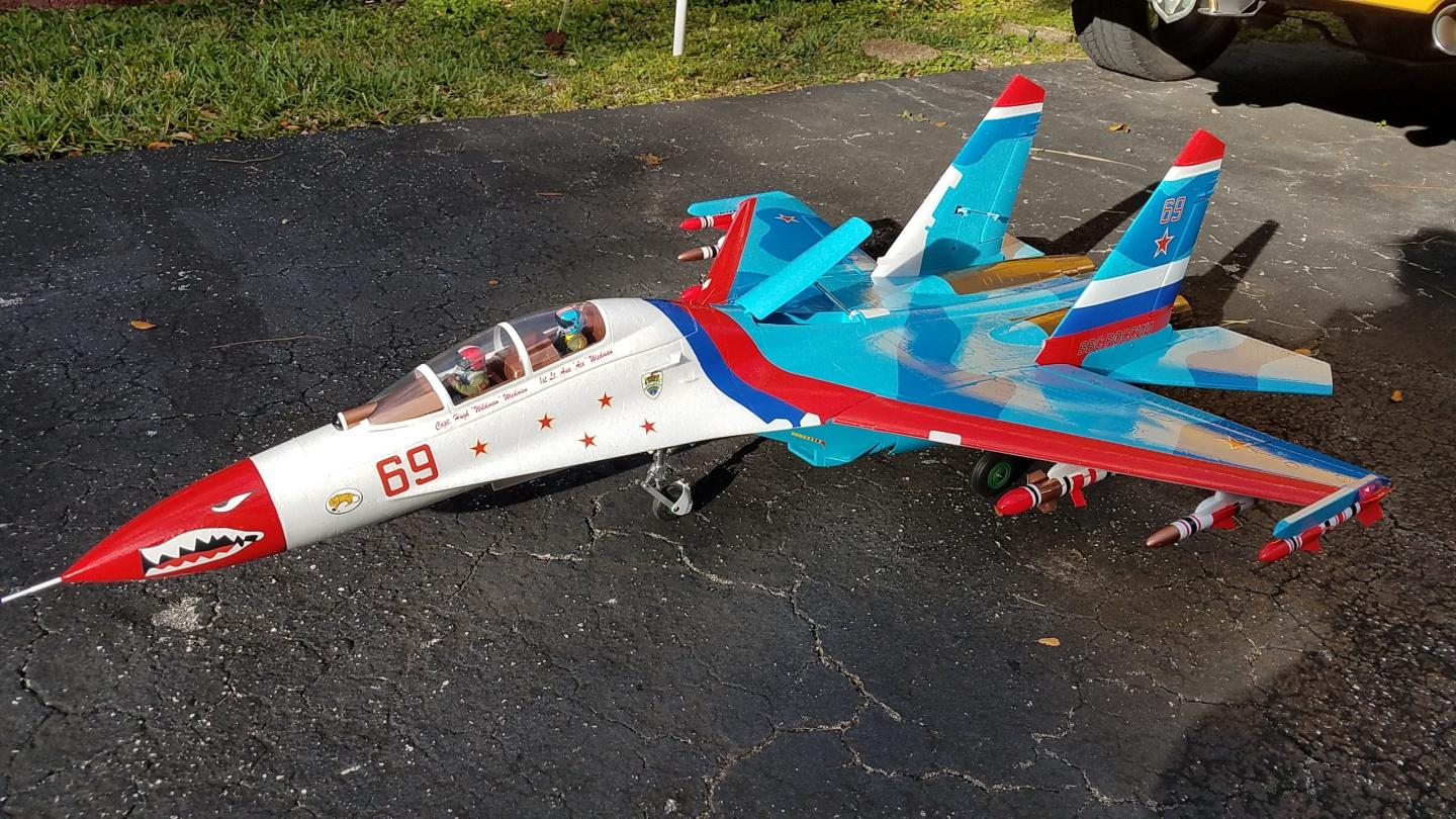

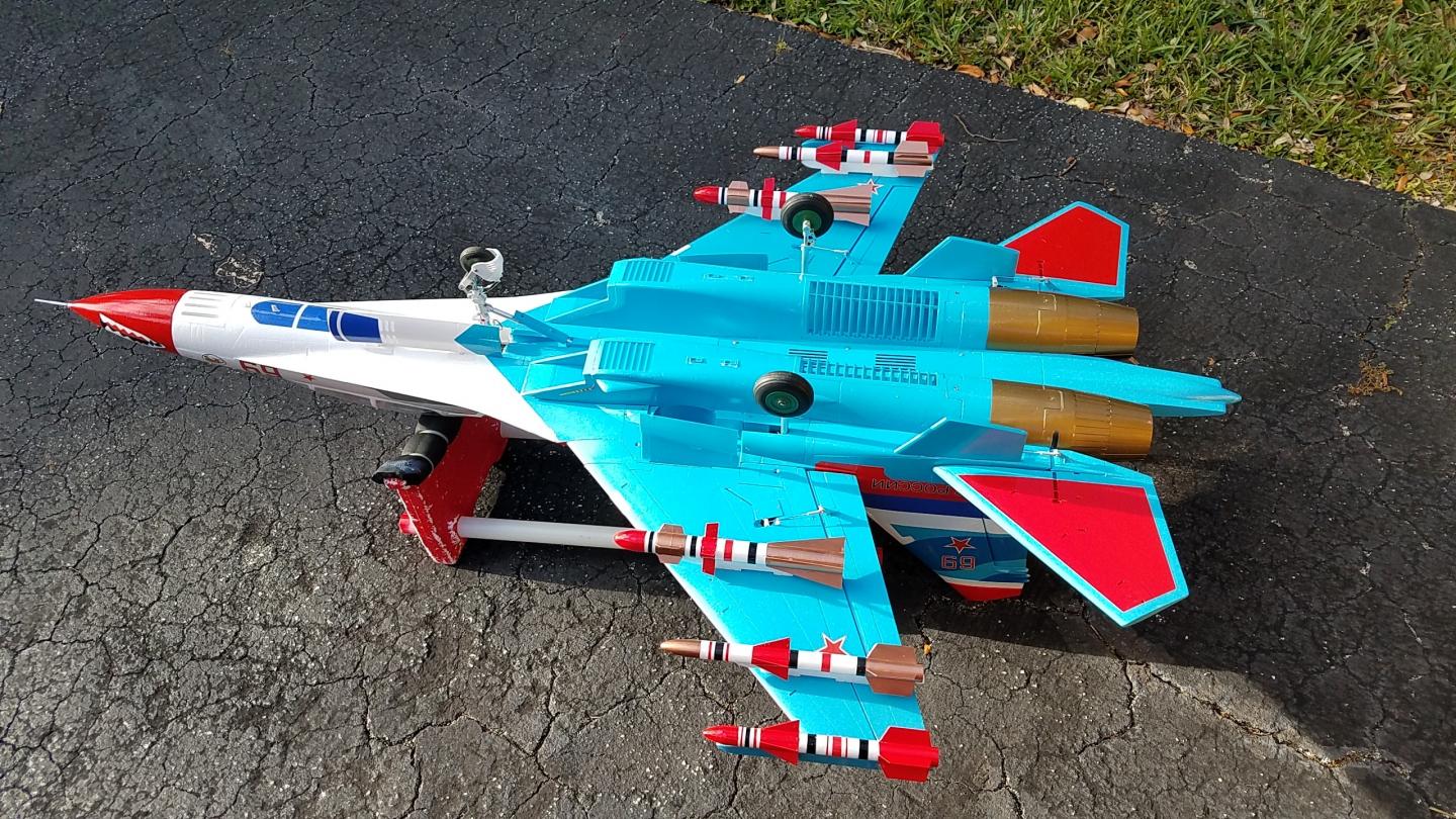

    Finally got the SU-30 finished and ready to fly. :hugging: Unfortunately, just in time for the weather to go to hell, high winds (20-25mph) predicted for the foreseeable future, and mostly cross winds. :triumph: At least I'll have some time to work on the F-18. Did only a few things to it, the idea was minor mods and get it out flying. I did do the following:
    1) Set it up with flaperons and a 7th channel so the speed brake is on it's own, independent switch. Also trimmed the nose gears wheel pants a bit as I fly off grass, hope this keeps it from catching on it.

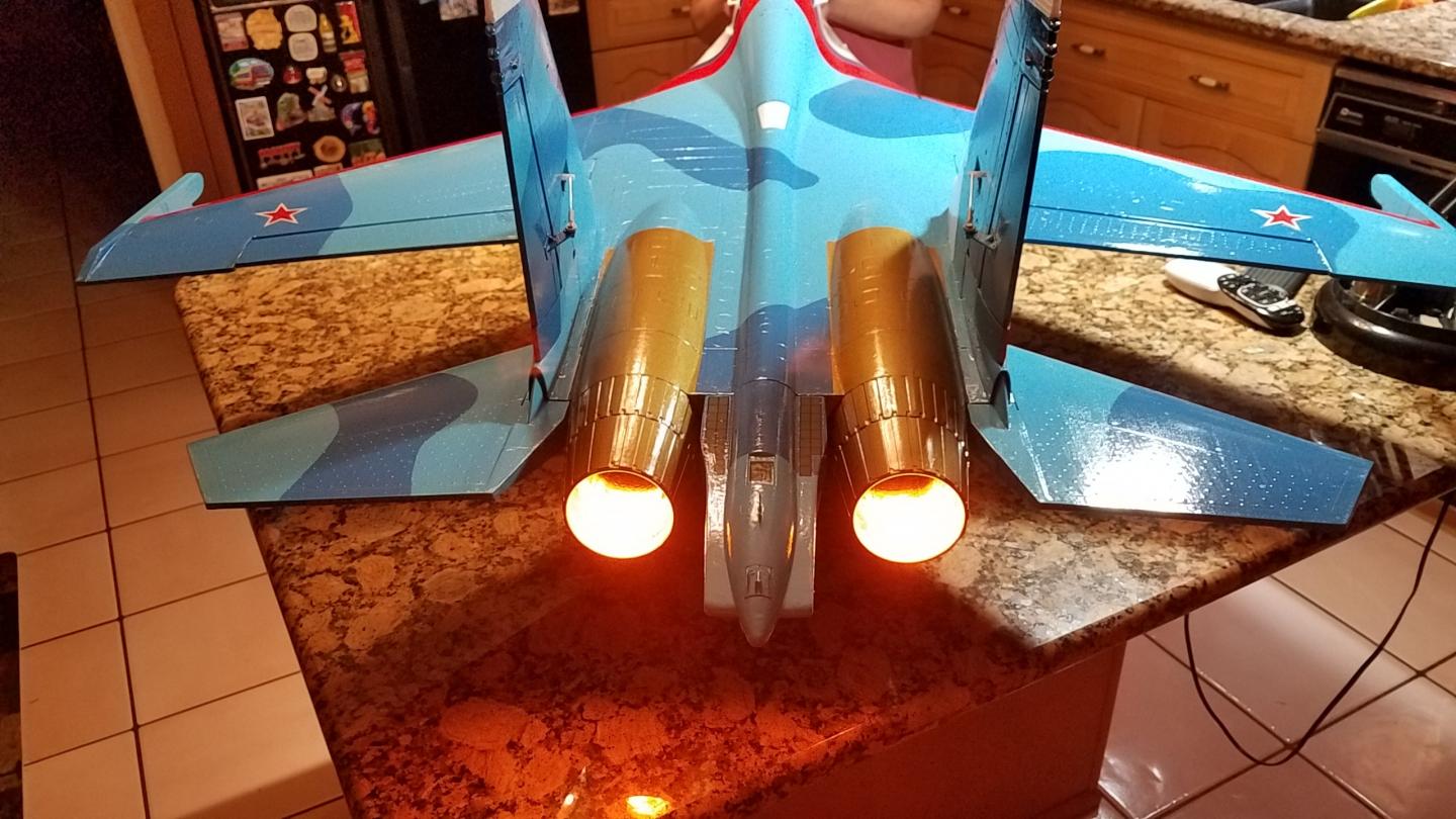

    2) Added the twin LED afterburners and coated the exhaust tubes in aluminum foil tape. Since the EDF is closer to the nozzles than say my F-4's and F-16, it seems to show up even better.
    3) Coated it with 4 coats of gloss spar urethane, mostly for protection of the paint as I said earlier this paint's adhesion is awful, but it sure shines nicely with the gloss!
    4) Did some very minor things to the cockpit and added a second pilot (c'mon E-flight, how could you leave it with only one pilot). :face_with_symbols_o
    5) Added some red paint to the underside of the horizontal stabs, mostly cause I have major difficulty with my orientation, especially with fast moving jets. Tried for the first time Aros's suggestion of using Tamiya trim tape. It was a little hard to find, but I got several roles of 2mm, 3mm & 5mm and man, this stuff works great. Been using Testors trim tape for years, but I think they discontinued it. Even so, the Tamiya seems better for delicate surfaces and since I gloss coated it first, the edges came out sharp with no lifting (primarily I think because of the urethane coating).
    6) Gave the missiles a little paint as well, need to see them if I'm going to put them on and fly with the extra drag.
    7) Did a couple different nose cones. They were a real pain starting out with unpainted foam, it was prime, sand, prime, sand, etc. until I had a smooth enough surface that it didn't look like the moon.
    This jet is slightly larger (30" wide at the horizontal stabs and 60" long without the nose) than any other jet I have, so I had to rearrange my hangar to get it to fit-where there's a will, there's a way! Can't wait for the winds to die down and try this thing out. Hmm, hope it fits in the truck.

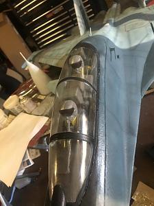

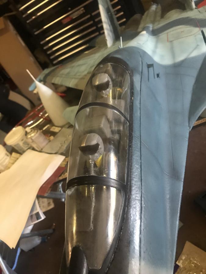

    Originally posted by dusmmdb
ID:	237670Click image for larger version
ID:	237671Click image for larger version
ID:	237672 I threw a second pilot, seats and a HUD into mine to make the cockpit not look so... plain
    now I have to clean paint up and do touch ups but I think this will do for now

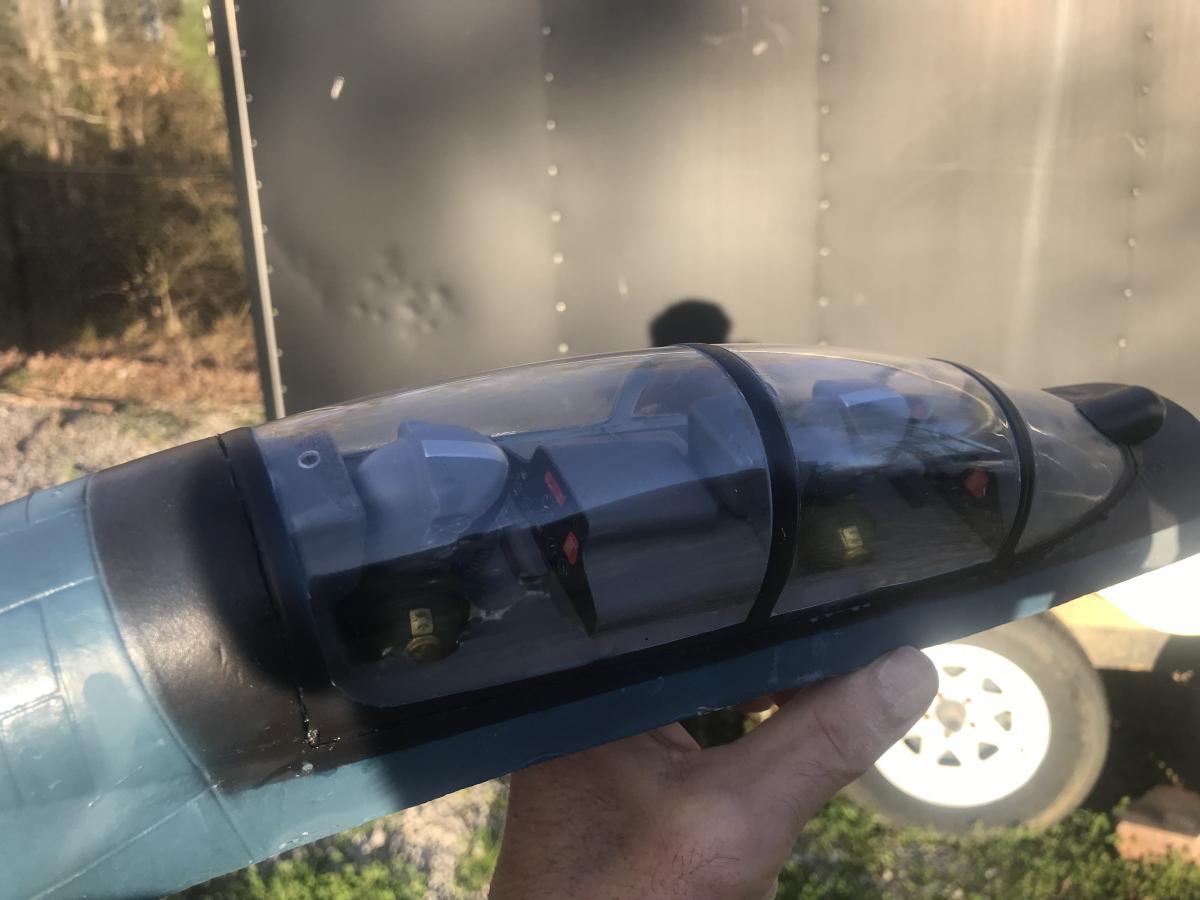

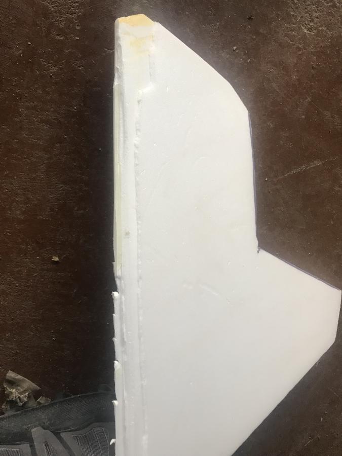

    It is molded into the frame which prevents some difficulty in moving.
    i used foam. I had some layered foam from an old kit (don’t remember the name) that I simply used the wings (see pic). The foam is stiff enough to stay rigid. I then used a small piece underneath to keep the canards from flexing.
    mistake I made was not removing the canopy before starting. Trying to remove it now has presented further difficulties. I’m not sure what they used to glue it on but it doesn’t want to separate from the foam as easy as a free wing planes does. I may simply insert a second pilot from underneath for now
    mike
