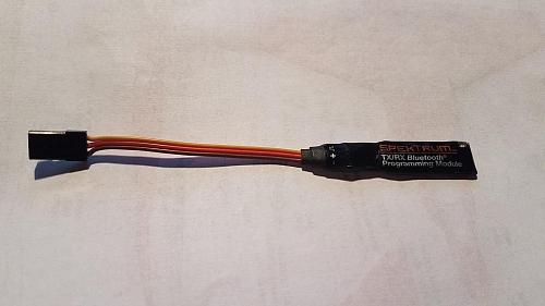

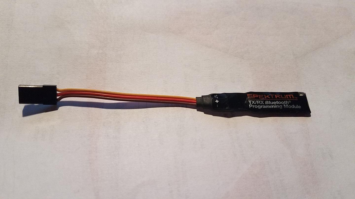

    Actually doing it through a Bluetooth programming module Spektrum used to use that plugs into the receiver and they is picked up by their phone app (either an Apple app or Android). I just now noticed that HH not only discontinued the AR636, but also the BT programming module. I used to use the audio interface cable years ago, but they upgraded it to a bluetooth module (and I think the latest, at that time, phone app to use the BT module). I'm not even sure if the audio cable still works with the AR636 and the latest phone app. Man, don't you hate that? It seems the AR636 has now been replaced by the AR637T which apparently you can program through the latest Spektrum transmitter (how I have no idea), possibly eliminating programming cables and funky phone apps that work intermittently at best. And of course they also increased the price by $20, thank you very much. Click image for larger version

    Just when you get "comfortable" with using something, they have to change it. I have over 25 AR 636's in planes and now all that years of "learning" goes out the window, damn. :triumph:

    There are two options:
    1. Wired interface that connects the RX to your smartphone headphone jack. Won't work if you don't have a headphone jack. This one may be discontinued.
    2. Bluetooth interface. It connects to the RX and goes to your smartphone via BT.
    In both cases, you just download the smartphone APP. The wired one is garbage and sometimes won't connect. The BT one is the one to get. They're about 20 bucks.
    OK thanks, will see if I can find a BT type somewhere.
