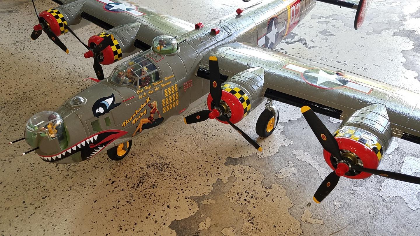

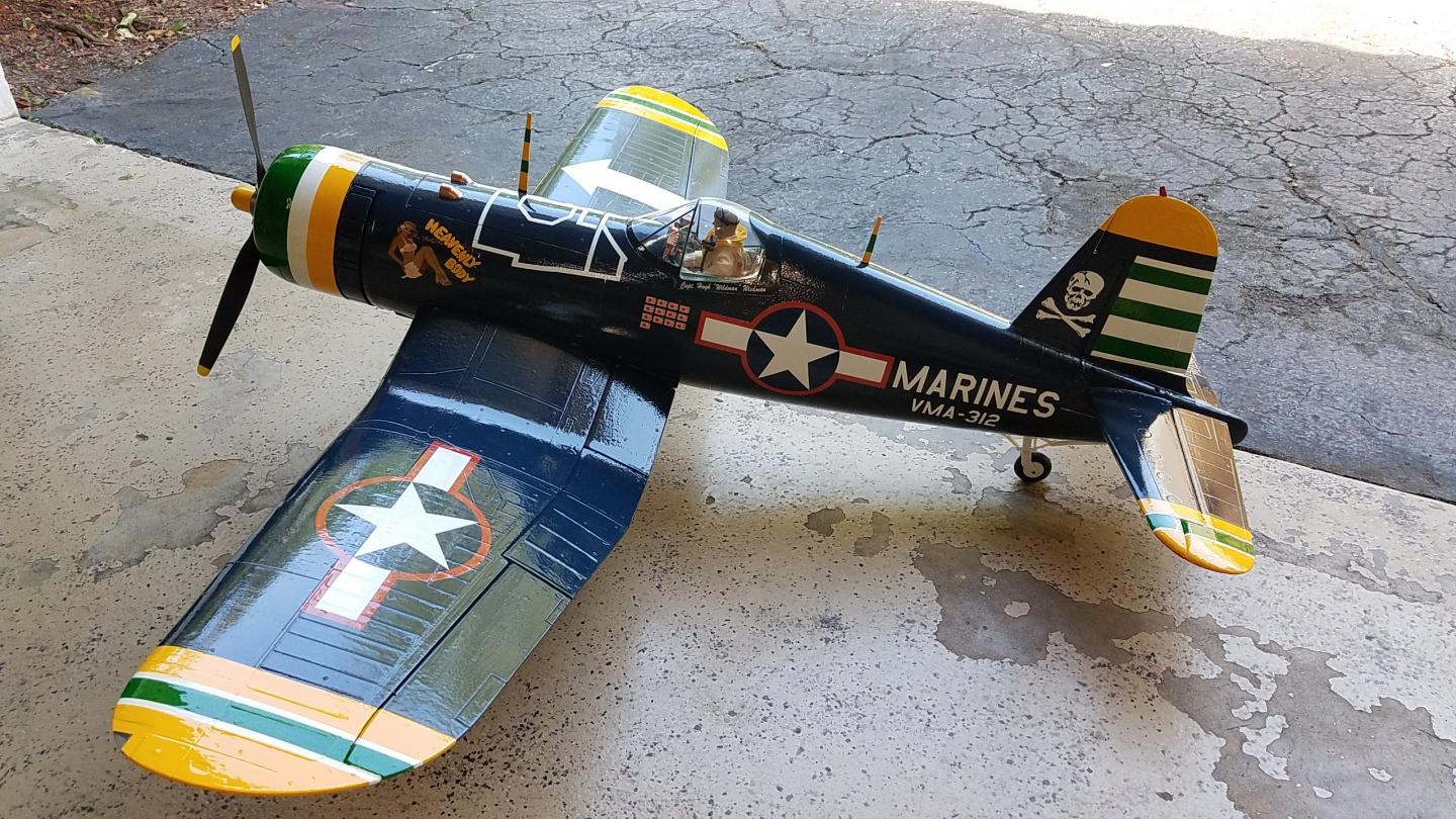

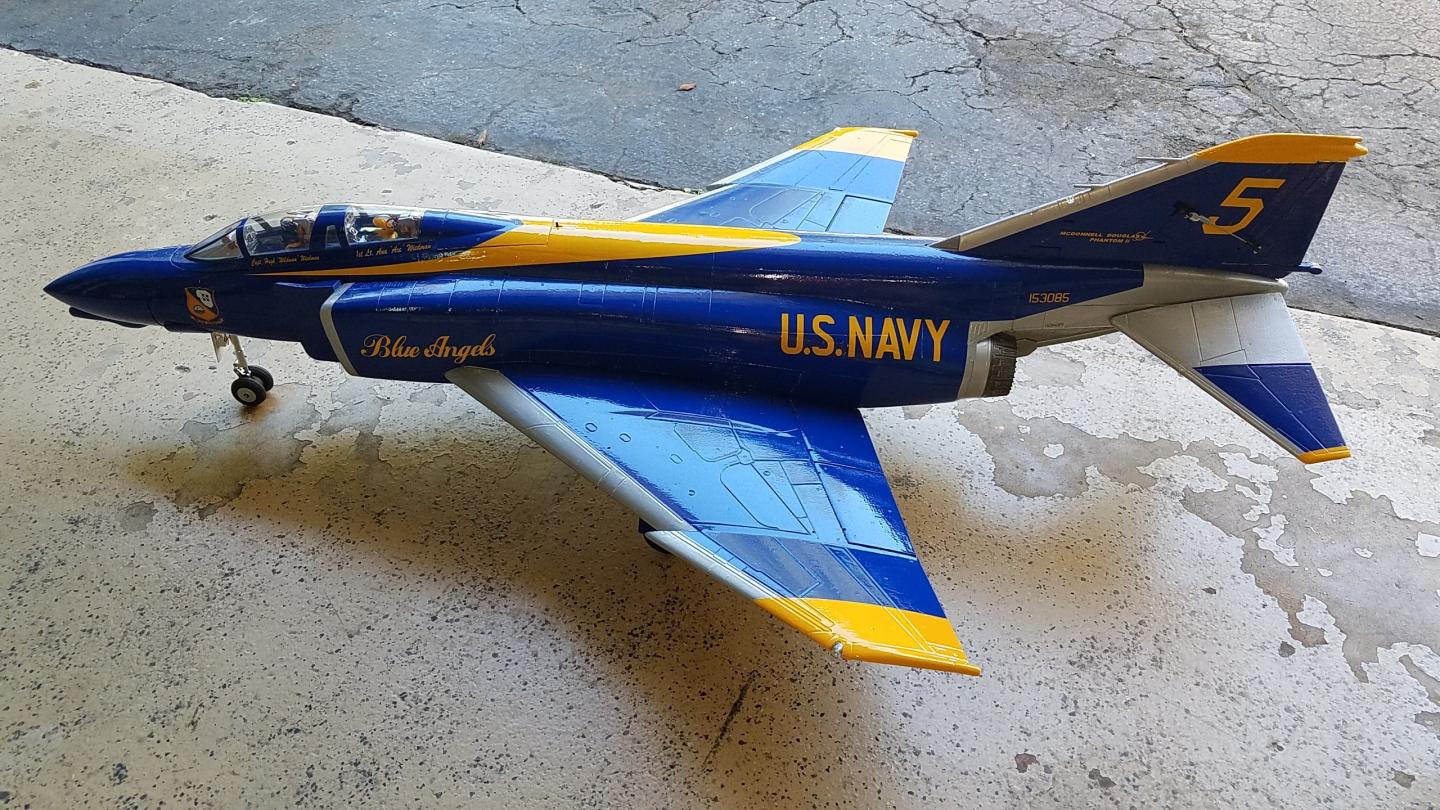

    I use the water based clear gloss Spar Urethane exterior, hand paint it on. Sometimes up to 4 coats. It comes in all types of finish from flat/matte/semi-gloss/gloss and I suppose I should use the flat or matte for more scale like appearance (the gloss shows imperfections like foam gatoring more) but I do like the shiny gloss, glistens on a sunny day in the air (definitely not scale). The best part about it is that the foam is much more durable with the coating and holds graphics or additional paints so much better. Used to have to touch up even slightly all my planes/jets after flying because it seemed the paint would flake off at certain high stress areas, but no more. I do it to all my foam planes now. Additionally, I found that if you are doing a re-paint, if you coat the stock model with 1 or 2 coats first, you can easily mask any area without pulling up the stock paint. I did the F-18 Canadian that way and it was so much easier to finish (especially having to use home depot spray paint), 2 coats on the base grey, then could put trim tape and tape larger areas to get the 4 color separations.
    Min-wax also makes a similar product and maybe others do as well (somewhere in the forum is a thread discussing the different types people use, some use spray as well) but they all work the same. I used this kind because I could get it from Amazon and have it delivered (Yes, I'm super lazy) and it's supposed to be avialable at Loews, but I've never found the exact one I needed. I like to use the water based, but just make sure it is the exterior type as the sun will yellow the plain interior type. Also make sure if you do it to mask servos control surface hinges, remove control rods and keep it away from any moving parts.
    I hate showing pictures of my planes :lying_face: , but here's a few shots showing the final look of the F-4's better and a few prop planes after coating. If you do coat your planes, a word of caution. As you know, prolonged exposure to intense and direct sunlight and heat will actually hasten the gatoring of some foam (like you sometimes see in cockpits after a while from the suns magnification from the canopy and trapping in heat). These clear coats do that as well, but not from normal exposure. The last photo of my Olive B-24 shows more gatoring than it had at first, but that was from having to leave it on the runway for spectators to get a close look at all entrants last year at a warbirds festival where it was done at high noon in 98 degree weather with no clouds. It sat there for 3 hours because of judging for various awards. My B-24 won best WWII warbird, but ended up with a bit more gatoring than I'd like.
    BTW, the photo above of the F-16 was before coating it, it looks outstanding IMO now and the F-18 Canadian and SU-30 above came out real nice also:
