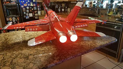

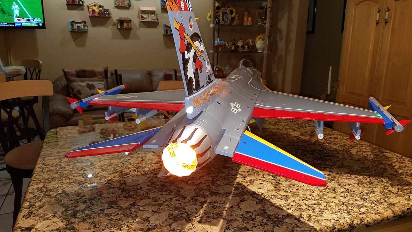

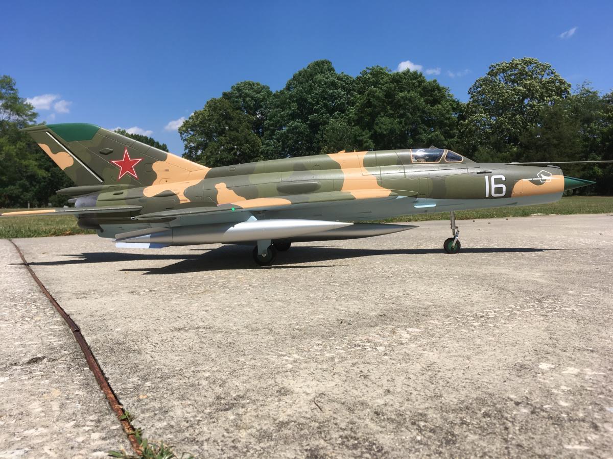

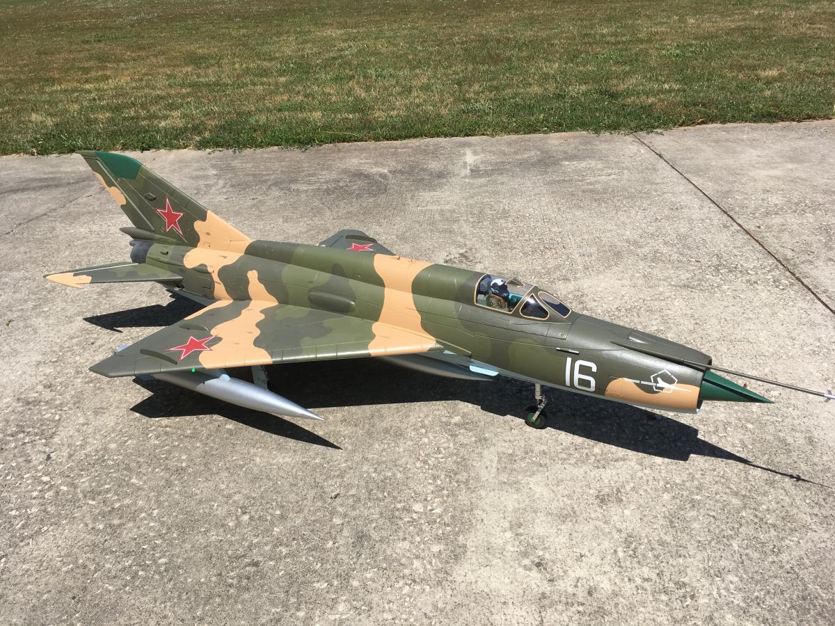

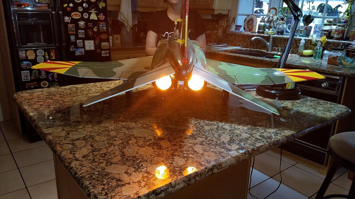

    jetdoc I also switched out the 636 for a 7350 AS3X (for flaperons and the air brake) and used essentially the same gains, but without the SAFE and any heading hold they put in the original (I hate heading hold, can't really trim properly with it). I do have a higher priority though at 140% and it still flies on rails. I have the AS3X in every one of my planes/jets (I'll take all the help I can get), even my 60" Extreme Flight 3D planes. I also put the afterburners in every jet I have, even the Avanti and Stinger 90 (what, they are not supposed to have those?), and a sound system in every prop warbird, as any little visual or acoustic upgrade is a nice touch. I even added an AB in my 90 mm F-16 even though it already has a ring burner (the more the merrier). The afterburners actually help me with orientation when taking off in the morning/early afternoon into sunlight for our field's layout and predominant wind direction out of the east. The new twin burners for the single fan F-4 and F-18 really look much better as well. I'm planning on getting an A-10 one of these days and doing the Arctic number on it and most likely will also add AB's for it, definitely will be the only A-10 with those!

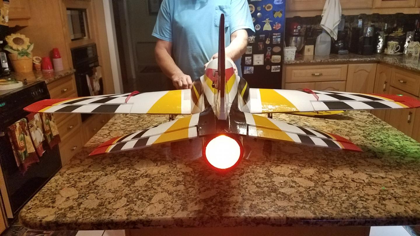

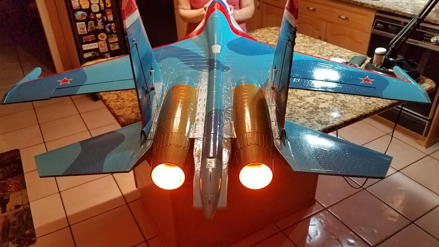

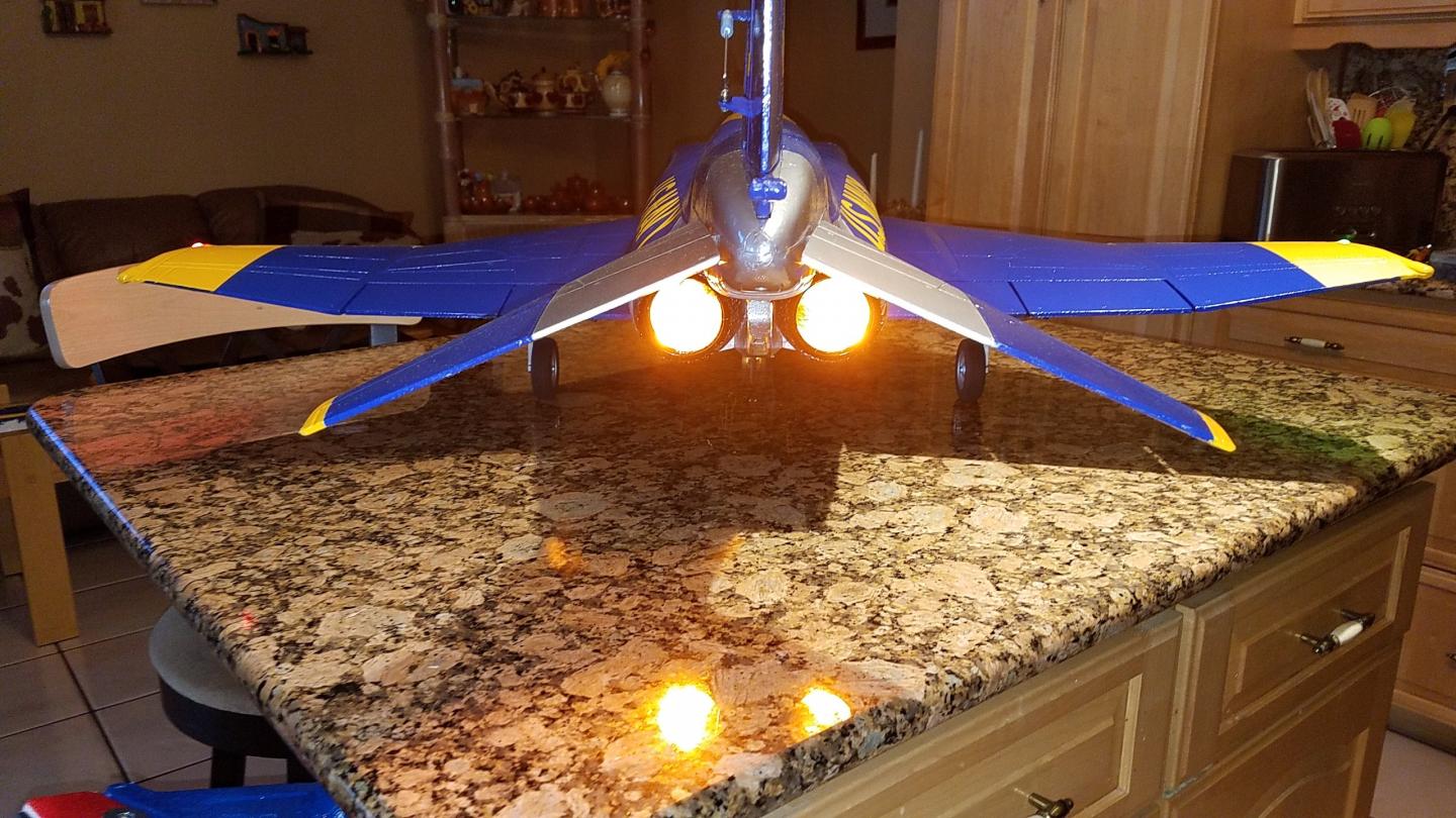

    Afterburner City:
ID:	261506Click image for larger version
ID:	261507Click image for larger version
ID:	261508Click image for larger version
ID:	261509Click image for larger version
ID:	261510Click image for larger version
    Very Cool!, do you clear paint your planes or is that just the camera?
