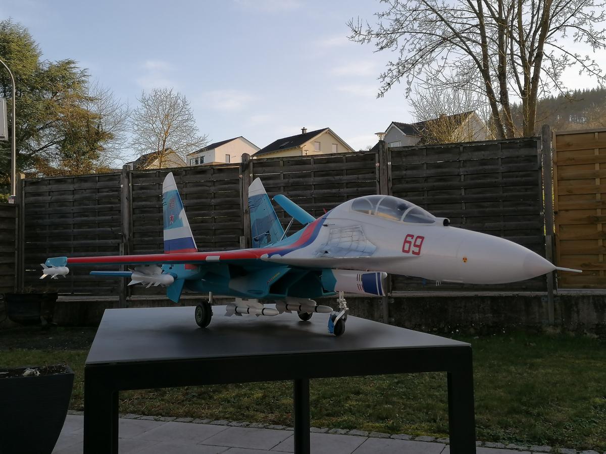

    Hi I have also the su30. I made a turbine conversation with a lambert Kolibri t30. The plane is soo amazing with this combo. The complete su has a semi scale Weathering, Afterburner simulation and the gun isolation replicate with flite metal. Greets chris
    Sehr gut!
  • Chrisi f-18

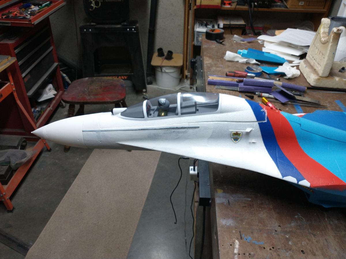

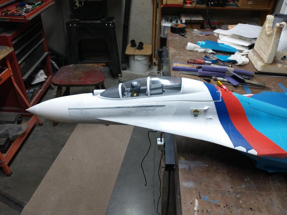

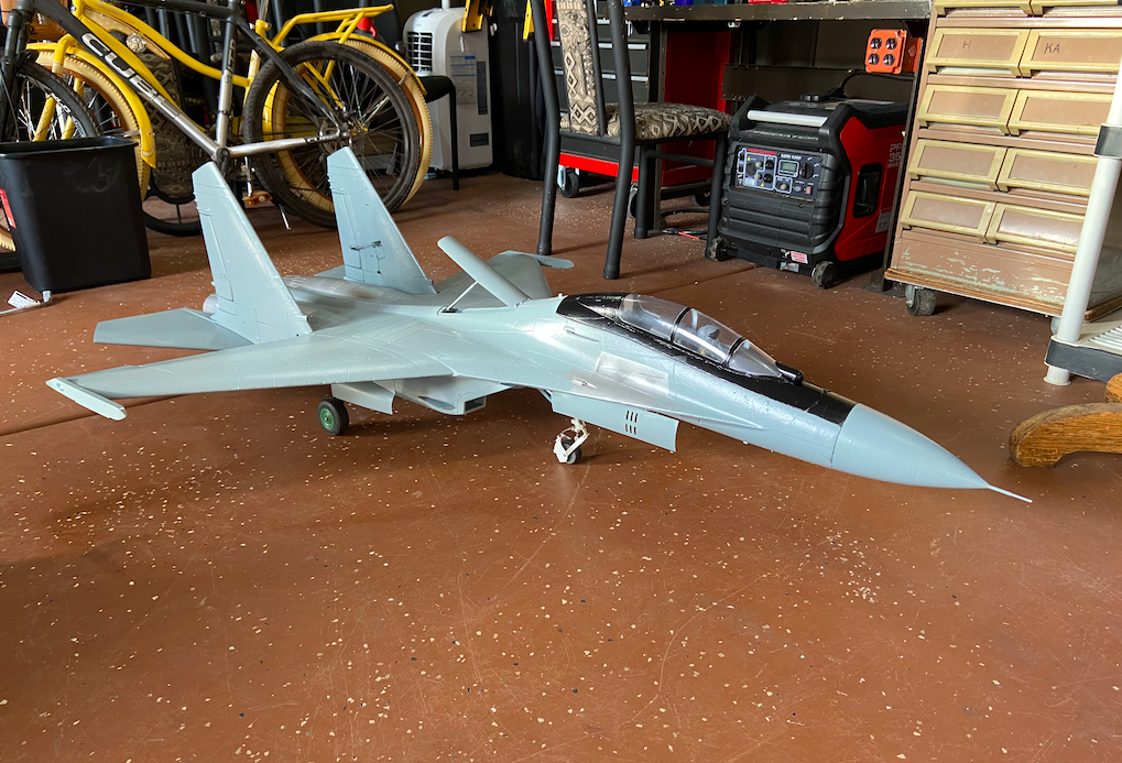

    The repairs are coming along. I used strips of CF on the outside of the fuse to hold the broken parts together while being glued. I had some areas with no foam and I used some expanding spray foam to fill in the holes. My bigger issue is trying to find a replacement for the wing spar. HH doesn't have one in stock. They may have them in April. I measured the original and it is 9.65mm (.380) which isn't a standard size. I can find 10mm or .375". Will try one of those and see if it works.

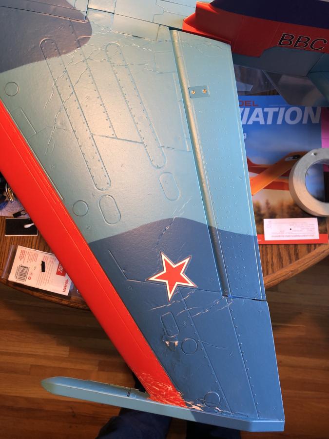

  • Wild Man

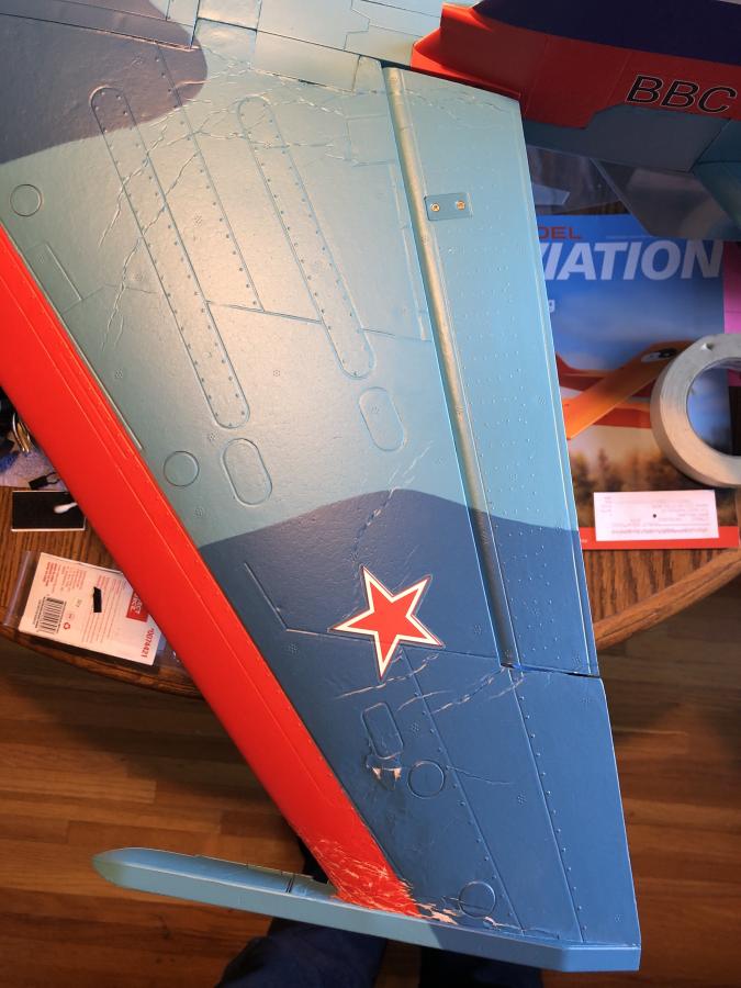

    I have flown mine many times. I have done more damage to it moving it in and out of the house and or garage last thing I did to it was set it on a table out side between the house and garage, it fell off the table and before I could catch it it wriggled the left wing when it hit the floor Ouch.
    radfordc As long as you're rebuilding/repairing, a couple things to consider.
    1) I put some reinforcement behind the nose gear brace rod (or whatever it's called). In the Stock setup, it goes into a piece of plastic that's glued into foam between the air intakes, no real bracing. After about 50 flights noticed mine was pancaking the foam and causing the rod to be loose. 90 degreed some carbon tubing and other pieces to take and spread the load of my "bull in a china shop" landings.
    2) Carbon fiber tubes in the fuselage end just behind the battery bay, real clever engineering. Again happening after some 60 flights the fuselage started developing stress cracks just behind the battery where the nose wheel folds in. But being stupid, I disregarded the stress cracks and in an effort to get more flight time, I tried my Hobbystar 8000 mah that flies outstanding in my F16 and gives me over 5 minutes of flight time. Well, it barely got off the grass, had almost 0 vertical and required almost 80 to 90 % throttle to keep it up, resulting in almost no additional flight time. Upon landing, even with the nose up, when the front wheel came down, the entire front section with the battery dropped off.
    I now only fly it on a 5000, at least it performs better than on a 6000 and I still get about the same flight time. Maybe it's just me or my flying, so just some food for thought.
