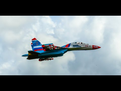

    I finally maidened mine a couple of weeks ago after looking at it on the rack for the last 15 months. I don't know why i waited so long to fly it - what a fun bird... got 3 flights on it with 0 damage... :)
    2:25 to 2:45 on the video
    I kept doing a retake of that over and over, thinking that is insane, with a full load of missiles no less.

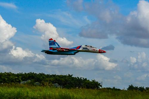

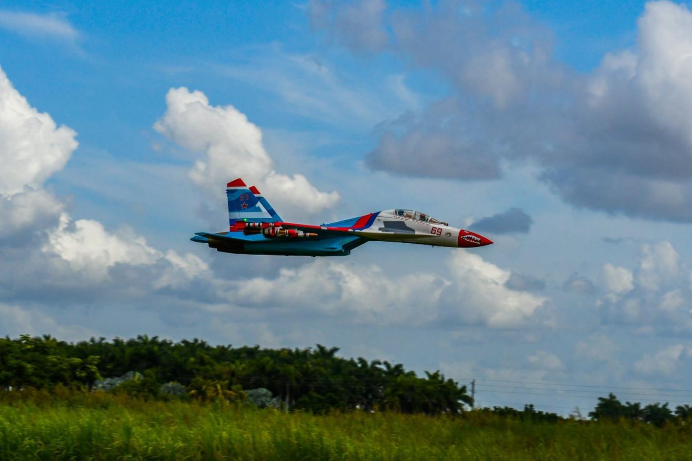

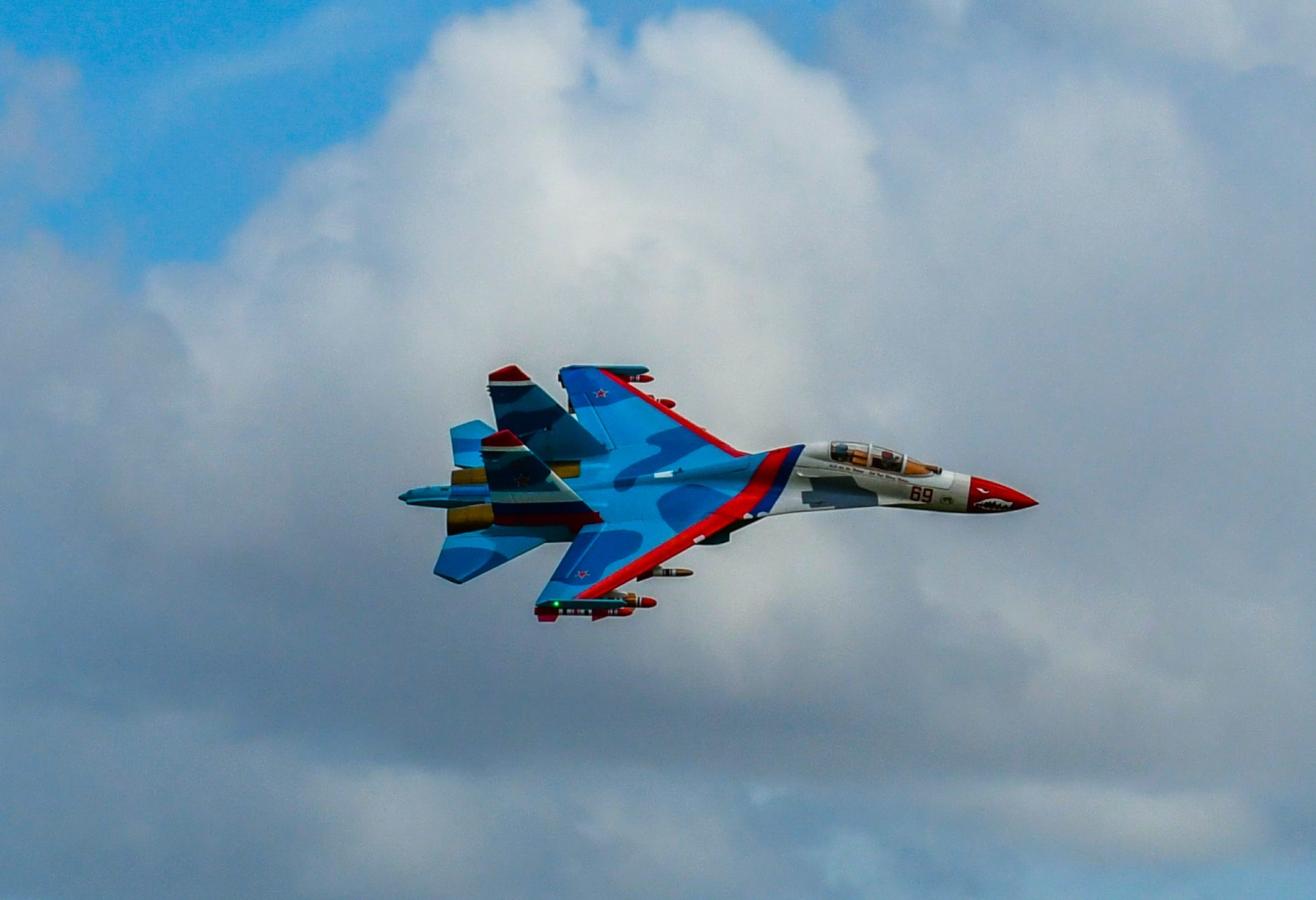

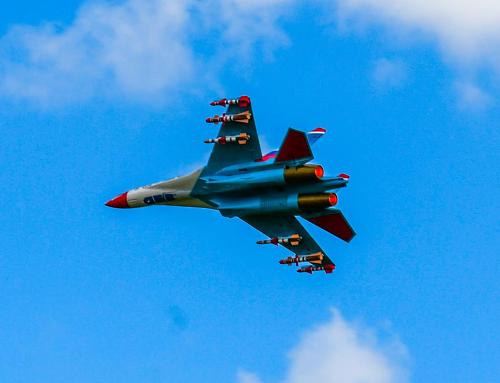

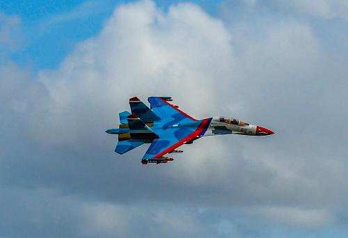

    Finally put the video together on the maiden flight with the dual batteries. After 2 years of fighting with this thing, it's finally worth flying. The FMS fans are a must, but equally important is converting to dual batteries. I'm able to fit either 2 SMC 5300's (each at 684gr) or 2 SMC 4500's (each 588gr). The only difference I found, other than longer flight times, was that with the 5300's it was a bit "heavy" when landing. Oddly enough, take-off distance and vertical was nearly identical. So obviously I need to do some more testing (at least that's the excuse I've given my CO)!

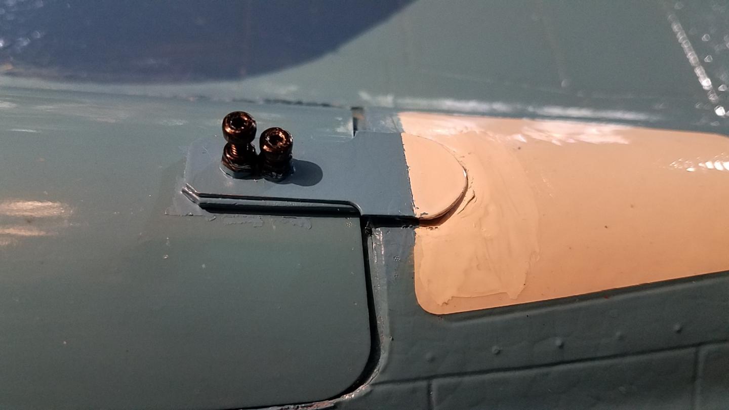

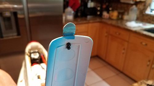

    Finally got around to finishing the double battery mod and put some rare earth magnets and an X-Acto blade with the sharp end ground down as the hatch closer. I was also able to balance it at 150mm using either 2 SMC 4500's or 2 SMC 5300's, so we'll see which combo works best. :hugging: Hopefully the weather will improve and I can give it a shot sometime next week.
    But no matter what, I'm done modifying this thing. :triumph: So far changed to the FMS fans, swapped out 2 RC Geek burners to use his latest slimmer ones, reinforced the nose gear and the base of the nose gear strut with carbon fiber square tubes, changed the nose wheel to a Hangar Nine 2 1/2" Pro-Lite wheel to help on grass and imbedded carbon tubes on each side of the fuse in the front battery bay because for some reason, they terminated over the nose wheel and I was getting some initial cracks at the beginning of the battery bay. For now I'll fly it as I did before with flaperons, but put each elevator servo on a separate channel to ultimately go to tailerons. That's going to require some funky mixing to keep the AR8360T gyro working correctly so I'll deal with that at a later date.
