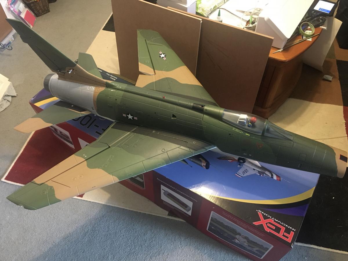

The F-100 has arrived. Overall, very impressed. A great looking model. Have had a burning desire for a good F-100 for years and this fills the need!
I have it assembled and have tested the power system and the sequenced retracts. All in good shape. Have not yet hooked the RX up to the Aura and will be doing that tonight. The fan sounded and felt balanced and sweet.
Paint and foam is very good, right up there with FW and FMS. Better than my Flex Cypher VTOL.
All basic decals are applied. With the SEA scheme, you get the choice of four different aircraft markings and you do the tail and nose and other special markings yourself.
Oversize panel lines, but that is unfortunately common in scale foam aircraft. These seem a little larger than FW applies.
Decals were done fairly well, with only 4-5 small ones applied crooked out of dozens.
Quality linkages and hardware.
Assembly is as easy as we expect these days. The only glue joints are the wing fences.
As we get to the small issues, it is worth remembering that every aircraft is a large cloud of compromises flying in close formation...:)
Very minor nit pics:
-The ESC was not connected to the motor. Not a real problem for me, as I usually disconnect the bullets and tape the connections.
-The rudder hinges had an offset that put the hinge line area of the rudder on the left side about 1/8" out from the side of fin. Was able to massage the hinges in the foam enough to make the rudder line up.
-There were a number of small glue smears under the paint, a few more than any of my FW jets.

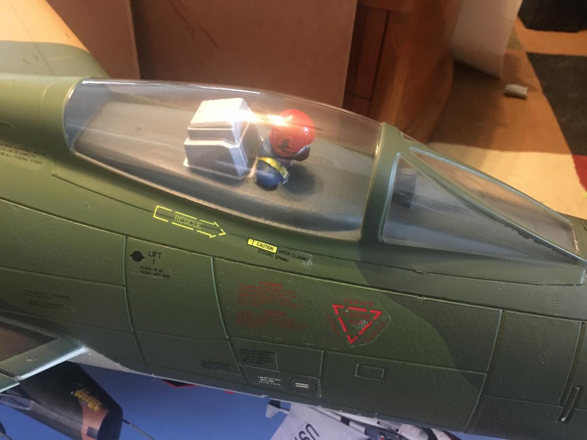

-The cockpit "floor" is raised above the canopy glass line. They were leaving some battery space at the rear area of the hatch, but the tub could deeper in front of the seat. To be fair, the cockpit floor to hatch bottom area is only about 1.125" thick. so some of this was due to structural strength issues Could be modded with some thin ply.
-They put a midget in the cockpit. He needs to be about 50% larger, with a shorter upper torso.
Hope to maiden tomorrow.
The pic shows the model assembled except for fences, pitot tube and refueling boom. the other pic shows the unusual cockpit treatment and space saving pilot.

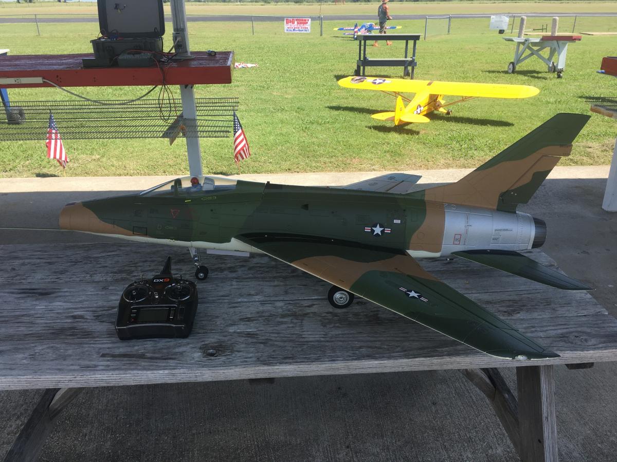

Sitting in the shade cooling off after the first flight, still smiling!
Flying with some friends up at the Texoma RC club field, near Sherman, TX today, about 80 miles from home base.
All was quite uneventful for a first day out with a new model.
Bolted the wings on, installed the HRB 50c 5000, did a control check and a gyro response check in all three Aura modes. All worked as advertised. The Aura in the F-100 is definitely super-easy plug and play with Spektrum. On my DX9, I used switch B for the Aura. It defaulted to mode 3 (high rate/advanced mode) being towards the pilot, mode 2 (low rate) is in the middle and mode 1 (gyro off) was away from the pilot. By the way, first time Aura user here. Had never touched one before.
Did a multi-aspect range check on the model with the AR8010 installed. All good.
Wind was about 3-4 mph out of the east, light crosswind.
Takeoff was uneventful using half flaps. Good acceleration. Great sound in the air.
Feels very slippery/low drag.
Stayed in mode 2 for most of the flight, with one lap in mode 3. Trim was very good, needed a whisper of down and left roll. Felt very locked in.
Felt fantastic in the air. The only thing I plan on changing is the pitch response. The default pitch setting is just a little more active than I prefer. Will need to program in a just a bit more expo In the elevator for my personal taste. Felt perfect to me in roll and yaw.
Did a loop, two rolls and a four point roll, and a number of low and fast passes and a low and slow flyby.
Timer for landing sounded. Slowed down, gear down and then full flaps on downwind. I found that if you slow down, the flap pitch effect is almost unnoticeable when the flaps go down, using the default Aura settings.
Eased down final with a couple of clicks of throttle and went to idle in ground effect. Settled down mains first without a bounce. I was a touch fast and it rolled out about 250 feet in the near calm conditions.
It is a keeper! Great presence in the air. After watching mine fly, Woody Woods, a long time flying buddy from the North Dallas RC Club, hauled out his smart phone and ordered one on the spot.....

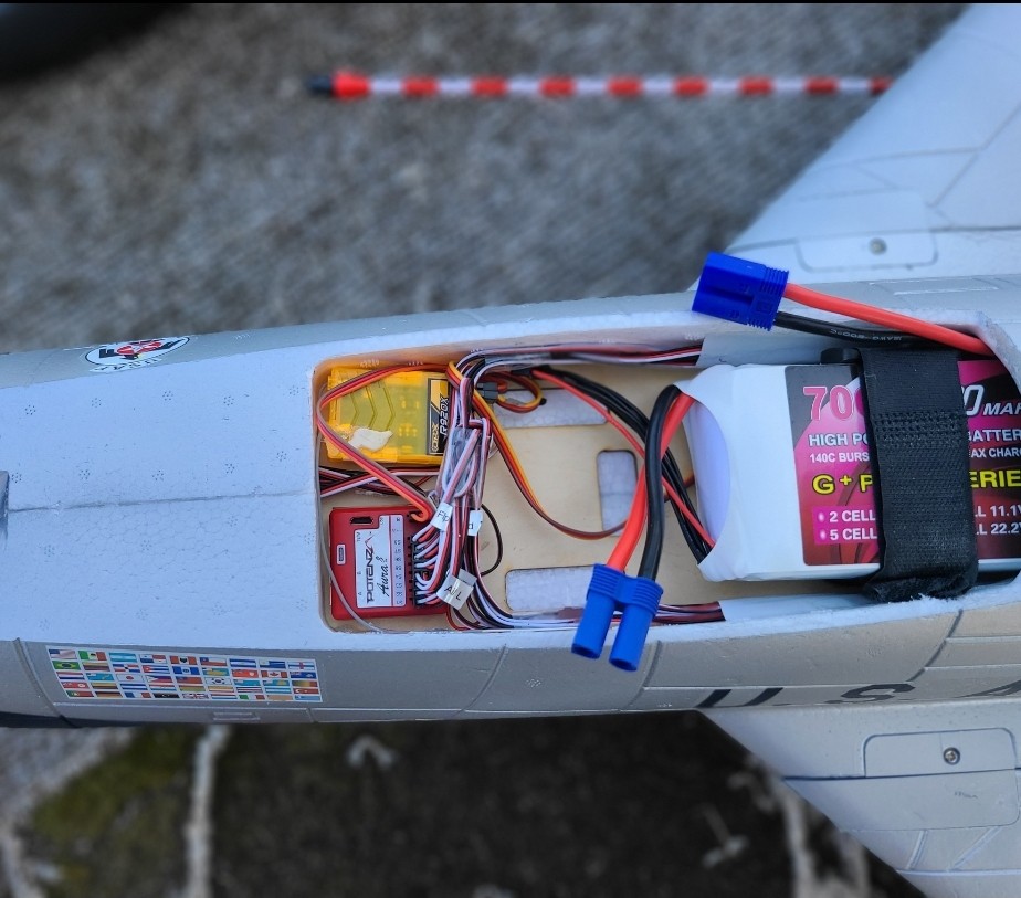

Very nice flight. That 3 minute flight time, although not a deal breaker, is a little off putting. Was the HRB hot at the end as some others have reported. Would a 6200mah or larger fit in there and still balance the plane?Originally posted by krakenreleaser View PostFlex F-100D bone stock flight video. Decent view of its vertical capabilities, speed, and overall maneuverability. Using a 6s HRB 5000. Setup per manual. I love it.
Thanks tailskid for taking the video.
Dave Ribbe reported over on RCG that he is using Potenza 6200 6s. They fit and balance is not a problem.Originally posted by xviper View PostVery nice flight. That 3 minute flight time, although not a deal breaker, is a little off putting. Was the HRB hot at the end as some others have reported. Would a 6200mah or larger fit in there and still balance the plane?
I tend to bend the throttle stick on most of my 80-90mm jets, so all my timers are set at 3 minutes. using 5000 lipos. I just take two battteries to the runway with me and fly for 6 minutes, with a short break for the pack swap.
The two fairly small wheels on the nose gear might be an issue, even on a well manicured grass runway. The good news is that the model has a nice positive deck stance, which will help.Originally posted by Dwalkerp47 View PostGuys, will the Flex F-100 fly off a well manicured grass runway?
I have noted that those Potenzas are generally much lighter than the "average" LiPo battery of the same mah. Nevertheless, I guess with my style of flying, I could likely squeeze another minute or so out of the same size battery.Originally posted by tab28682 View Post
I do the same as you when I go flying. I take 2 batteries per plane to the field and as many planes as will fit comfortably into the car. However, in my case, don't usually fly the same plane twice in a row.
Well, I will get mine later in the week. There are several of us that have been flying EDF's for quite a while now on our grass strip. I will give all of you a "Grass Ops Status"when I maiden this beautiful Bird.Originally posted by tab28682 View Post
Thank you! It was warm but nothing crazy. I also flew it with a 6000 CHNL 70c pushed all the way aft and it flew great as well. I flew it for 4 min and it came down at 33%.Originally posted by xviper View PostVery nice flight. That 3 minute flight time, although not a deal breaker, is a little off putting. Was the HRB hot at the end as some others have reported. Would a 6200mah or larger fit in there and still balance the plane?
